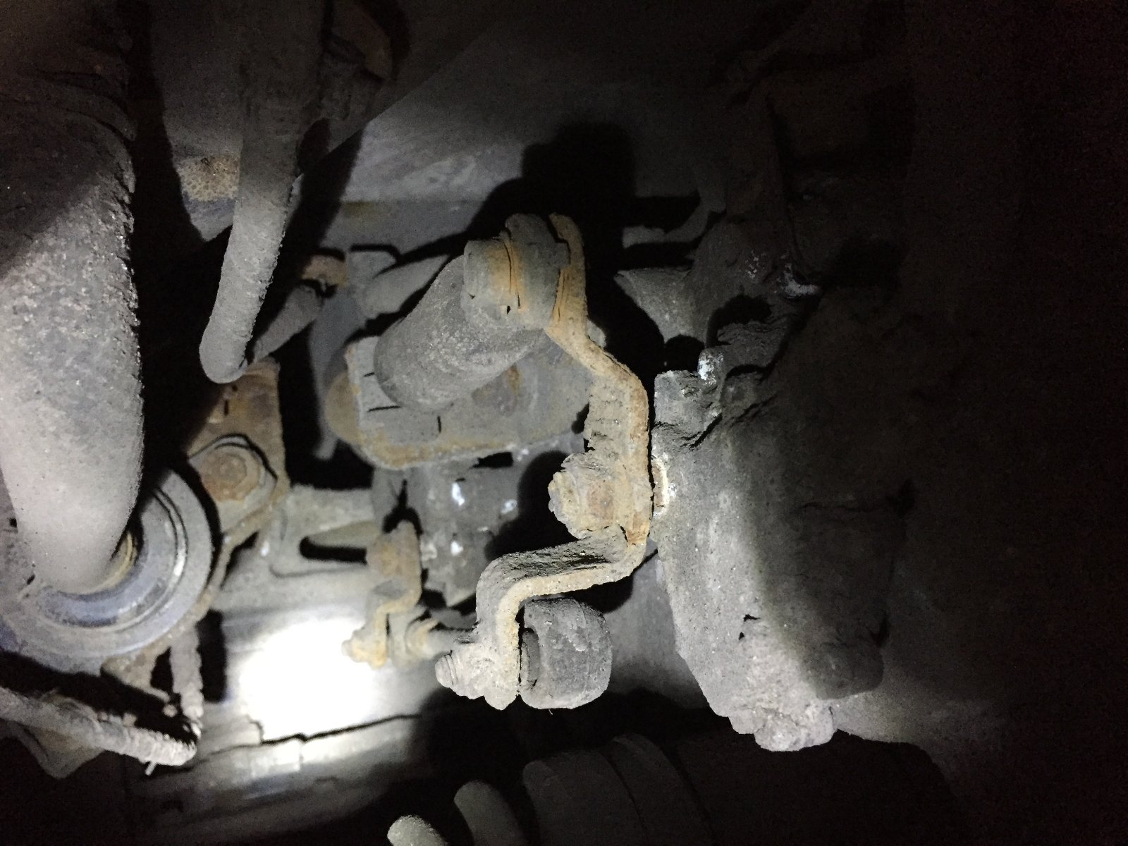

Well it was playing up again today and as it wasn't raining tonight I thought I better do something about it, even in the dark!
When I left work the lever was quite stiff and "springy" at the ends of travel and I found I couldn't push it fully into park - and it triggered a fault immediately. It also felt like it was trying to spring out of drive. So I backed it up onto the ramps tonight and saw this:
The switches themselves can barely be made out from the dirt and corrosion.

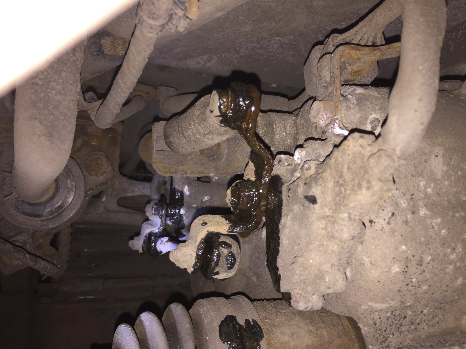

The two switches are quite a long way apart (about 6 inches) with a long link rod with a ball joint at each end joining them. I just gave all the pivot points and ball joints a thorough douse of standard cheapy halfords spray grease I had on hand:
After greasing it like this and giving it a good working back and forth the gear lever feels like new again - it travels easily right to the ends with no springiness and there is a nice satisfying engagement when you go between drive and neutral instead of it feeling like its trying to jump out of drive. So far, I can't reproduce the problem with it reporting an error in the park position.
The bowden cable itself is completely enclosed with a large rubber concertina boot (at the top) so I wasn't able to get any grease into that, but it doesn't look like the cable is to blame anyway.
From what I can see the issue is the ball joints seizing up - probably due to dirt and moisture building up in the cups, as they look somewhat exposed to the accumulation of dirt and moisture! Although I sprayed grease on the shafts themselves, I'm not convinced that that actually did anything. It's possible corrosion at the top pivot point where the cable attaches to the lever arm was also a potential culprit. I greased all the pivoting points just to be safe.
Touch wood this has fixed the problem
and it looks like due to the silly exposed design of these levers and ball joints a bit of spray grease on the joints should be an annual maintenance activity. With the car backed up onto ramps it only took a few minutes, I didn't even have to remove a wheel!

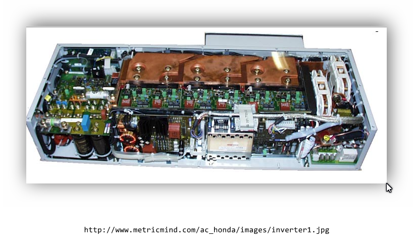

Gibbo2286 wrote: 05 Feb 2018, 11:56
Everything is repairable Chrisfancy getting inside one of these? This is a Seimens example.
I'm up for having a go at repairing anything electronic (within reason) but even I'd balk at this one... The scope for epic fireworks and injury are very, very significant...
I say that, knowing the principles of operation of these things; the chances of a successful repair are low. Many try to repair switch-mode power supplies - they operate on similar principles - and invariably even the most skilled have to give up in frustration at the continual failures, almost fixes and lots spent on new components...
They injure their fingers too from the continual crossing of them they do...
