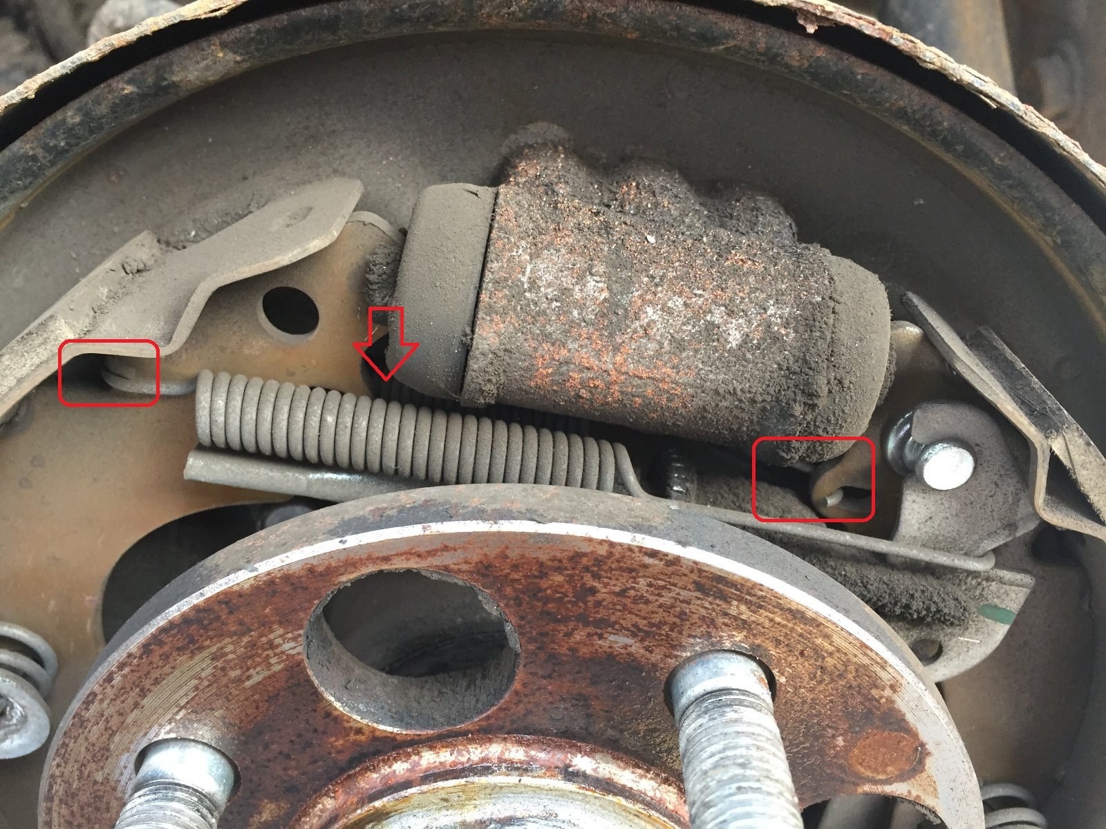

white exec wrote: 17 Jan 2018, 12:30 Return (pull-off) springs normally link shoe-to-shoe.
In that picture, the RH end of the spring does seem to be pulling on the adjuster (or is it the handbrake lever?), but where it pulls is so close to the pivot that it will be pulling on the shoe as well, I guess. Perhaps that one spring is made to do two jobs: shoe return and handbrake relax.
As bobbins amended post says, there are two springs there - the one you can see is the automatic adjuster spring. The shoe to shoe spring is behind and under the cylinder. I've highlighted the ends of the shoe to shoe spring here as well as a tiny glimpse of it you can see at the arrow behind the front spring:

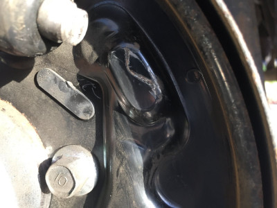

Simon, a latest photo above does show six (copper-greased) pads.
I'm puzzled by this photo, though. Not sure what I'm seeing there. Looks almost as if a pad had been partly ripped away, and turned upwards. Can you clarify? I'm certain those pads should all be flat.
That's the top right backing pad from the photo with the grease before the grease was applied. It's not ripped away its just a flat raised painted pad with a big gouge in the middle cut into it by the edge of the shoe...

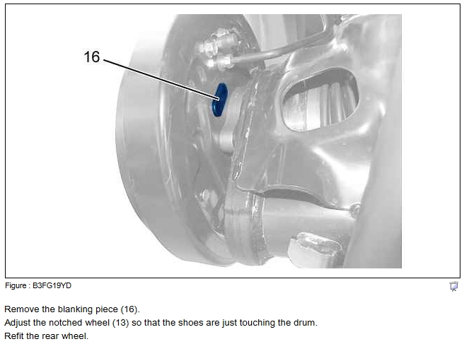

bobins wrote: 17 Jan 2018, 16:23 Just to clarify from a previous post of yours - the book method of adjusting the shoes up is to put it all back together then....
The notched wheel (at 13) that they refer to is what you, I think, refer to as the self adjuster.
Yes I have that service page - I initially followed it but the problem is if you follow it literally you are tightening the adjuster to the point where the shoes are dragging when the handbrake is left... doesn't seem right to me even if it is listed in the service manual...
The article I linked from earlier today had an interesting comment on this:
Brake shoe adjustment is another common cause of rear brake lockup. It is generally accepted that rear brakes should be adjusted until a slight drag is felt. This procedure only applies to a small handful of older vehicles. The methods listed by the vehicle’s manufacturer’s vary widely and sometimes incorporate some rather odd steps. A good generic approach to use is to quick set the shoes to the drums and then use the vehicle’s self-adjusting system to complete the process. Vehicles with duo-servo rear drums (Figure 61.1) should have several stops made when backing up. This will complete the adjustment. Most FWD vehicles self adjust when braking while the vehicle is moving forward (See Figure 61.4). Once the rears are quick set test drive the vehicle to finish the adjustment process. It should be noted that this procedure will only work if the self adjusting system is functioning properly.
I pretty much came to the same conclusion independently - which is that it was better to start with a bit more slack and let the self adjusters find their natural adjustment point after a test drive.

If you look at the upper of your two pictures, Simon, it looks like the pad to the right has slipped around on the mounting plate. If you compare it to the pad on the left, there is obviously a difference. Not having the whole pads to compare against does make it tricky, but the end of the pad is near to the fold (left pad), while the pad on the right is over the fold.

Mandrake wrote: 17 Jan 2018, 19:56 IMG_0457-1.jpg
Sorry, but you've lost me there.
All six of those pads should be flat, surely. The one in the photo above really doesn't look it.
What is the turned-up edge? How deep is the gouge in the pad?

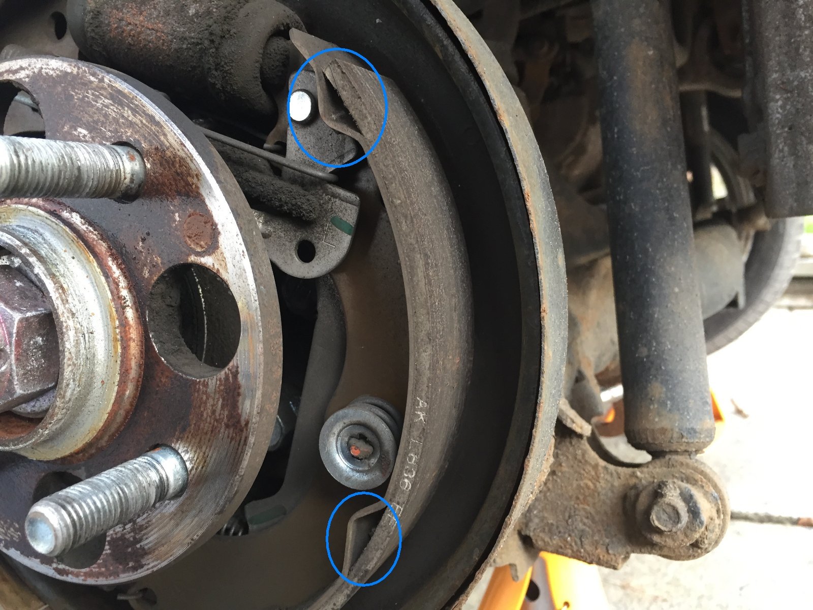

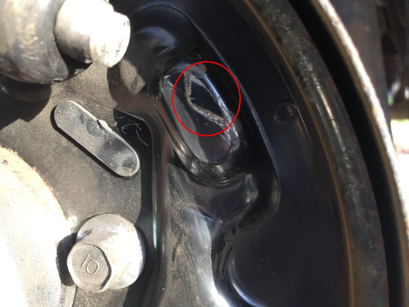

white exec wrote: 17 Jan 2018, 21:24
The wear marks circled red:
Wear marks - Mandrake (modified)
Correspond with the brake shoe frame circled blue:
Brake shoes - Mandrake (modified)
x 1751
Re: Simon's new Xantia V6 and Peugeot Ion blog
I've looked and I've looked, but I cannot make sense of what's in that red circle.
The pads should be flat and smooth. That one - presumably - needs plating over or something put in its place. It cannot have ridges and be expected to work.
A bolt-head in the backing plate, in contact with the back of the brake shoe, would do the job.

Hell Razor5543 wrote: 17 Jan 2018, 20:08 If you look at the upper of your two pictures, Simon, it looks like the pad to the right has slipped around on the mounting plate. If you compare it to the pad on the left, there is obviously a difference. Not having the whole pads to compare against does make it tricky, but the end of the pad is near to the fold (left pad), while the pad on the right is over the fold.
If you mean the two shoes are not centrally located at the top, horizontally - no they probably aren't in the photo, because I almost certainly moved the shoes back and forth sideways after removing the drum but before taking the photos. So that's not a problem. Remember the drum will force the two shoes to centrally locate themselves when you apply the brake with the drum in place - assuming they can slide freely to do so of course!

white exec wrote: 17 Jan 2018, 21:24 Sorry, but you've lost me there.
I think you're getting fixated on what is either just a shadow or a reflection in the paint. The edge is not "turned up", all the pads are raised, flat sections, albeit with some wear grooves in them. The gouge is the full depth of the paint down to bare metal.

Handbrake acts mechanically (via levers, usually) on both shoes, and virtually simultaneously. Applying braking to only one shoe would be to induce unneeded stresses on the drum, and be unstable (could let go when parked).
Sorry not to be able to interpret the photo. Getting rid of the ridges on the pads is definitely a first step.

Since I have seen a wider shot photograph might I suggest you look at the shoes and pads. On the earlier shot (first photograph, first post on this page) you can see that the left pad ends at the crease, while the right pad bridges the crease. However, in the lower photograph in the seventh post on this page you can clearly see that the pad bridges both creases on the metalwork. I wonder if the pads might have been put on the wrong way around (so the left pad and the right pad are in the wrong position)?
