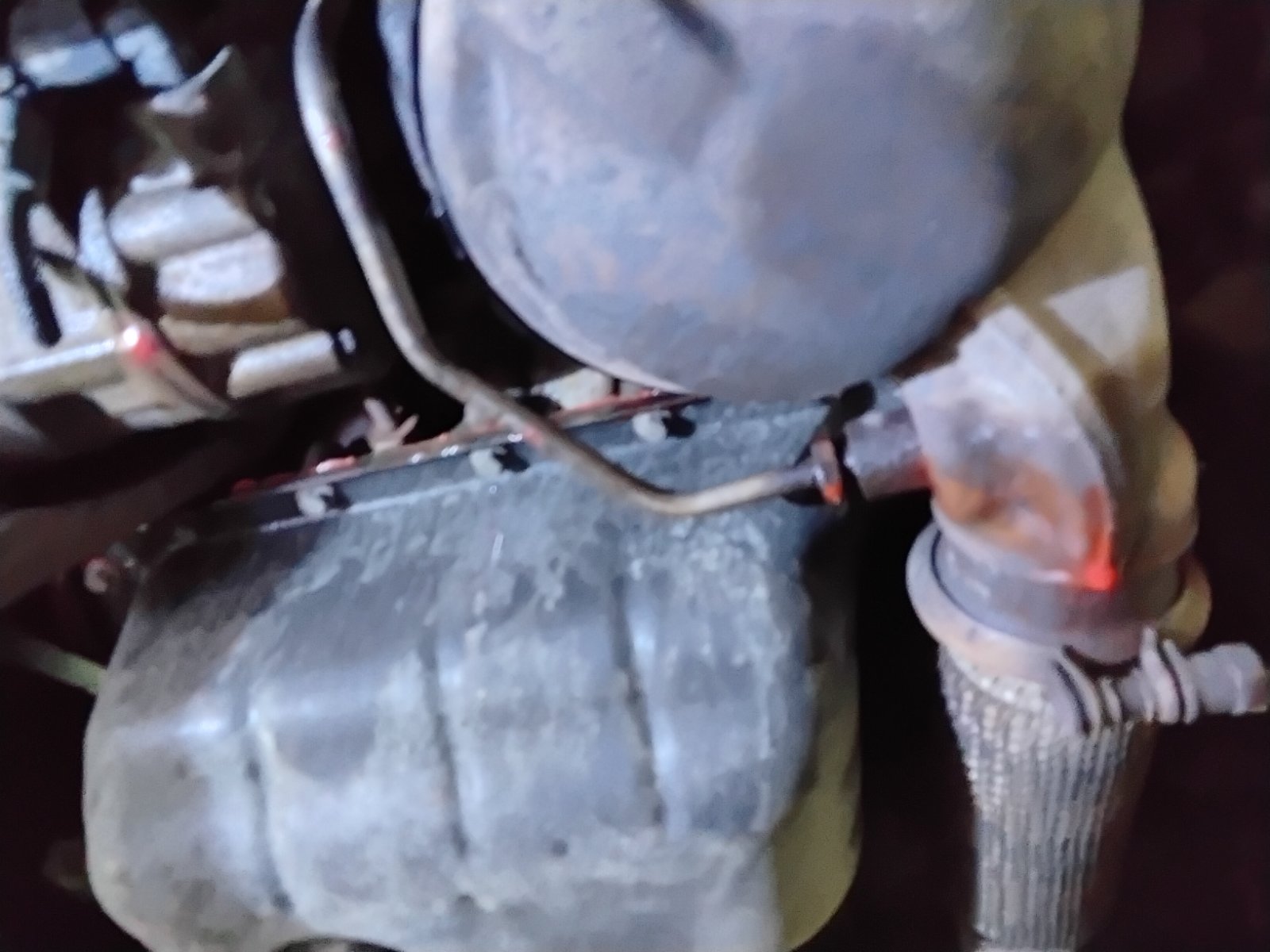

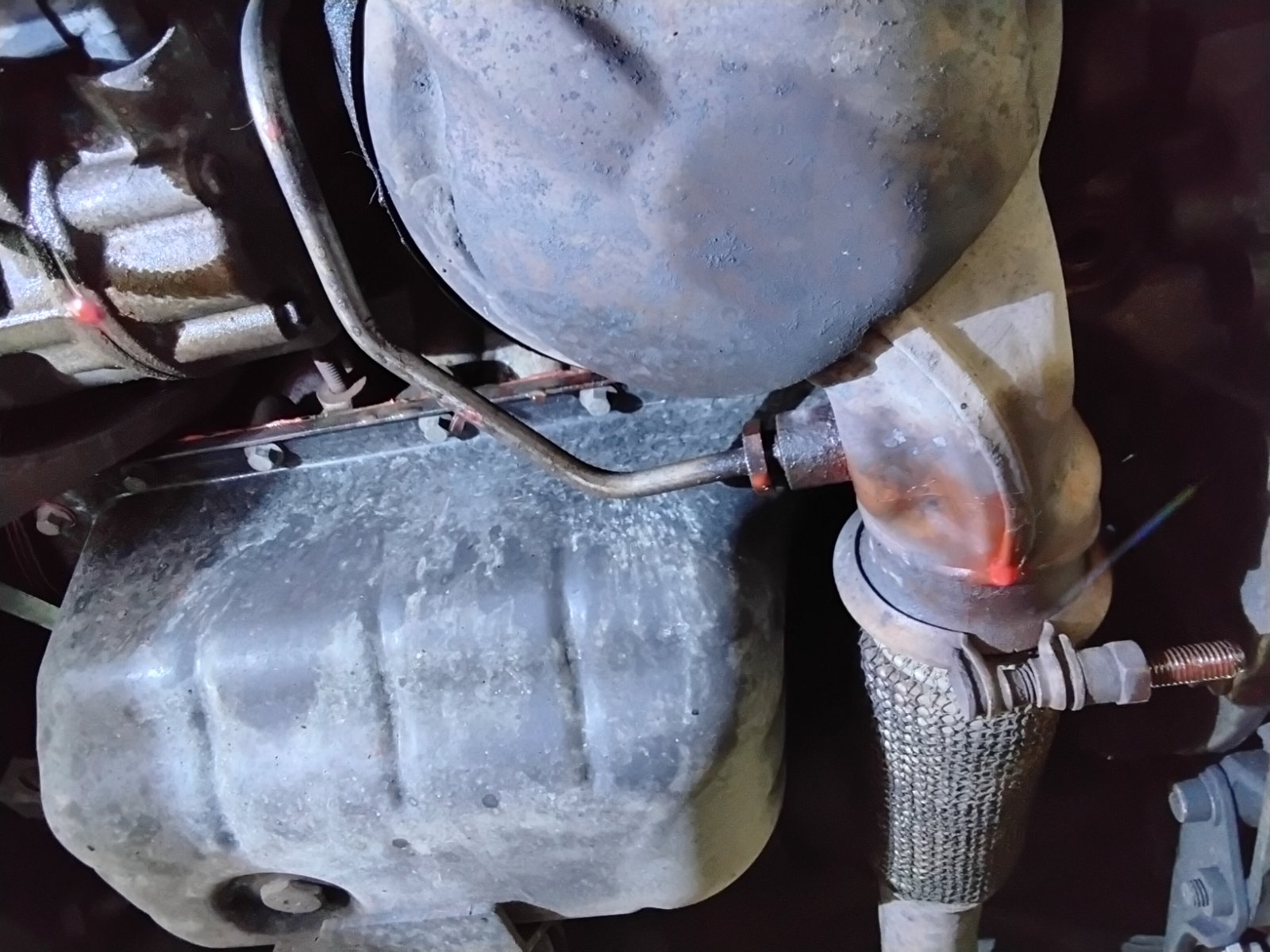

Hi Mick well as far as i can tell alls ok in that department , Not sure if these photos will show up, oil clean too so i decided not to waste coolant & used water in the header tank while filling it took lots and i heard a trickle drip sound hitting the drive .
Not sure if any drips can be seen on these 2 photos but this is the area where the leak is ? Core plug ? I for the life of me cannot picture whats in this area for a leak to happen .
So theres no core plugs.
I seen the oil filter housing can leak , im thinking it would run onto part of the dpf as thats very close to it then run down the engine under part of the sump and basicly pee out everywhere till the level gets below this housing locations lowest point.
