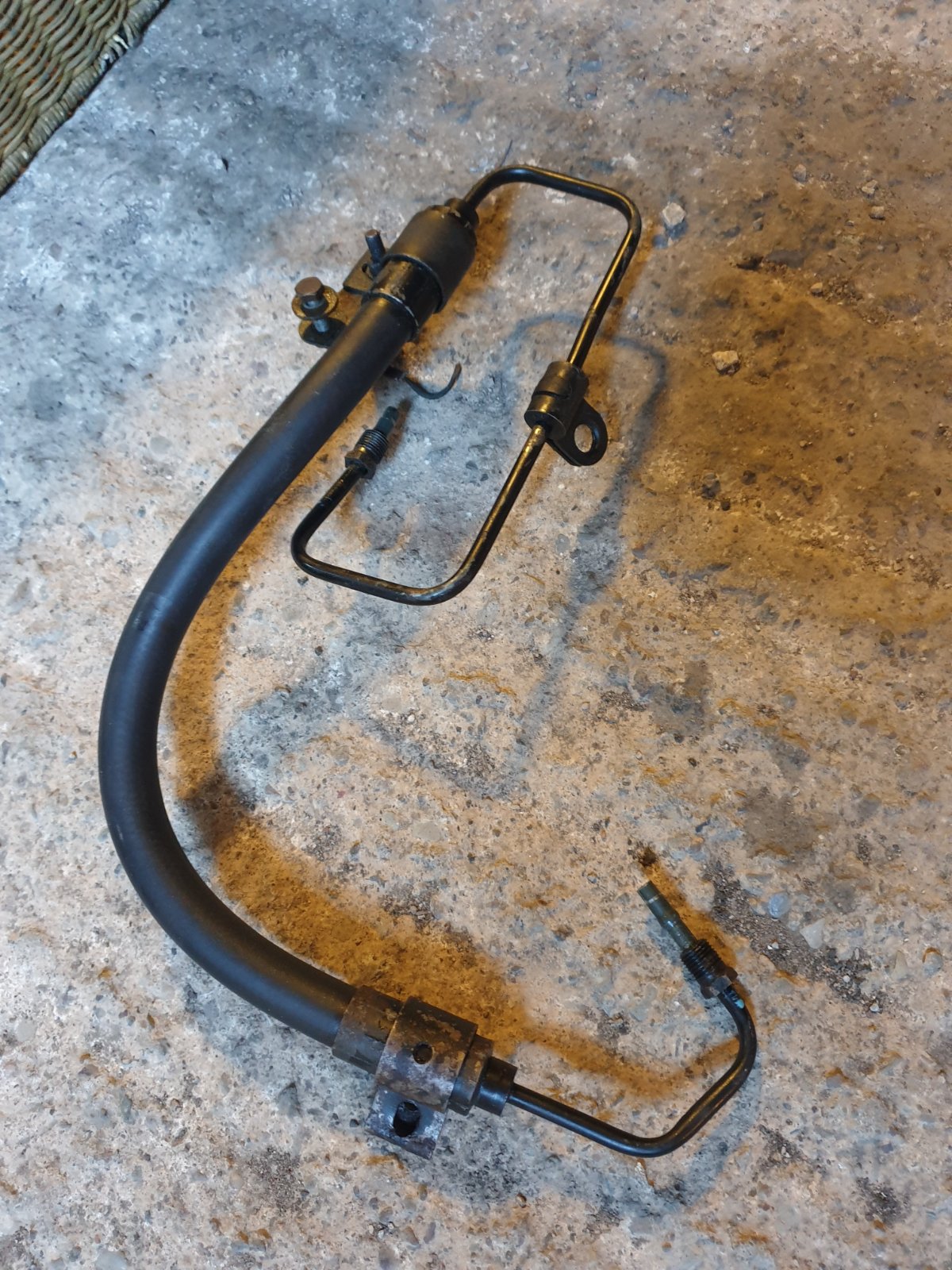

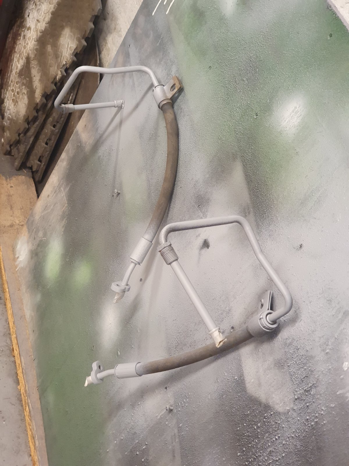

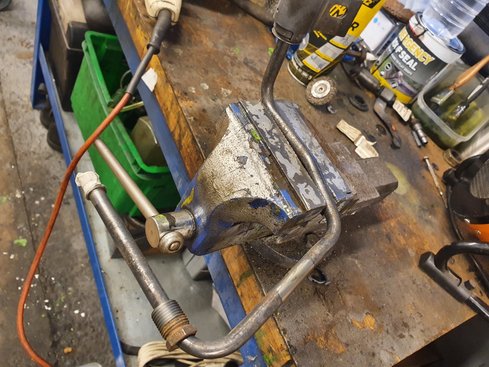

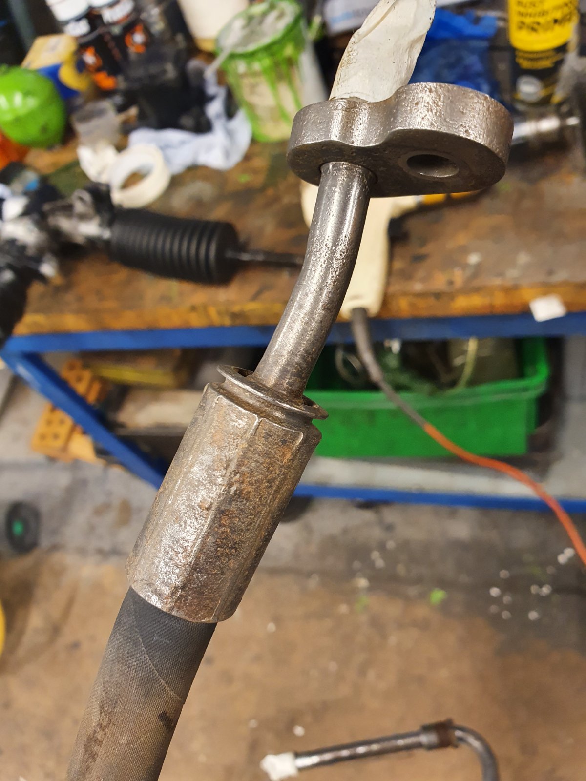

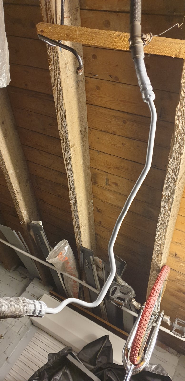

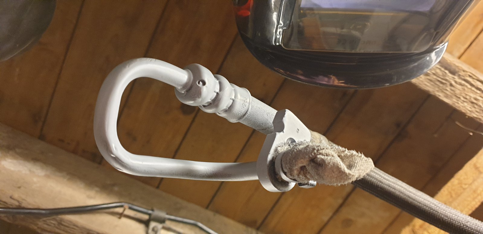

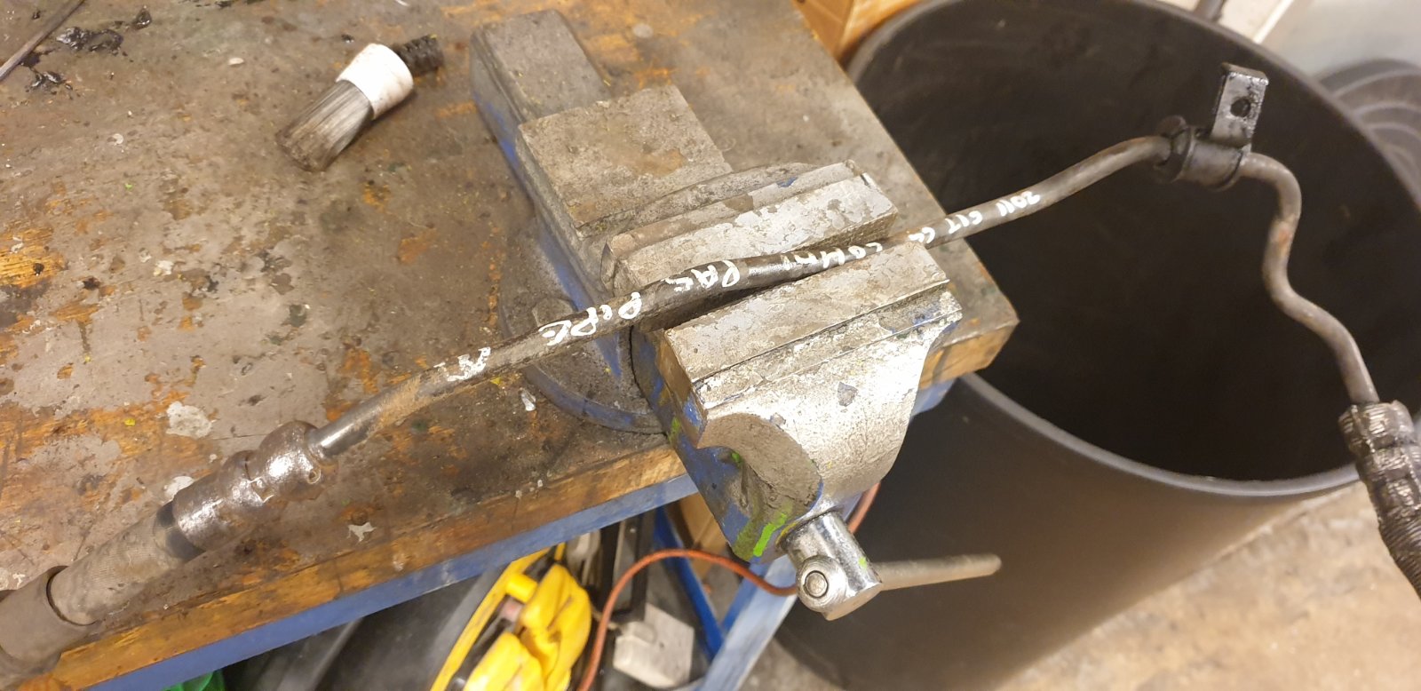

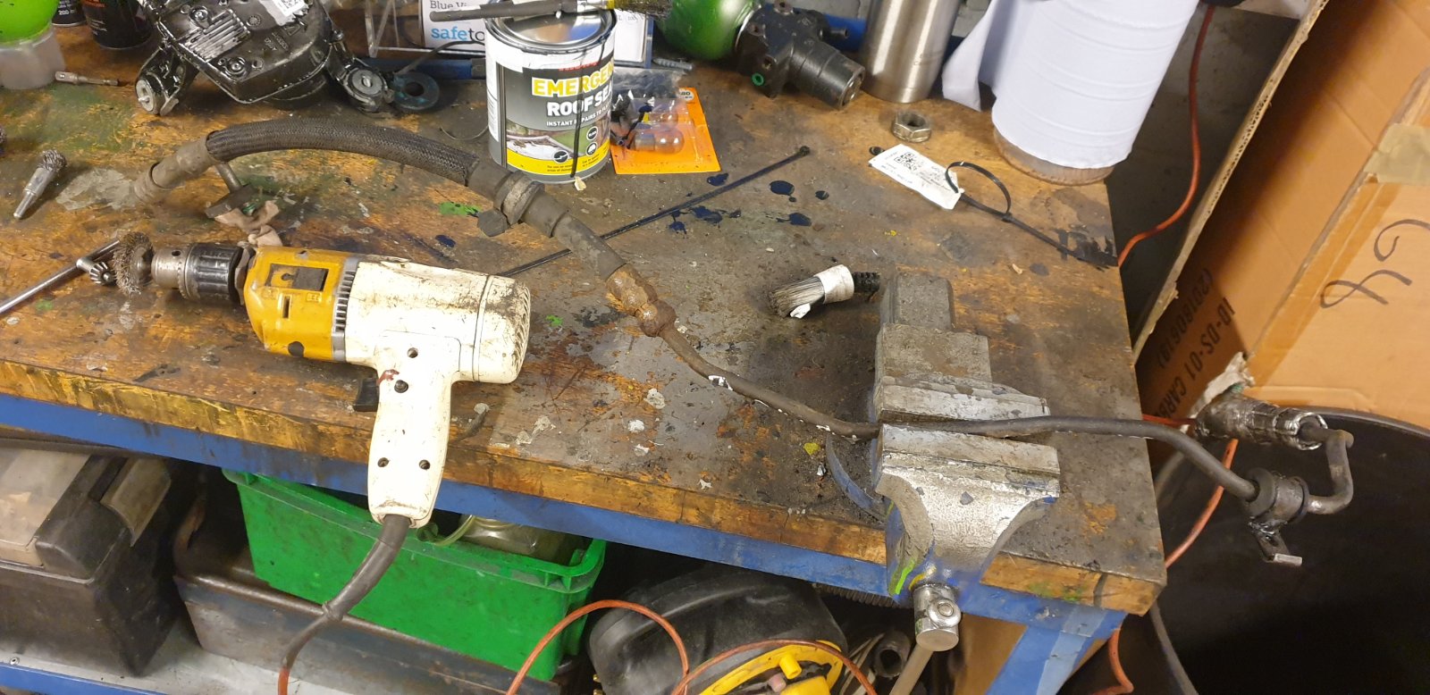

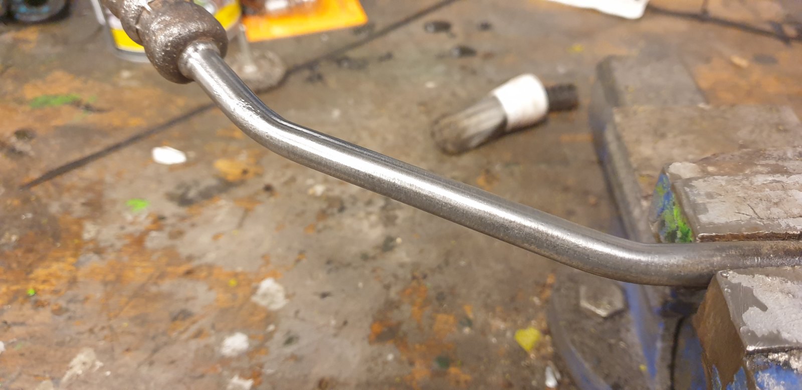

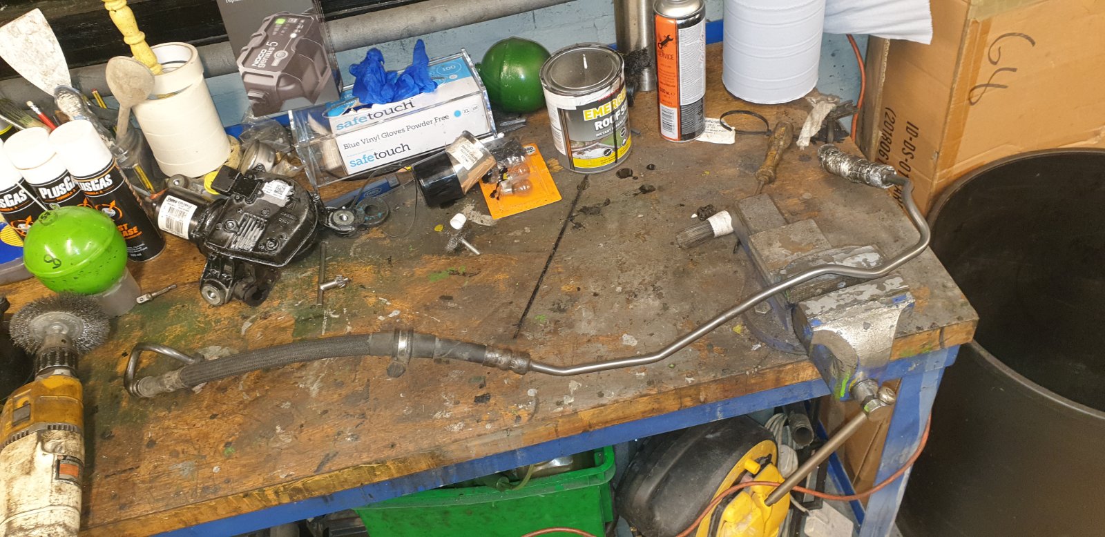

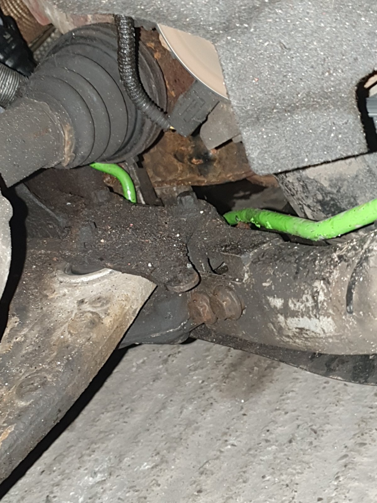

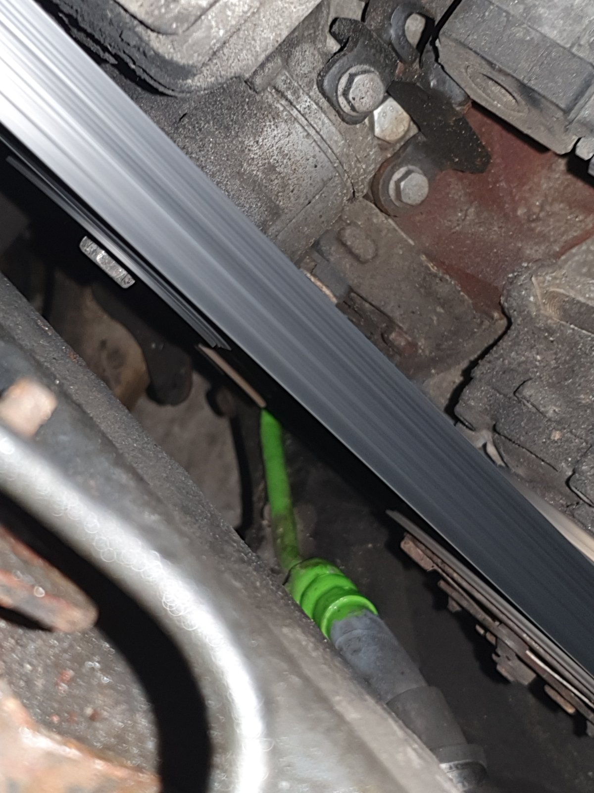

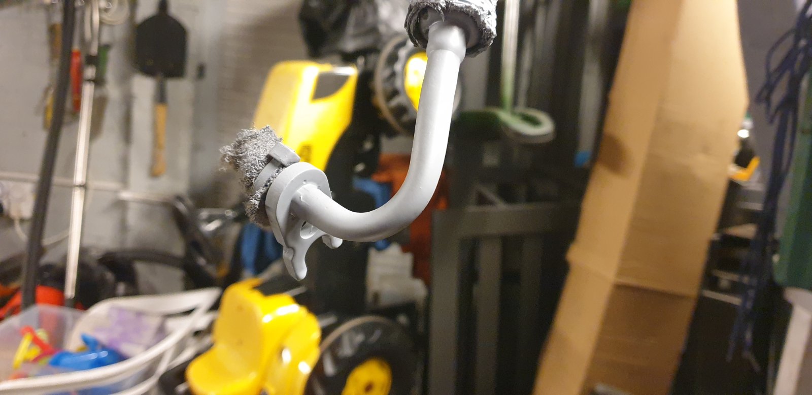

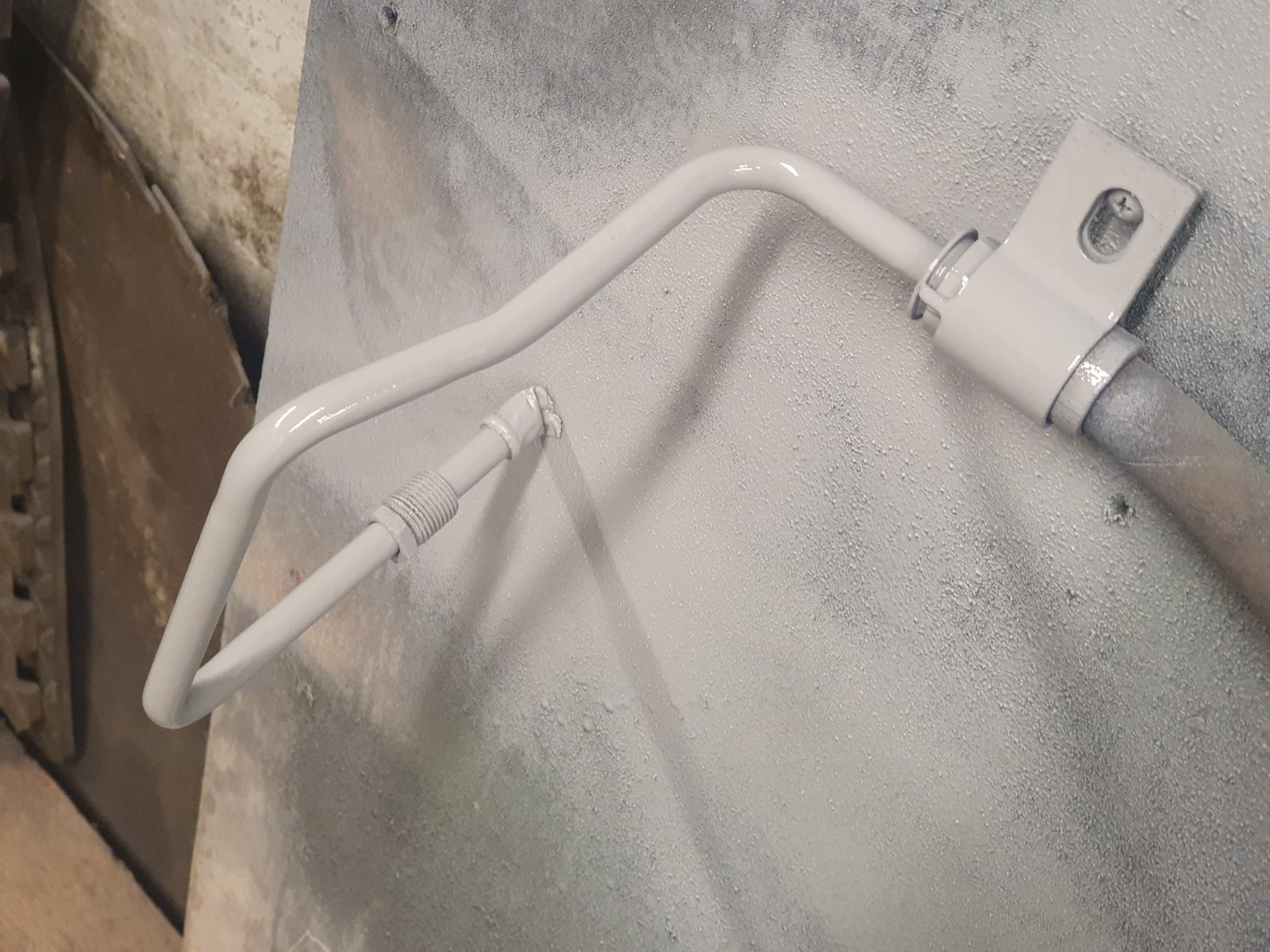

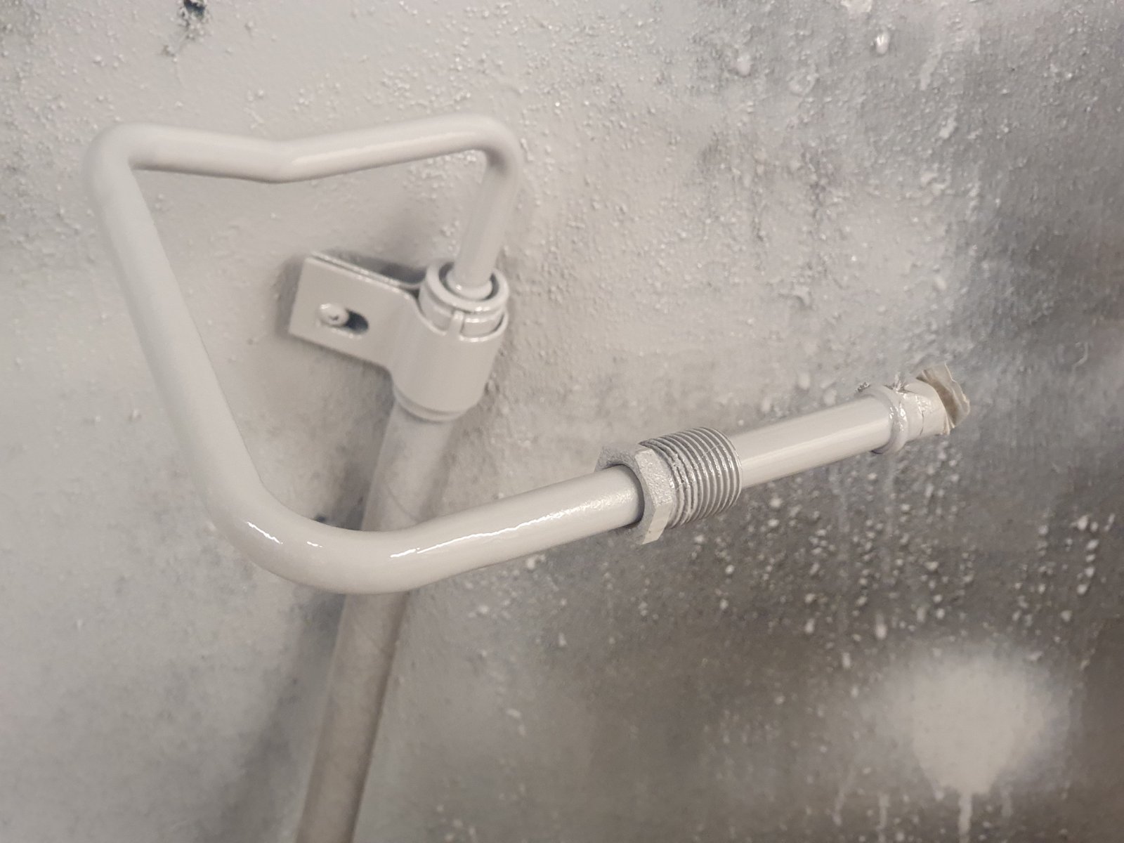

I have started to refurb and protect the power steering pipe. Here is the state of the used part:
Cleaning the surface rust off with wire brush shows that it is in good condition underneath.
Next 2 layers of zinc primer
I'm going to return and add a protective top coat - ideally something fairly thick but have not decided yet what it'll be. I have a fair amount of brake caliper paint albeit in bright green :-D and I had good results with the flat roof repair paint a few weeks ago but I don't know how compatible that is with the primer. I might try a bit to see if they are happy together and don't react.

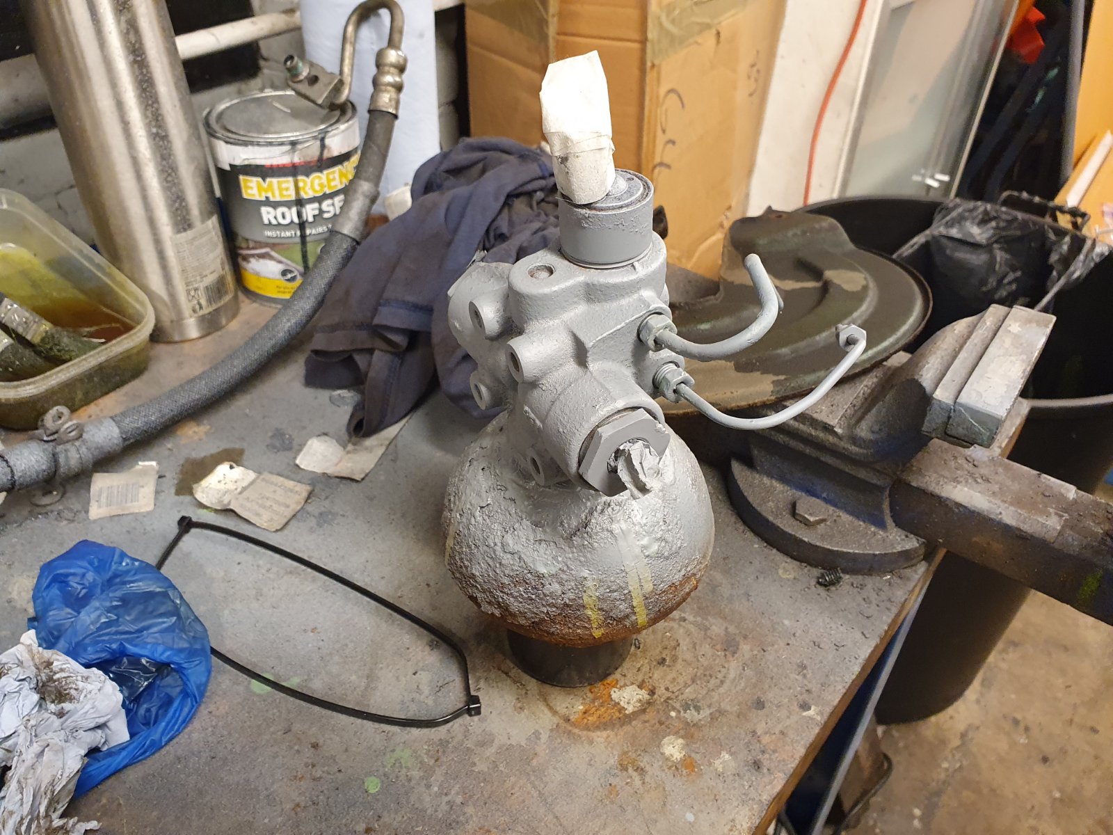

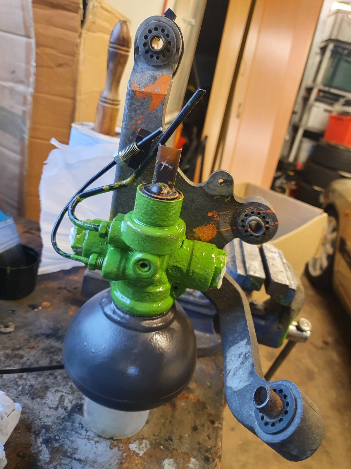

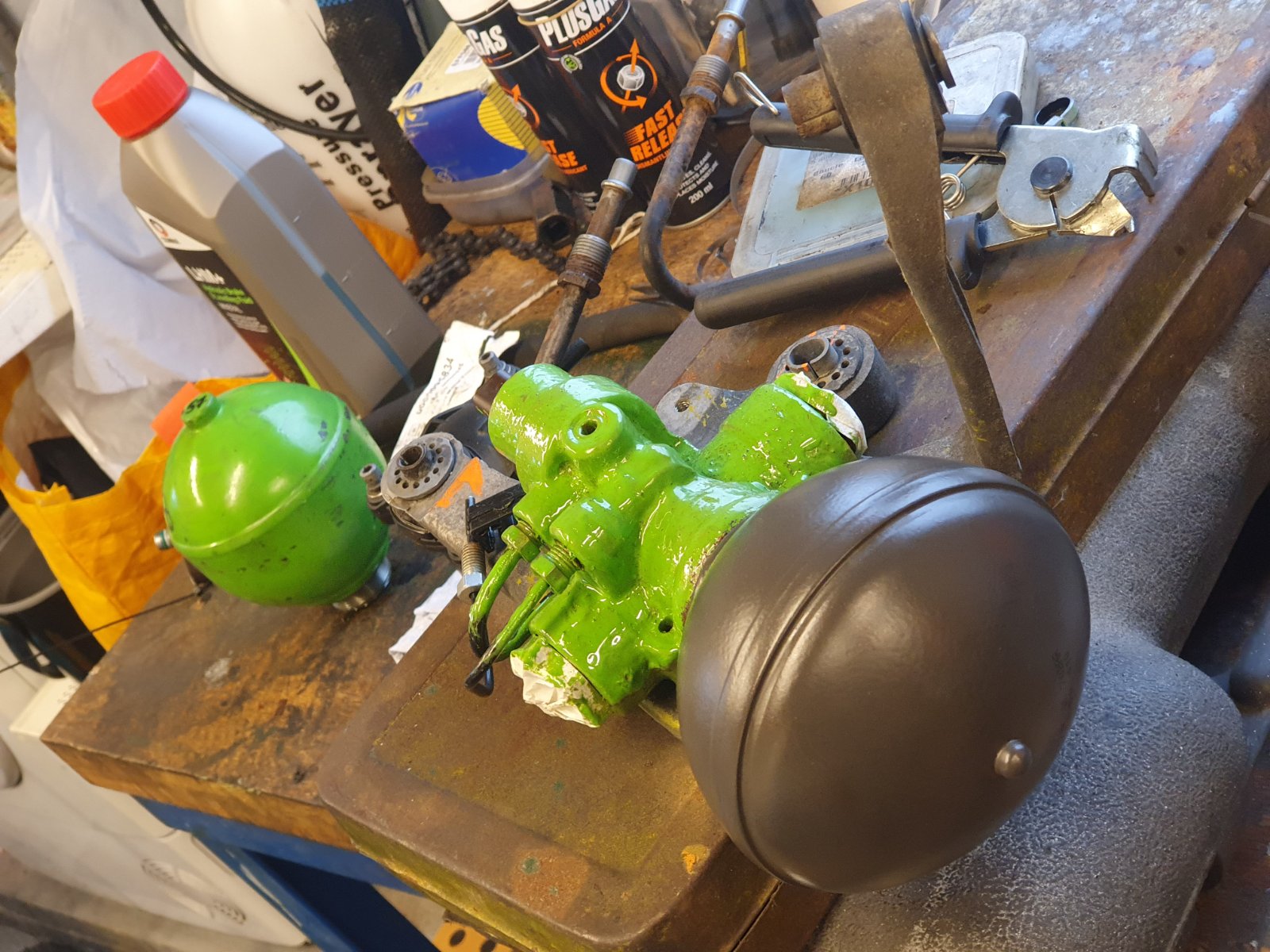

I used some of the bright green paint on the replacement front suspension regulator:
I had originally painted this in gold caliper paint but was not happy with the coverage and felt it would just corrode again. The green is so much thicker and I think it will protect the unit from the heavy corrosion in future.
I really hope this can protect this notorious power steering pipe and that it will not have to be replaced again...

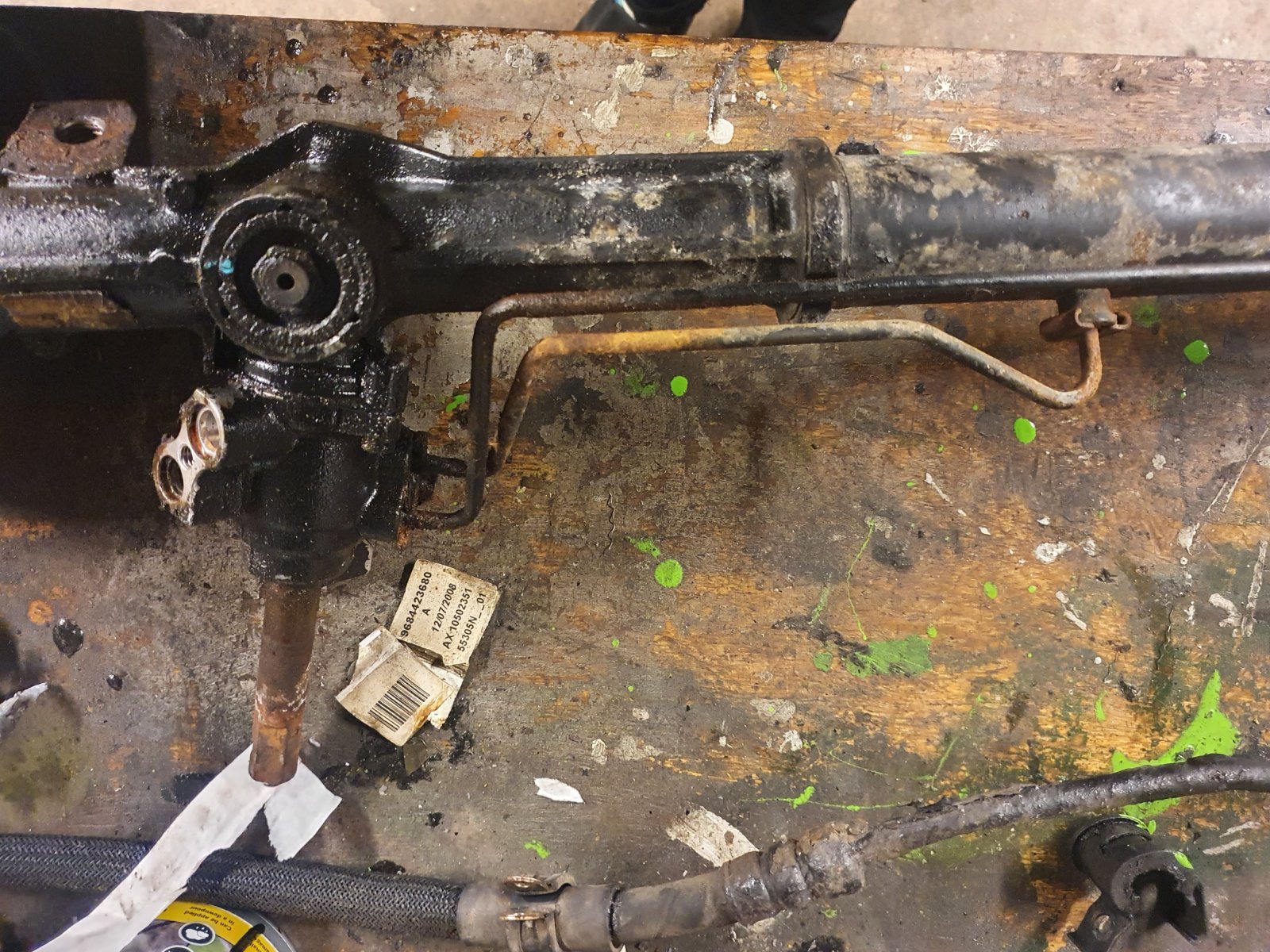

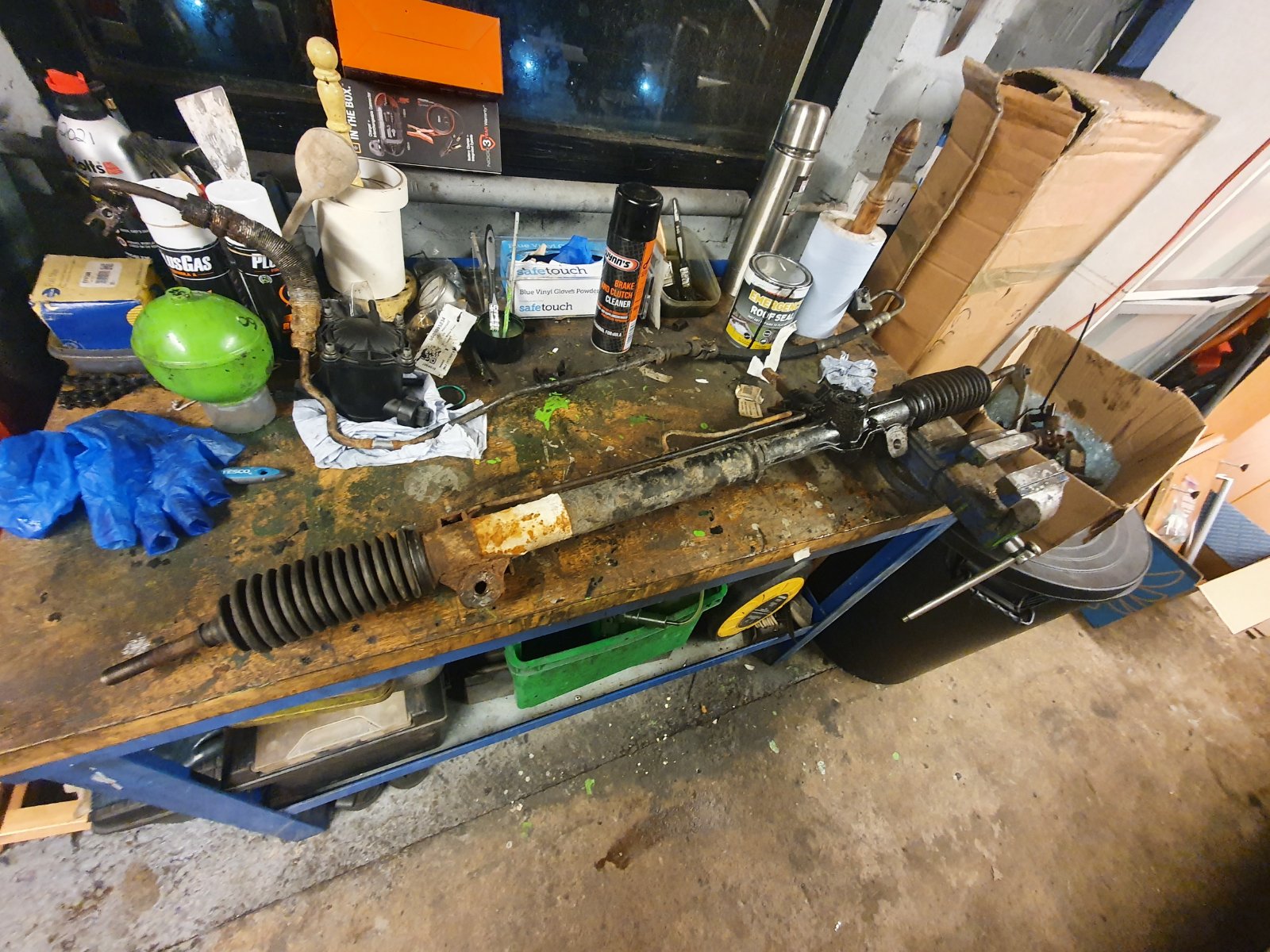

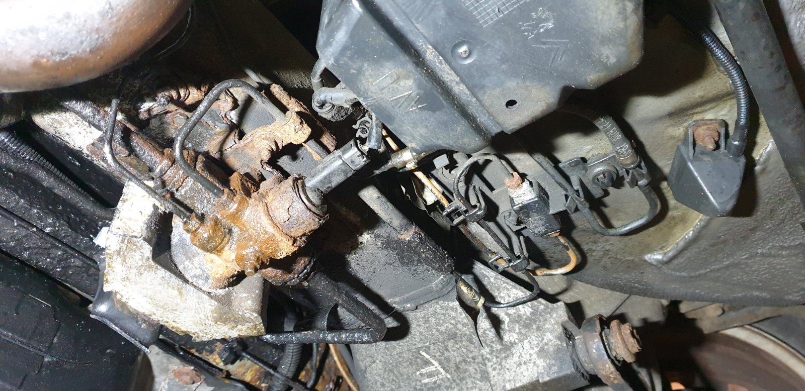

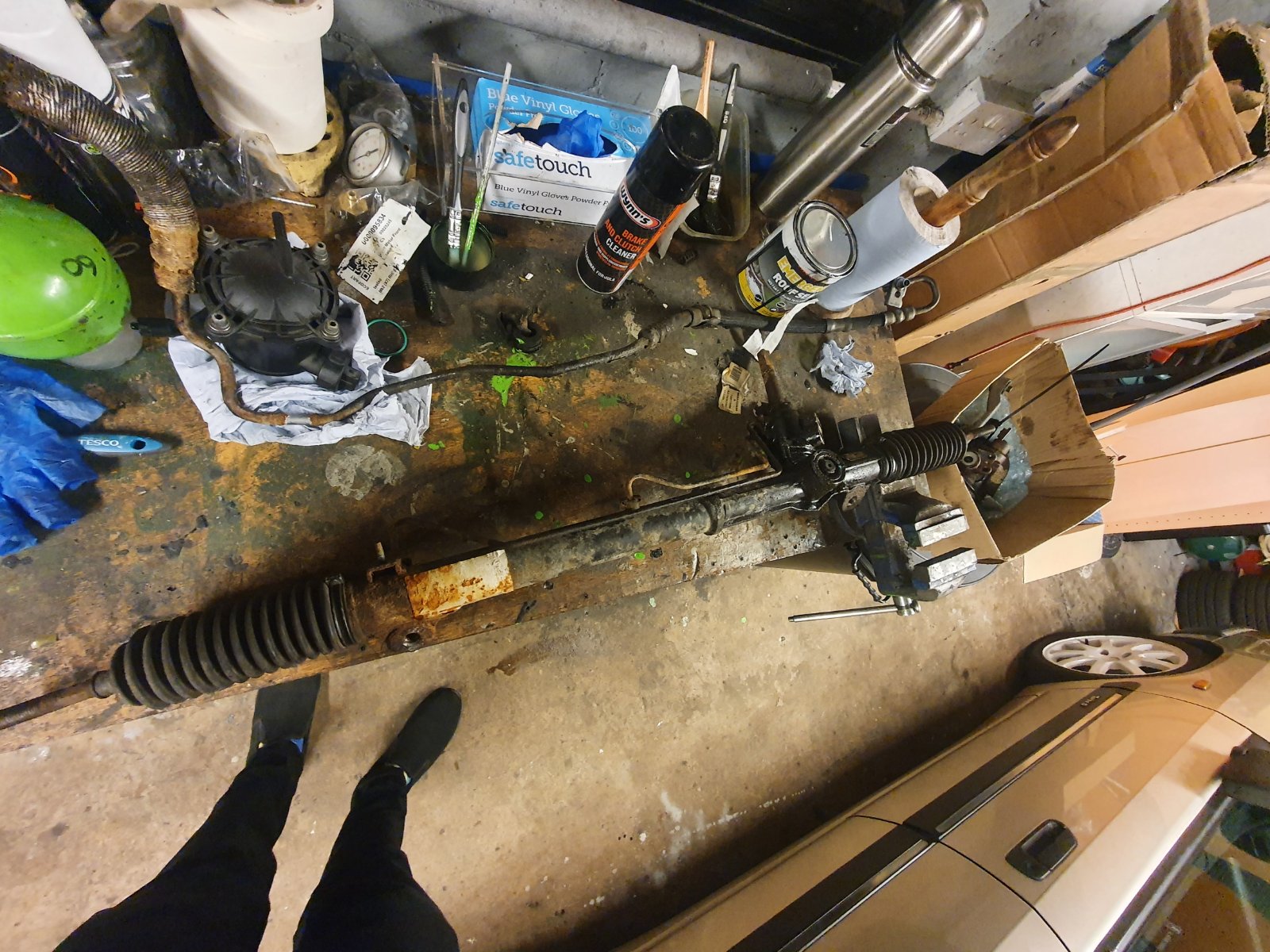

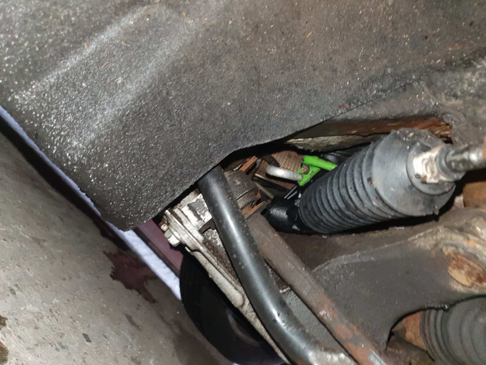

Finally have the replacement rack fitted, the reconditioned PAS pipe fitted and most excitingly (for me) finally have the front suspension regulator changed! It is impossible to change over without lowering the front subframe.

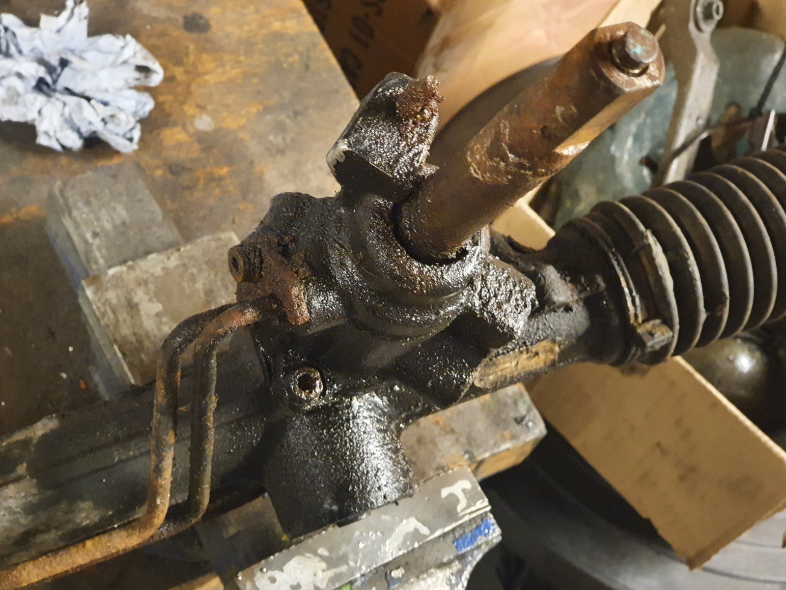

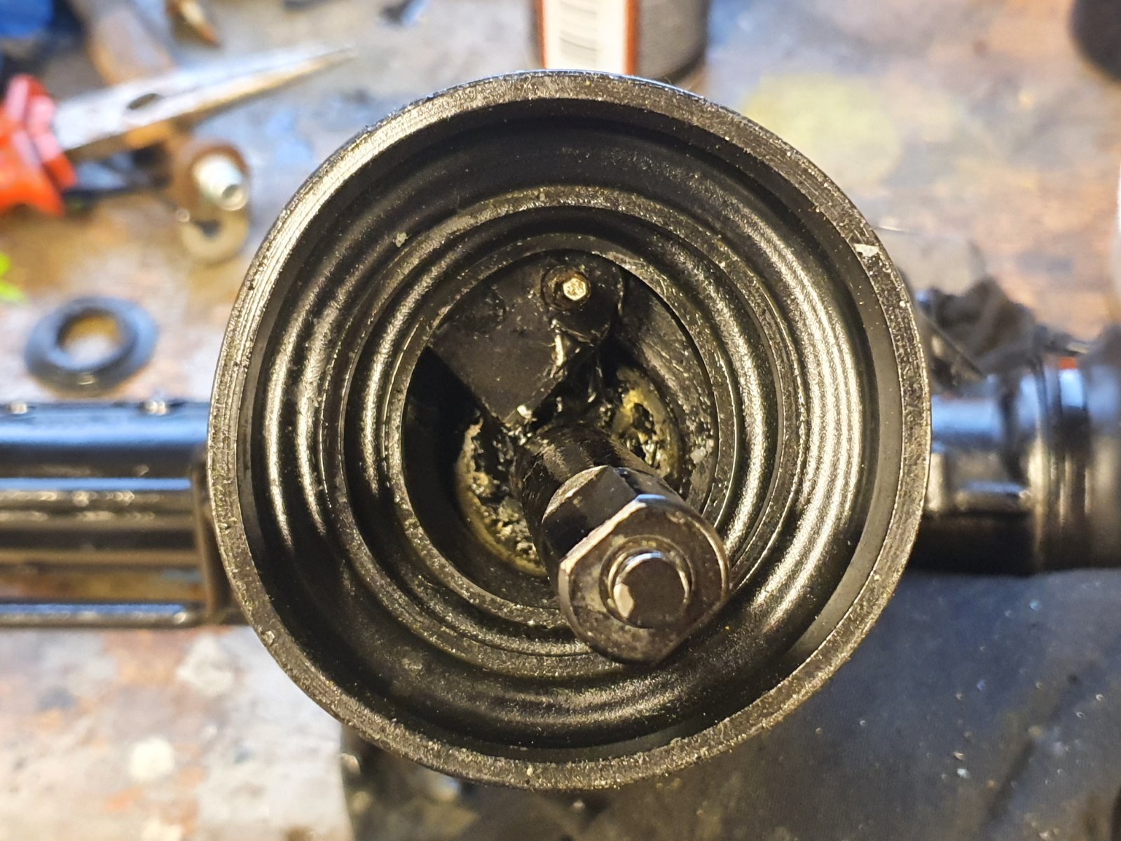

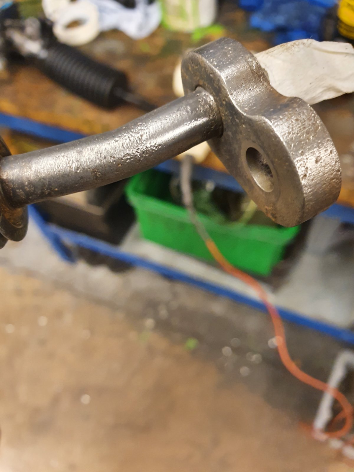

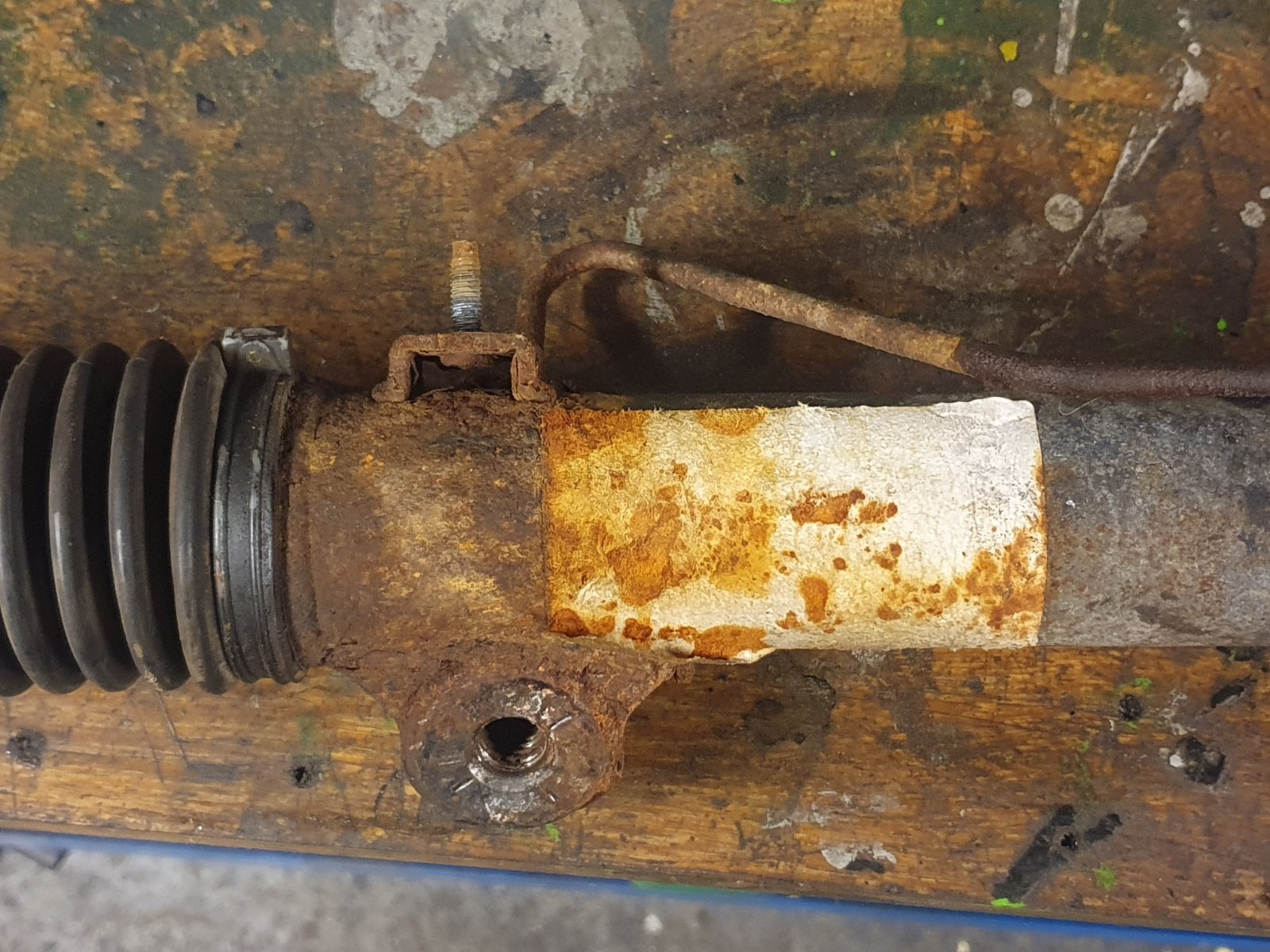

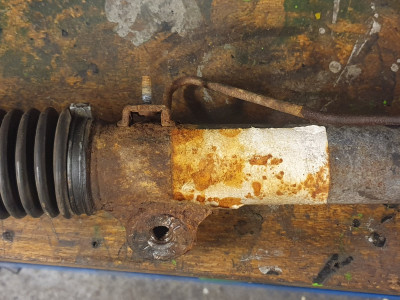

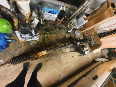

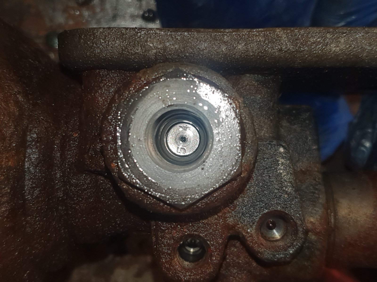

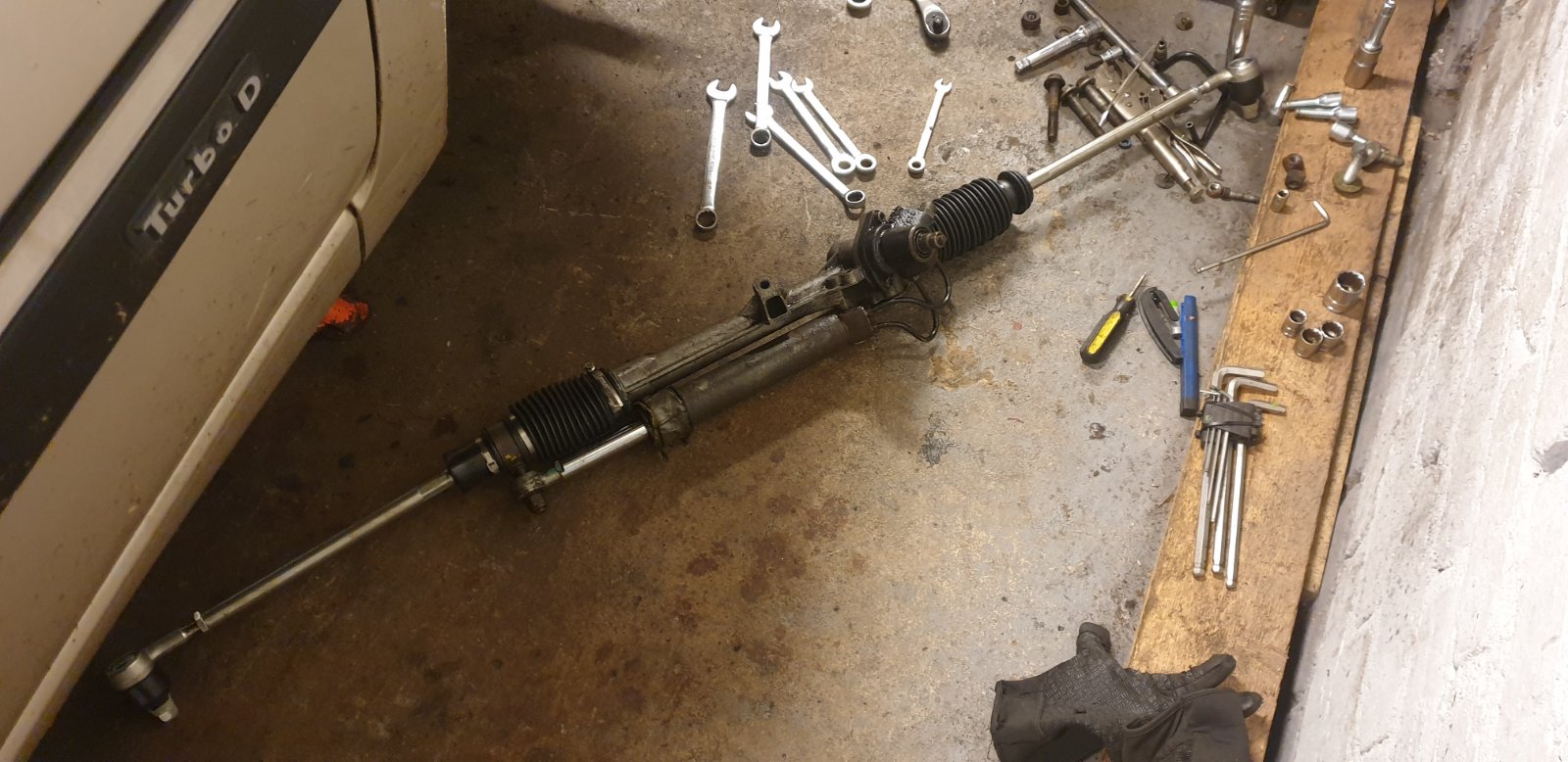

Anyway, a few snaps of the old rack:
you can see the corrosion here and there but although the usual pinion valve seal leak is happening, the rusty shaft looked to me to be not as bad as others I've seen posted on here.. I suspect actually this rack was already a replacement but no proof.

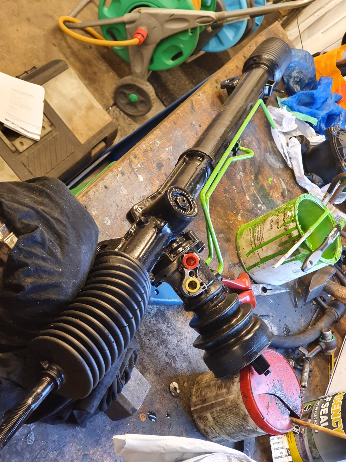

After derusting and zinc primer to the PAS pipe I returned and painted it with 2 layers of caliper paint. Bright green as before. I didn't take a picture of the painted pipe but you can see it now in position here:
The bright green might seem a bit crazy and really it's because I happen to have a fair amount of green caliper paint but it also means over time I can see any changes to the surface of the pipe if it starts corroding prematurely again.

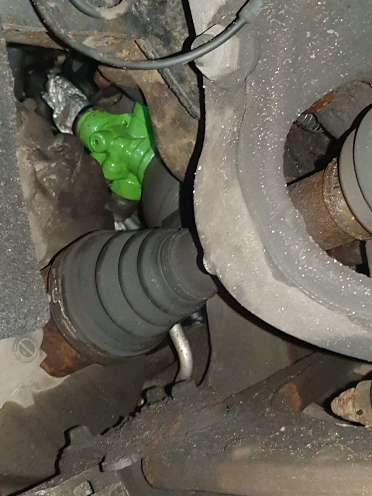

More green paint action here! The new front hydractive regulator!

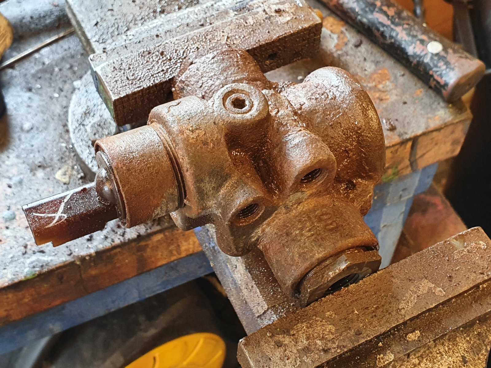

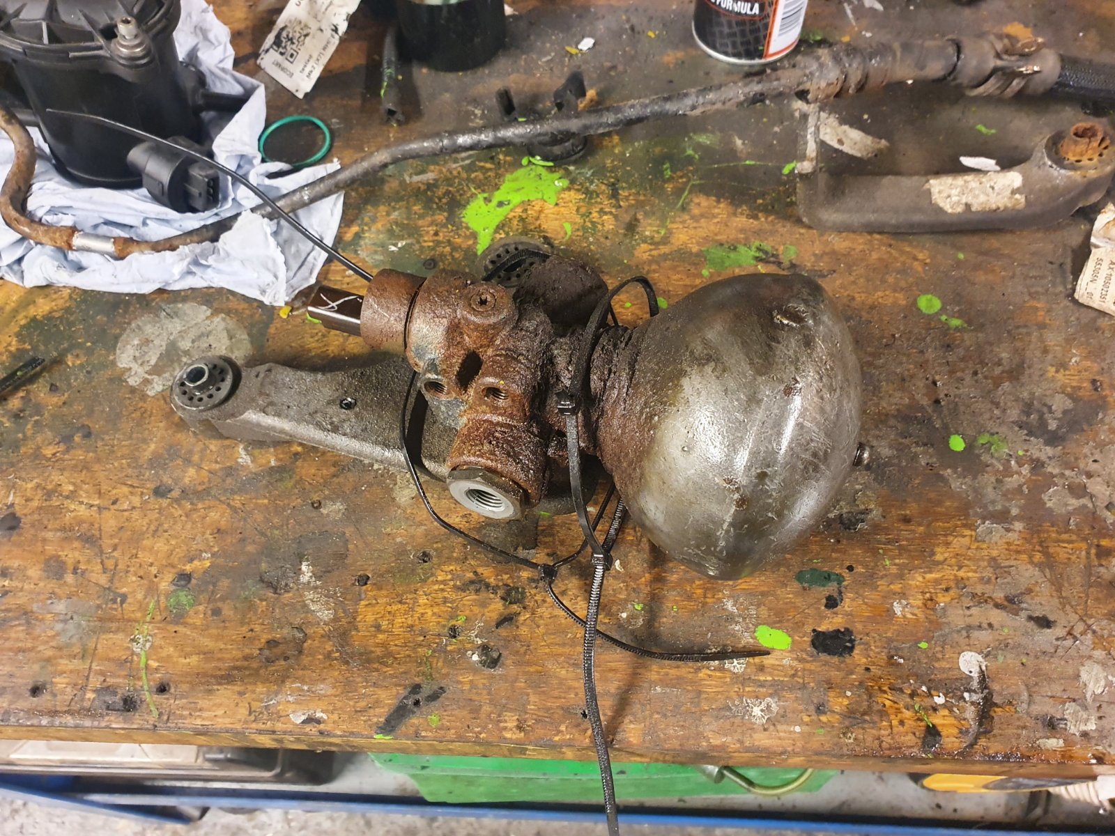

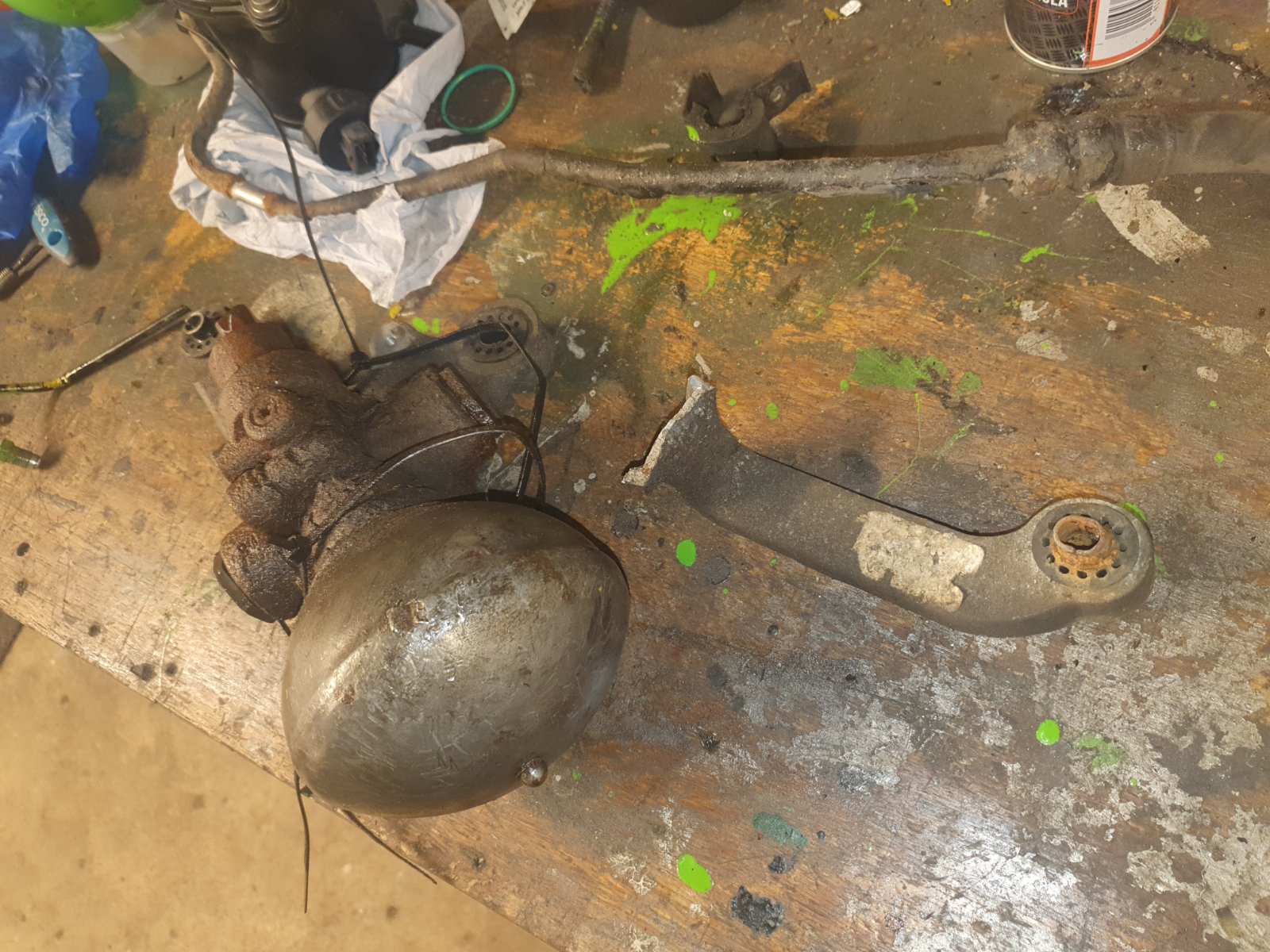

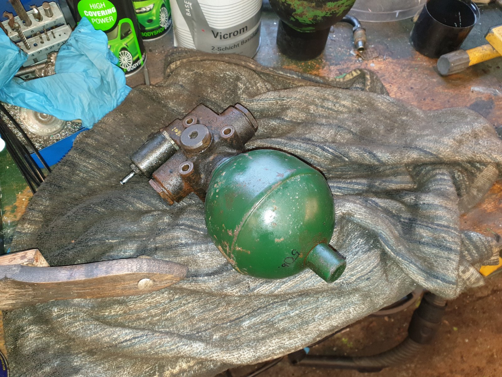

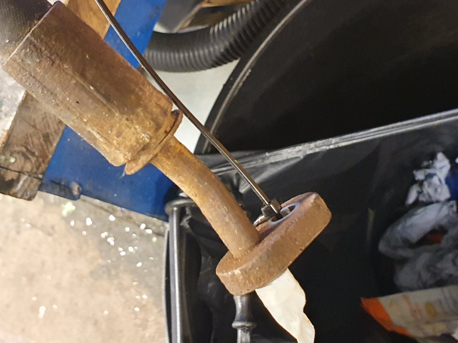

First, here's the original one, rusty, impossibly stuck sphere and the broken mounting bracket.

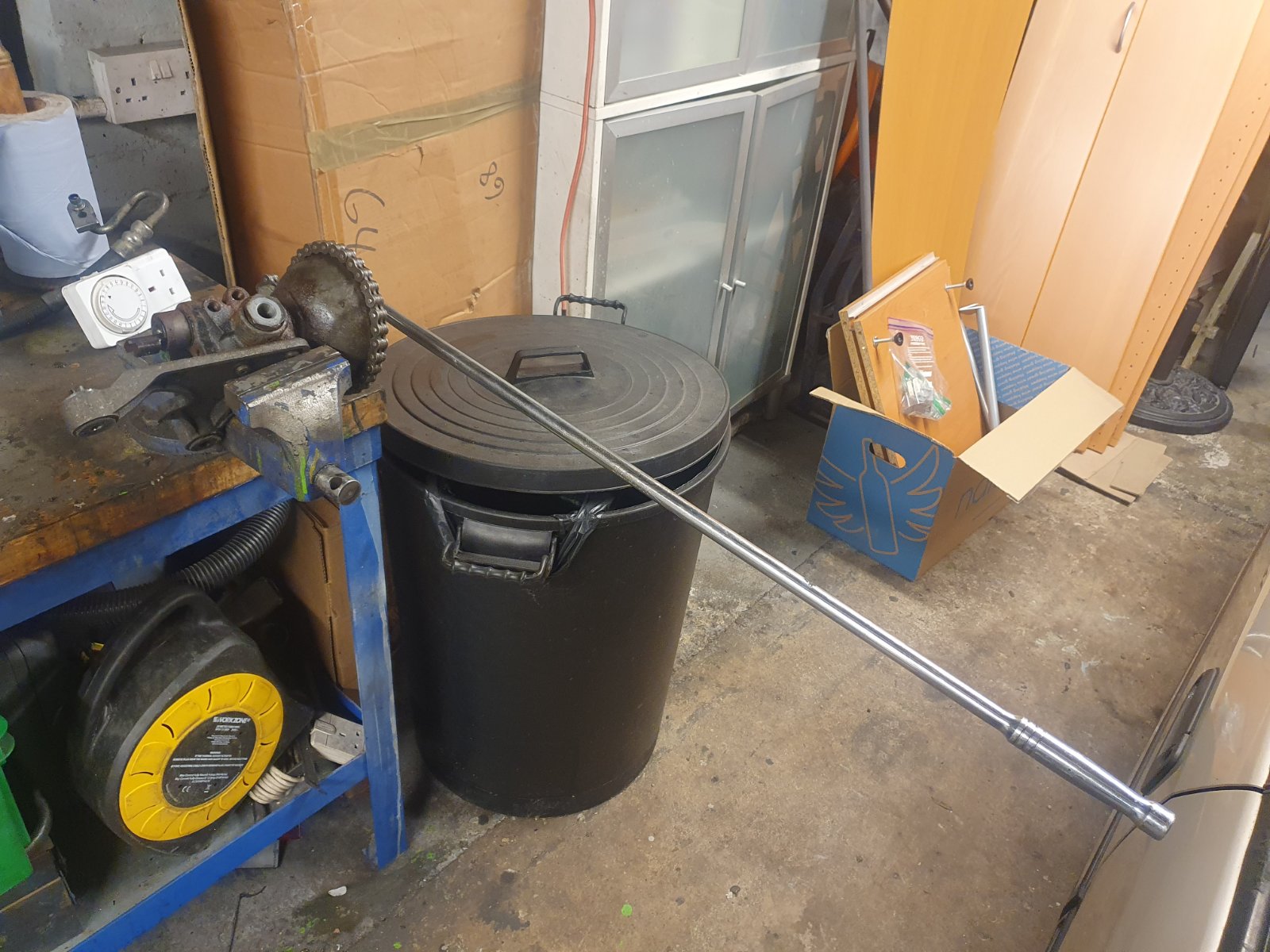

Longest bar, wire brush, soak in plusgas and it still wouldn't come off! Some idiot also left a full Xantia in the way
Little peek in and the damper valve is identical to the replacement regulator
The new regulator before it went in:

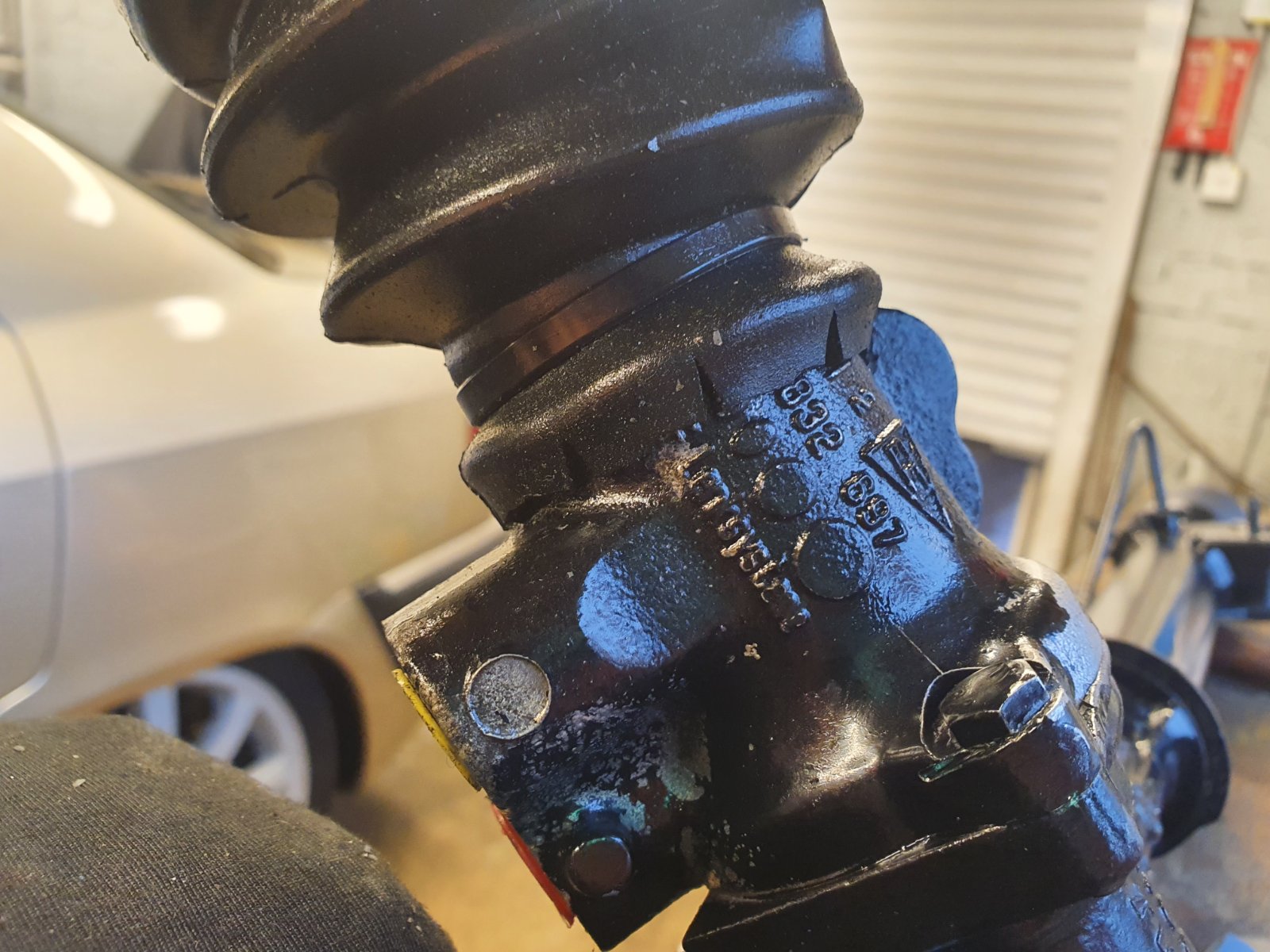

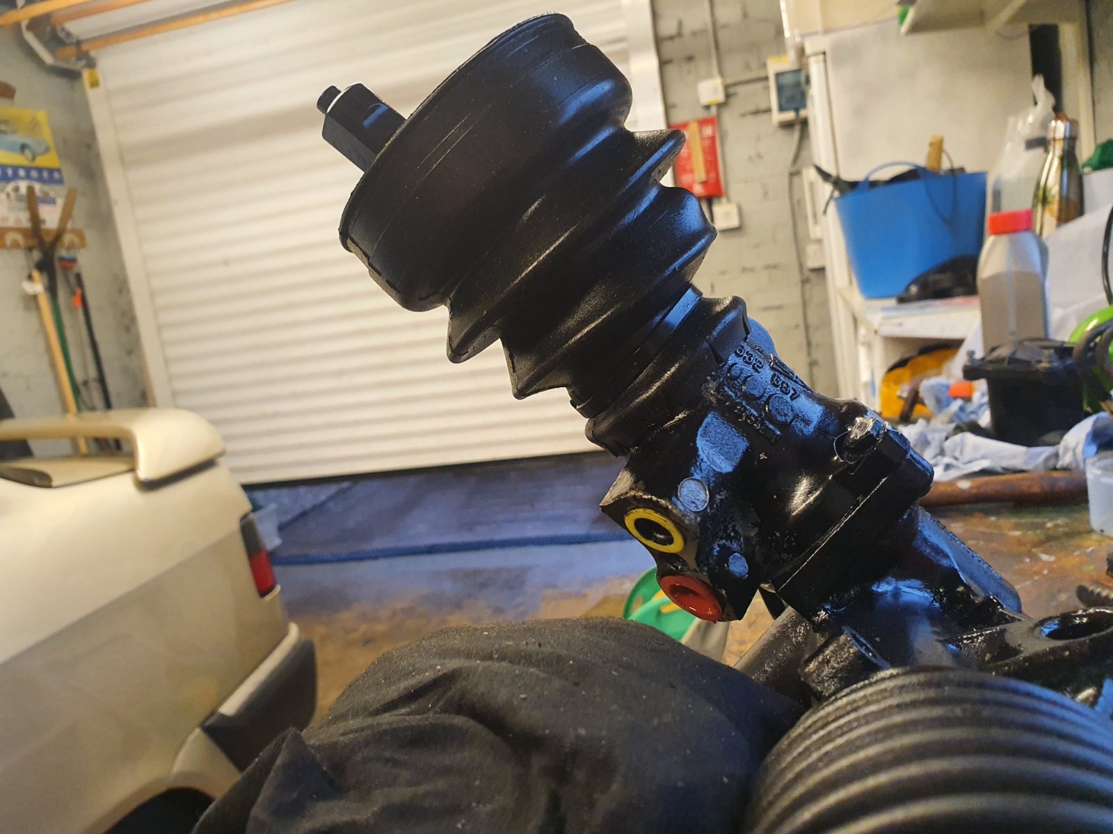

The replacement rack complete with CV gaiter added to surround the pinion valve - idea happily stolen off you guys! I also treated and painted the steel pipes on the rack because I wasn't pleased with the thin, non-primered covering the reconditioner had used.
Held by a cable tie and I didn't touch the unused boss that sticks out the side because it helps keep the gaiter on even if it slightly skews it.
kind of skewed angle of the CV boot but it actually fits through the aperture in the footwell
I really hope this CV gaiter will now make the rack last a lifetime. I was at the Glasgow Power Steering services place to return the old rack for the surcharge and lo and behold there is a C5 up on one of their ramps....
So far so good and the PAS pipe sealed well that the viton O rings were not needed..
Reconditioned regulator seen in place now
A few days now and no leaks and the steering is nice and smooth too

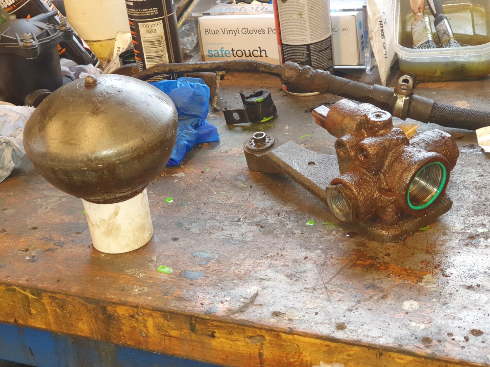

Observations on the state of bits that are removed.
The rusty state of the parts on C5s is a bit alarming at times. After a few days soaking in plus gas and moving the Xantia I got a good swing on the old regulator sphere and FINALLY it came off. I've never experienced such tight spheres as these ever.
finally the sphere came off

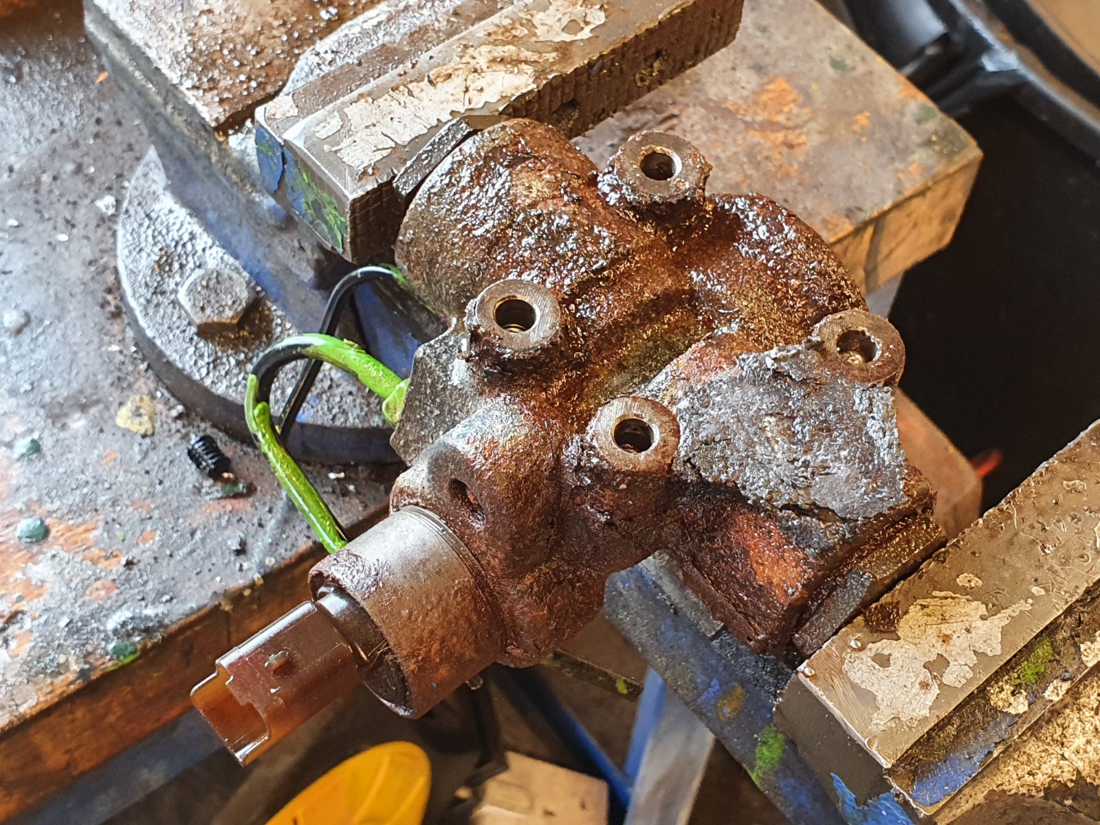

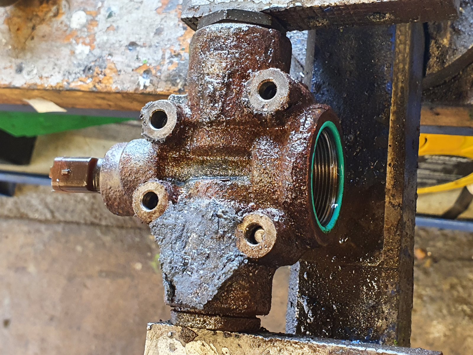

Here, you can see how rusty the regulator is. Here, the broken mounting bracket finally removed you can see the reverse side of the unit.
The lump of stuff seen growing between two of the mounting clearance holes is build up of the product of galvanic corrosion. Worse than ever - only seen this before on the Xantia rear brake caliper-to-trailing arm mounting faces. A well known problem. I feel the C5 is full of this kind of thing and it remains to be seen how the PAS pipe lasts out despite all the zinc primer and caliper paint.

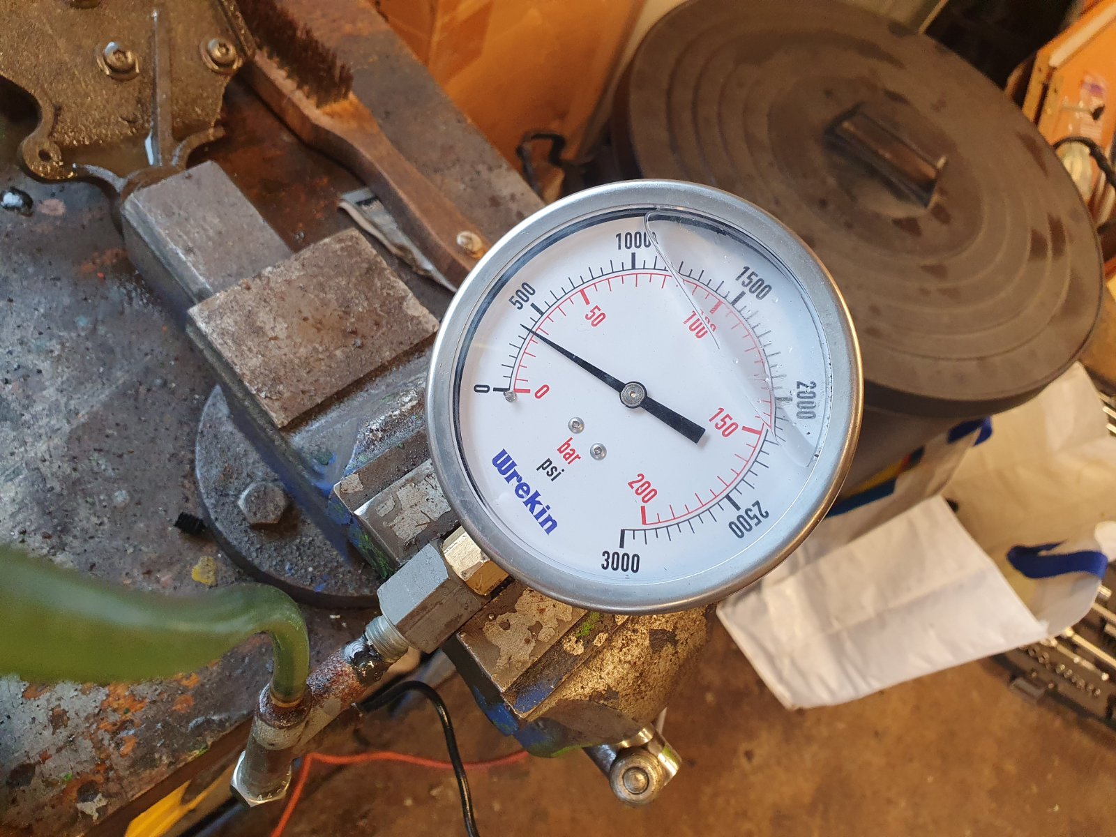

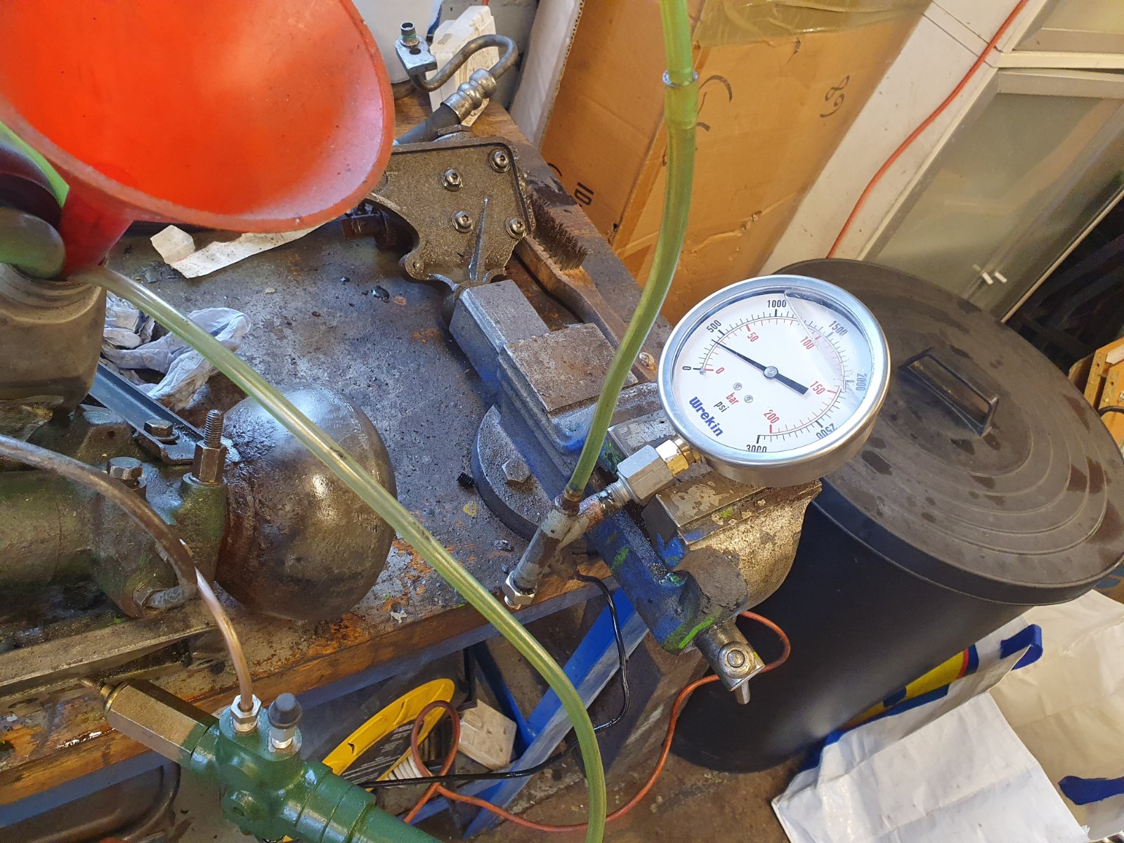

on the sphere tester
And..
25bar
25bar
It measured at only 25 bar!
This is strange given the other 2008 sphere lasting over 13 years to still have 50 bar. I suppose mine had a harder paper round! Just shows the variation in the sphere life even with these saucer spheres.
It's a bit disappointing too because my cunning plan had been to fit the two old front accumulators to the rear where they are specced at 52bar. but with this one being 25 that's not going to happen!
However, with the brand new sphere now fitted to the car with its full 70 bar the ride is noticeably incredible now. I actually considered it to be the best I've experienced before changing any spheres and that had been with a 25 bar middle accumulator! It is now incredible ride! And! the front corner spheres are only 25 bar(meant to be 50) so I hope it becomes off the scale great when they're replaced.

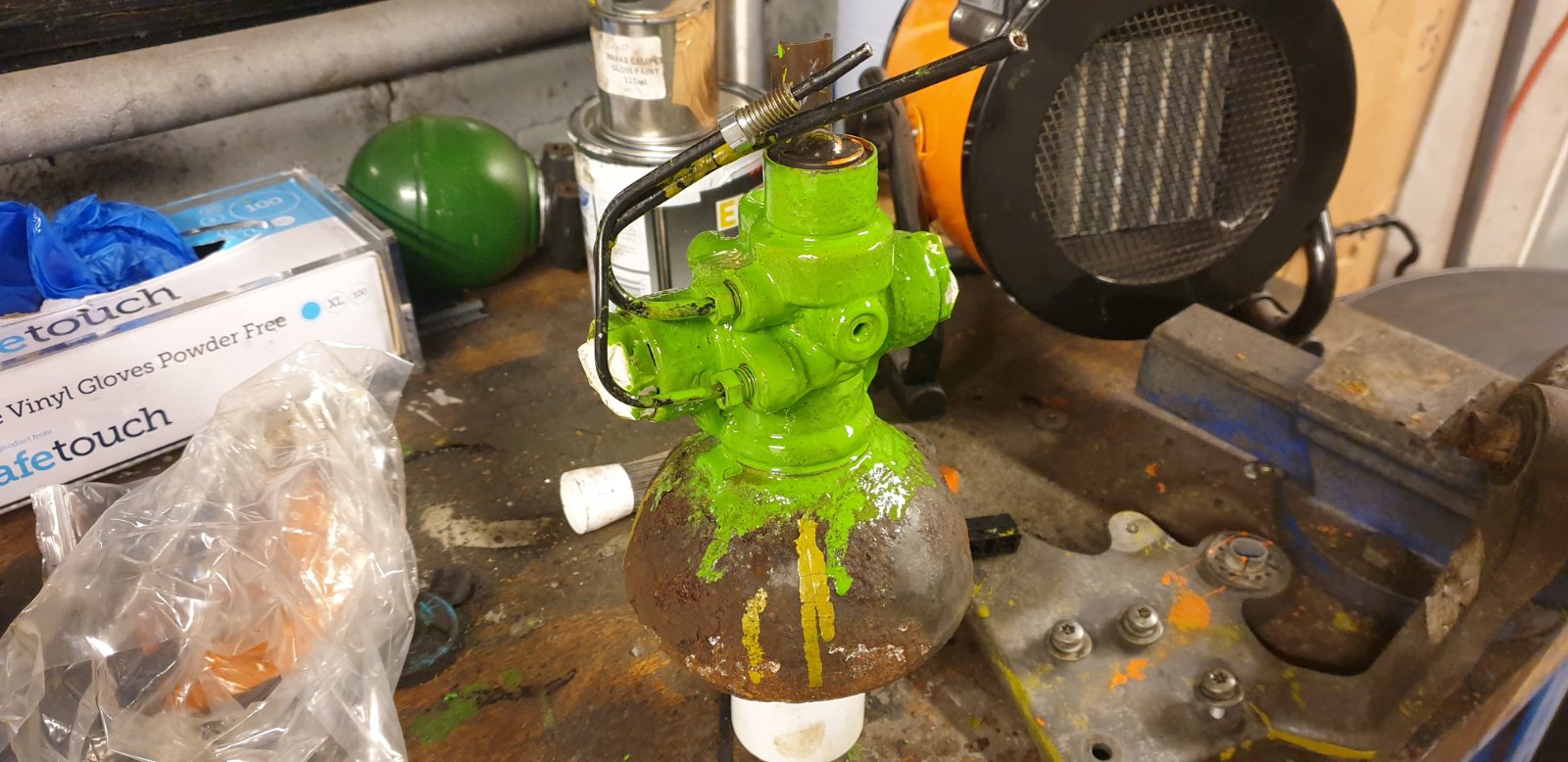

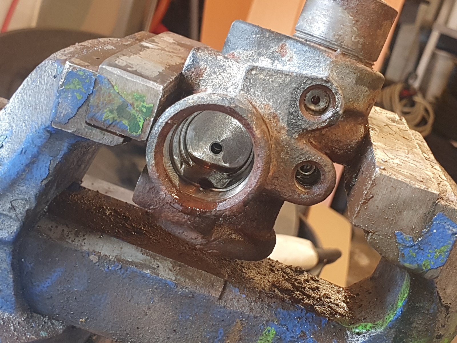

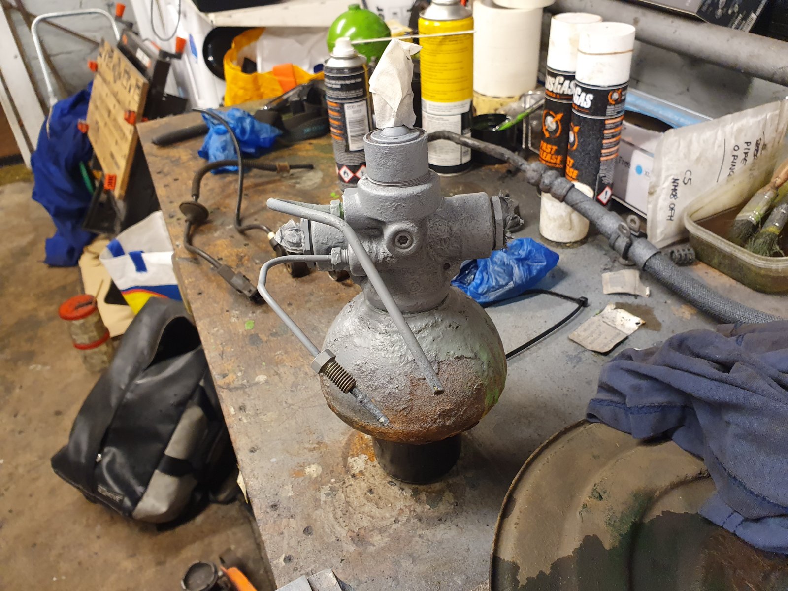

Beginning to derust the regulator

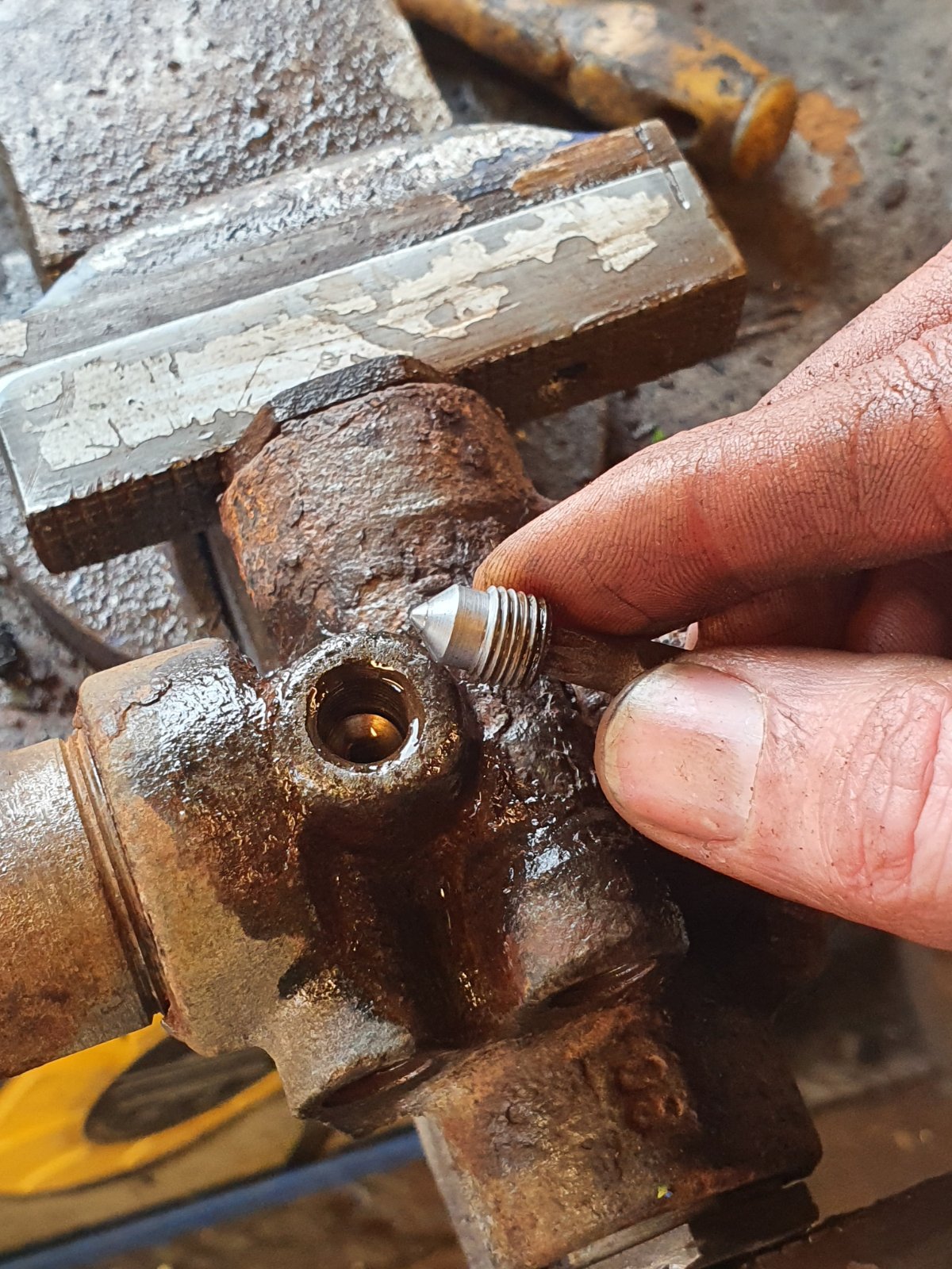

to my surprise the screw for the bleed nipple actually came out (the front unit has this plug, the rear regulator has a bleed nipple here)
Cleaning up well - damper valves out

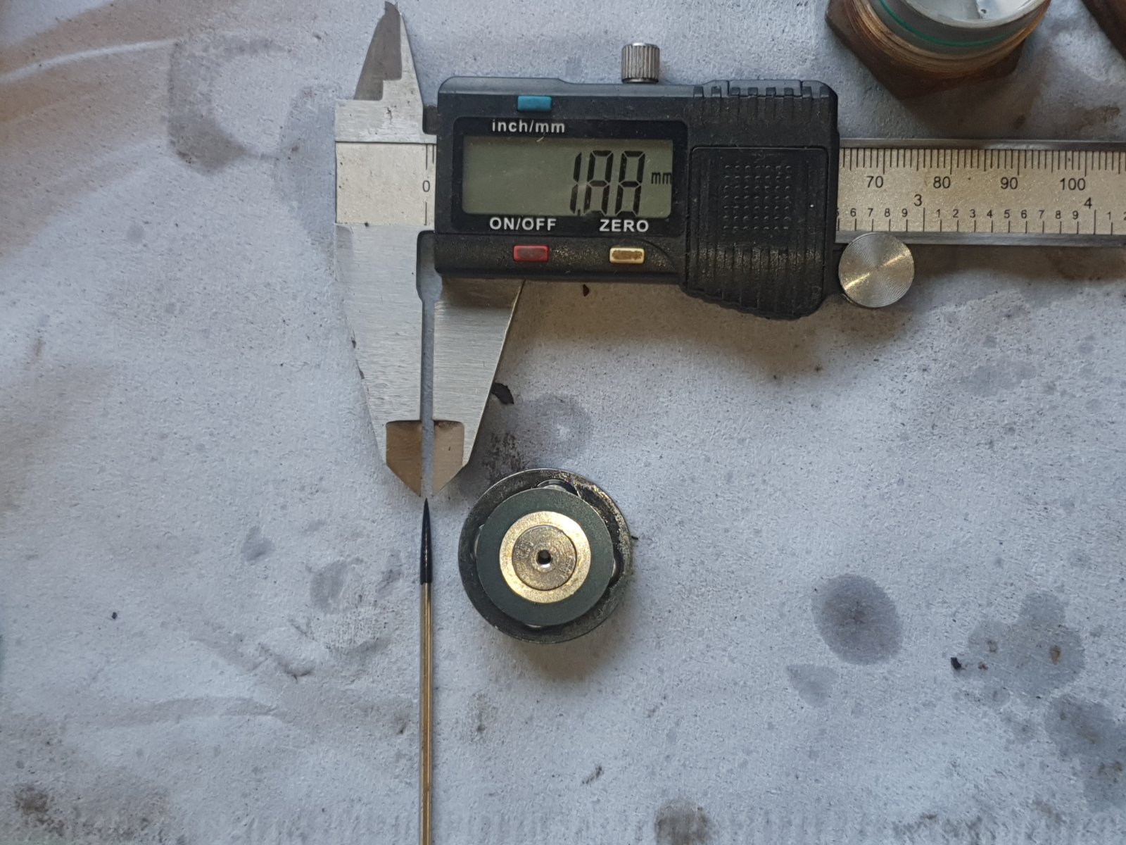

measuring the damper center hole confirms it's the same as the replacement regulator 1.8mm with '5 - 4' etched on.
a few layers of zinc primer and this regulator will be painted later on..
The plan for this unit is to replace the rear regulator that's rustier than my piano skills, with this cleaned-up front. The core unit is identical but the rear has a bleed nipple, an alloy block shape manifold to fit the two rear accumulators - this is removeable, and possibly has different damper valves for the rear but not confirmed and don't have any data on this. It is easy enough to remove the rear damper valves and fit them to this regulator for the purpose but that's all for the future.
So far, so good although the C5 is becoming like one of my old classic Citroen projects... does that make the X7 a classic now? that it's needing its bits restored? I wonder!

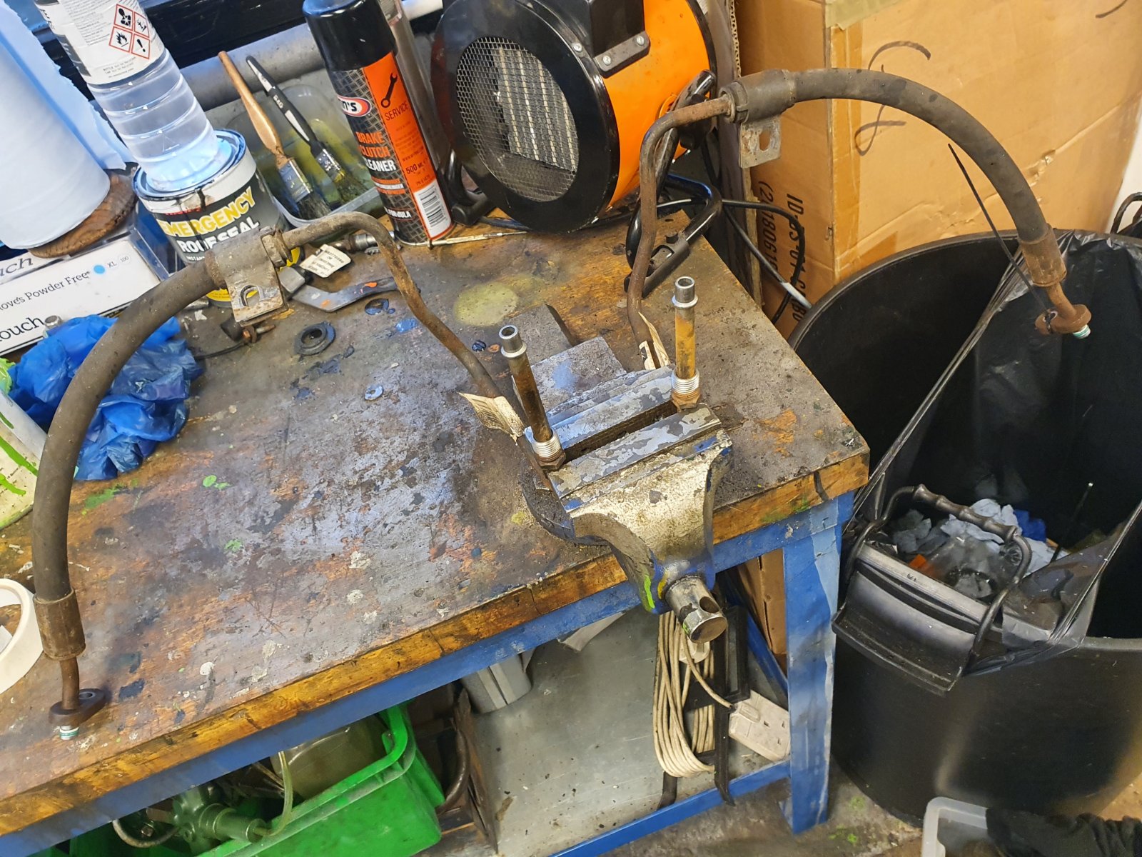

with the replacement regulator improving and heading to be fitted at the rear, the 2 rear suspension pipes to each strut are just as corroded as the rear regulator. here's a snap of how they were before Christmas:
The state of the rear regulator and pipes

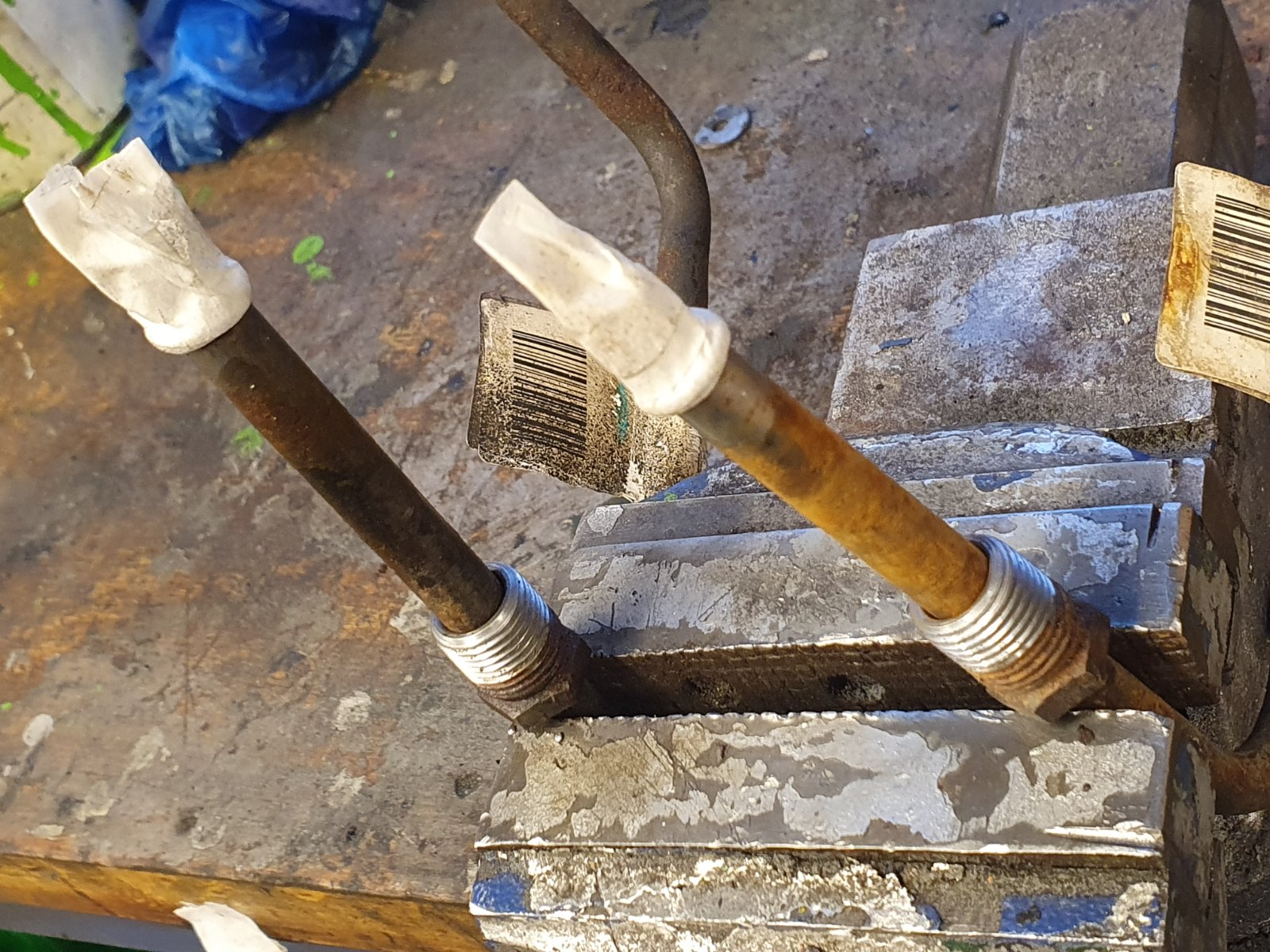

And the pipes look so bad that I was too scared to touch them. I've now learned from seeing the cut remnant of pipe on the replacement front regulator (why do breakers always have to cut pipes!) that the pipe walls are quite thick so even though very rusty I think they'll hold out.
Anyway, I have 2 replacement R&L rear pipes all the way from Lithuania and they're a million times better that the state of the ones on the car but still, they got the full bare metal treatment:
not too rusty - a little pitted
Usual treatment - layers of zinc primer

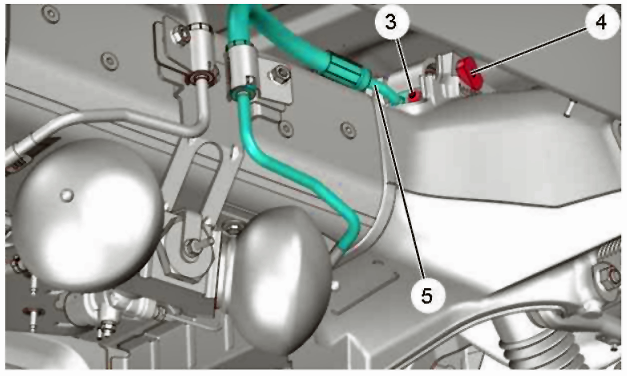

this is the arrangement - nicked off the C6 forum
So these are currently waiting on a good couple of layers of paint. Likely more of the green caliper paint although I might just paint them black hammerite. Anything to try and make them last!

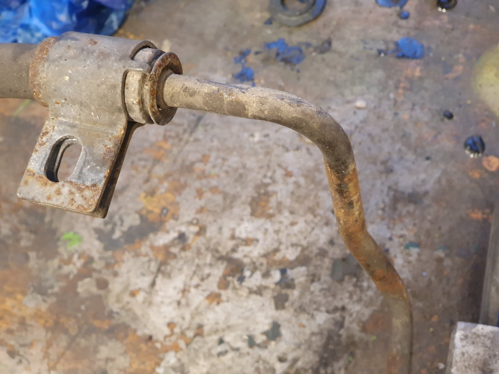

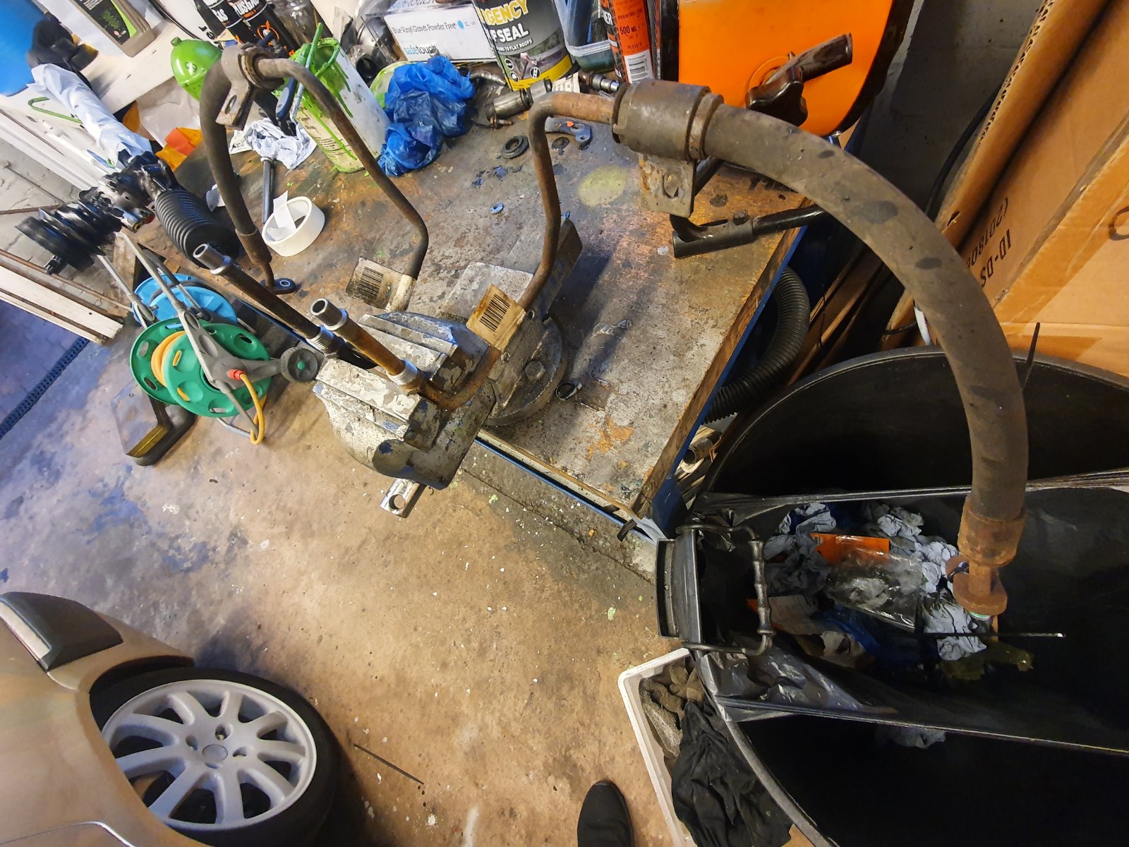

Comparing the rusty bits to the equivalent parts from the Xantia: The C5 is 13 years old and the Xantia 28 yet the difference is stark!
28 year old rear Hydractive 2 Regulator
28 year old PAS pipe
28 year old steering rack! (ok, new rods fitted)
C5 equivalent bits:
C5 13 year old rotten rack
C5 13 year old rotten front hydractive 3+ regulator. PAS rotted pipe on bench behind
..is it possible the Xantia's hardware is better made? I'm maybe being unfair to the C5 because I don't know the environment each car lived in each life. the C5 was registered in Newcastle and apparently lived there until it came here in the last 3 years. The Xantia lived in Essex the first 22 years then South Wales for less than a year then up here the last 5 years. Well who knows really just surprising how rusty some isolated C5 parts are.. not even mentioning the steering shaft thing!
