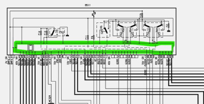

What do you mean by earthing ring? Yes I would definitely confirm pins 6 & 8 have a good earth (I would check them under load if it was me). Has this not already been checked?Dormouse wrote: 18 Dec 2021, 15:46
Within the BSI is a clear earthing ring that connects through one single point inside through connections 6 & 8 to both MC32 and MC30 If you can reach that ring inside and earth it you will test if the earthing connections are disconnected/faulty. I think it is well worth checking this earth ring

Yes but pins 6 and 8 connect up inside the BSI to the earth ring and there are multiple earthing connections going out to all of the services on the same connection - for instance R6 internally or flasher/hazard unit 23 externally via pins 13 and 14.
IF, just IF, this earthing ring is disconnected from MC30 & 32 then none of the switching earths for the BSI will work - Hence no control as well as activation

Can you confirm by earth ring are you talking about the line i've highlighted in green?

Yes. That ring connects multiple earths/returns and IF, just IF, 6 AND 8 do NOT connect to that ring there will be multiple failureswheeler wrote: 18 Dec 2021, 17:31 Can you confirm by earth ring are you talking about the line i've highlighted in green?
