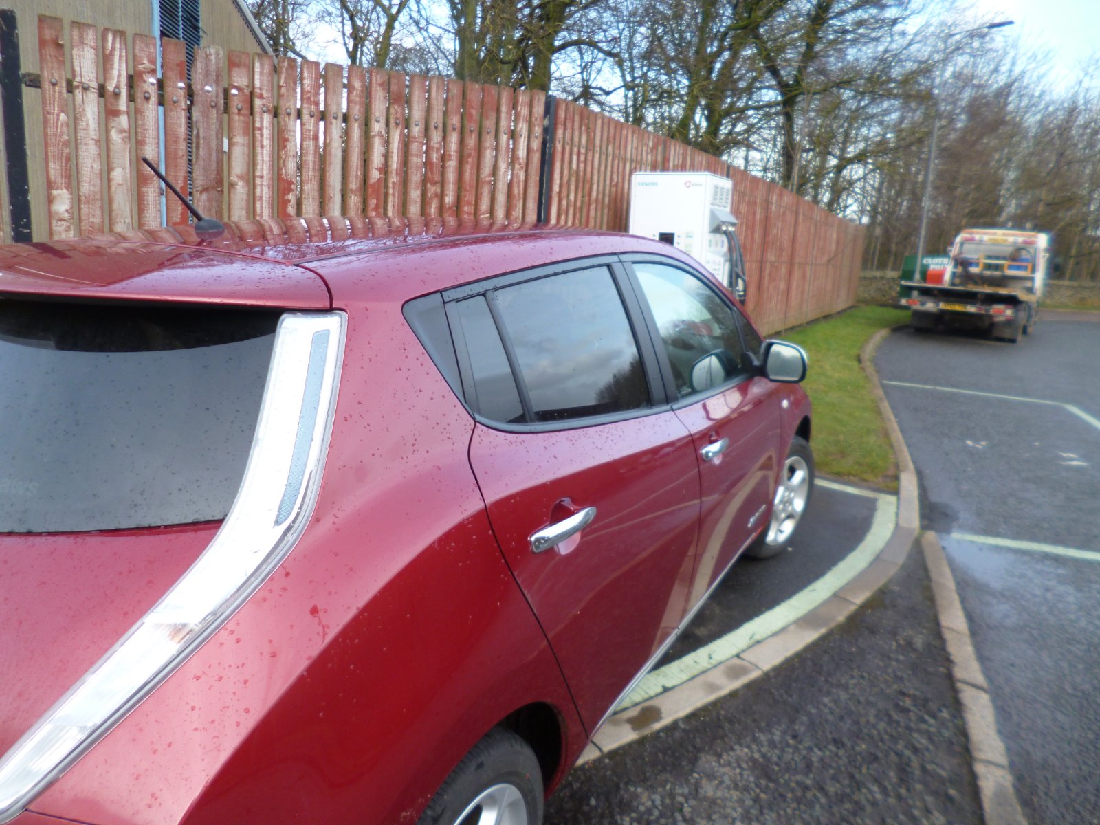

New charging point visit today......not the most scenic Lauder, Scottish Borders just past the co-op up the industrial estate road.
4,000 electric miles now on the Bargain Basement Leaf....
Running my Micra I would have had to buy 400 litres of Petrol to do that milage at total of £500 ish.
Spent £20 on Rapid chargers on one trip to Yorkshire and so far the rest had been free.
