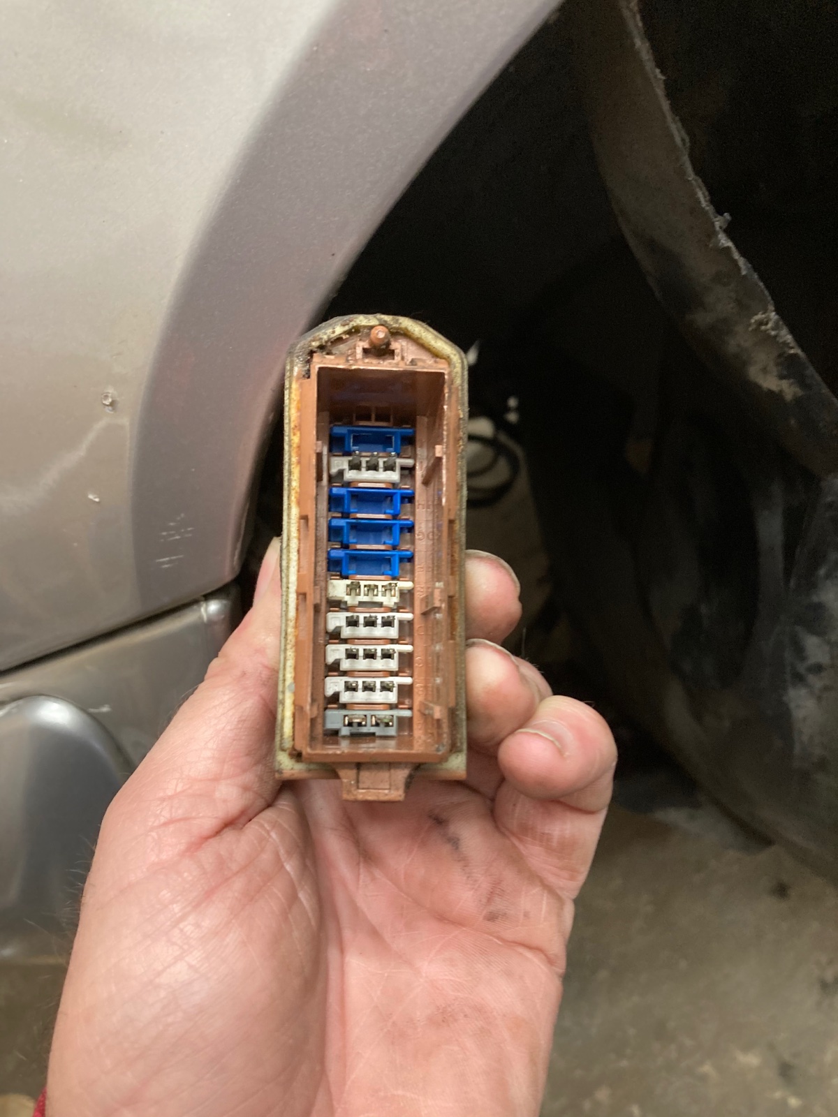

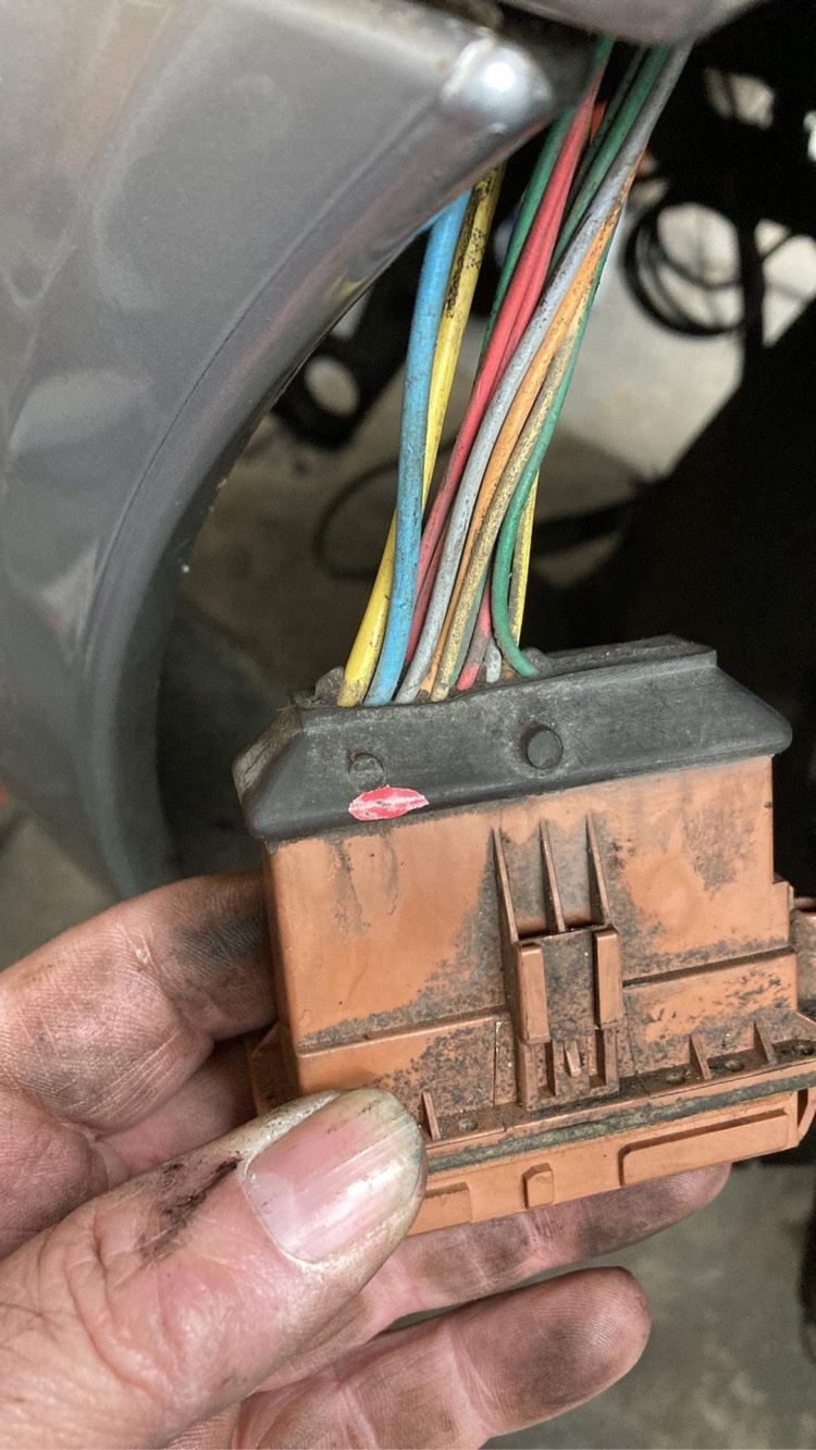

Well. I actually tracked down the high resistance yesterday in the power supply to the compressor.
IC02 the brown cinch interconnection under the nearside wing has a corroded terminal in the moulded plastic so I am wondering if anyone on here has carefully 'butchered' one of those interconnections?
I pierced the wire before it entered the interconnection and got just over 12V. The nice, bright and shiny male terminal inside measured 1.5V so I suspect that the terminal is almost severed from the wire. On close inspection, it looks like the moulding around the yellow and blue wires (which go to terminal A1 and A2 respectively) is perforated and this would have allowed water in (as I have no undertray to protect the area in front of the wheel arch liner.
The easiest way to resolve this would be for me to clip the wire and solder in a new wire and connect into the wire just before where the sheathing goes under the fuse box behind the battery. I could use spade or bullet connectors to make it serviceable if I ever need to disconnect it (with a sacrificial bit of heatshrink tubing to protect the bullet join). This would, of course, be the easy and obvious solution.
However, me being me, I am wondering whether it is worth gradually dremelling the plastic away on the corner of interconnection IC02 down to the wire. Does anyone know if these interconnections are resin filled or voids internally? If there is a void, it would be still a task. I doubt that the male termination is removable. Certainly not easily. I could then rebuild the corner up using plastic weld.
Am I completely nuts?

Apparently these Cinch interconnections are apparently accessible?
Has anyone deconstructed one? Must investigate all options before I take a dremel to it. I'm pretty sure the 'cap' is moulded to the top.

Now! I had spotted your comment earlier in the thread about the wires to the drier BUT...
Mine has 3 green wires and one white and they are ALL the same diameter so I cannot work out which the signal wires are readily.
The connector is ICO2 which sits on nearside inner wing and is not the Bitron connector which I believe is under the nearside headlight.
The connector I have identified is definitely corroded internally as I have 12V to the wire but only 1.5V to the terminal inside it. This is one fault with mine.
Once I've repaired that, I need to work out how to bridge low pressure out so it fools the ECU.
