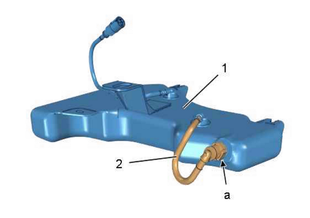

There is a white plastic fitting in a recess in the Eolys tank cover, does anyone know what you do with it, does it twist, squeeze or lever?
Thanks
Thanks
- x 6948
Re: Does anyone run a C5 X7 diesel estate?
This is the additive tank Peter:
You uncouple the pipe (2), by pressing in the sides of the click fit connector to release shown at (a)

Thanks again, ignore the last post it was just a locating peg.
Do I have to take the tank out to fill it? I read something about an overflow connection?
- x 6948
No, you fill it in place by gravity.
