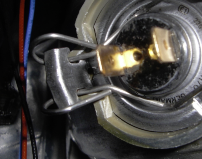

This is the swine spring clip. Looks huge here, but as tight as a crab's ar*e in reality to get half a hand in that won't allow you to reach the top of the spring clip.
So once I've determined if this is a push down and to the side or other, I will attempt it again - trouble is, looking in a small LED mirror - everything you do is back to front and opposite - which of course really helps - not!
If I do manage this, getting the new one in will be just as bad I can see. So will try again in the morning.

I find using one finger to unlatch one side (push toward headlight then outward) first is the only method that works for my large hands as it's impossible for me to manipulate both sides of the spring at once. This unloads the spring tension so the other side comes away easy enough and you can then lever it out the way so the bulb can be removed. Whatever you do, don't allow the other captured/levered end to unclip itself and fall off! Ask me how I know!!
Refitting is also a guessing game until you develop the muscle memory from repeated failures of refitting mis-orientations. At least, that's my experience of those spring clips.

I’ll advise the skin graft surgeon to be on standby, thanks Mike, that at least will save some time in determining how to get the *#%/@& off.

Mike is right. Push down one of the curved 'ears' at a time (not both together), and swing outwards to unhook. Retaining clip then goes loose, and the bulb can be removed.

I also think the issue is that this was a new headlamp we had replaced last year, so the clip is really tight. I could just about touch the top with one finger and that's about it.

If it was a new light last year, then the bolts should come out easy enough - worth dropping it off, as then it will be easier next time it goes. Should be able to get away with just unhooking the end you need to get at.

Right, will Messrs Chris & Mike please go to the back of the class and stand on the naughty chair.white exec wrote: 02 Dec 2018, 08:43 Mike is right. Push down one of the curved 'ears' at a time (not both together), and swing outwards to unhook.![]()
So after waiting for a break in the rain and after my trip back from town (see that fiasco below) to get a set of H7 bulbs, I decided to attack the job again following the advice of my learned colleagues above. After another hour of faffing, it turns out that it isn't a push toward, nor a push downward - it's a lift up and sidewards away!
So likely a design change or just different on this MK II facelift version I can't say, but at least they are both done. The worst one was without question the right hand side. The rigid expansion tank pipe blocking everything across the entrance to the recess of the headlamp. The one I thought would be the hardest was the left side, being as the battery and the air intake pipes and fusebox were in the way, but this turned out to be a doddle and I had it done in 5 minutes!
