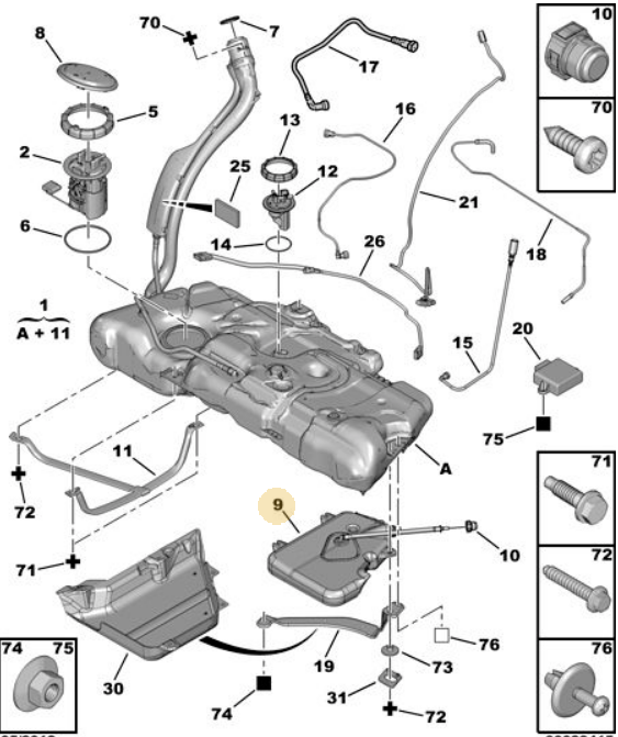

Ok, so the fuel additive tank IS available from Citroen, which should contain all the components, as the additive pump cannot be separated from the tank (note the pump is in the additive tank, but the additive injector is in the fuel tank). Item (9) below Part No: 1500Y7, priced £283.73 inc. VAT.

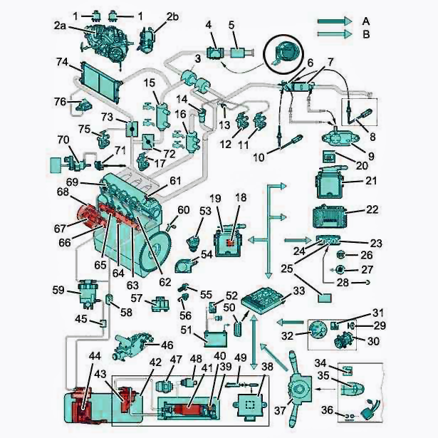

For information the following is the fuel system and components for your engine. You can see at the bottom of the diagram, 39 (additive Tank), 40, (Low Additive Level Sensor) and 41 (Additive Injection Pump).

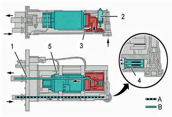

A more detailed diagram below shows the Additive Level Sensor (2) inside the Additive Pump:

It's a 3.5 additive tank John. It has the same part number (1500NK) as the following C5 X7 Diesels in the table below.
Each engine has different factory-filled levels - as each has a different engine ECU and engine capacity / EURO standard.
