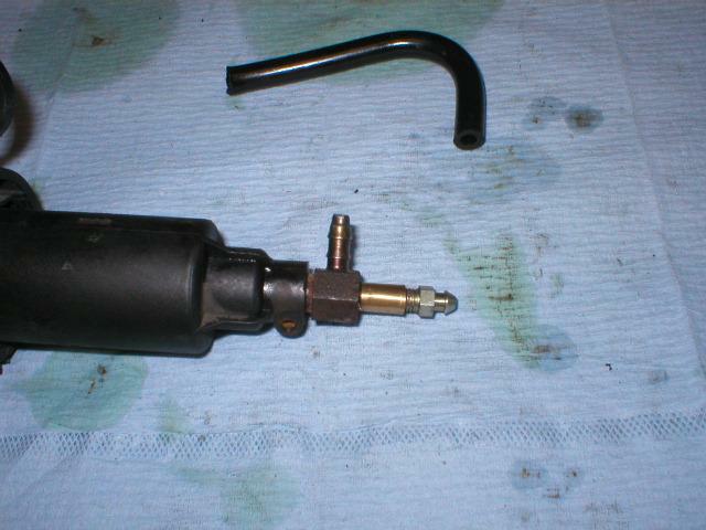

How to bleed a 'sealed' Xantia Hydraulic Clutch
Models covered:
S2 HDI 110
*please add,some xm's etc,struggling already Jim, haha*
Symptoms: Clutch pedal on the floor,useless.
This is from my own experience, Xantia HDI 110, but may cover many others.
Car drove fine,then went BANG.No clutch.Mate had to crash the 'box to get home. When we got it apart, the release bearing had separated from the clutch plate..total destruction,wrecking the slave push rod as a parting gift..
CitroJim explains here:
The whole clutch hydraulic assembly is one of those "sealed for life" jobs. If bought new, they come in two parts, separated at the blue bullet connector. You install both ends and pop the bullet together and that's it. job done.
Replacing the master cylinder is an absolute dockyard job and to be avoided if at all possible
Problem is, the blue bullet won't come apart again and to renew the whole assembly will cost the debt of a small nation. They are very expensive so having a go at bleeding is worthwhile...
The clutch slave cylinder is a push fit, (bayonet style),into the gearbox. Here it is seen from above,the green arrow shows it,and also points to the front of the car.
There is no bleed nipple on it.
So if your pushrod has come out or you've lost pressure/fluid etc..how on earth are you supposed to bleed it?
Here's how, quite simple really:
Take the clutch slave out of the bellhousing.
Take out the pin of the fluid pipe union which holds it into the slave.We had to grind the head off the pin,although you might need to drill it etc.
Place the slave stood up somewhere and fill with fluid.
Then, put a clear pipe on the end of the cable nipple, (which fits into the slave).
Take the top off the small reservoir near the bulkhead,put plenty rags round it.
Syringe fluid up the pipe untill the reservoir is brimming.Take off the clear pipe and wet connect it to the slave,trying not to lose any fluid.
Still next to no travel/clutch?
Take the pipe back off the slave and hold it near, tight, and wet bleed from the pedal end.
This worked fine for me,took half an hour,if that,with an assistant.
Here's a more detailed description which nearly got a complete novice back on the road:
Take the slave out of the bellhousing. Disconnect the fluid pipe again whilst trying not to lose any fluid.Plug the end of the fluid pipe.
Place the slave vertical somewhere. Get some thin,clear pipe,i used some fish tank pipe.
copied your pic and it's gone tiny! anyway:
Stick the clear pipe over the metal nipple on the end of the fluid pipe,arrowed in the pic. Take the top off the bulkhead reservoir and put rags round it.Syringe fluid into the clear pipe which should expell most of the air out of the reservoir.Should get plenty bubbles,then carry on untill the res is full,brimming.
Take the clear pipe off the end of the fluid pipe nipple and quickly place your finger over it,so no fluid can get out.
This is where the mrs, or assistant comes in:
The pedal should now be in the correct ish place,ie,in the middle,not on the floor.
Part 1.) Hold the full clutch slave vertical. Get the mrs to gently press the clutch pedal while you still have your finger over the end of the pipe.You should feel pressure.Then quickly connect the fluid pipe to the slave,whilst fluid is being squeezed out,so air can't get in. When connected,make sure the bulkhead res is full,and the mrs can then let go of the pedal. Put the small pin back in the slave (holding the fluid pipe on). Put the connected slave,with its pushrod,back in the bellhousing.
You could try the clutch now,but i found air was still in there so wifey comes in useful again:
Part 2.) This can be a bit tricky,as it's under pressure,but a bit of persistance and swearing works well:
Keep the bulkhead res full.Take the pin out of the slave whilst holding the metal fluid pipe end,do not press the pedal,as the pipe will shoot off the slave.
With the mrs gently pushing on the pedal,let the pipe out of the slave very slightly,while you push hard against it (i think i used a big bar in the end,wedged against something and the metal connector). Fluid should pi$$ out.While mrs is on the downstroke,force the connector back in.Once it's in,the pedal can be released. It's just like bleeding the brakes,but we're manually moving the connector in and out of the slave, instead of turning a bleed nipple
You may have to repeat this a few times,keeping an eye on the bulkhead reservoir level.
You can tell if it's working as the pedal gets more of a spring in it.
In the end, CitroJim saved i3's day
I'm presuming you now have Jims' modified elbow in your slave cylinder,as in his pic:
..with the bleed nipple screwed in,straight,flush, not cross threaded or owt... And the plastic pipe heatgunned onto the ridged/barbed connector.
Have you ever bled brakes before? Same ish proceedure.I only ask because your mechanicing skills sound quite limited, and part of this proceedure could be tricky...
In theory you should always keep the master cylinder full.Screw the bleed nipple in.Bolt the slave in the g/box.Put a clear plastic pipe over the nipple with the other end in a clear glass jar/milk bottle with brake fluid in,so air can't get back in. Then,bleed it from the pedal end,with someone to work the pedal.Only open the bleed nipple on the downstroke..then tighten before the pedal can be released.Loads of fluid/air should pump through. When the fluid is clear..in the pipe into the jar..it should be free of air...
Still might not be though,so you'd have to carefully take the slave out,without pressing the pedal,as the rod would shoot out...and push the rod inwards,whilst working the bleed nipple,expelling any trapped air in the slave itself.

Hi Have a March 1999 2.0 HDI Xantia. The clutch went right to the floor and the hydraulic fluid level was very low. Then i pulled the clutch back and now it seems very hard to push towards the end and cant be pushed fully. The gears also dont change with the engine running.
1. Does it indicate that the slave cylinder rod is out?
2. Why is the clutch being hard to push now?
3. can this newer bleed type cylinder fit my car?
http://www.mister-auto.co.uk/en/slave-c ... JK121.html
4. Does the whole clutch kit necessarily need changing or changing the clutch release bearing could be enough?
