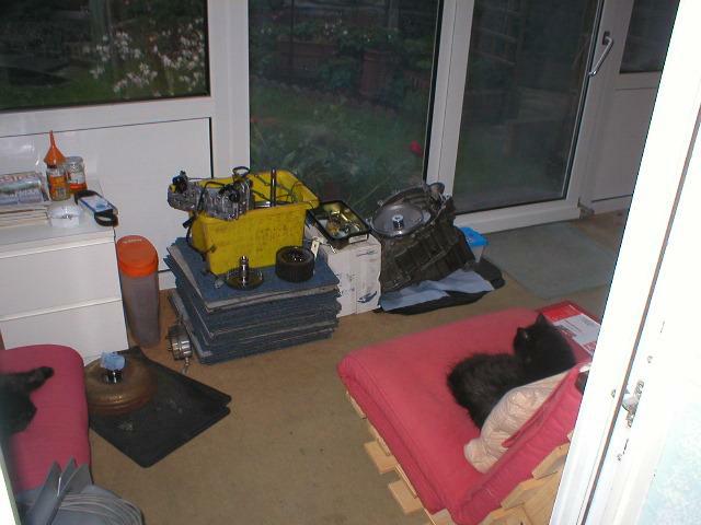

Not too much achieved today on the V6 project as time is short. I have to collect the junior SWMBOs from school this afternoon and then take them clothes shopping. I'm also hoping I'll have time to slip into the Vodaphone shop and look at the possibility of getting a new mobile phone.
Soeaking of the junior SWMBOs, it is my daughter Robyn's last day at school today and she will only now return to sit her remaining GCSEs. In September her world changes as she begins sixth form...
I'm still cleaning bists up and today I attended to the cooling system components. Back along I reported that the cooling system was full of something nasty; something used in an attempt to possibly seal up a leaky heater matrix. Today I found out just waht damage it did
The expansion tank was first on the list and this was full of the stuff and it ran out in great clods during flushing
Some of the smaller ipees were clogged with it and worst of all, the old transmission cooler was totally blocked with it. This may well have helped to kill the gearbox and my recommendadtion stands never to use any sort of rad sealant on an automatic with perhaps the exception of the Forte product.
Looks like it was a blessing I killed the old radiator getting the engine out as it too must have been somewhat clogged.
Although the "bubble breaker" was substantially clean, I was worried at how much of this gunk was in the engine itself so I cracked open the block drains (one for each bank of the vee) and was pleased to not the coolant that drained was clean.
I also removed the thermostat (it's a strange old thing on the V6) and saw the engine internals look perfectly clean. The V6 waterways are wide and unlikely to clog up. That said, as soon the the engine is in a suitable position, I shall give it a thorough flushing before the radiator and replacement transmission cooler is connected as I cannot risk any of this remaining stuff (whatever it was) getting trapped in the transmission cooler.
I think now, fingers crossed, that everything is now clean and the days of painting things with white spirit and blowing them clean and dry with an air-line are now behind me. Interestingly, although I got hold of a can of Gunk, I still find good old white spirit is still my degreaser of choice when used in conjunction with an air-line.

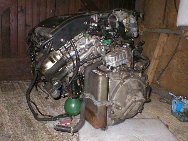

I'm now well into the final assembly bits now and this evening saw all the engine ancillaries refitted and the gearbox ready to be lifted up and be rejoined onto the engine
Here is the current state of play...
After the gearbox is on (tomorrow hopefully as I need to use my crane), there is little to do before lifting it all back into the car
I can do odd jobs like fitting the pressure regulator block and accumulator sphere ready but I guess my time will be best spent loosely reassembling the remains of the spares gearbox currently cluttering up the conservatory and annoying the cats
Not much of it is really a lot of use and I'm not sure what to do with it. I guess I'll store it somewhere; you never know...
There are a few minor jobs like de-rusting and painting the battery tray and de-rusting and resealing the gearbox ECU that got rather sad-looking sitting for so long under the battery tray.

Not a lot of progress last evening but I did get the crane out and mate the gearbox back onto the engine.
It's a pretty precision job and the two guide pins supplied with the kit of special tools are pretty much essential for the job.
After fitting the pressure regulator and installing the new thermostat (when it turns up), that'll be it. Job done until the big lift back into the car

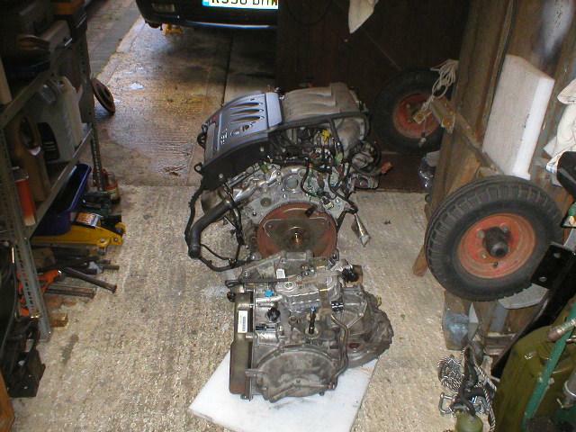

Good work achieved this evening
The engine and gearbox (with the excepting of the exhaust headers) is now all reassembled and ready to drop back in the engine bay..
More soon but in the meantime here's a picture of the reassembled engine and gearbox now just waiting in the wings for its big moment
