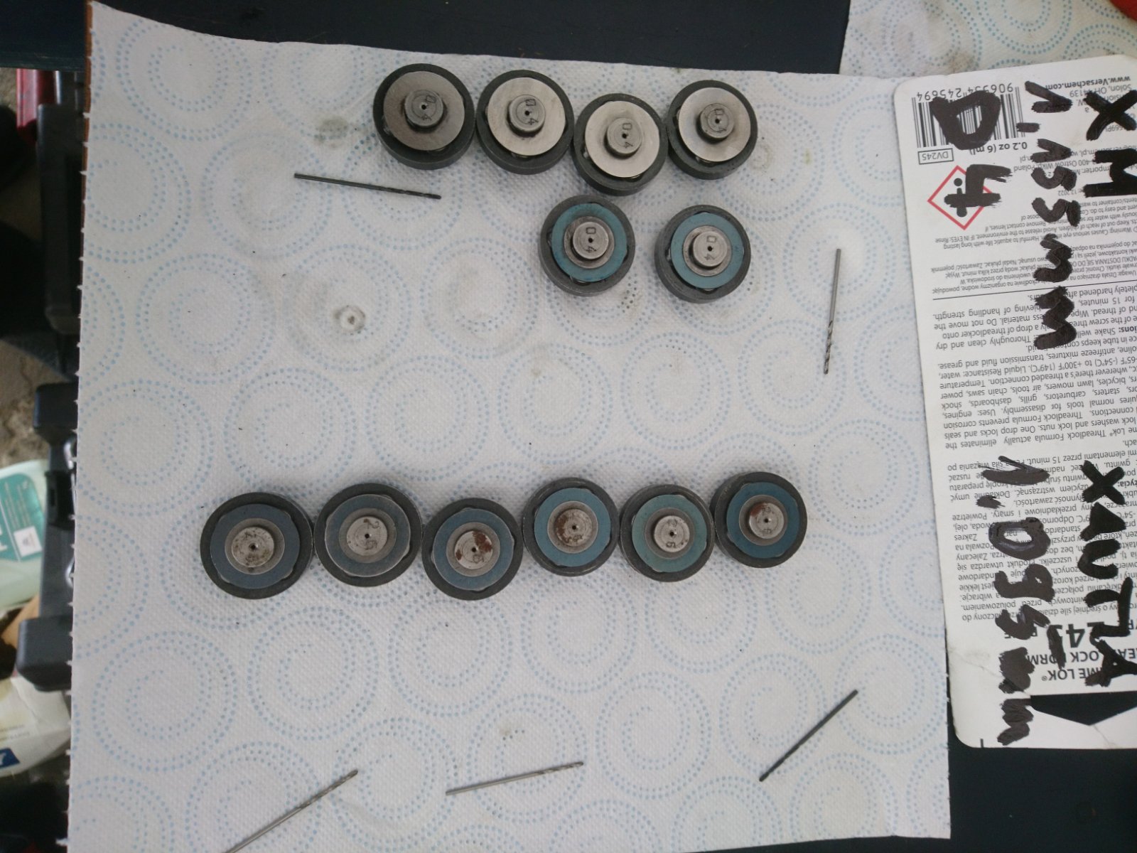

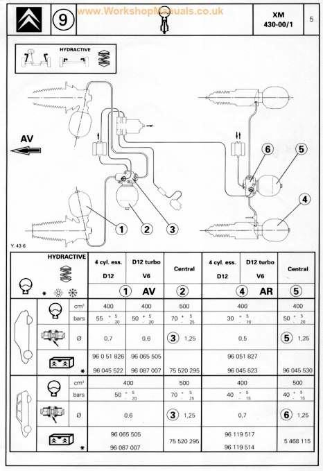

I found all the chokes from the HA block that I have. 5 pcs XM and 3 pcs Xantia. I measured accurately and XM has 1.15mm chokes in the block with the designation D4. It has 3 plates and I had some older HA block bought with 2.5 plates but also D4.
Xantia 3 HA blocks. They all have 1.1mm and 2.5 plates. Mark 26.
Maybe there is a mistake in the book and it was supposed to be 1.15 instead of 1.25mm? The rear HA block that I used was originally from the factory as it came out and there were 3 plates with a hole of 1.15mm.

Don't think a misprint. This is the full workshop manual page:

I don't know why this doesn't match with the documentation. I still have a question.

From memory, the 3 ports clustered together at one end of the valve are all internally connected together, so it doesn't matter which one you connect to. Apparently, connections to these can vary from Xantia model to model, depending on ease of manufacture. Can't remember now which port I actually used on the XM here.

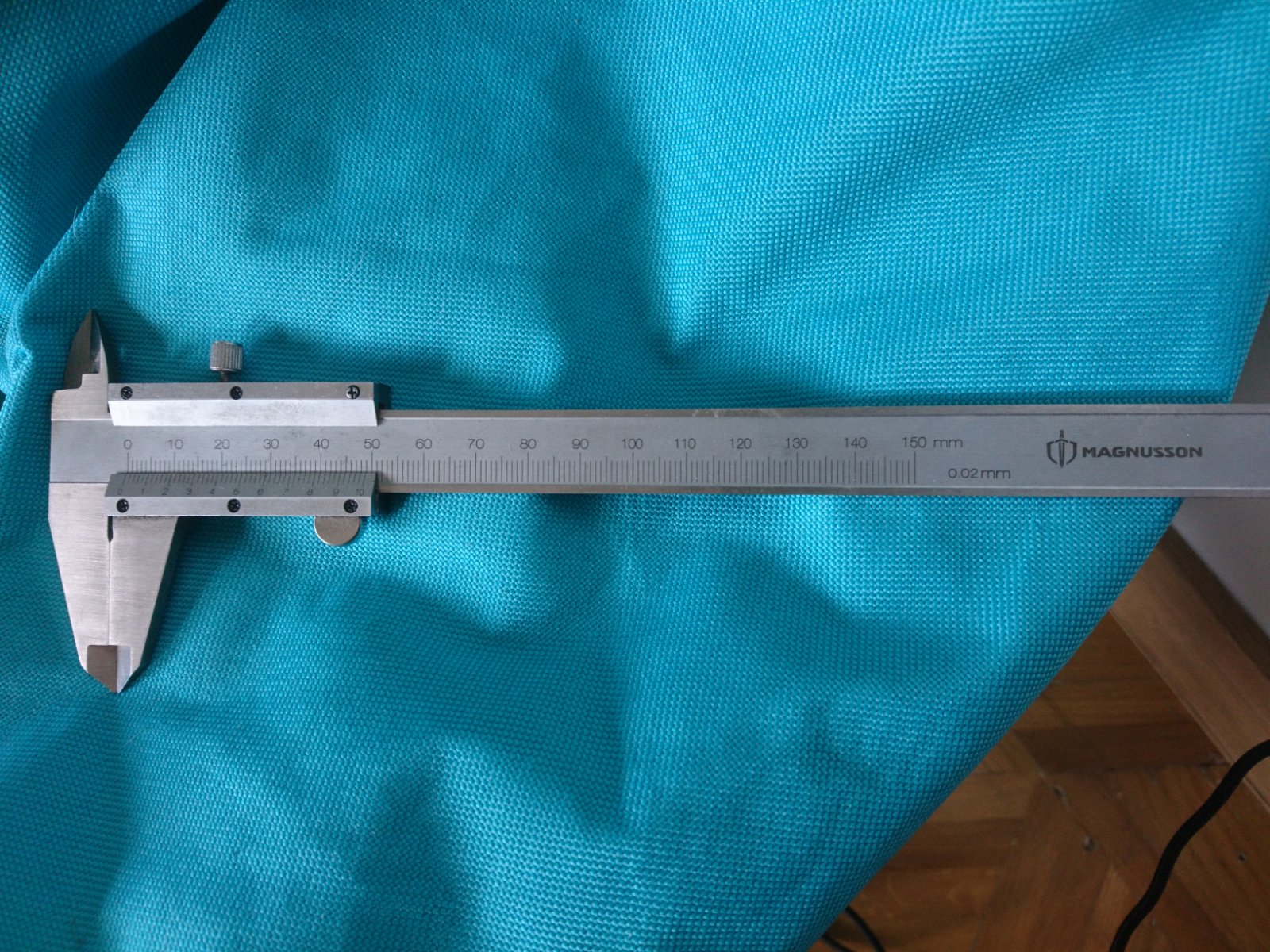

On the orifice measurement, I do find that measuring accurately to 0.1mm or less can need several measurements, especially with a digital vernier. Micrometer is more consistent. Some tiny drill bits not perfectly round, either.
The dotted numbers are sometimes difficult to read; D4 is probably 04, and 5 and 6 can be a struggle.

Yes they are connected, that's why I left the cable as it was, but I preferred to askwhite exec wrote: 17 May 2020, 07:23 From memory, the 3 ports clustered together at one end of the valve are all internally connected together, so it doesn't matter which one you connect to. Apparently, connections to these can vary from Xantia model to model, depending on ease of manufacture. Can't remember now which port I actually used on the XM here.
I had several drill bits of the same size and their size is confirmed by an exact caliper up to 0.02mm. Unfortunately, I do not have a micrometer, but I think that the caliper should determine this enough with these differences.
D4 is probably 04 as you write

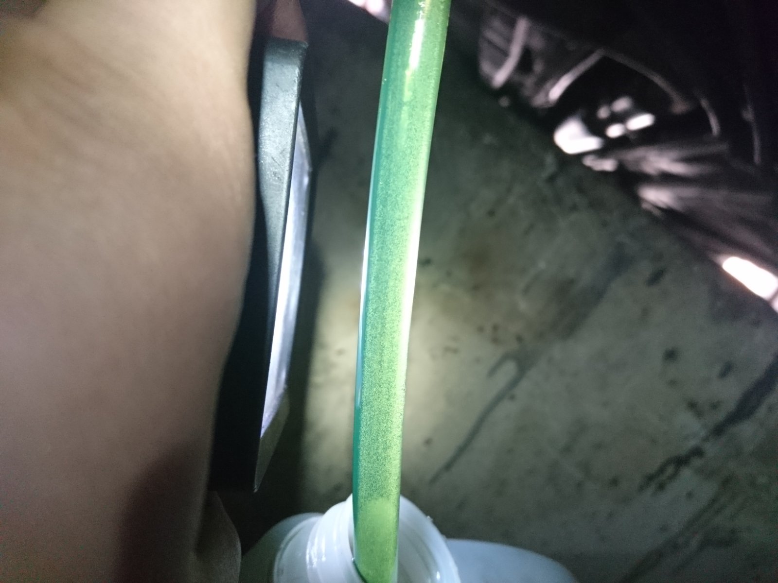

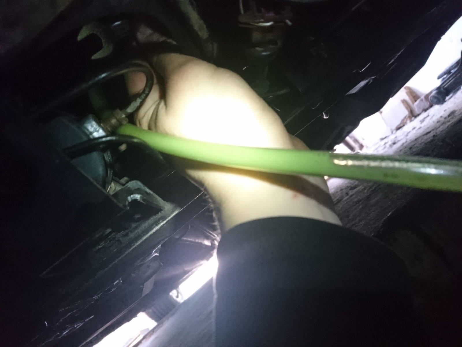

Suspension still has trouble picking holes on the road and is nervous / unstable to drive. Due to the fact that they are bleed in HA Blocks, I tried to bleed the suspension today. I drained the foam only from the front HA block! I poured 0.8 L LHM from the rear suspension and the pipe is full of air, which did not try to move like larger air bubbles. I have no ideas where the problem is. Soon I will have a new Citroen pump. I will try to match the V6 engine and start testing again.

MatPL wrote: 20 May 2020, 13:25 Suspension still has trouble picking holes on the road and is nervous / unstable to drive. Due to the fact that they are bleed in HA Blocks, I tried to bleed the suspension today. I drained the foam only from the front HA block! I poured 0.8 L LHM from the rear suspension and the pipe is full of air, which did not try to move like larger air bubbles. I have no ideas where the problem is. Soon I will have a new Citroen pump. I will try to match the V6 engine and start testing again.

I did not mean bleeding the system, but checking what the oil inside the system looks like, because driving is far from ideal. Bleed the brakes after replacing the blocks in the same way you gave. I already had 5 pumps and each was sealed. I checked the expenditure of each of them and meets the conditions of Citroen at a minimum level. Approximately 1.1ml suspension and 3.5ml support per revolution.
- x 1751
Re: Workaround for bubbles in LHM return flow
OK.
All parts of the suspension system are under positive pressure, so any leak anywhere would show as just that - a leak of fluid.
The ONLY exception to this is the suction pipework between reservoir and pump, and the input side of the pump itself, and the "pick up" plastic tubing down into the reservoir fluid. It is these items that are usually the cause of aerated fluid.
I thought from your earlier photos that the reservoir fluid was just about air-free now, so that points again to suction pipework or pump.
One other cause of aerated fluid is a gradual leak of nitrogen gas from one of the spheres into the system, but this is normally all over and complete when the sphere finally empties itself, and doesn't continue for days/weeks.
Not sure whether you've checked the pump by taking its output through some clear pipe (and back into the reservoir) to see whether it is pumping out air. If there is air being pumped out, make a new good tight tube connection from a container of non-aerated fluid, so the pump is just sucking up from a container and circulating it back there.

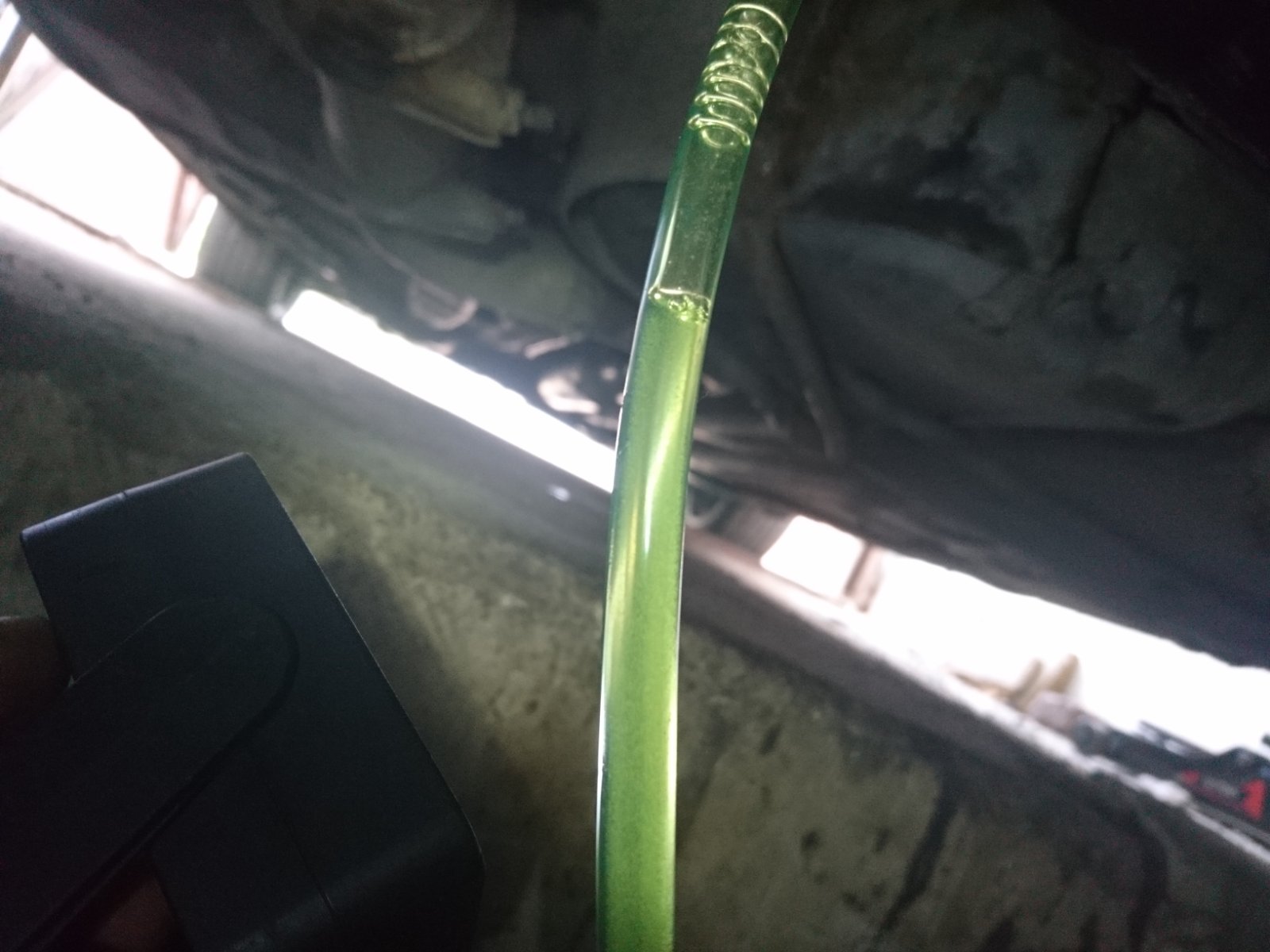

The entrance to the pump was sealed with liquid metal to be sure. The suction pipe was replaced yesterday again with new matched clamps. I replaced the upper forging in the tank with different ones and additionally with CX connections, this plastic in the tank should not be a problem, because it was the same on everyone. Unless 3 tanks that have the same problem. I had a hose directly in the tank and the ride did not change at all.white exec wrote: 20 May 2020, 17:10 The ONLY exception to this is the suction pipework between reservoir and pump, and the input side of the pump itself, and the "pick up" plastic tubing down into the reservoir fluid. It is these items that are usually the cause of aerated fluid.
The air leak from the sphere rather falls off, because it has been going on for several good yearswhite exec wrote: 20 May 2020, 17:10 One other cause of aerated fluid is a gradual leak of nitrogen gas from one of the spheres into the system, but this is normally all over and complete when the sphere finally empties itself, and doesn't continue for days/weeks.
I will try to think about switching the main pressure to some tank before it reaches the conjector. From what I've seen in the transparent return hose, the air only appears as the conjector begins to pump into the tank. When it pumps for suspension, no air can be seen in the pipe.white exec wrote: 20 May 2020, 17:10 Not sure whether you've checked the pump by taking its output through some clear pipe (and back into the reservoir) to see whether it is pumping out air. If there is air being pumped out, make a new good tight tube connection from a container of non-aerated fluid, so the pump is just sucking up from a container and circulating it back there.
For now, I ordered new connections from the tank from Xantia. Maybe they will fit into the Xm tank. That would exclude this oil extraction tube and hose connection. I will have a new pump soon. Then the cable itself or some unknown problem in the installation will remain ...
