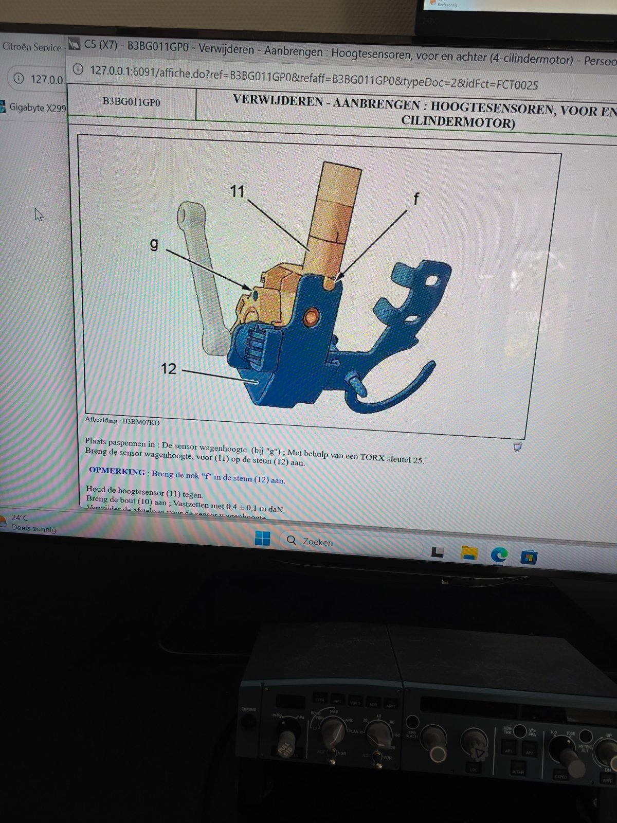

I find something else, you can see, the lever must be facing downwards.

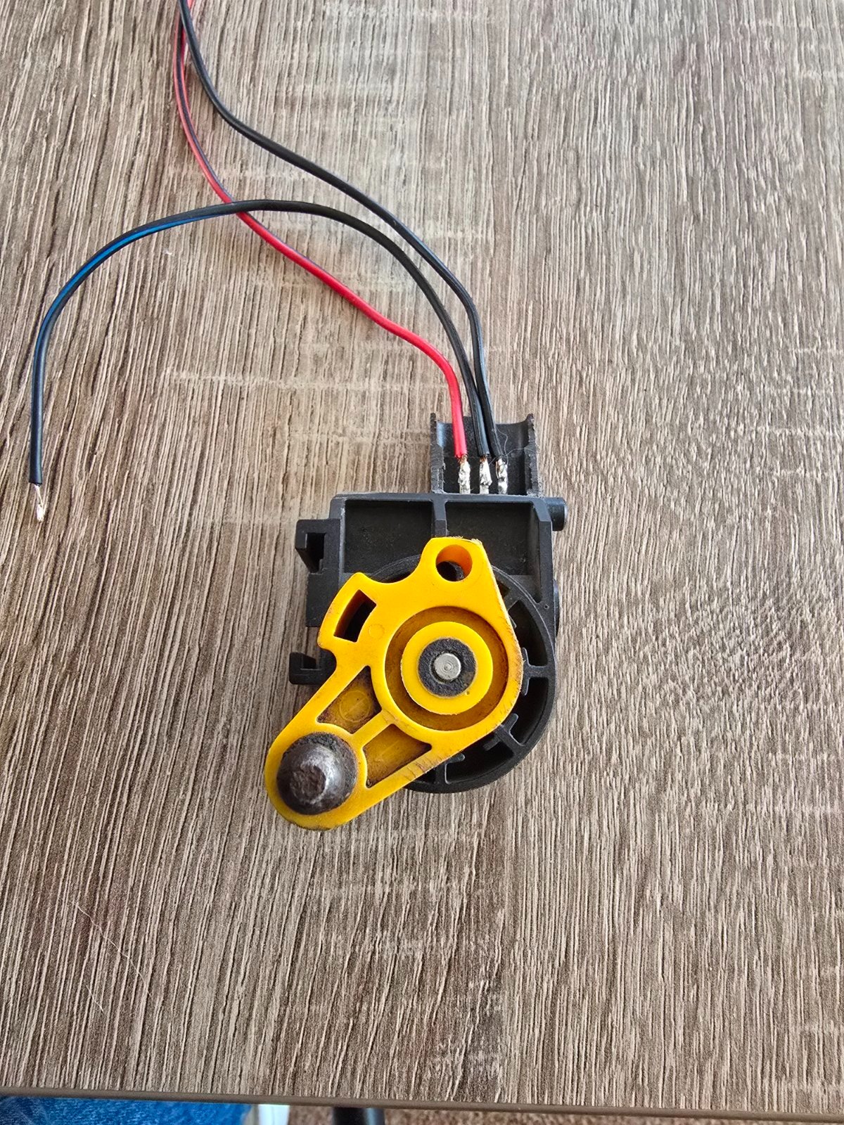

Re: Citroen c5 2.2 x7 -13 stuck in lowest
I’ve checked the position multiple times and it’s facing the right way. I’ve also tried the another sensor not bolted to the car and the car still won’t move up or down when I turn it. Tried it the same in the rear and the car raises or lowers without a problem.
The front lights react when I turn the height sensor and the pump starts. The voltage was about 3.8 in the front and rear when measured with the sensor disconnected. About 0.10 on 2# and 3# both front and rear

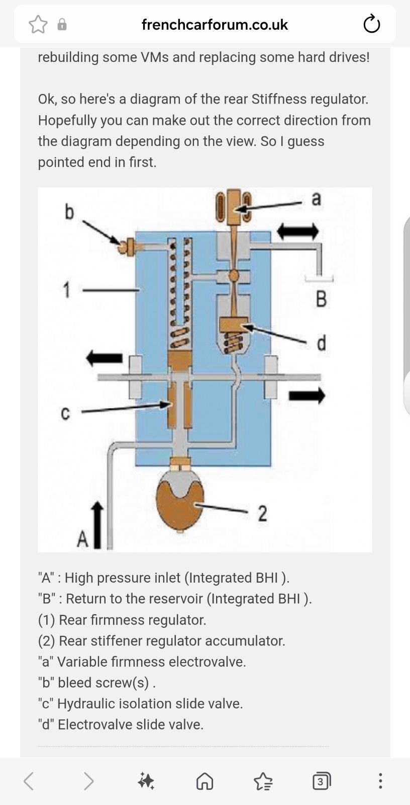

Pomp number is the right one.
Here also the principal working of the stiffness regulator, if you think there's the problem, this can only check, by disconnect "B" then here should the LDS come out constan, but notice, this is the return to the LDS tank, so if you disconnect this line, make sure to block it.
@furriegurrie: no, that's not the case, its "b" on the picture I placed before where you can see how the stiffness regulator work. But also it's not possible to work on the front regulator, you have to remove the subframe for it. Therefore is the same nippel on top of the right suspension strut. You can with this one release the pressure, but connect a plastic hose on it so you can put this back in the LDS tank.

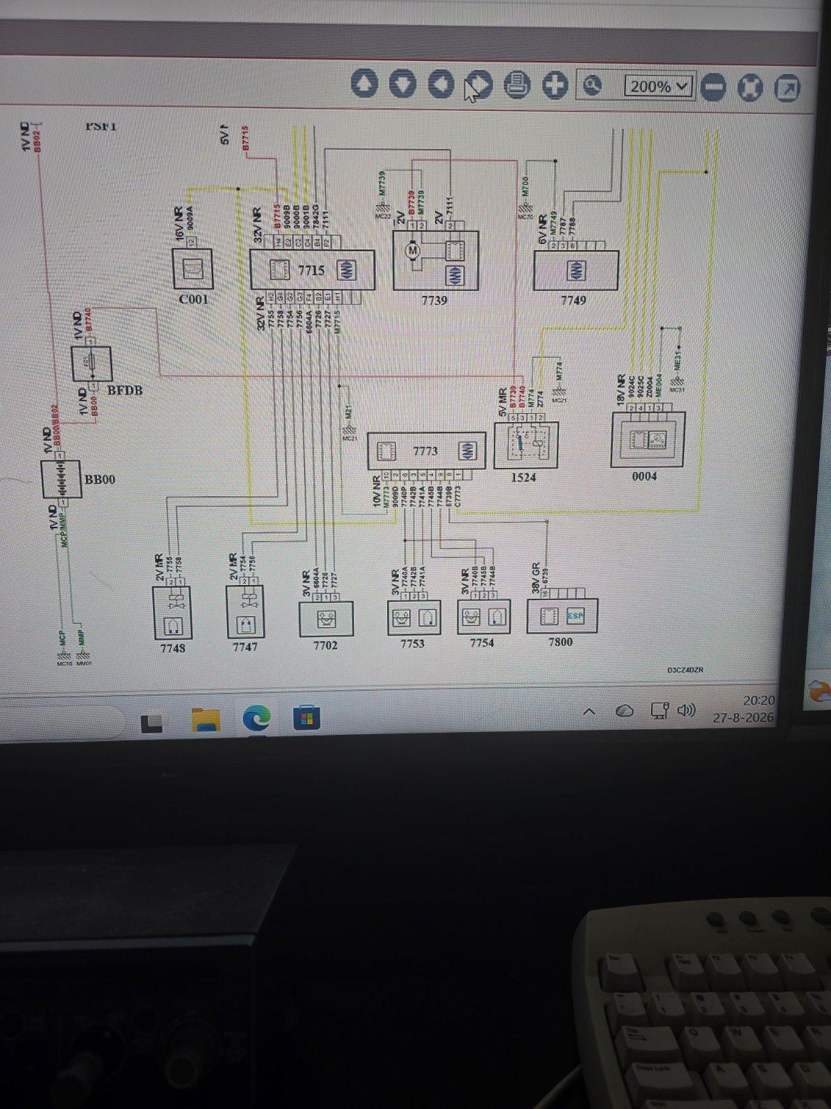

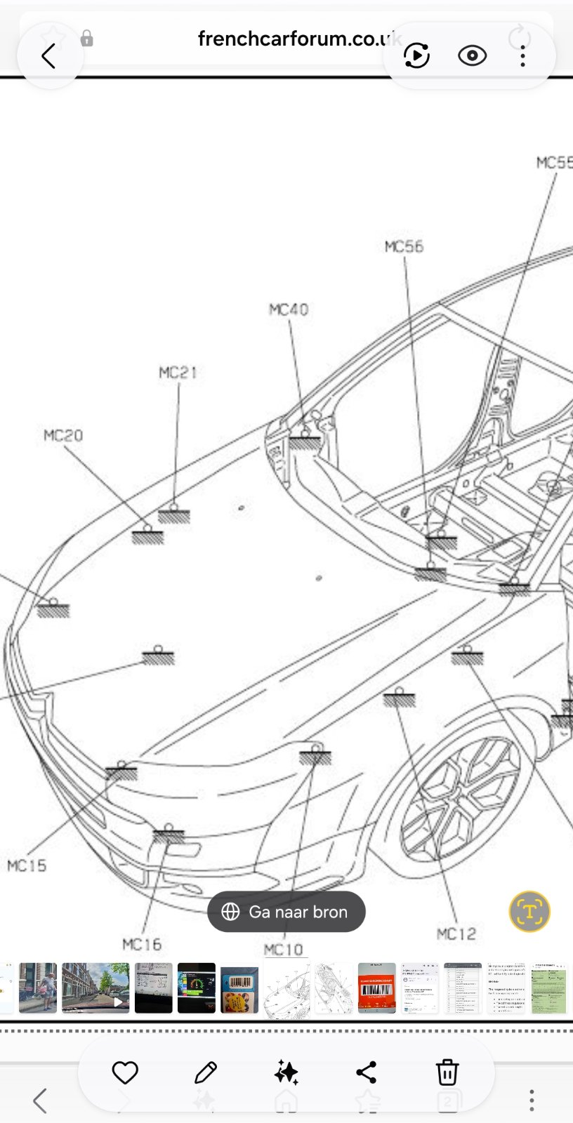

I look into the schematic.
Pls check line/wire from 7702 to 7715 and specially M21/MC21. This is a ground connection on the chassis.
This good be the error U2118.
Between pin #1 and 3 must be 5V and you mentioned before a lower voltage.
It's possible that MC21 is at the opposite side.
