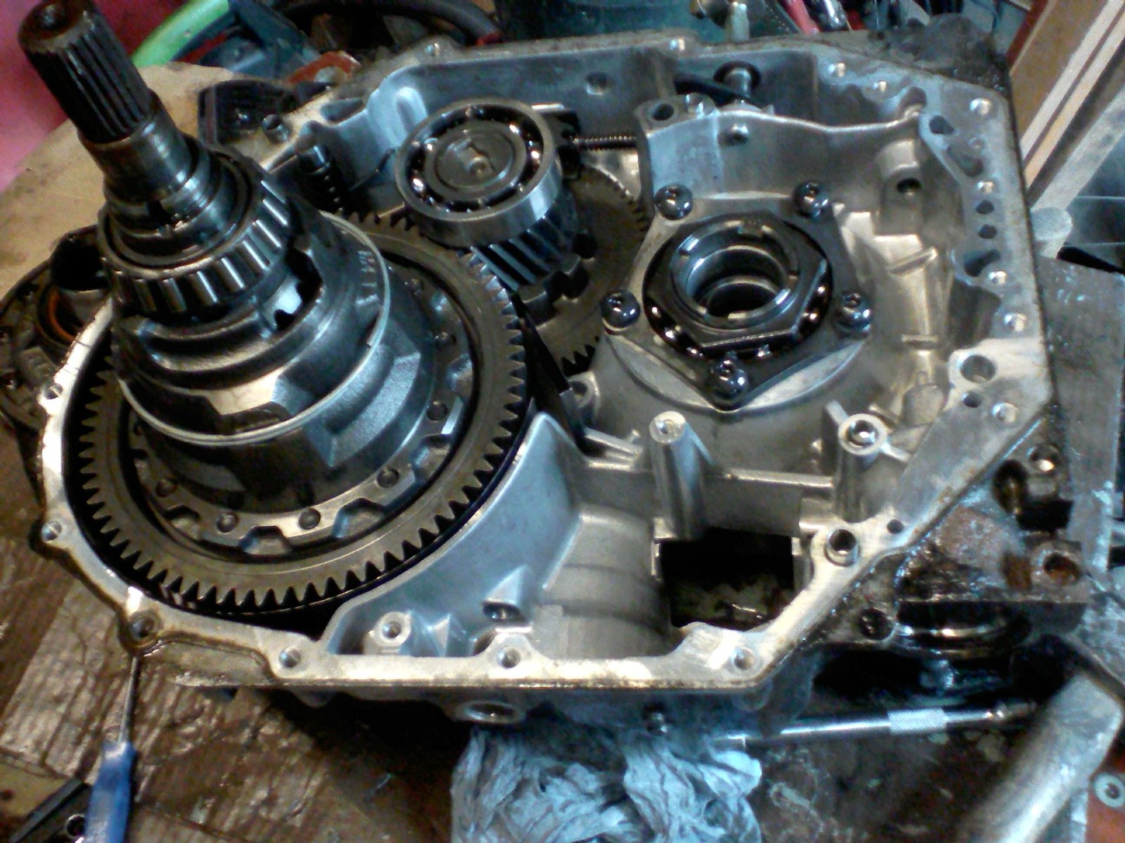

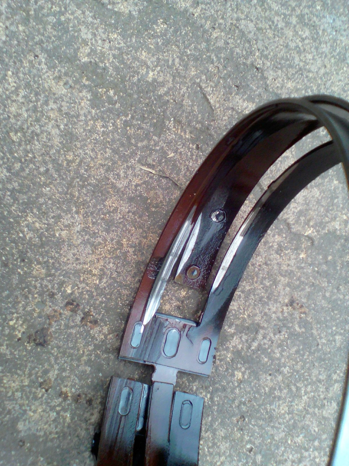

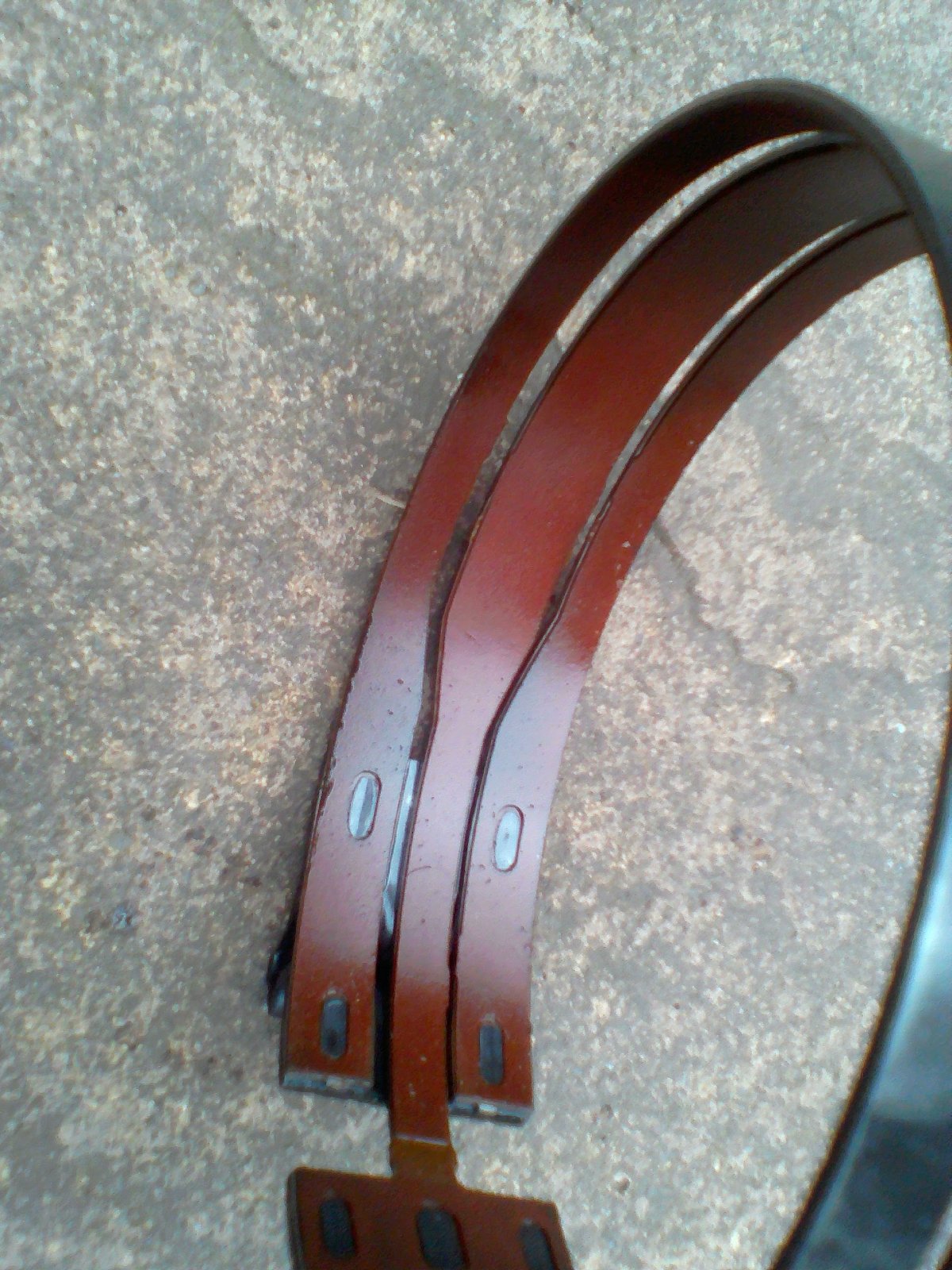

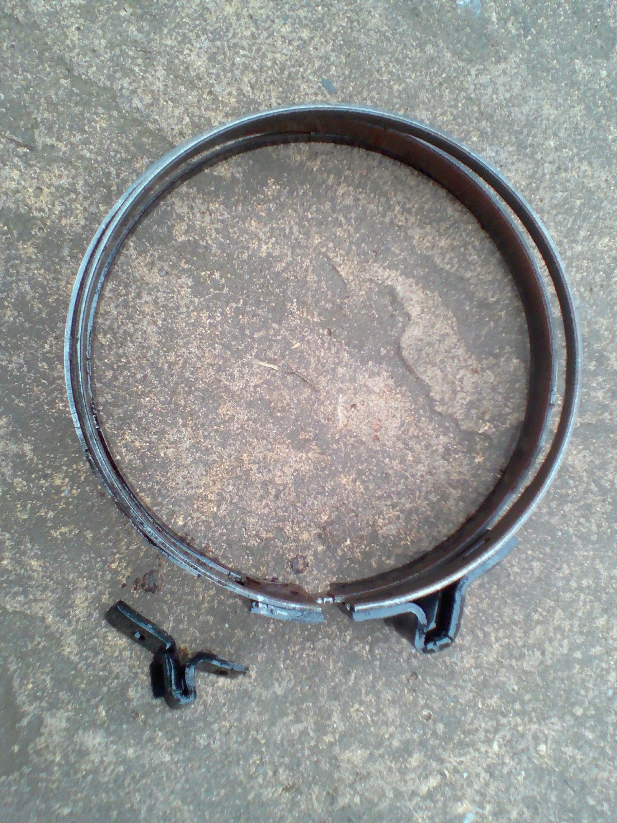

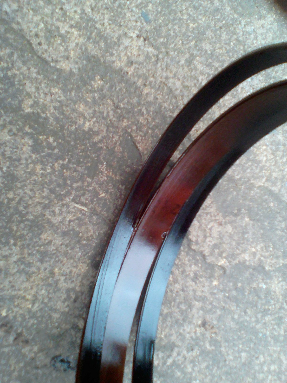

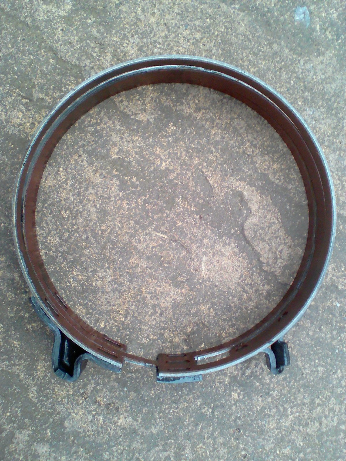

MattBLancs wrote: 27 Jan 2026, 19:29 I wonder if you've had the same mechanical failure (all be it on a different band - it was first gear mine lost) as my 406 Coupe's AL4?
I'll see if I can find a picture
Found them!
