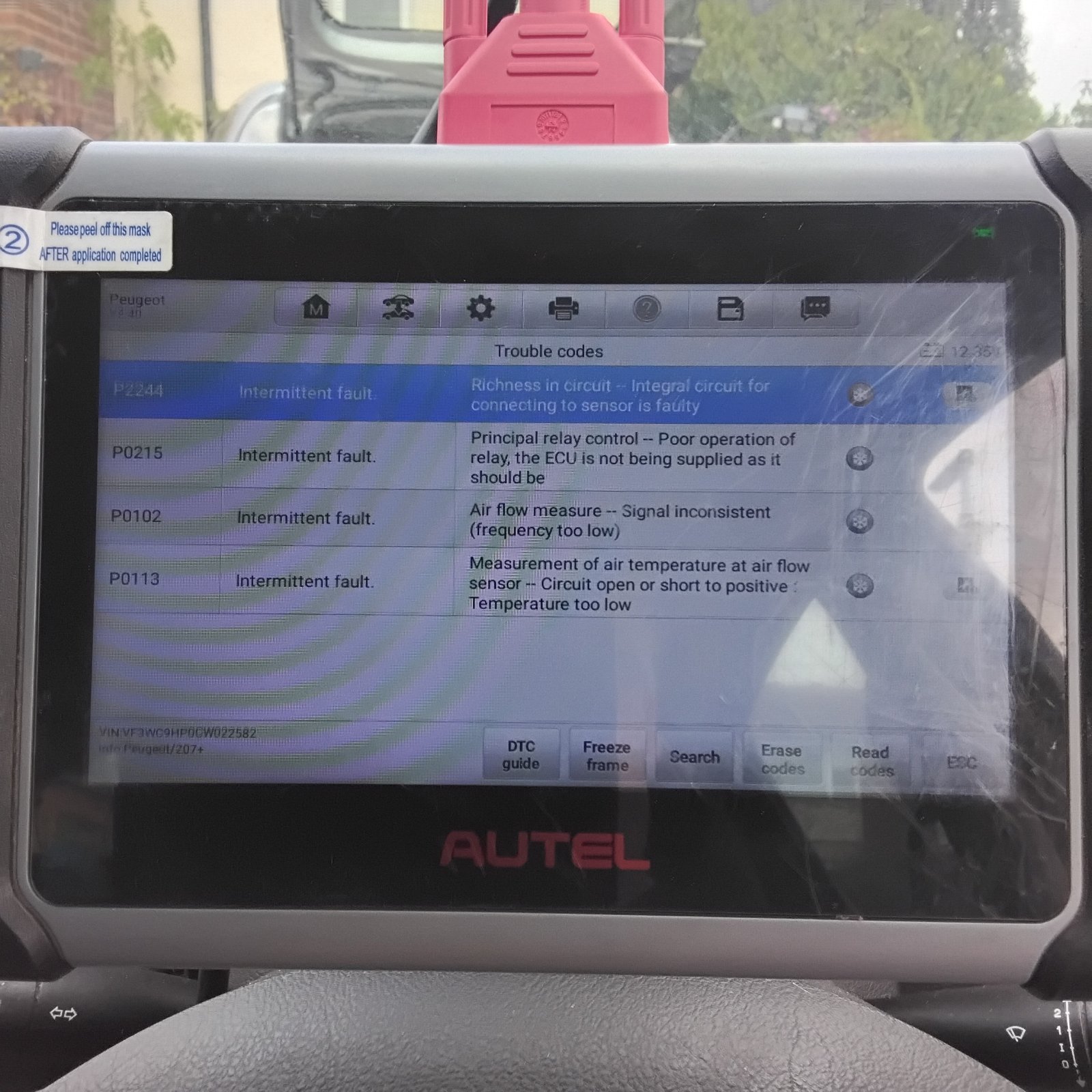

He's my setup , one lead one hand heald tablet thingy. If you purchase the plug in to the obd port this can work wireless 10 meter range ,

Yeah there are easier to use diagnostic machines out there and yours look a good piece of kit for the money.
