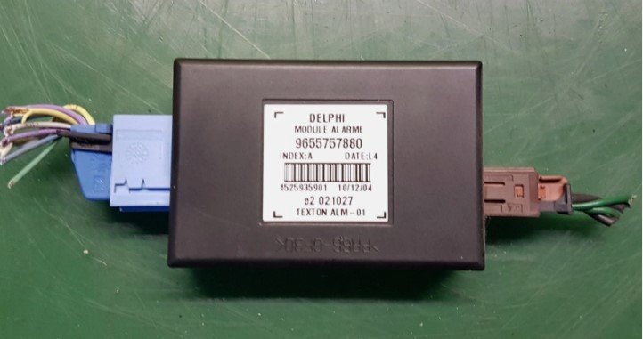

I would try to locate the alarm ECU, will probably look something like this, the brown connector is the sensor connection.
If it the fault goes away either replace or leave unplugged if you are not bothered about the alarm.
Looks like the sensors are a full harness & i bet they are quite expensive.
