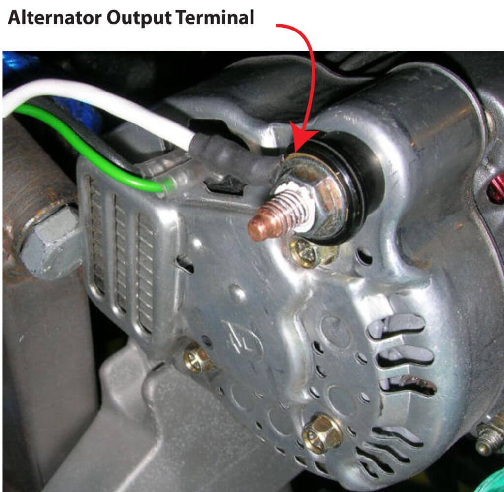

Thanks both makes sense only not sure how to find the big lead to touch the probe on? I can see the ground i think on the top of the alternator then theres a wiring harness clipped. Yeah iwas thinking of possibly getting a refurbed on but I'm a bit weary of getting the job done only for it to pack in after a few months etc theres plenty on ebay etc for 50 quid suppose once I've done it once I'll know exactly how to do it next. And you're right 150 quid is about the same as the car is worth haha. The manuals have come doesn't show a great detail of if belts automatic tensioned or sort of manual i will look to have a go this weekend see how i get on. Cheers for the help lads really appreciate it

The big lead on the alternator is the one with a ring over a bolt, held in place with a nut. You can trace it directly from the battery positive terminal, it is by far the thickest cable connected there. I'll try and find a clear picture :)

You put your positive probe on the nut arrowed:

Thanks Mick i will give it a test later I can see that on my alternator pretty easy so i will give it a check after work and post back findings.
