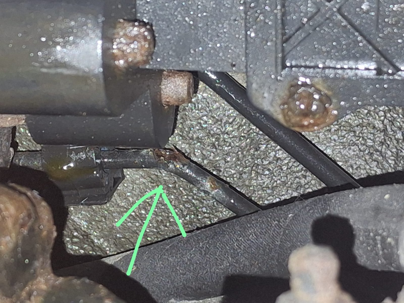

Citroen C5 x7 hydraulic leak
My C5 exclusive emptied the entire contents of its LDS fluids all over the ground today and the car sat itself on the ground. I think this is the cause but it looks like a brake line. Am I correct or is this part of the hydraulic suspension?

Re: Citroen C5 x7 hydraulic leak
It must be a suspension pipe, as the C5 brakes don't run on LDS.
Welcome along!
I would assume it's a suspension pipe - unless it's a power steering pipe. Brakes are separate on these and conventional. Whereabouts is it?
