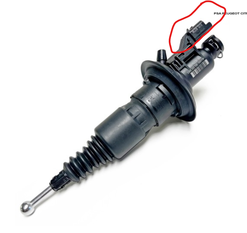

Possibly this one: http://c4owners.org/plugins/forum/forum ... php?241152 ?
Could be a cheap fix, I guess that the connector wears and then you don't get sufficient movement of the master cylinder to get the clutch in what the ECU considers the 'start' position. AFAIK the master looks like this, the sensor is integral - with the wiring connector (circled) on the engine bay side.

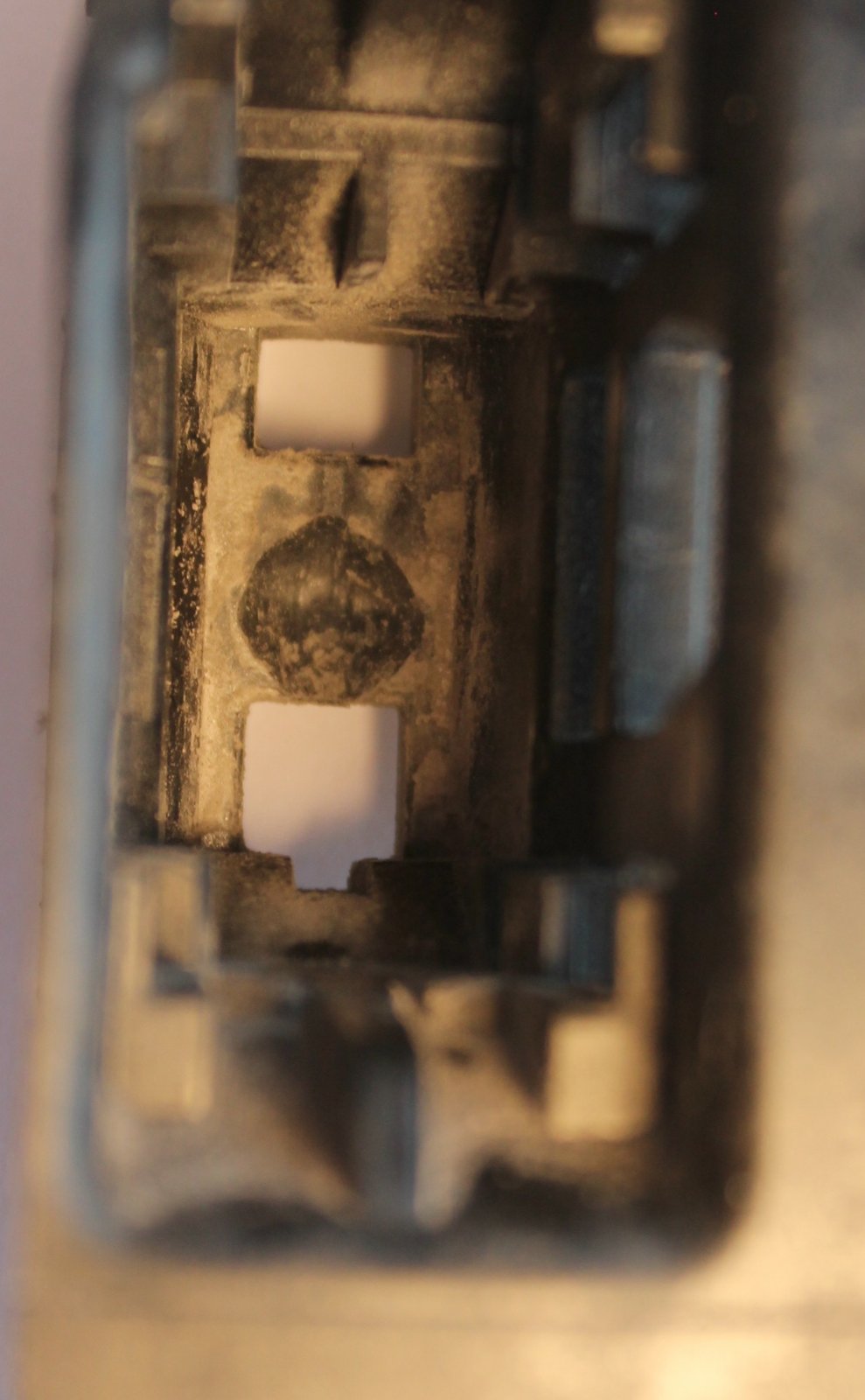

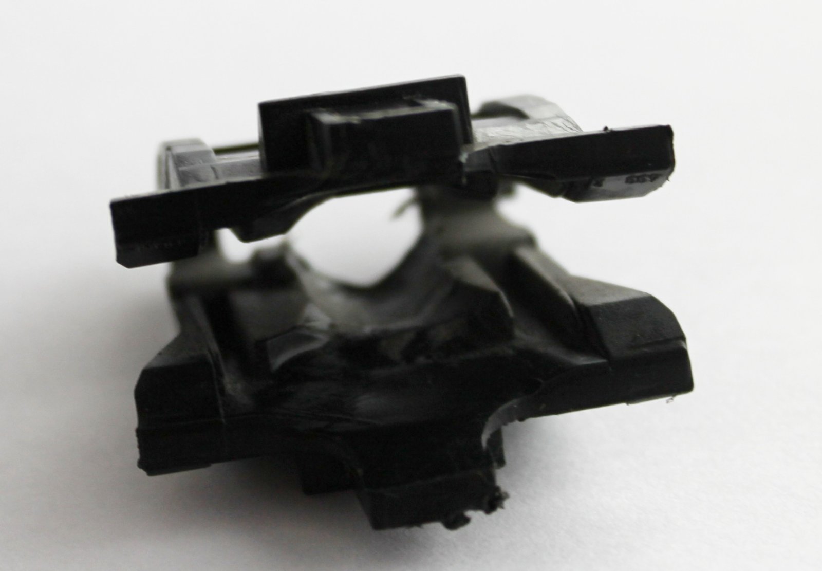

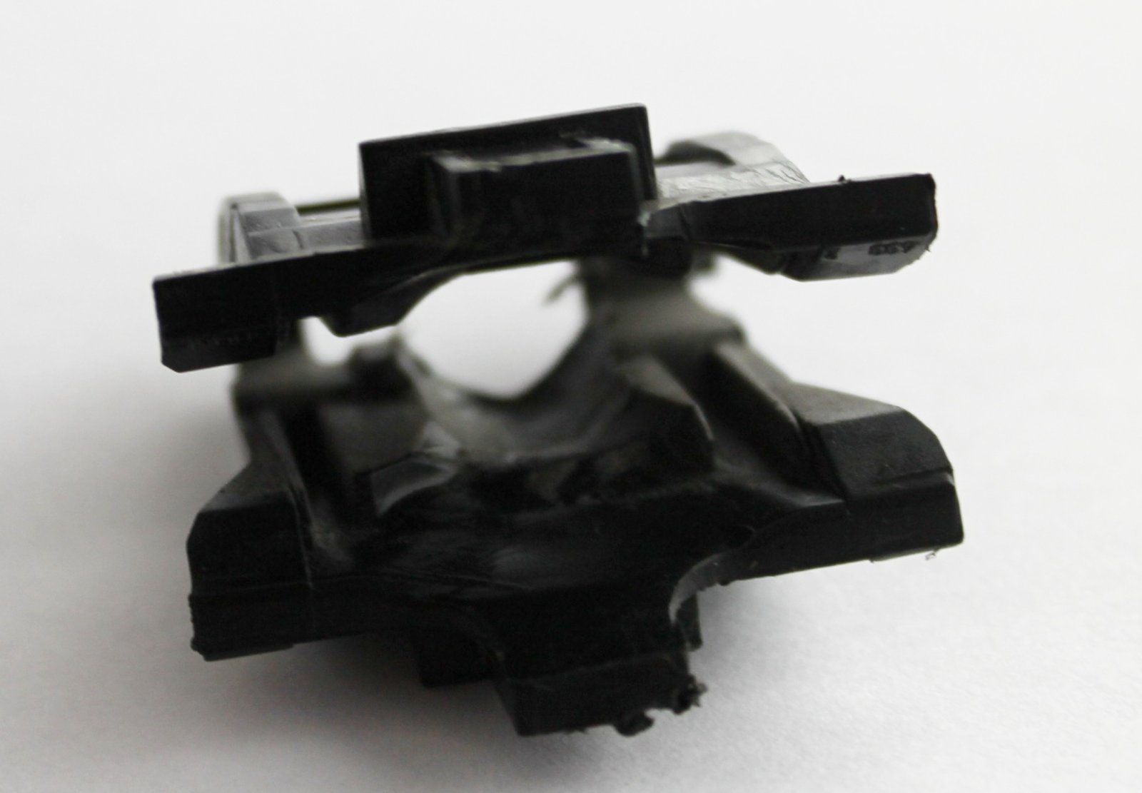

The plot thickens. I have now managed to remove the clutch pedal entirely.
1. The original clip is black and appears to be of a larger size and has an extra locating peg.
2. The clip I have, which is supposed to correct is smaller, it may however fit but have I got the right part?
3. The original clip appears to have worn right through and the ball on the piston rod appears to have worn a round depression in the clutch pedal itself.
I just want to be sure I have the right clip before trying to reassemble it.
The pedal has PA6-GF50 on it.
I shall see if I can find a different clip.

Found another lettering on the pedal VIC 1 >SEBSK 9678478080 01
Looking on Ebay there appears to a type of clip similar to that fitted, which is different to the one I have.
stephenfreeman
- Posts: 31
- Joined: 19 Nov 2021, 10:25
- x 3
Re: Problem starting Citroen C4 2016 blue hdi
I have attached photos. There is only a little wear on the piston ball. As you can see the ball has worn right through the clip and has impacted on the clutch pedal itself.
download/file.php?mode=view&id=79650
download/file.php?mode=view&id=79649

Correct clip now to hand, just waiting for the weather to get a little better first. For those interest the Citroen part No is 98 204 202 80
stephenfreeman
- Posts: 31
- x 3
Mobile again ! The hardest part was putting it back together again, especially the last bit, a small mirror helped to get the bolt through the hole. If anybody needs to know, Amazon sell a type of pincer designed to pinch the ears of the old clip together (BGS 8968 | Piston Rod Removing Pliers | for Clutch Master Cylinder ), which makes removal easy, it cost £20.55. So plus the clip about £50.00 altogether. Though of course I had all the other tools needed already, which apart from the special screw tips also included a G clamp. The clutch works perfectly now and the car starts first time.
