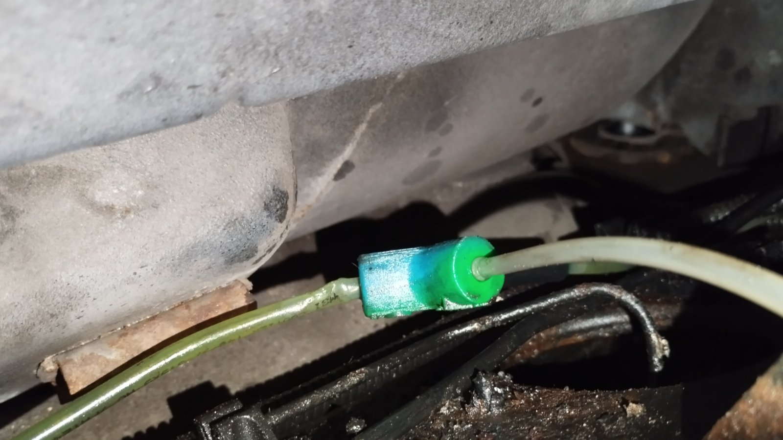

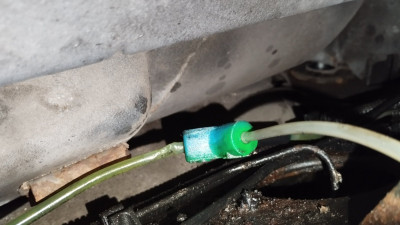

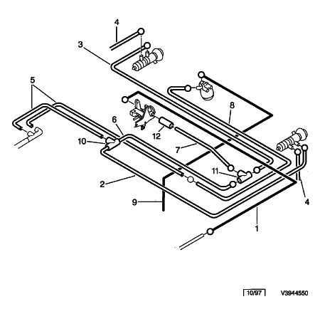

This is the connector that I am working on today. The subframe is dropped about 50mm on the right, the fuel filler hose prevents it being dropped much more on that side, but the left can be dropped more (but watch the hydraulic pipes running to the front.
The subframe is held up by 2 bolts on each side. Your main challenge will be to safely support the rest of the car at a height where you can work underneath it.

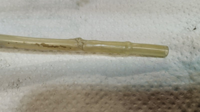

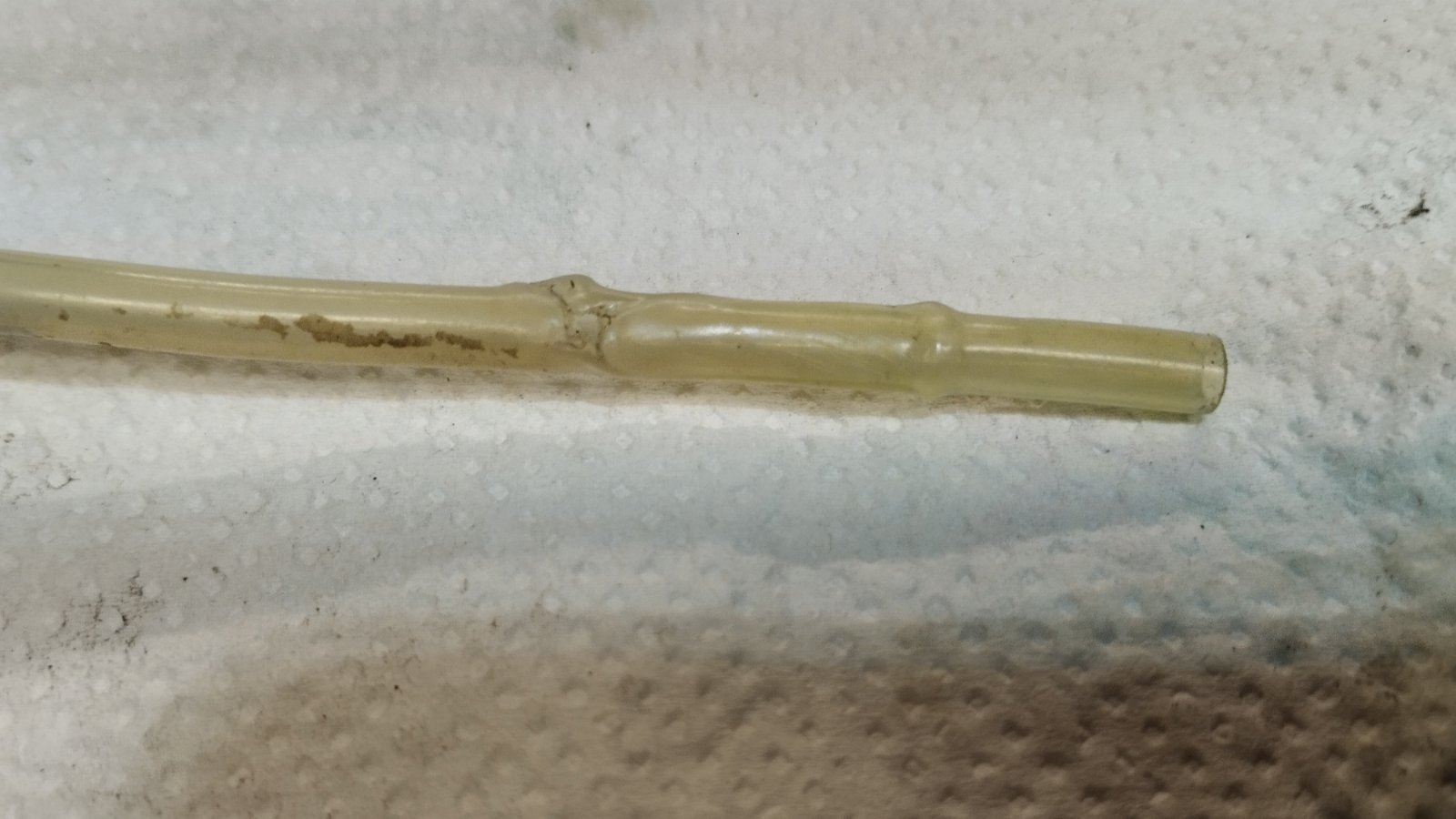

In my case I replaced the green connector last year when it perished, but the current replacements are much harder and I apparently cracked the plastic pipe when refitting it.
I repaired the pipe with a rubber sleeve and crossed fingers.

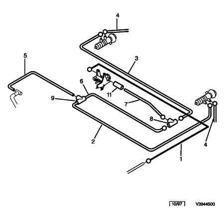

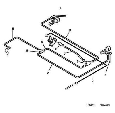

How to lower the rear subframe......Be SAFE, use good axle stands on a FIRM BASE
viewtopic.php?p=743545&hilit=lower+rear ... me#p743545
Return system on a 1.8i 16v
1. Without HA 2. With HA

Have had a look at it and it's dripping from both sides now..
Most likely it's some of the rubber connectors that have perished.
