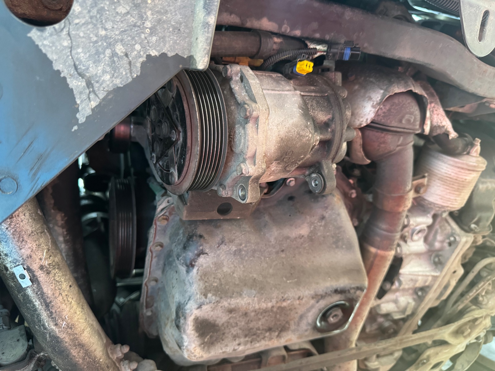

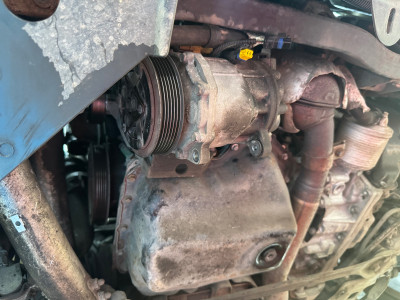

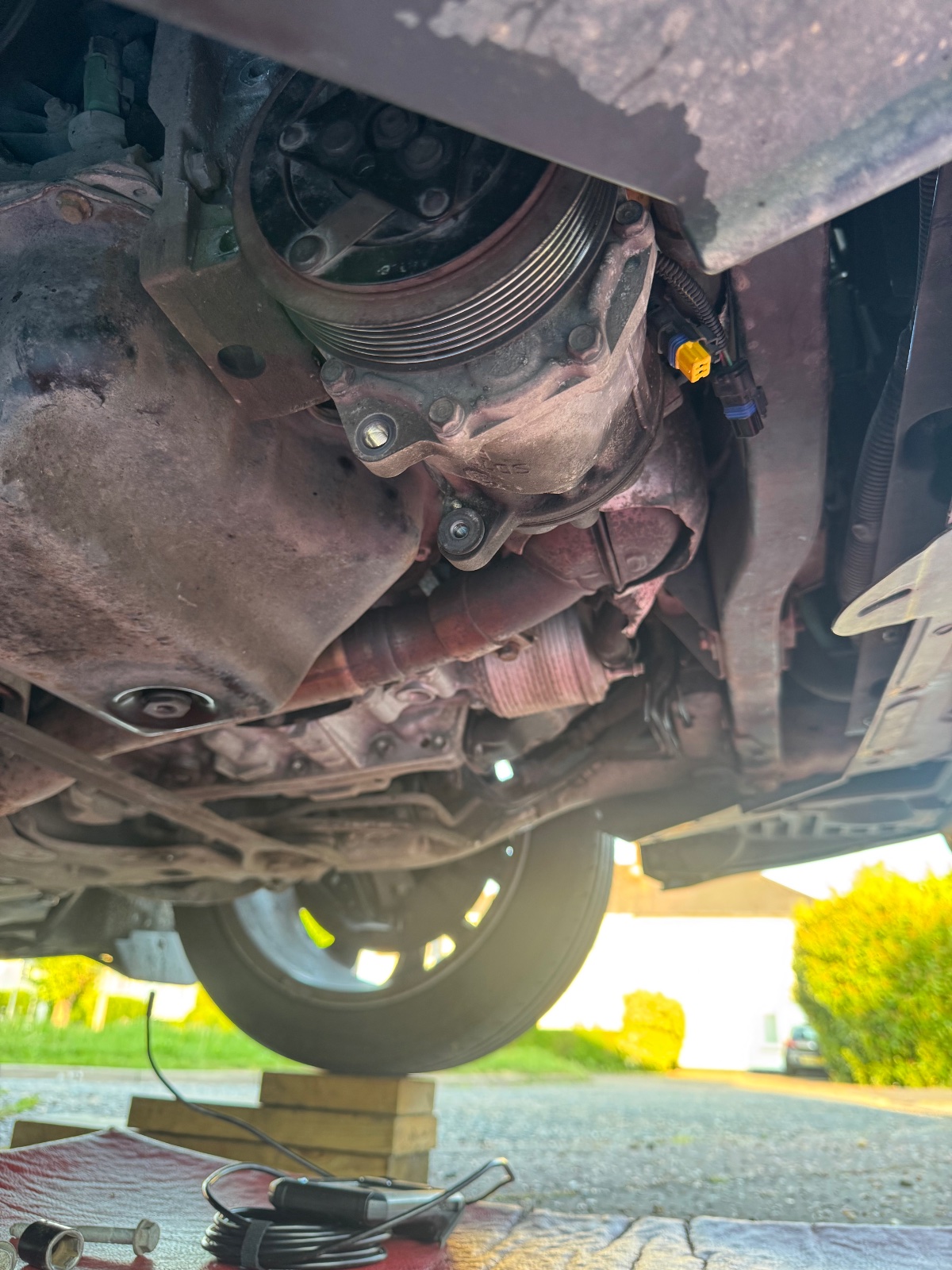

Didn’t get the job finished yesterday (couldn’t start it till mid afternoon).
Nothing technically difficult so far, but access is just a complete arse. It’s just a small number of bolts overall, but everything conspires against you getting at them. So much of it ends up being done ‘blind’ ‘by feel’ reaching through small gaps. Even stupid things make everything take 15 times as long - like the two 10mm bolts that hold the air intake duct to the side of the block. Once loose, they still have sufficient friction on them that you still can’t undo by fingers, while access to swing a spanner or ratchet wrench is minimal, so you only get a 1/16th or 1/8th of a turn each time - and the heads of those bolts are stupidly shallow so the socket doesn’t stay on, but slips off every time…
So many different variations of spanner, socket, ratchet wrench etc needed, to best suit access to each different bolt. Basically it’s just an unpleasant thing to work on.
Unfortunately the air con compressor won’t drop while connected because the front cross member stops the hose manifold from passing. It won’t swing down out of the way either - one of the flexible hoses has enough slack in it that it would, but the other (the one that runs to the condenser) has barely any. Best you can do is lower it slightly. I’m hoping there might still be just about enough room to wriggle the alternator out the side with it like that, but am far from confident.
Not sure if I’ll get back onto it today or it will have to wait until tomorrow - we shall see.
Couple of tips so far with reference to the oem instructions:
- An Allen key works fine as a tool to hold the aux belt tensioner retracted
- to remove the aux belt, the bottom bolt on the aux belt tensioner just needs to be loosened a lot but can be left in place and just the top bolt removed. That avoids the aggro of trying to blindly line up the bottom bolt when you come to refit (top bolt much easier to access)
- I can’t see any good reason to remove the drivers wheel and wheel arch reason, so far
- air intake duct does not need to be removed to replace the aux belt (or to remove the a/c compressor) but I have unbolted it to improve access to the alternator. I can’t see how on earth you are meant to ‘remove it’ from the engine bay though - there’s no ‘path’ to pull it through? Best I’ve managed is to disconnect everywhere and move it back and to the side so it’s clear.
- don’t be tempted to remove the top part of the intake duct (where it attaches to the throttle body), it won’t help. Just stick to the lower part and remove it at the jubilee clip - you will need to completely loosen and slide the jubilee clip down from the coupling point, otherwise the duct won’t expand enough to slide off (can’t just loosen the jubilee clip and leave in place)

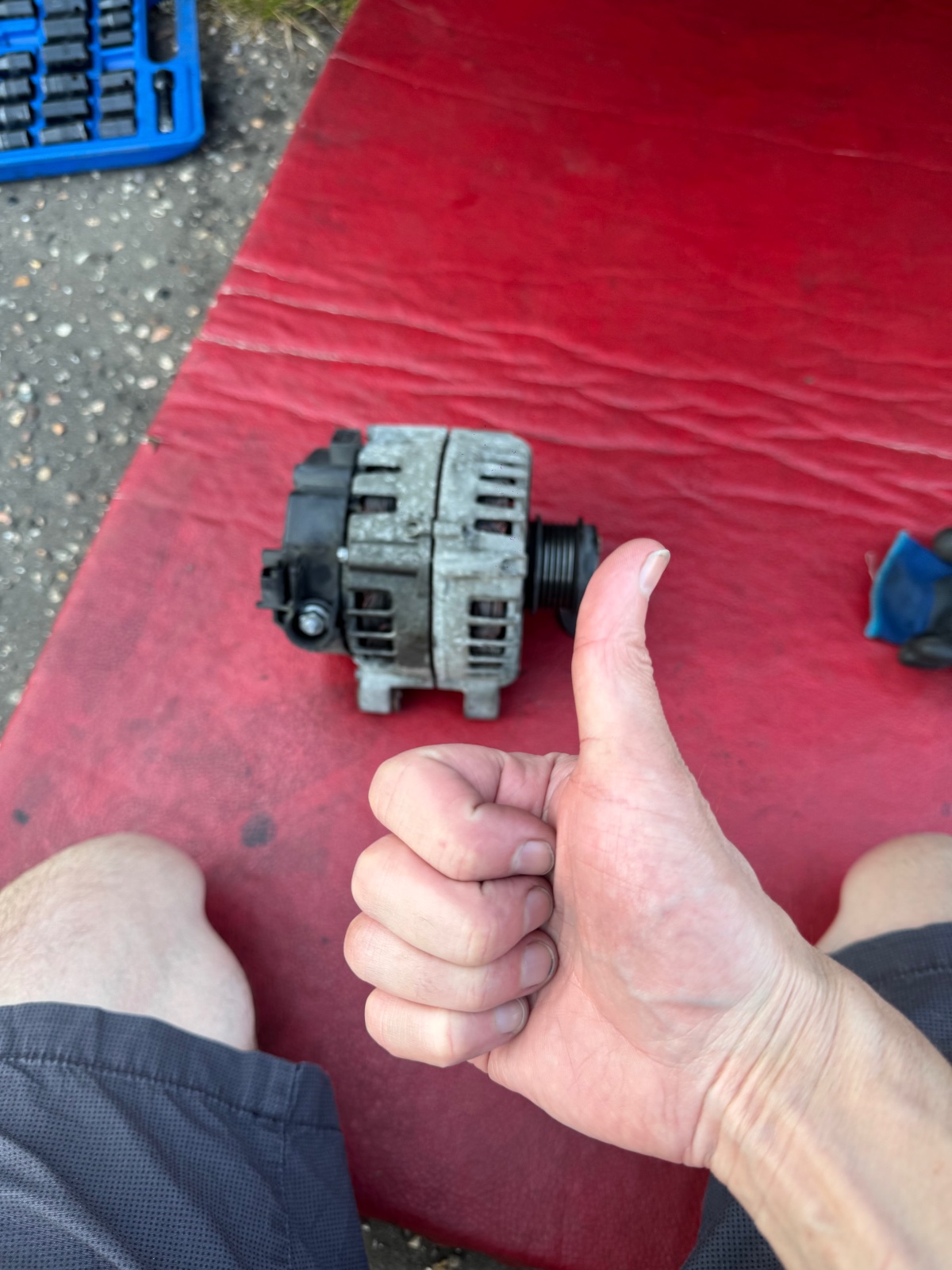

Post work tonight, we have an answer:

Re: C5 X7 HDi V6 aux belt vibration - Alternator Change
Hurray! It's a boy, I mean it's an alternator!
Access looks, very much as you described, horrible! What a relief to get that out at last.
Refitting is reverse of removal (which is an absolute lie, for example it's not possible as far as I'm aware to "un-graze" your knuckles!!) good luck with the next bit
