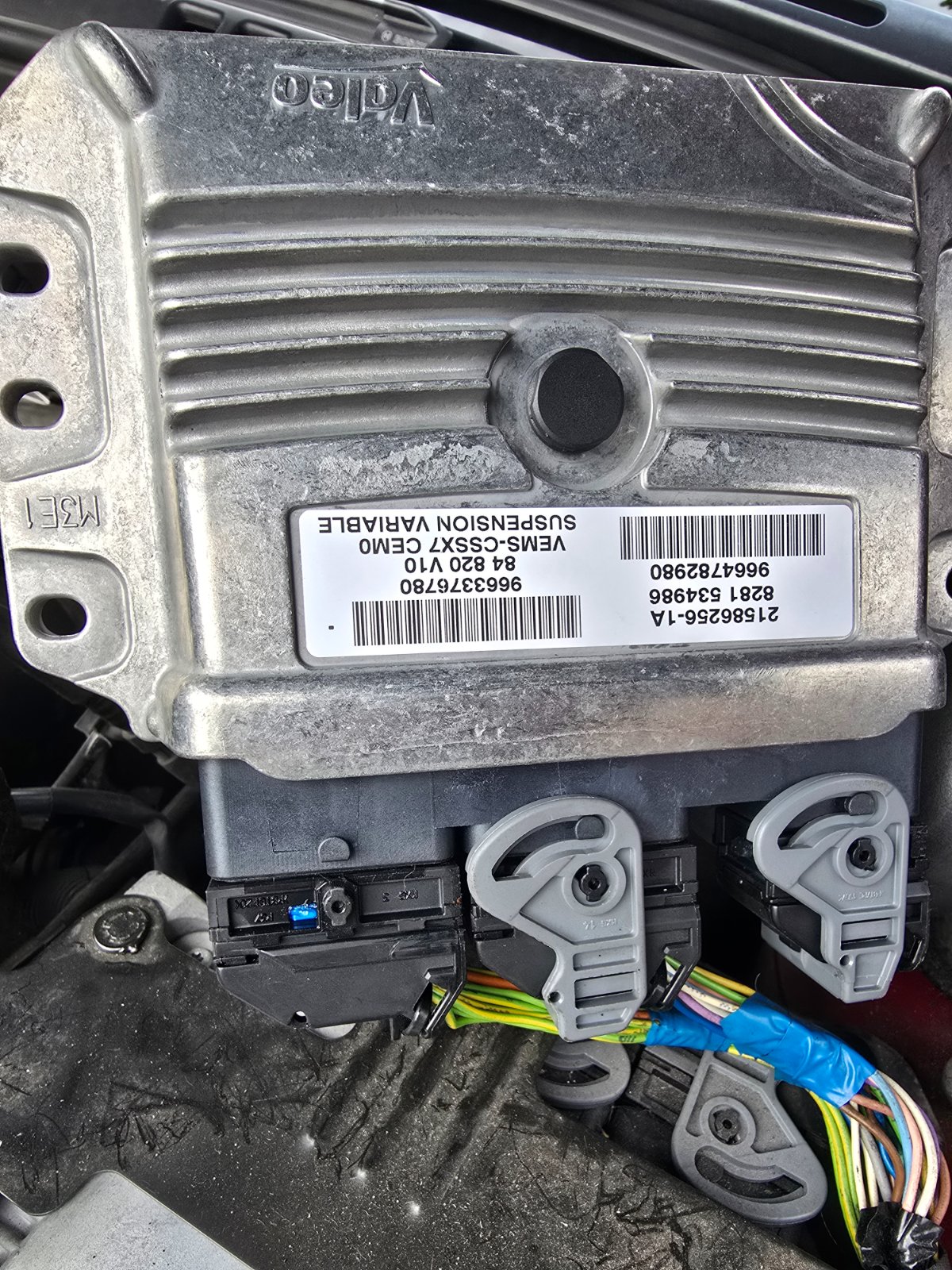

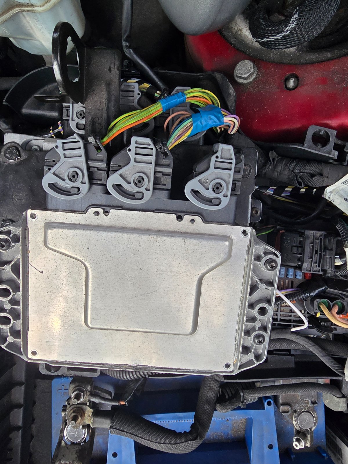

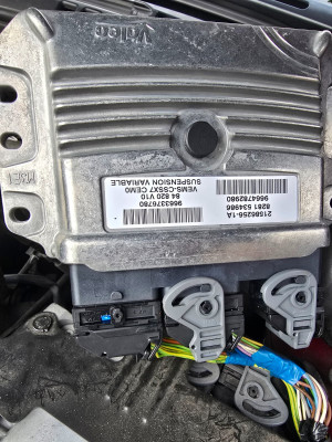

Hai, i make some pictures of my car, only it's a 3.0 petrol.
You can see my CSS, and it's says "suspension variable " not "damping variable " as the C6.

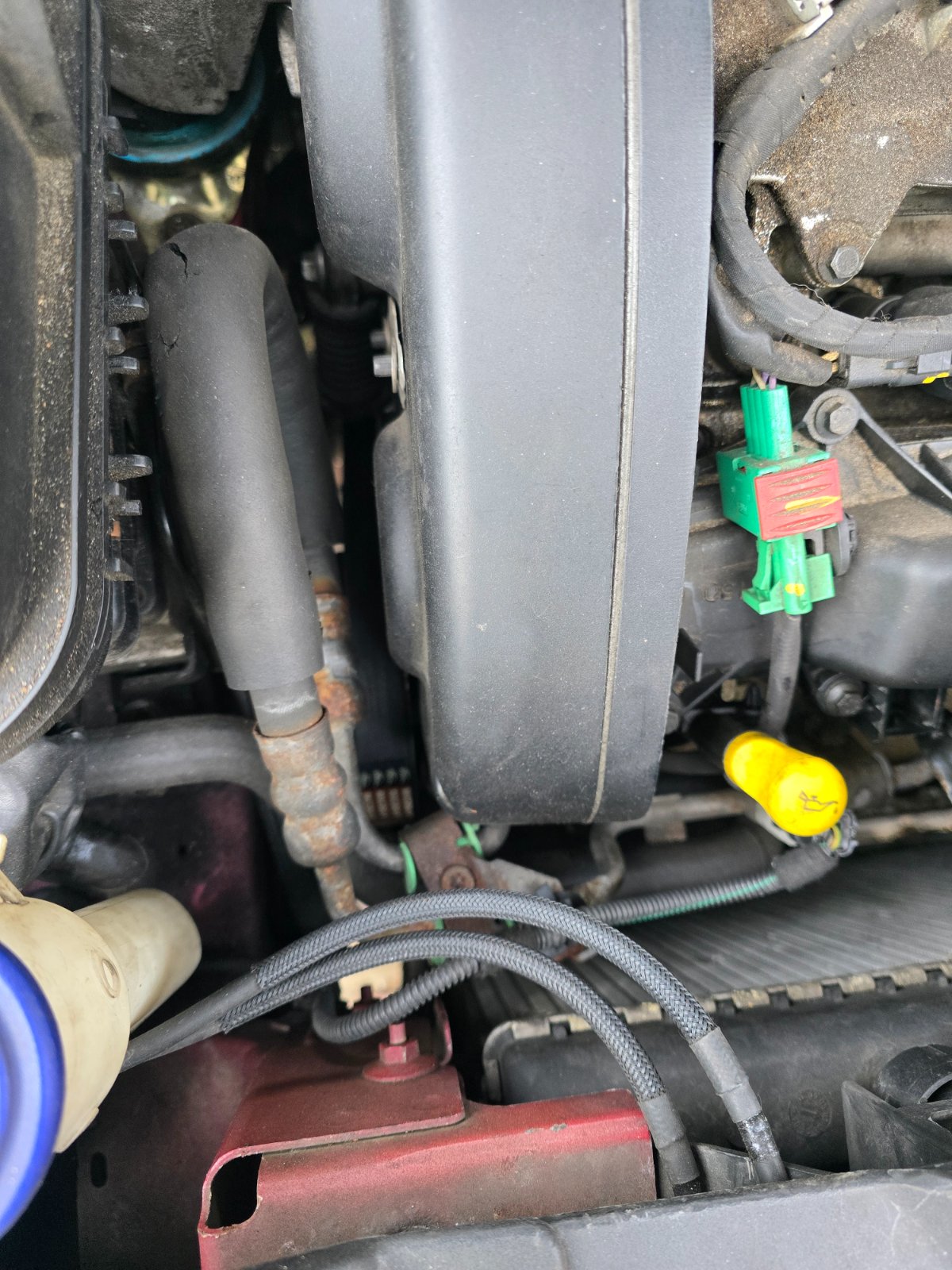

You can also see, that i have a mechanical steering pomp, and don't know if yours is the same, or an electric one?

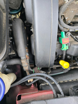

Maybe it's possible to fill the hose leading to the pomp with LDS, and I also read, that you maybe have to ad 0,5 bar at the LDS tank.
I also see some pictures of a saperate tank for the steering pomp, behind the mud protector at the right front wheel.
So you see i try to thinking about the problem and maybe you have something about this
Greetings,
Kees.

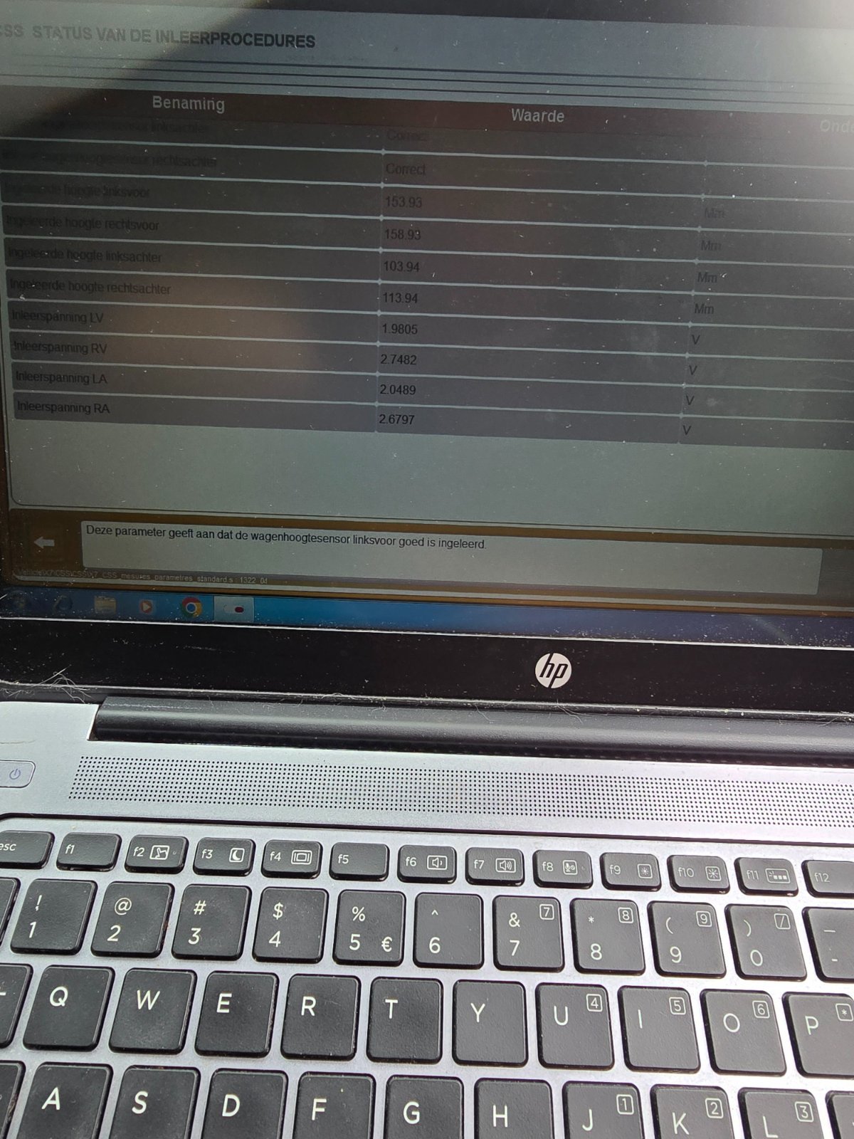

Re: C5 X7 no power steering
I read something back from your post .
"The only thing I can think of that may be related to the power steering that I disturbed is the two electrical connectors that mount on the bracket bolted to the nearside lower suspension arm rear bracket - is one of them related to a sensor/variable assistance control for the rack? However I didn’t disconnect them, I simply unbolted the bracket from the old arm mount (complete) and bolted back onto the new one."
Did you disconnect the rod between the height sensors and the lower arm before unbolt the lower arm?
Because otherwise it's possible, you overstress them.
But you can see if the data from them is correct by using the diagbox.

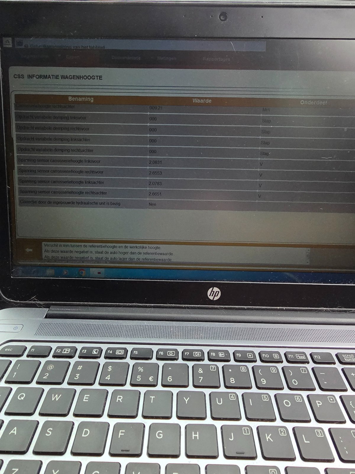

- Posts: 589
- Joined: 16 Nov 2021, 16:16
- x 147

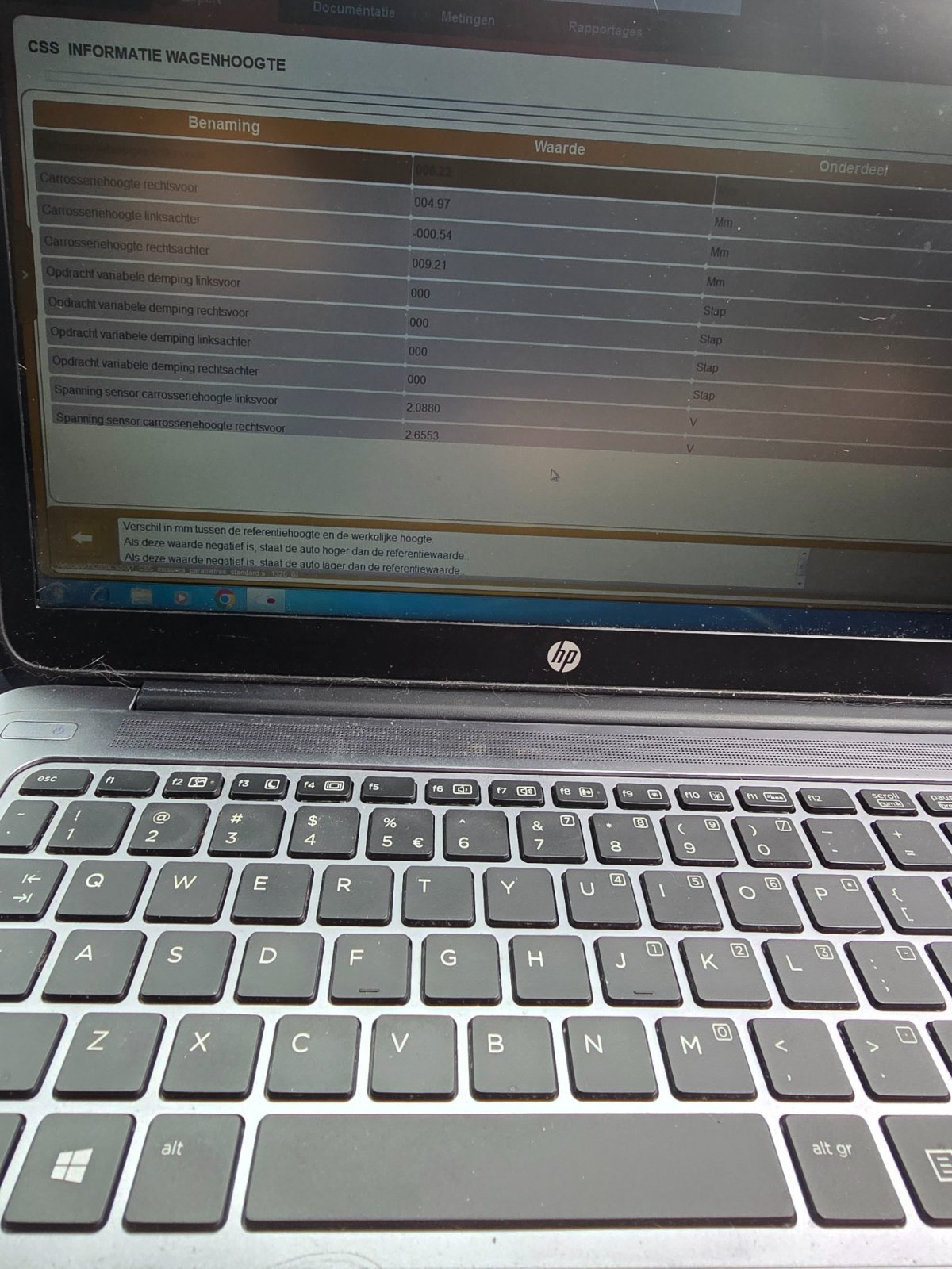

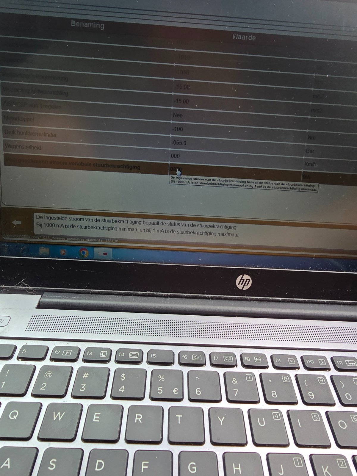

Here you can see the data from my car, the difference between some height sensor is, the car was not horizontal.

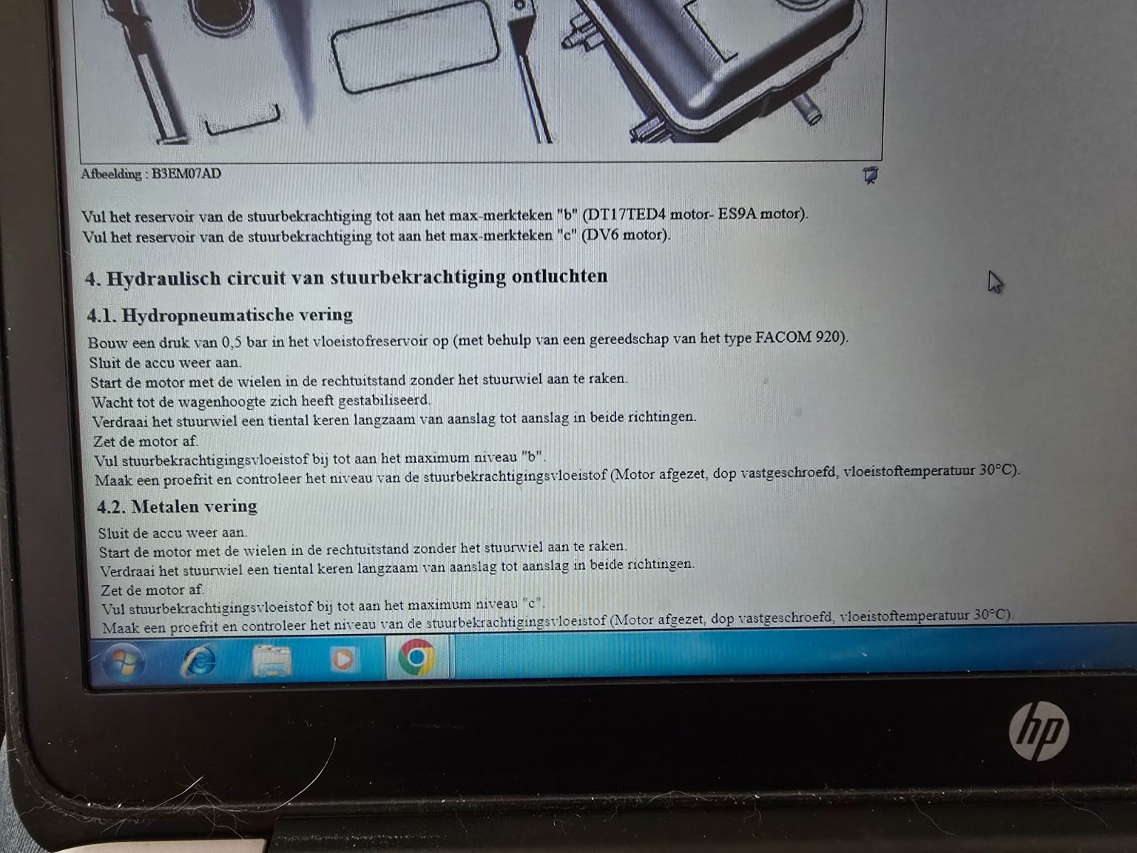

This is what the service box tells about air in the system.
Ad 0.5 bar on the LDS tank
Start the engine with the wheels straight forward without attaching the steering wheel.
Wait until the car is stable.
Turn the steering wheel 10 times slowly from left to right.

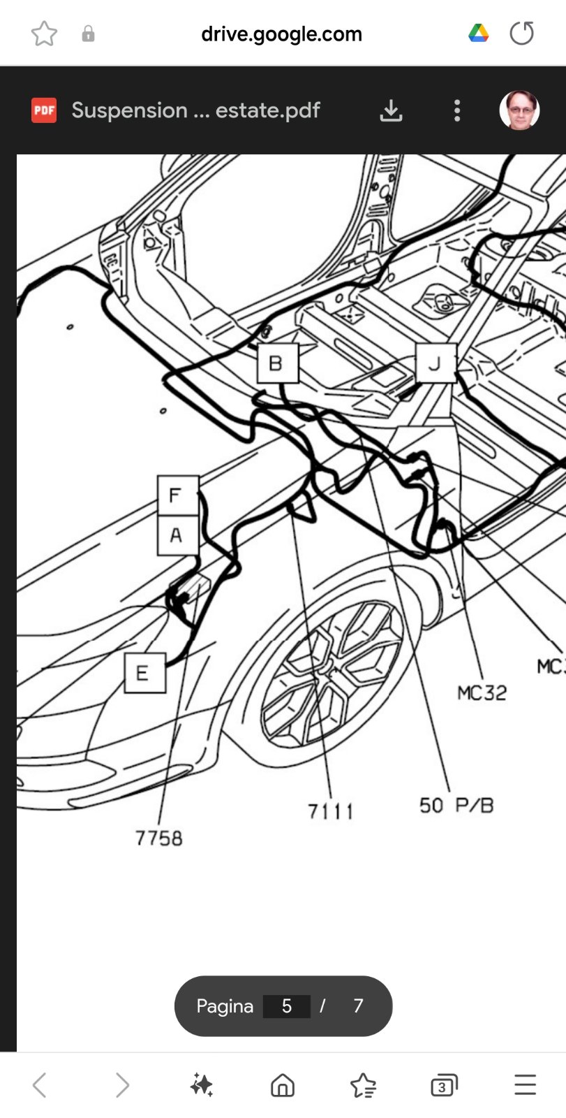

Still getting to grips with my bootlegged Servicebox, but I think the below schematic is the one you're after (or at least it's the only one I managed to dig up).
0004 is the instrument panel
1524 is the supply cut-off relay
7111 is the variable power steering proportional electrovalve
7715 is the suspension control unit (I'm assuming the regular ECU that appears in all H3+ X7s)
7739 is the central electronic block motor
7747 & 48 are the front and rear suspension electrovalves, respectively
7749 is the luggage compartment height selector
7751-54 are the height sensors
7758 is the variable damping ECU (presumably the one you have complaining)
7769 is the suspension buzzer (no idea what that is)
BB00 is the battery
BFH1 is passenger compartment 1 fuse box 1
BPCB is the battery cable protection unit
BSI 1 is the BSI (go figure)
BCM0 is the multifunction switch block
C001 is the OBD port
CA00 is the ignition switch
PSF 1 is the engine compartment fuse box panel
I'll try and see if I can dig up anything on the error codes, but I don't know if I have that ability (EDIT: Looks like I don't unfortunately, I can only do mechanical and electronic schematics).

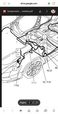

Kees
- Posts: 589
- x 147
You see, that connector 7111 is in the same wire harness as the wire from the height sensor, maybe there is something wrong, sometimes because of the movement and some corrosion there's the reason for your problem.

Not hugely relevant I don't think - but component 7749 not identified in that list.
Interestingly, the two plugs I'm referring to that I disturbed, aren't shown in that wiring loom drawing (or on the schematic/wiring diagram). So that suggests they are not related to the this system?
Is that schematic/wiring diagram for a RHD car or a LHD car?

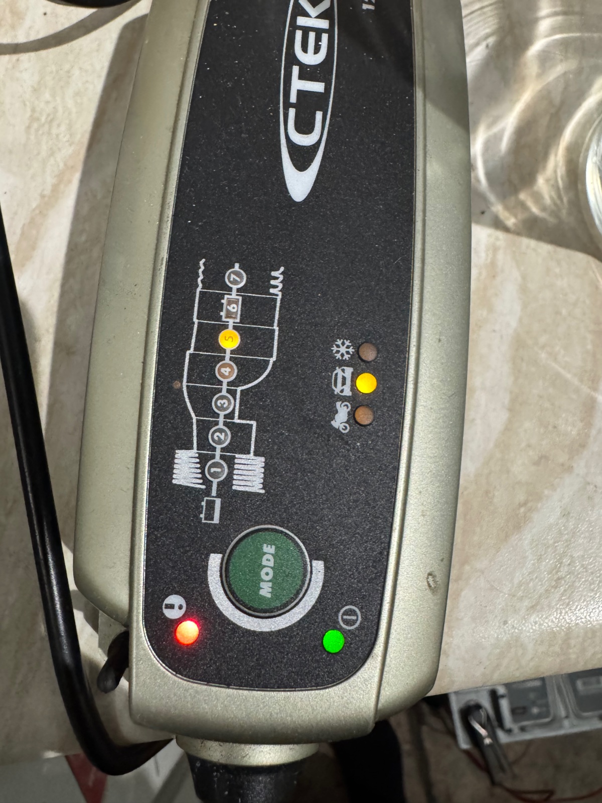

Progress made on this today?
Zero - because the (-expletive removed-) thing has either developed a horrendous parasitic drain problem, or the two month old Yuassa battery has completely carped it overnight, or it's not charging properly - or a combination of all three.
Drove it Wednesday night (85 miles, so not a short battery draining trip!) and today it was completely and utterly dead. Not the merest sausage of life.
Was able to unlock it (and once jumped, could central unlock it) but couldn't jump start it using another battery jumped onto the terminals in the engine bay and hence wouldn't come out of economy mode.
So the battery is now out and on charge - will test that once fully charged tomorrow, but I'm out all day so can't make any more progress on it then.
I *hope* the cause of parasitic drain is the bluetooth audio streaming thing that I had rigged up piggy-back powered from the passenger fuse box, audio connected into the aux terminals (one of these). I only installed that a couple of weeks ago and noticed when I used it on Thursday that it was no longer working (phone did not discover it). It's confusing though, because I thought I powered it off an Ign. switched live (that was certainly the intent!). It came off G35 - door lighting and electric mirrors.

Amazingly though, I think it may be the battery!
One of my smart chargers refused to charge it (didn’t even recognise I had anything connected, so refused to turn). The ctek mxs3.8 did start, but when it got to stage 5 it stopped and put on the fault light - never seen that before.
Might be a shorted cell.
I’ve restarted the ctek, see what happens this time and then I’ll test it with my battery tester either way.
