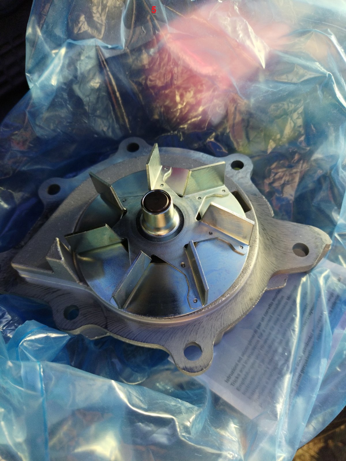

it's strange but I have 70 degrees and the radiator is hot and the heater is not very strong, I can feel air on the heater hose.

BrayanLDZ wrote: 24 Feb 2025, 18:14 I filled the cooling system with demineralized water and added a product to clean radiators from scale, etc....the water pump seems to be working because when I rev the engine, the fluid disappears from the fluid reservoir, so something must be pushing it further.
The right way to check if the water pump is working properly is to take out the return line (the small one on the top.Watch out, is fragile) of Water Coolant Reservoir Tank with the engine running and see if coolant comes out with the engine warm because we want open thermostat.These water pumps are known to fail because of plastic impeller.By physics, if water pump barely works, coolant will choose the easy way with the least resistance.I don't remember the route of coolant hoses as we have same car, but maybe this is combined with some blockage due to old coolant of hoses. Watch video (in your language 13.38 min).
Another suspect is thermostat.If i remember it feeds the heater.

I know the engine more than once, I've done the timing, I've never had a broken water pump impeller. I can always feel the heater hose that either has flow resistance or air. Maybe I'll go faster, the auxiliary will turn.

I changed the thermostat but still no heating... but the pump? the pressure in the fluid reservoir is when it heats up.

I suppose you bleed cooling circuit the right way through 2 bleeding screws on thermostat and over the heater pipes close to firewall.At least in mine it's like that.There must be a constant strong flow also through these two screws to understand if water pump works and not intermittent. Overflow pipe on expansion cooling tank is more difficult to understand if pump works.

so after filling with liquid I first unscrew the bleeders on the lines only then I start the car and it heats up. however the heater does not heat up. apparently the faulty water pumps were disassembled and I will check the water pump drive.

problem solved. water pump drive broke. replaced pump with timing and everything works.

BrayanLDZ wrote: 27 Feb 2025, 13:15 problem solved. water pump drive broke. replaced pump with timing and everything works.
The solution.

exactly as shown in the film, I had the same problem. I installed a new pump with timing and everything went back to normal. I still have the non-working seat heating but I guess no one knows anything about it...:(
