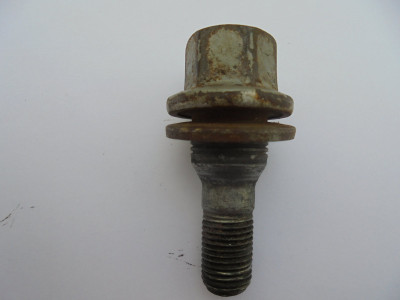

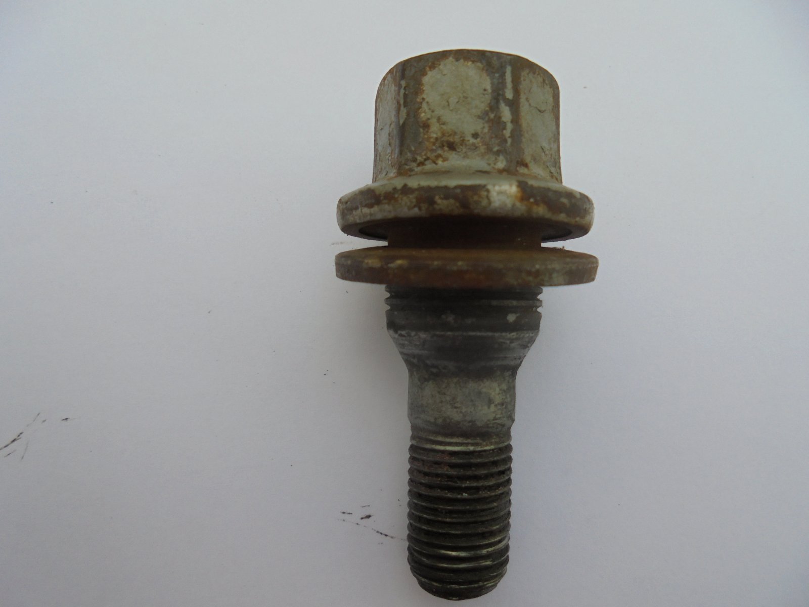

This shows the type of wheel bolt you should have for PSA alloy wheels of that vintage. Note the washer and parallel shoulder and then the tapered shank. This taper is for steel wheels if you happen to have a steel spare wheel.
Actually, the whole thread is worth a read.
