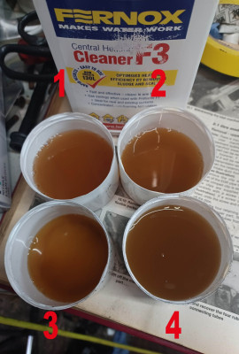

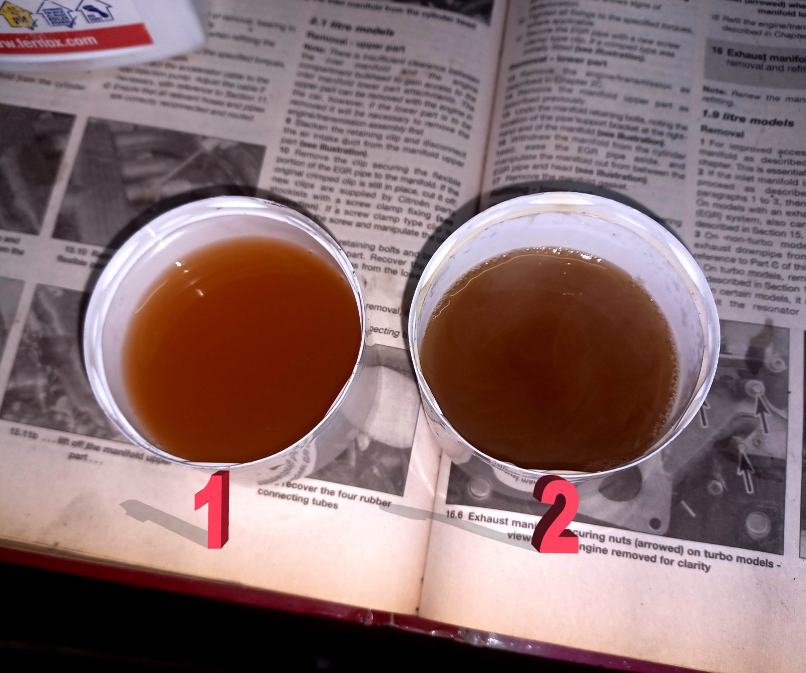

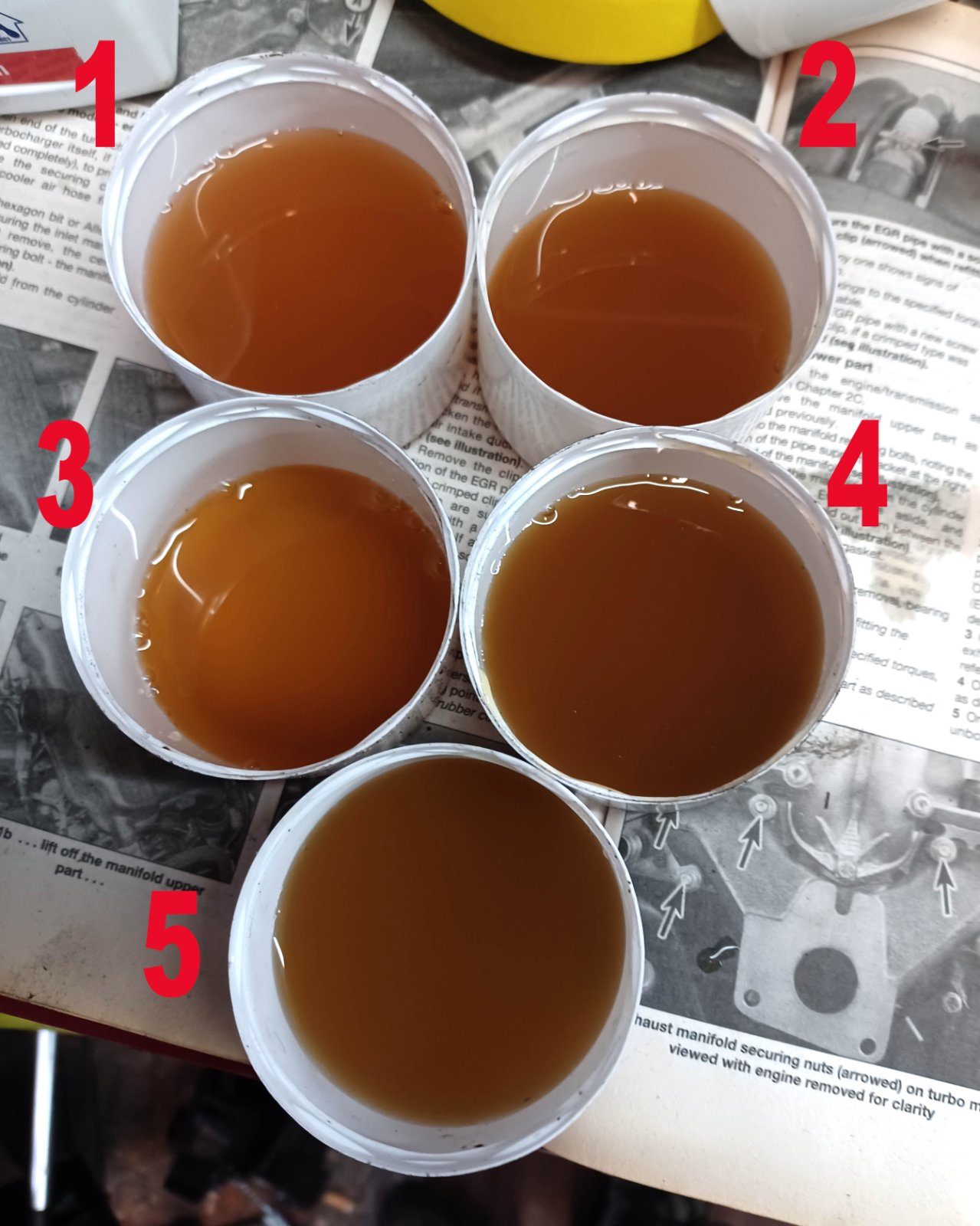

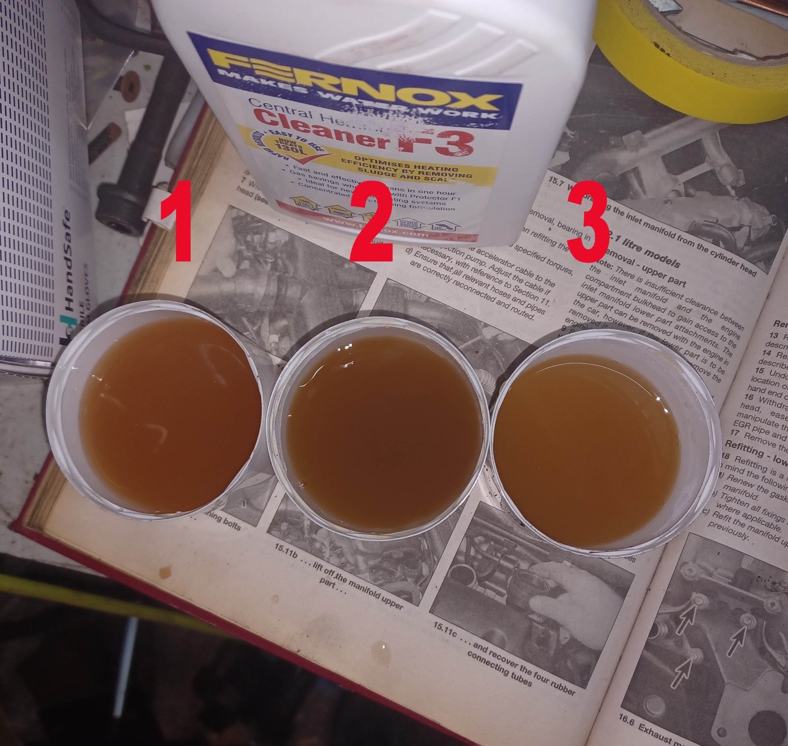

So it begins.....The Initial untreated sample....this is plain tap water which was put in 4 days ago after flushing / after Wynns "Radiator Cleaner" treatment that had been in the system for 2 days................it really does look like morning p**s :)
The FERNOX F3 has been poured in, I used 250ml of F3.
I will run the car up to temp 4 times daily with one 20 min drive checking the heater temperature and taking 100ml samples from a hot expansion tank every 24 hours for a week then I will do a coolant dump.
Will be interesting to see how this works............

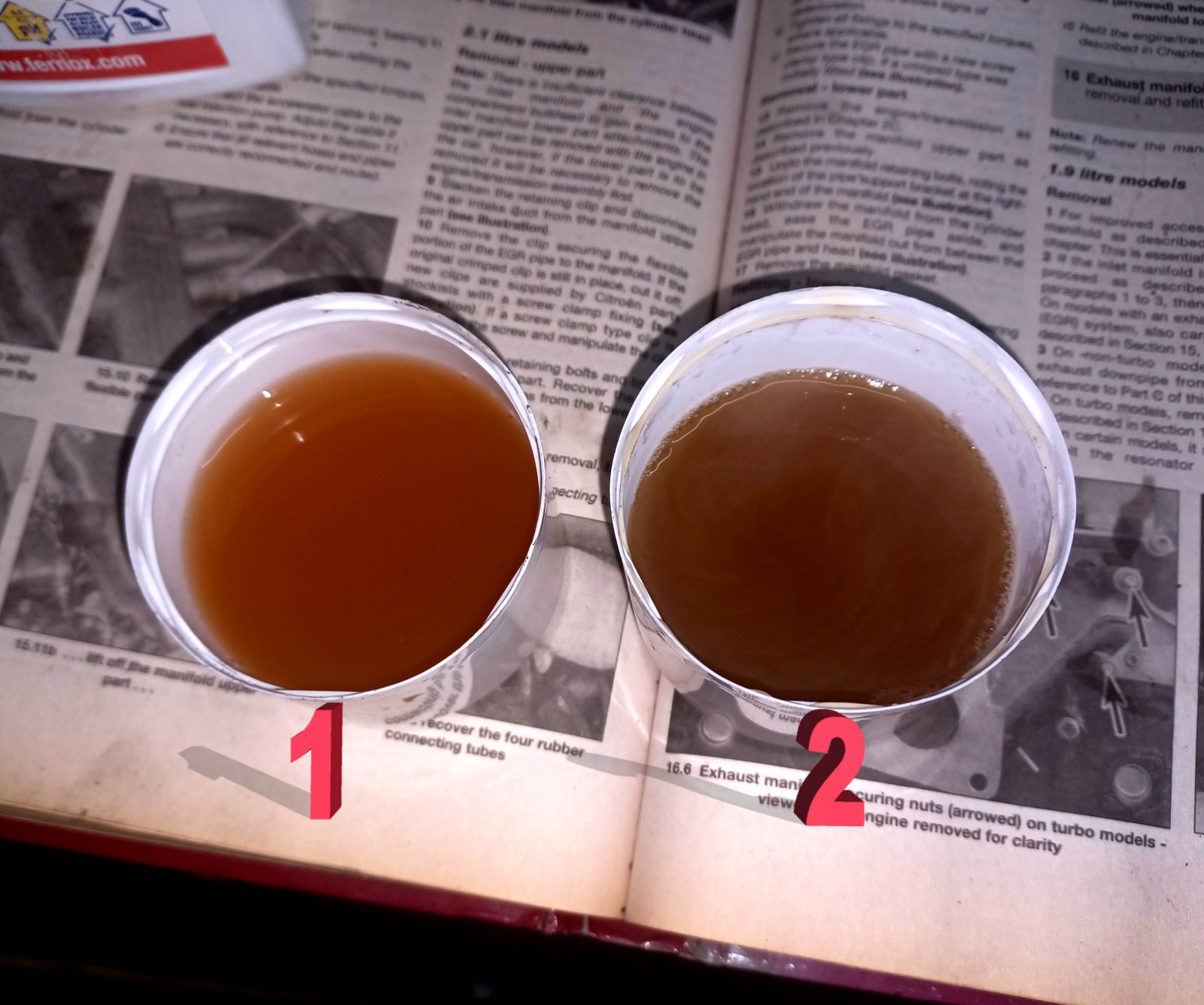

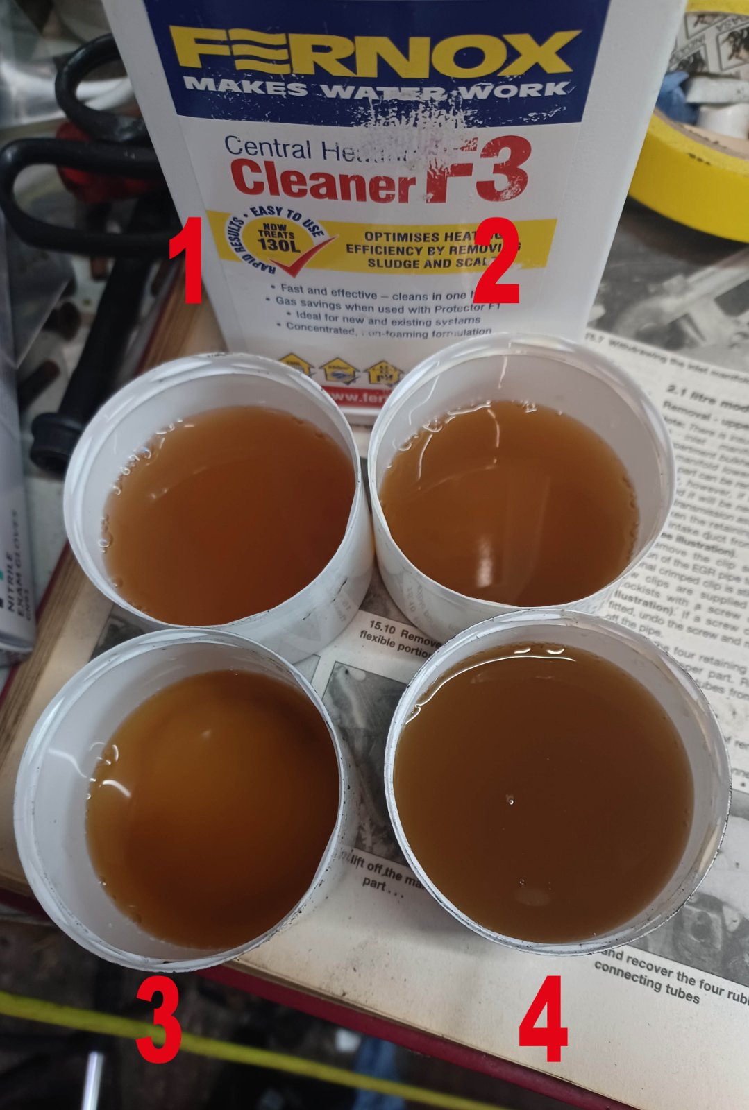

24hrs later...............
Sample No2................ sample 2 is darker a slightly more cloudy.
Did I notice a "slight" increase in temp when I put on full fan for the first time ??...not sure.
It still goes lukewarm after being on full blow for about 30 secs. Supply pipe and flow out to the matrix both reasonably hot.
Posts: 11822
Joined: 28 Mar 2013, 21:05
x 2000
Re: Xantia heater not working cold air flaps/blower
Unread post by Stickyfinger »

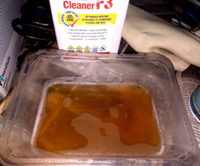

Day 3...............no change in heater temp :(
Not a lot seems to be happening at the moment.....I expected more TBH.
Note, the colour is the same/white container/flash is messing with it.
Posts: 11822
x 2000

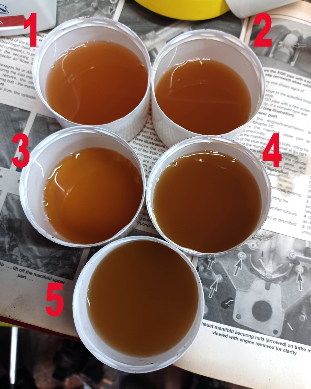

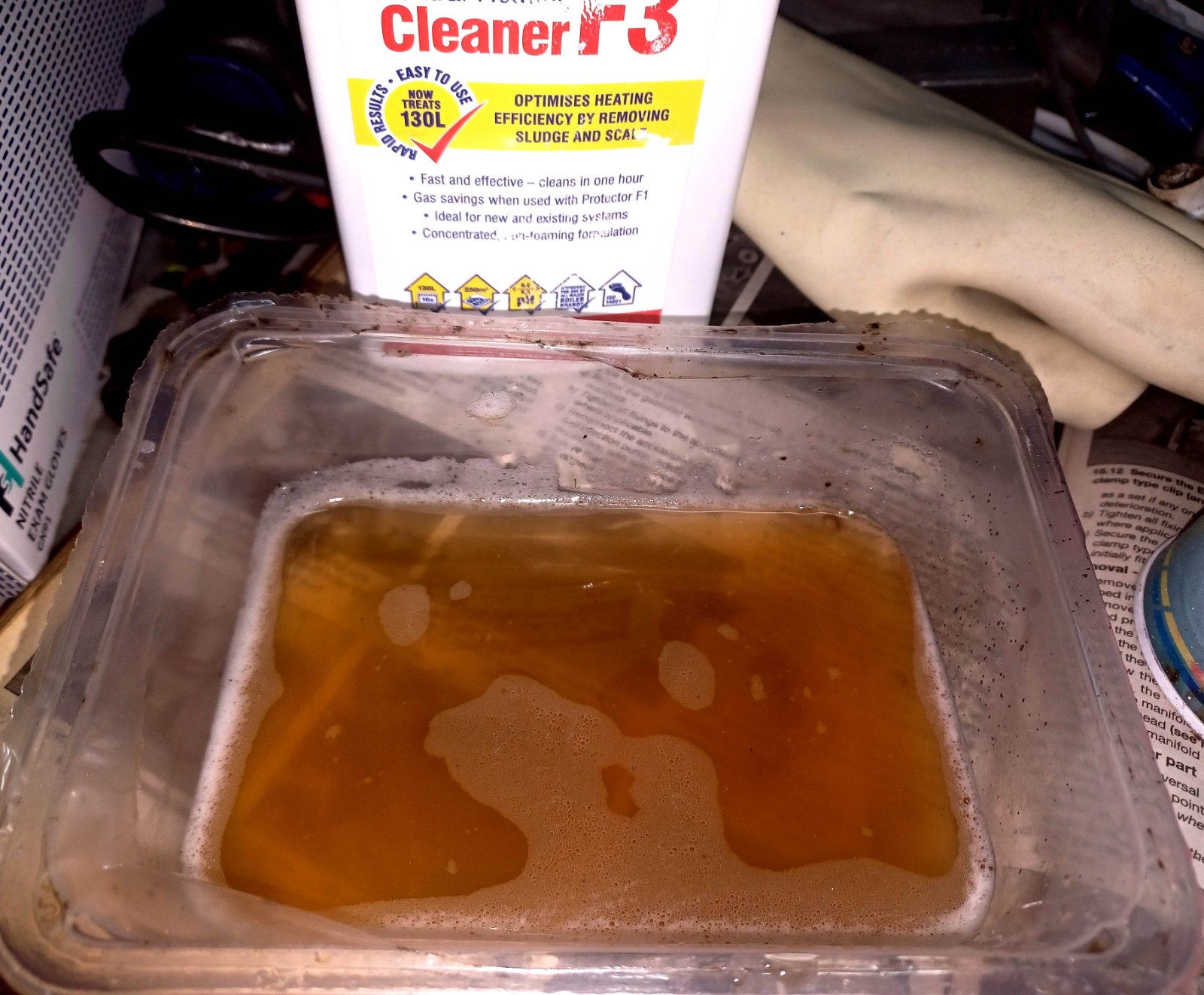

Day 4....no change in heater output yet. The water does seem to be getting more "cloudy"
Posts: 28673
x 5671
Might be worth flushing with just water and get rid of the cloudiness before continuing with Fernox.

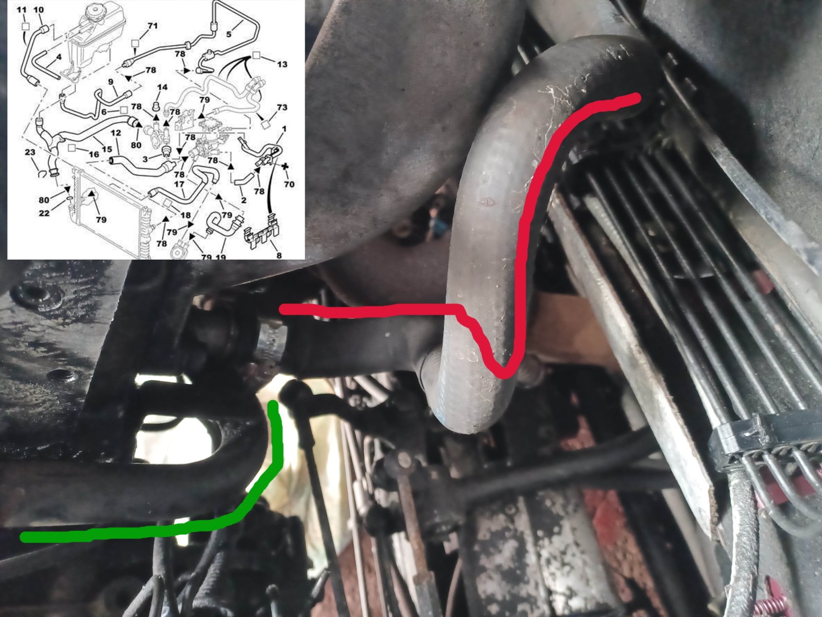

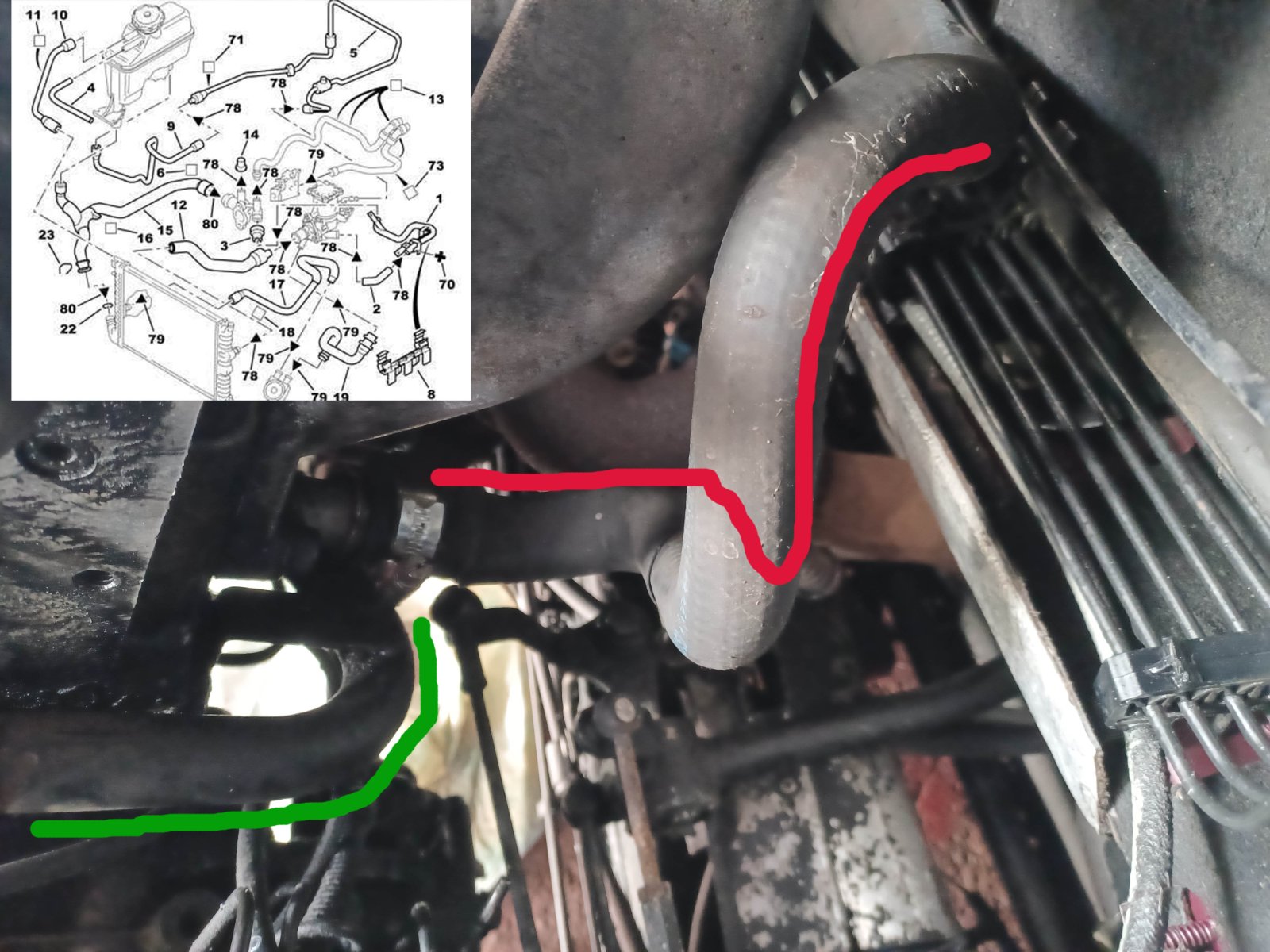

LAST chance saloon now is a back flush direct to the matrix itself.............so which pipe/hose is it ?
This is looking down the back of the engine on its left side.....red one going into the block, green one going forward to under the ?? fuel filter ??
Forum Treasurer
Posts: 12575
Joined: 07 Aug 2002, 17:12
x 1485
Unread post by RichardW »
I'd say red is the feed - hot water coming off the head; and green is the return - cold water flowing back into the water pump suction side.

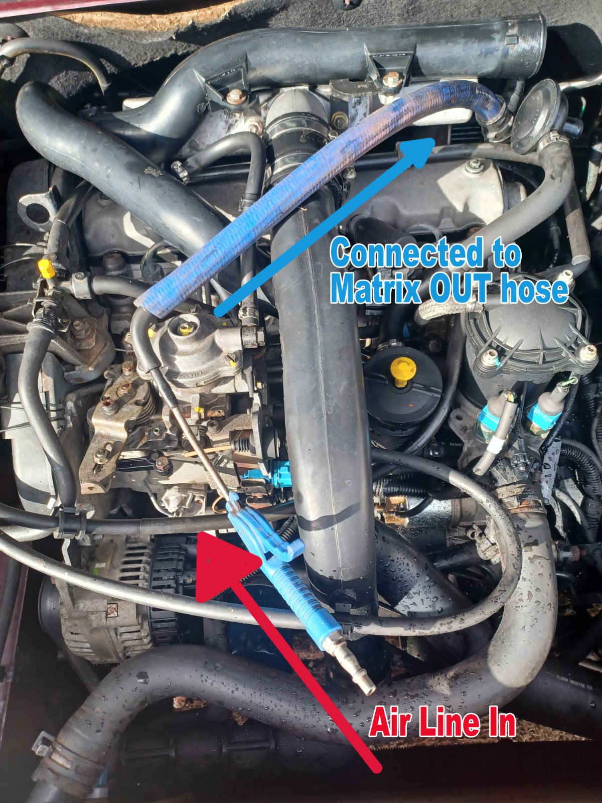

OK....this is it now......
I back flushed twice with a hose (but I have low pressure at the garage)
I connected an AirLine to the out flow hose and blew/forced the residual water head in the matrix back through it a good few times. I was gentle !
Reconnected all hoses, refilled with water and ran it up to temp
Turned on fan, LOTS more heat but that then tailed off after 30 odd seconds...this reduces to luke warm (but warmer than before)
I conclude the Matrix "U Drop" pipes are silted up from its long lay-up/this had "hardened" and the heat I get is from the top cross pipe (all be it that is now very clear thus more instant heat) heat soaking the Matrix. The "U-Drop" pipes if blocked get no flow unlike a full flow radiator such as an oil cooler.
Matrix swap (or ultrasonic clean) will be needed, this will need it to be removed which will WAIT till the summer whilst I have the ACTIVA on the road.

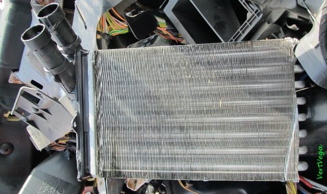

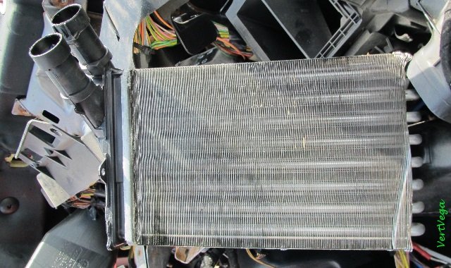

Looking at images on-line......it seems the Matrix design is cross-tubes (C) NOT drop-tubes (U).........
ONE little niggle remains....... There is still good flow/volume of water through the matrix which surprises me a bit, I would of thought blockages in the cross pipes would have reduced that..
peter306
Posts: 197
Joined: 11 Nov 2013, 12:44
x 60
Unread post by peter306 »
Hello Alasdair,
2 things, have you felt the heater hoses going into the bulkhead after the car is warmed up.
Bad news, that post you got the picture from, check the picture before that one, shows the matrix in place and it looks like the tubes drop.
