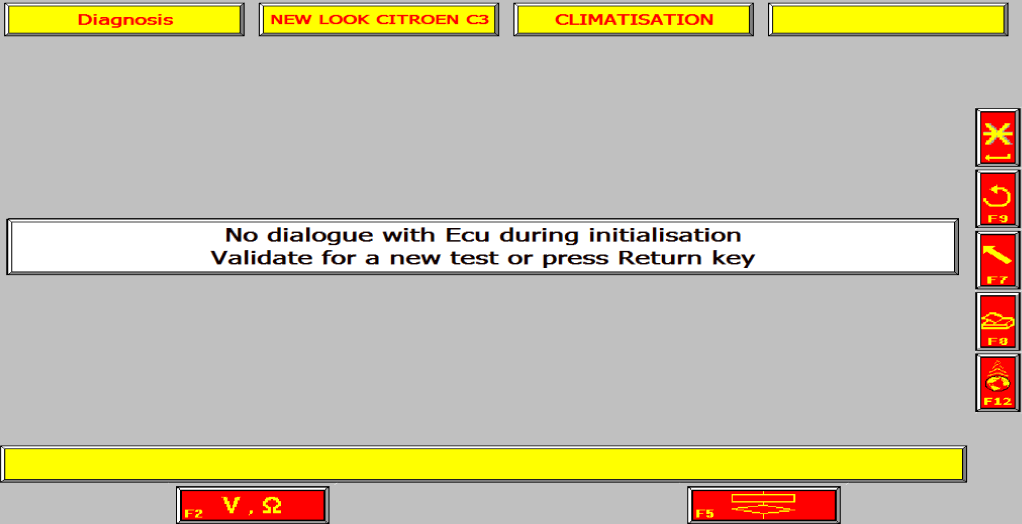

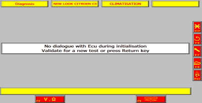

I tried connecting to the A/C ECU with Lexia to try the actuators, but Lexia refused saying there's no A/C present.

So let me get this straight. When the AC works the AC ECU appears in LEXIA? And when the AC is not working, the AC ECU disappears in LEXIA?

Have we established that LEXIA cant see the AC ECU when the AC stops working? AND, that LEXIA can see the AC ECU when the AC is working?

I just connected Lexia to the car and run the global diagnosis as well as the specific component diagnosis. In both cases the response from the A/C ECU is the same (shown in picture below). Just so we're clear, this is the control panel/ECU for the A/C. And this is the BSI that sits on the side of the battery under the hood. I taped a video of what happens with the back lights of the control panel at the same time as trying to dialogue with the A/C ECU. Unfortunately I cannot upload it. But what happens is the following. After turning on the lights with the stick on the left of the steering wheel, the radio and the control panel light up (the back lights). If I turn the lights off, the control panel back lights turn off. They do not turn on/off on their own nor they are all the time on or off. Same thing happens with all the other buttons. After pressing the AC button it lights up in green, so does the rear defrost but in orange and the recirculating option in red. When turning middle knob on to 1, 2, 3 or 4, air starts to come out of the vents. But the A/C compressor does not kick in. There's no "clack" sound coming from it.

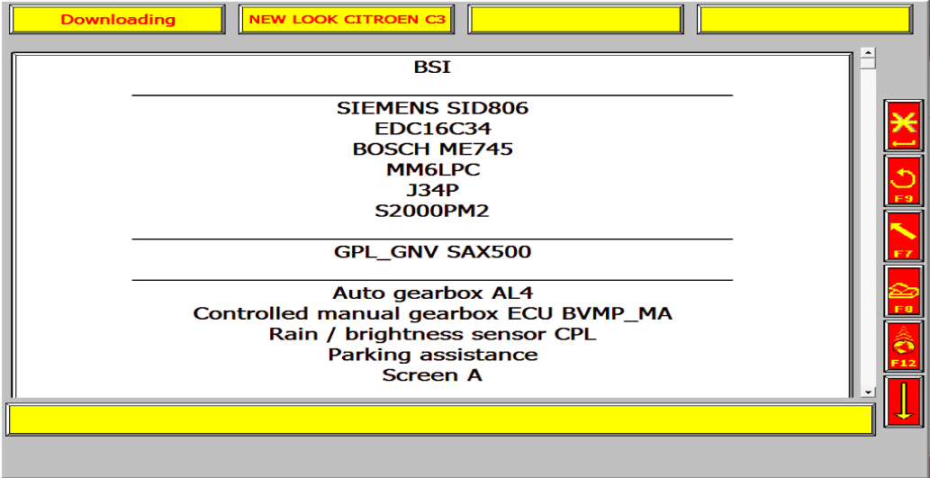

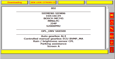

There's an option in Lexia to show the available ECUs and it shows the following. No idea if the A/C ECU is part of any of those. Googling all those codes brought up images of the BSI posted above or similar.

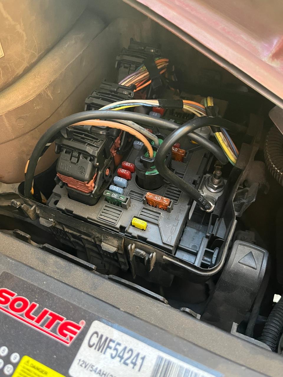

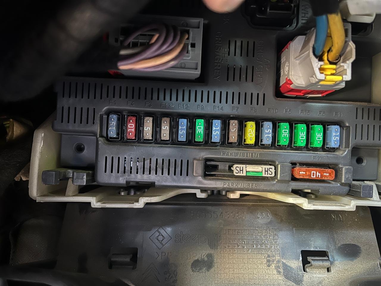

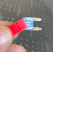

I also took a look at the fuse box under the steering wheel and it only has one fuse which I believe is 5 amps. According to my car's manual it is either the Cigarette Lighter/Digital Clock/Roof Lights/Passenger Mirror fuse, or the Digital Clock/Steering Wheel Controls/Radio/Indicators fuse. The curios thing is that the manual states that these fuses should be 30A and 20A respectively, not 5A. I pulled the fuse off and tested the roof lights, the radio, the control panel, turned the engine on/off, the cigarette lighter... everything worked fine without the fuse. I would have expected nothing to work. I really have no idea what this fuse is protecting. The only 5A fuse according to the manual is the airbags, but should be located in another position. My car has airbags...
There are more fuses under the hood, but the manual does not relate anyone to the A/C.

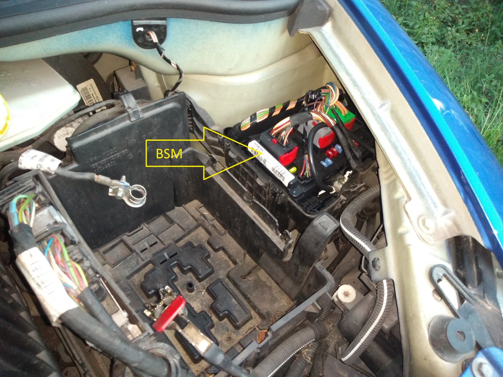

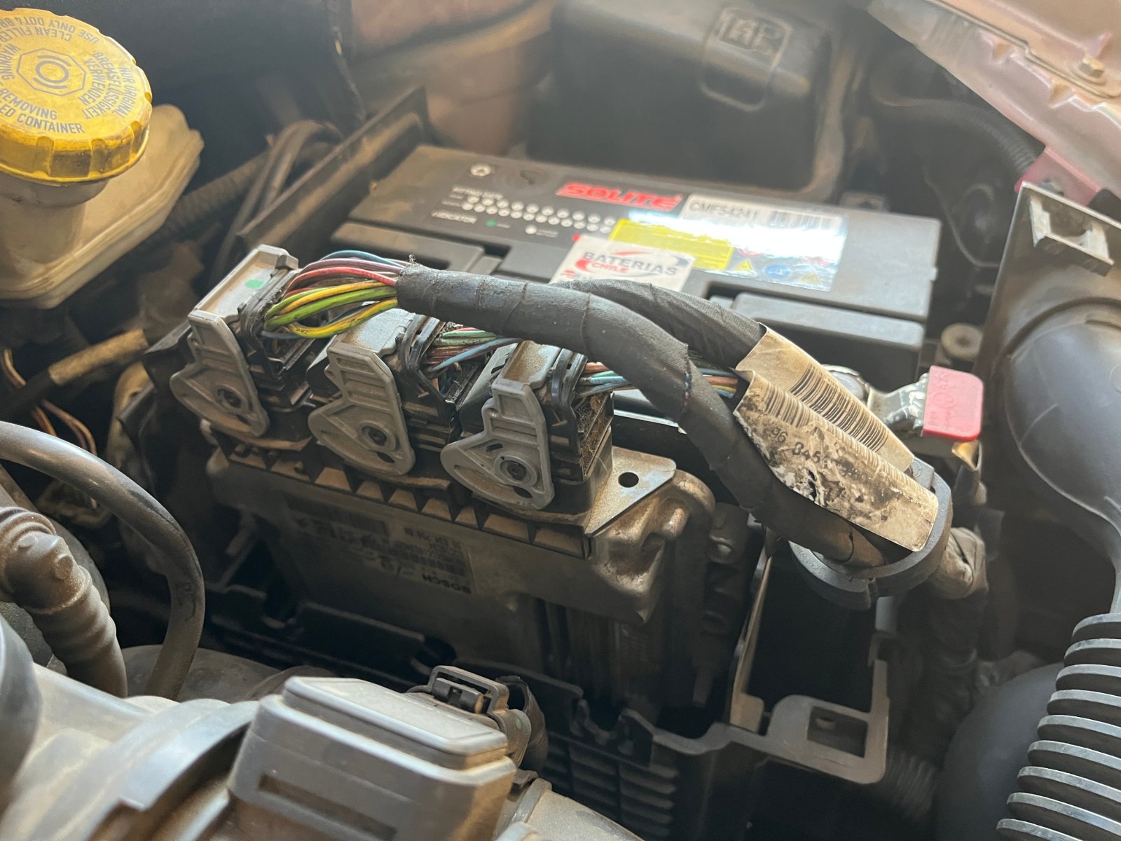

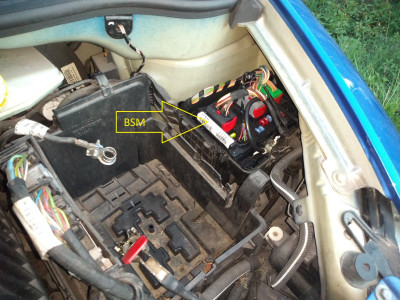

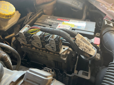

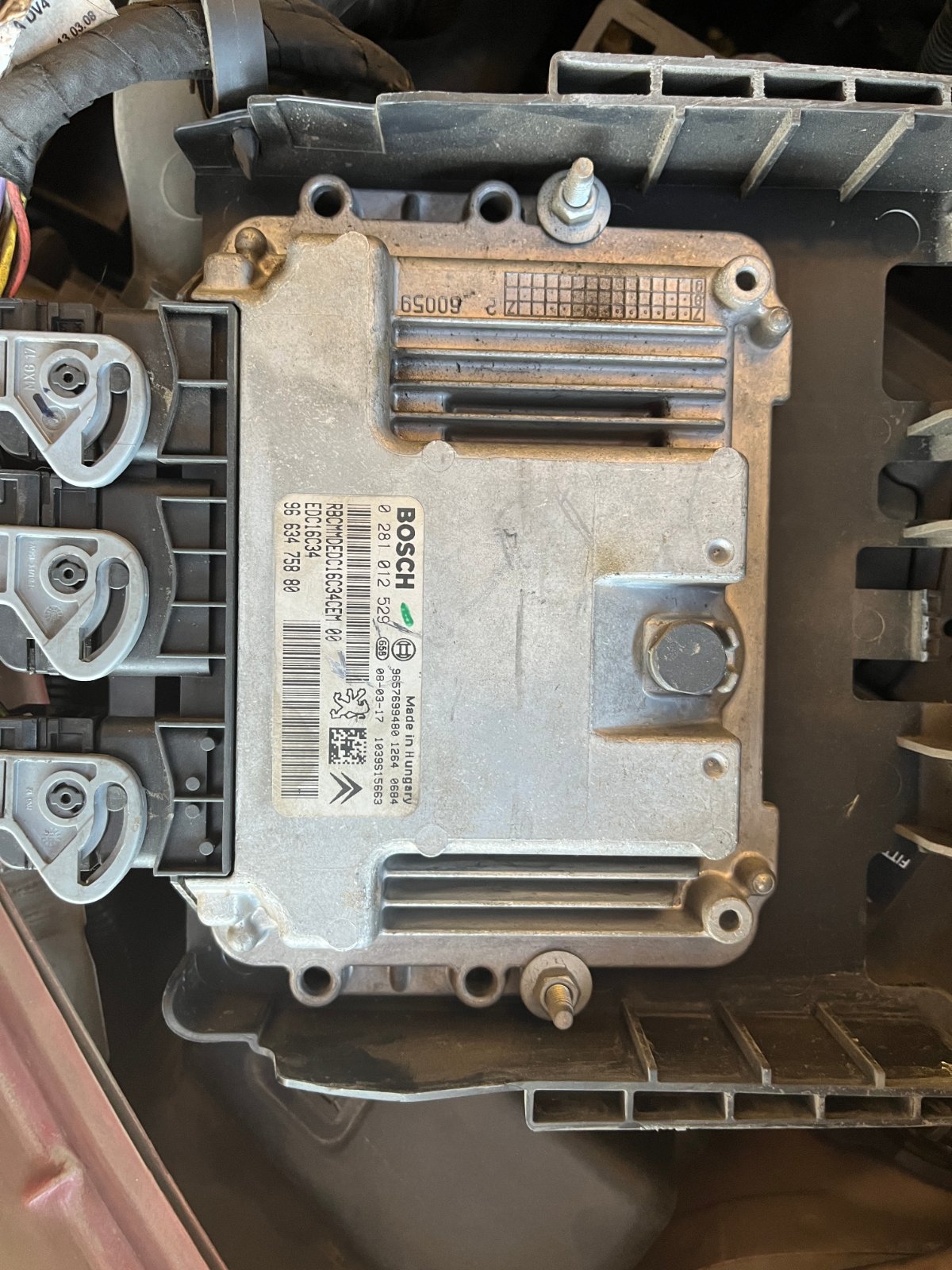

Next. The device in your pictures is the engine ECU. While it can shut the AC down, it's not relevant to this discussion.
This is the BSM and it's location. I have removed the battery and cover for clarity. This is a MK1 BSM. Your electrical connectors will be different colours and shapes. But this is where it's located.

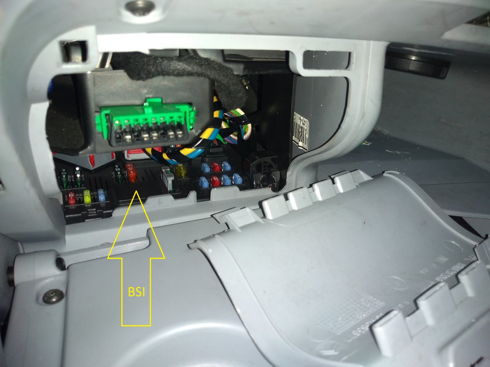

This is the BSI. It's on the left hand side of the cabin. It's in the glovebox of a right hand drive car. Next to the steering wheel of a left hand drive car. In your case, its under that fuse block.

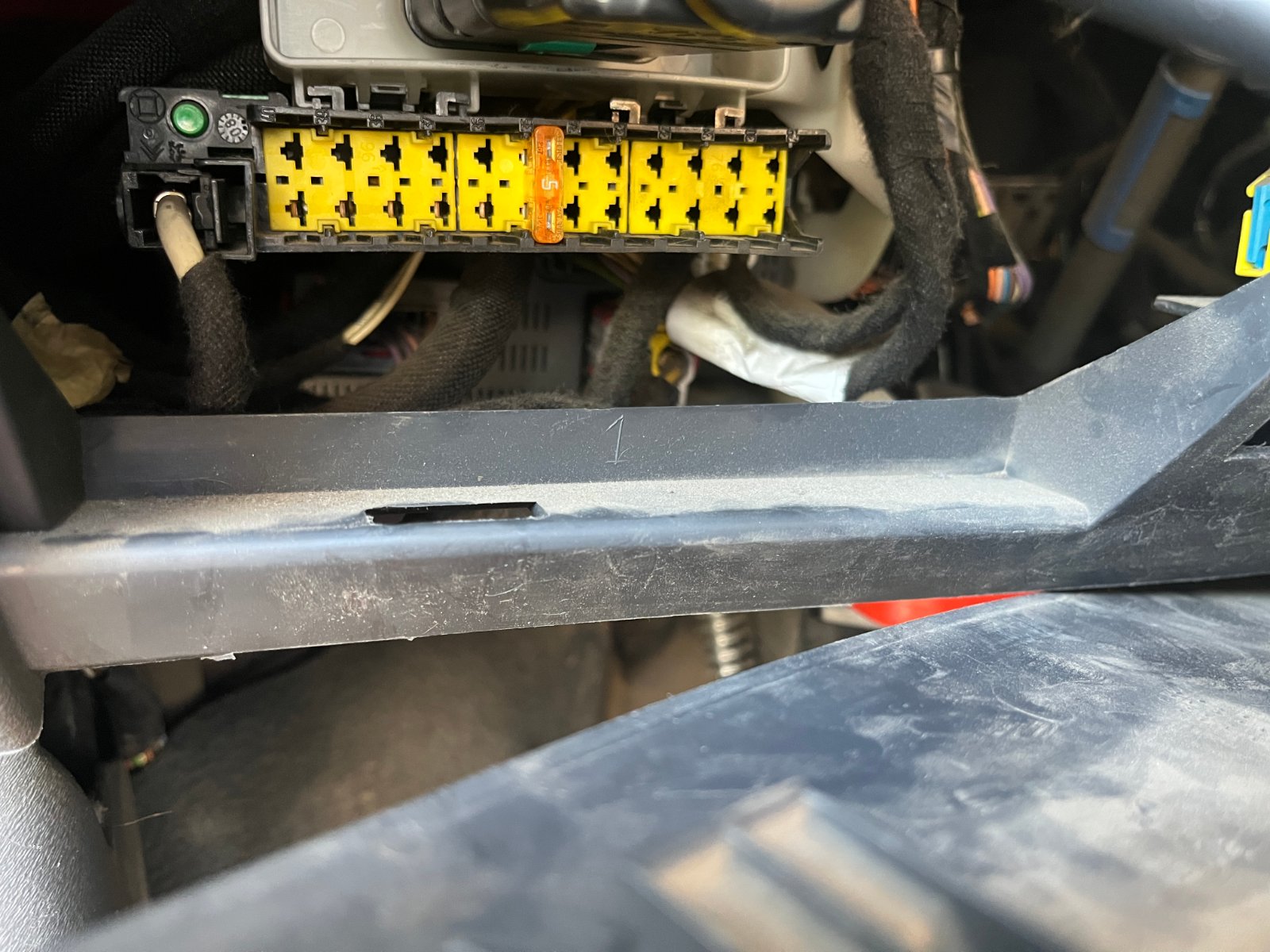

Thanks for all your explanations. Based on that, below are pics of my C3's BSI and BSM, respectively. This is a 2008 C3, diesel engine, steering-wheel on the left side. I'm now quite clear as how the whole A/C system works and the roles played by each part in the process.

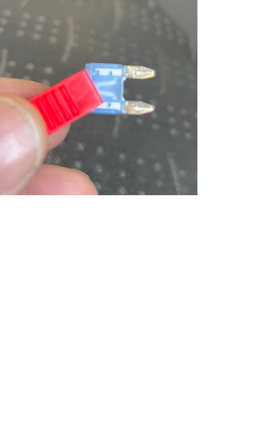

Now that I've found the fuses
I pulled F14 (Blue, 15Amp) just for the sake of it and checked it. According to my car's manual this fuse is in the A/C circuit, and it also appears on the circuit diagram you provided. As expected, the fuse is OK.

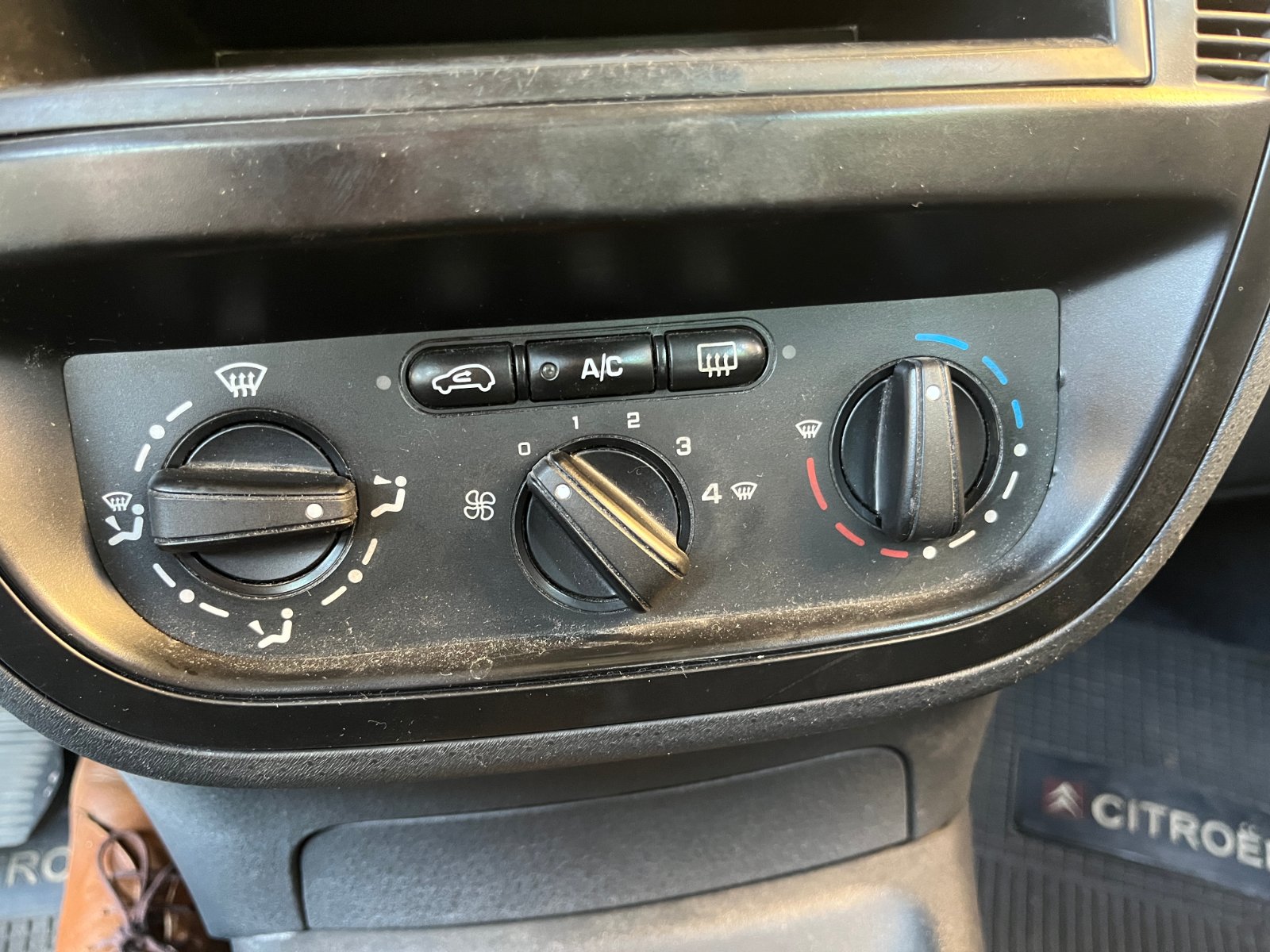

Just to summarize, my A/C is manual as can be seen in the images posted before. Also, in the past (as of the end of January) the compressor kicked-in and I could see the A/C ECU in Lexia. As of today, the compressor does not kick-in (tried both with the engine on and off) and I cannot see the A/C ECU in Lexia (again, tried both with the engine on and off).

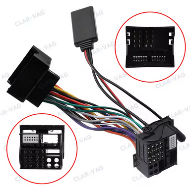

The only change I can recall between January and today is that I installed a Bluetooth adapter to the car's radio to have a hands-free unit paired to my mobile. This is what I installed:
As can be seen, the BT adapter has a bridge harness. The original harness connects to the bridge, and the new harness that connects directly to the radio receives the BT adapter connector. After physically connecting, the Aux1 port has to be enabled in the radio with Lexia. I must say it works like a charm! I was careful not to change any other configurations.
I strongly doubt it, but could it be that either this bridge harness is somehow affecting the dialogue with the A/C ECU? Or that during the installation either the connector to the control panel or a CAN BUS cable was damaged?

I honestly don't know. If it's the type of adaptor I'm thinking of, it just acts like it's the CD stacker. However the CAN BUS does pass through the radio to the CD stacker, so I guess it's possible. I would attempt to put everything back to "stock" including "removing" the CD stacker in LEXIA.areid wrote: 12 Mar 2025, 21:13 The only change I can recall between January and today is that I installed a Bluetooth adapter to the car's radio to have a hands-free unit paired to my mobile.
No, I doubt that. The panel effectively works, it listens but wont talk on the BUS.areid wrote: 12 Mar 2025, 21:13 Or that during the installation either the connector to the control panel or a CAN BUS cable was damaged?

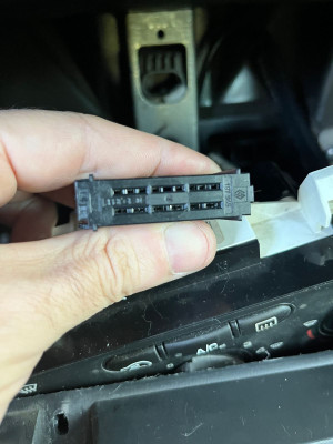

First, took out the radio, disconnected the bridge harness that has the BT unit attached to it, and connected the radio again with the original harness. Fired Lexia. A/C still does not show up, as expected.

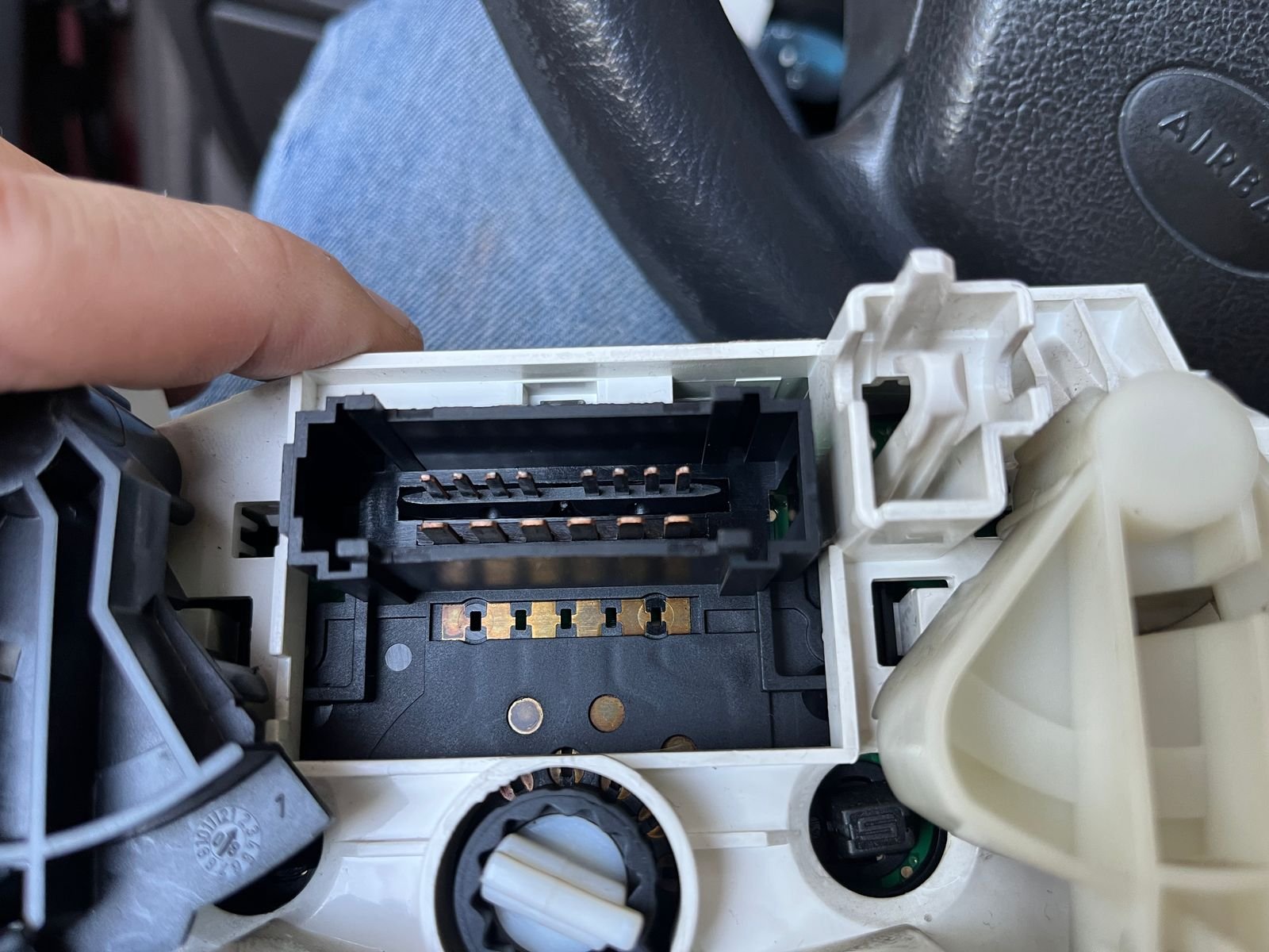

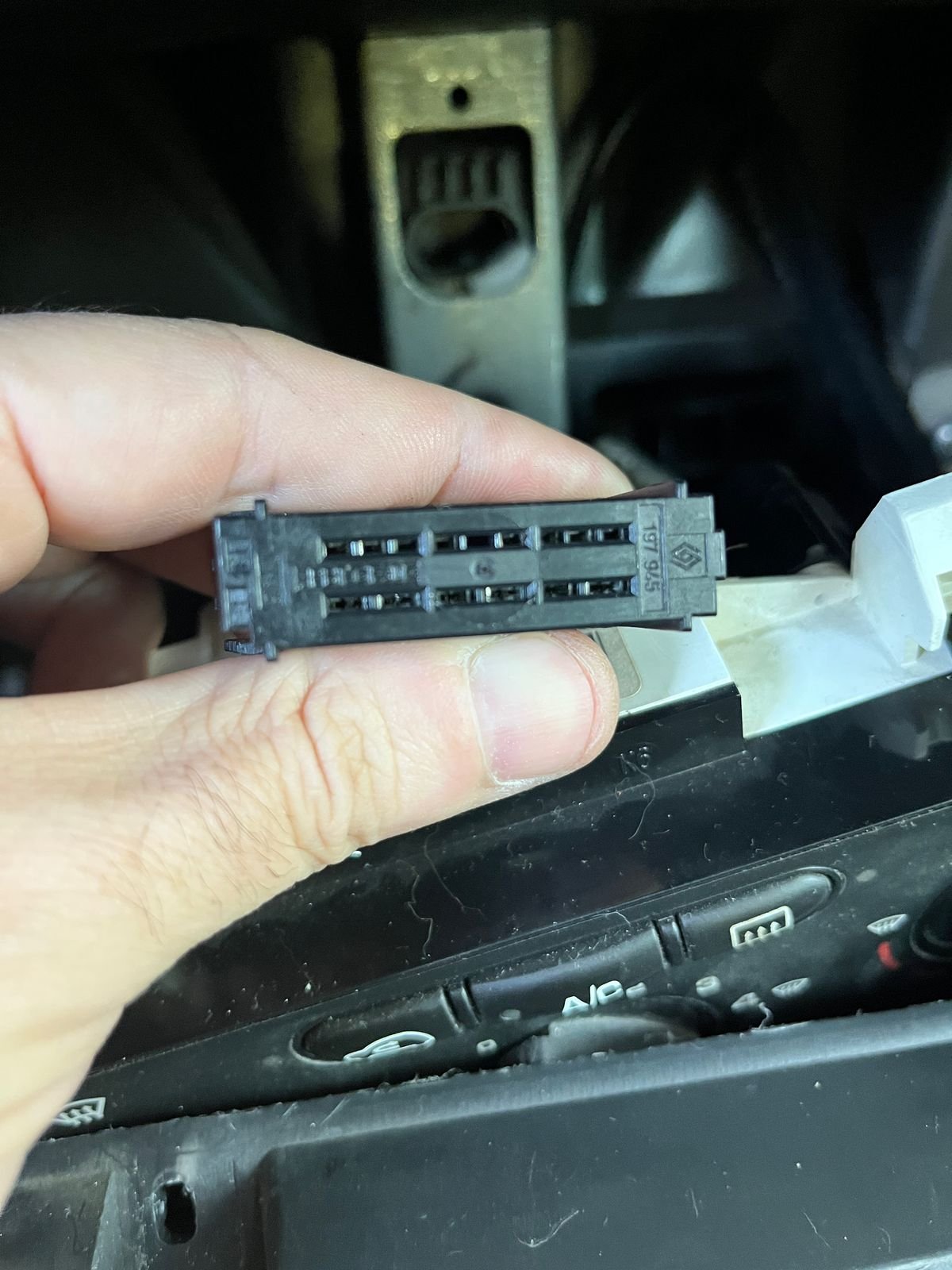

Second, I was able to pull the control panel out.

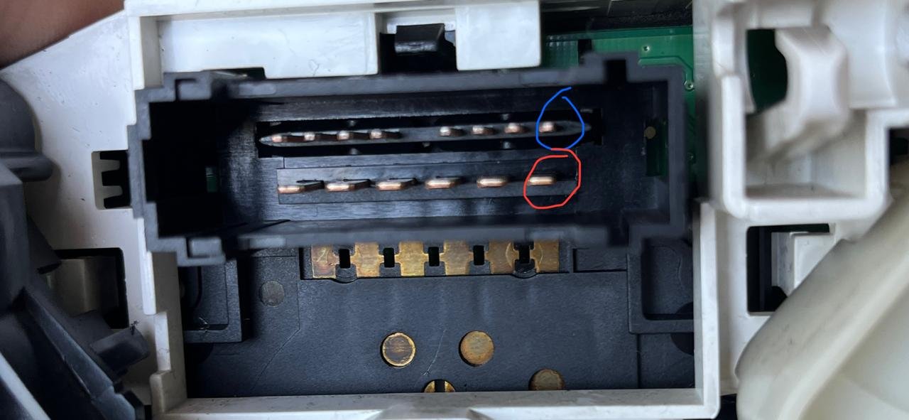

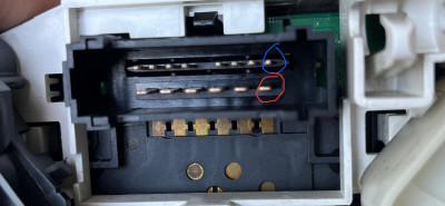

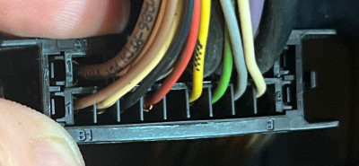

This is the connector And this is the back of the A/C Control Panel. Tried checking for continuity on all the pins in the control panel, but got no response. No idea if I did it correctly, probably not.
The same with the connector. Engine off, no key in the ignition. My leads are too thick to fit into the slots.

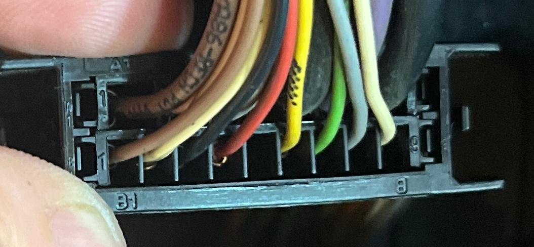

How can I know which pin is which as per the schematic? This is a two level connector and the schematic shows everything as a flat connector.
Thanks
Thanks

Take another look at the first diagram, item 8025.
They are labeled on the panel as "rows". That is; row A and row B. A1, A2 and so on. Then B1, B2 and so on. So "top" row and "bottom" row. A hint is there are only 6 "A" pins but 8 "B" pins on the schematic.
BUT on the connector they are labeled, pin1, pin2 through to pin15. HOWEVER, pin15 is not used. So that should give you a hint. The numbering usually goes around in a circle.
Usually the connectors are labeled with at least 2 pins, the first and the last. Sometimes the first of a row and the last of a row. Cant see that printed on the face of the connector but the numbers may be some place else on the connector.
There are 2 earths on the connector, pin6 and pin7. I would make sure they have a good connection to metal parts of the chassis.
Have you done a BSI reset with the radio re-installed? look up "BSI reset" on this site.
Is the radio aftermarket or stock?
areid
- Posts: 17
- Joined: 02 Jan 2025, 16:02
Re: Citroen c3 2008 No AC detected by Lexia
Thanks for that. The radio is stock. Have not tried a BSI reset, but will.
Was able to get a closer picture of the back of the connector with the labels for each row. So looking at the back of the control panel, pin A1 would be in the bottom row in the rightmost position (red circle) and pin B1 in the top row in the rightmost position (red circle). Could not find an indication of pin number in the connector except for the 1 on each row, but with the schematics I can infer that pin 6 refers to A6 and and pin 7 refers to B3. Tested those pins for conductivity connect one probe to pin 6 and the other probe to a metal part of the chassis. The same goes for pin 7. Pin 6 (A6) gave a close to zero result measuring conductivity, while pin 7 (B3) showed a 1900 figure measuring conductivity. Are this figures correct/expected?
The schematics have three thicker lines in pins 7 (B3), 8 (B1) and 10 (B2). Are all of those ground connections as well?
How do I test the other parts of the connector and the control panel? I recall you were looking at a signal that the A/C ECU was "listening" but not "talking". I played around a bit with the control panel and a multimeter and got numbers like 1500 or 1600 when touching some B pins, which is a reflection of high resistance in the circuit. Nothing came out of A pins. Besides that, I have no idea what I'm doing.
BSI reset was completed but don’t want to assemble anything back before more testing on the control panel.
ozvtr
- Posts: 881
- Joined: 13 Oct 2020, 01:11
- x 244
The thick lines (in the circuit diagram) B3 and B1 are the CAN BUS lines.
There CAN NOT be anything wrong with the CAN BUS or lines. 1) The instrument cluster (labled 0004 on the circuit diagram) is on that line. Any problems would cause the instrumentation not to work. 2) The back lights on the panel come on when commanded by the headlight switch.
The next thick line, B2, is power. Again, this is supplying power to the instrument cluster. Again, the backlights work and everything else works. So it has power and ground.
And you have checked both grounds.
The only odd wire is the one going from B6 to pin7 of the 10 pin black connector of the BSI. I don't know what this is doing.
Does the interior fan work? Can't remember if you told me that? All the speeds work?
I am beginning to suspect that the AC ECU not showing up on LEXIA is a red herring!
Have you looked for power on pin1 of the 5 pin yellow connector of the BSM with the AC on and engine running? Can't remember if we have gone down that path.

Pin 1 of the yellow connector powers the clutch. If you have no power there, you won't have any at the clutch.
I also think that you can run the clutch actuator test from the BSI. I would find the clutch actuator test first.
Also look for AC system inhibited or not inhibited in the BSI.

How do you get a probe into the JN 5 pin connector? The connector only has 3 wires coming out of it, but the wires have some sort of seal at the connector. Also, how do you pull that connector out?
My guess goes to the connector at the compressor, or the compressor itself.
