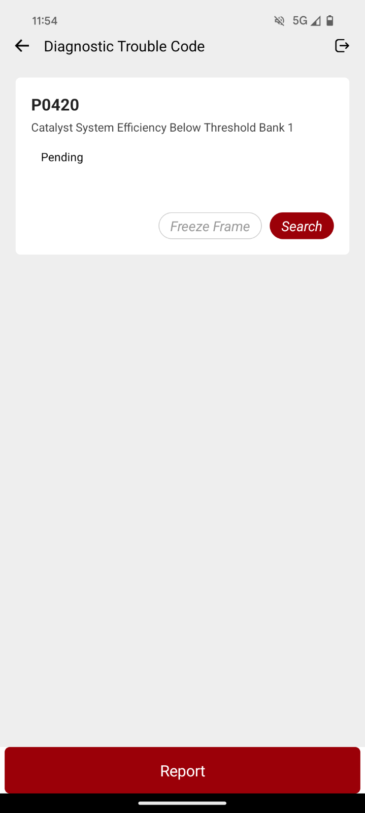

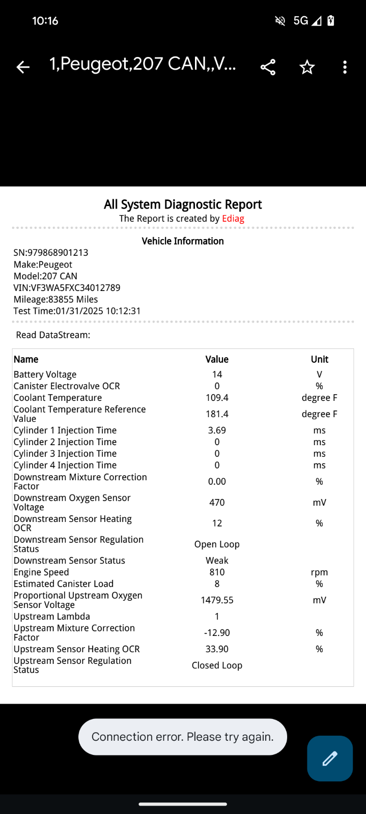

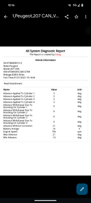

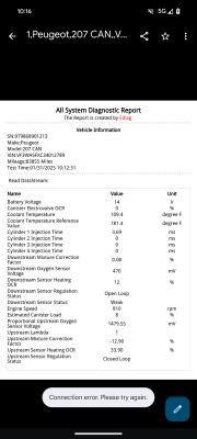

Cat code again, not had this recently though. I had noticed on live data that the sensor after the cat the signal reads as weak? Wonder if it's worth changing both and seeing if that makes anything difference, I have tried some cat cleaner in the fuel twice already to try clean it

If you look at live data, the catalyst inlet lambda sensor should be constantly switching and the outlet one should be fairly steady. If the outlet one is also switching it most likely means the catalyst needs replacing.

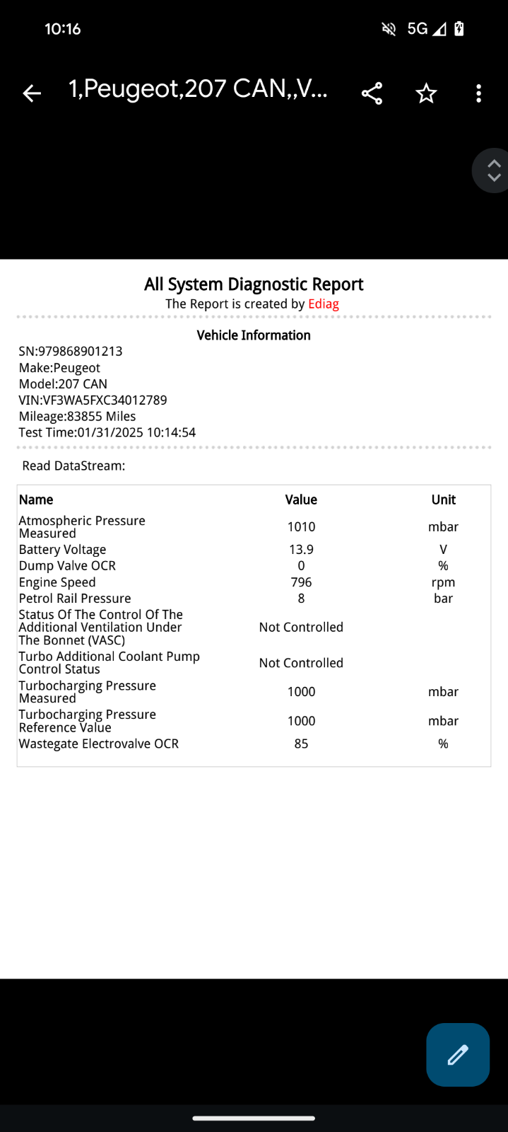

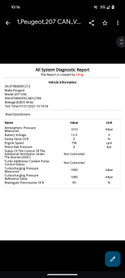

Fuel pressure at idle jumps anywhere from 44 to 52 bar, you can feel it at idle. I can replace the pump myself so wondering if its worth giving that a go, was reading the hpfp are common on these?

When it is idling smoothly the pressure is more stable
