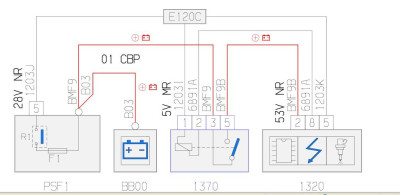

psf1 = Engine F/Box
1370 = Engine Mangement single Relay
1320 = Ecu
1320 = Ecu

You sure this diagram is correct? would be unusual to have an external injection relay on this age of car never mind a 5 pin one? Even the older ones pre BSM were 15 pin 'double' relays.
Where does the diagram show 1370 being located?

I can't comment on that being the right circuit or not, but either way that's only a partial circuit (very limited function) What is it labelled as being the circuit for?

Ref whether you should have power at pin 2 with just ignition on, impossible to say from that circuit because it is only a partial circuit - Where does E120C go? Without a supply from that connector onto Pin 1 of the single relay, you would get no output from the relay. And without the rest of the circuit, we don't know what turns on the feed from connector E120C/in what state it would be live. We also don't know what pin 8 at the ECU is meant to provide - is it meant to be +12v or ground, or a signal etc?

So with reference to the circuit on the previous page, what have you confirmed at the ECU? No +12v on pin..?On advice of electrician checked the supply feed to the ECU. Nothing but..
And just to be clear, from what you've said, I assume this was checked during ignition on only (not during crank), yes?
Did you check all other pins at the ECU (in case that circuit schematic is wrong) or just check in accordance with that circuit schematic alone?
If you have the ECU unplugged, then on the basis of that circuit schematic, the ground to pin 2 on the single engine relay will be lost, which means that relay won't close, which means there will be no output from the single relay to the ECU (which means you wouldn't ever get +12v on pin 2 at the ECU). So no, I'm afraid you do need to test for power/ground at the ECU with it plugged in (or provide a temporary direct ground to pin 5 on the ECU plug).. Also I am checking on the plug and battery negative i.e. the plug is not on the ECU. I don't think that will make a difference but again if you know different please let me know.

The Relay is identfied as a seperate item on the electrical diagrams but as you pointed out, in reality it is integral to the "Fusebox". I've not been able to find a location on any Forum, website or drawing. The local Peugeot dealer was also stumpted. I've checked the wiring harness between the Fusebox and the ECU, there is only harness, no other items. The diagrams are from the Servicebox. What I have shown is a Snip from the very large schematic. It is accurate for other items I've been checking (coil, injectors, etc.)
And just to be clear, from what you've said, I assume this was checked during ignition on only (not during crank), yes? Correct. Checked against the Schematic only. Unless some indication otherwise, I'll assume information in ServicBox is correct.
If you have the ECU unplugged, then on the basis of that circuit schematic, the ground to pin 2 on the single engine relay will be lost, which means that relay won't close, which means there will be no output from the single relay to the ECU (which means you wouldn't ever get +12v on pin 2 at the ECU). So no, I'm afraid you do need to test for power/ground at the ECU with it plugged in (or provide a temporary direct ground to pin 5 on the ECU plug). I think I understand the point your making and I will retest for this tomorrow.

If the wire number & pin location on the ECU plug match the diagram i would give that wire at the ECU connector a (fused) 12v feed & see if the engine starts.
