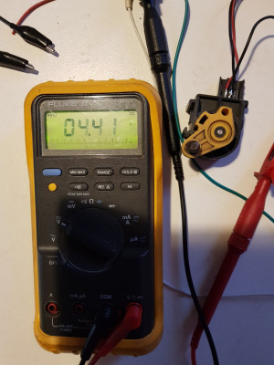

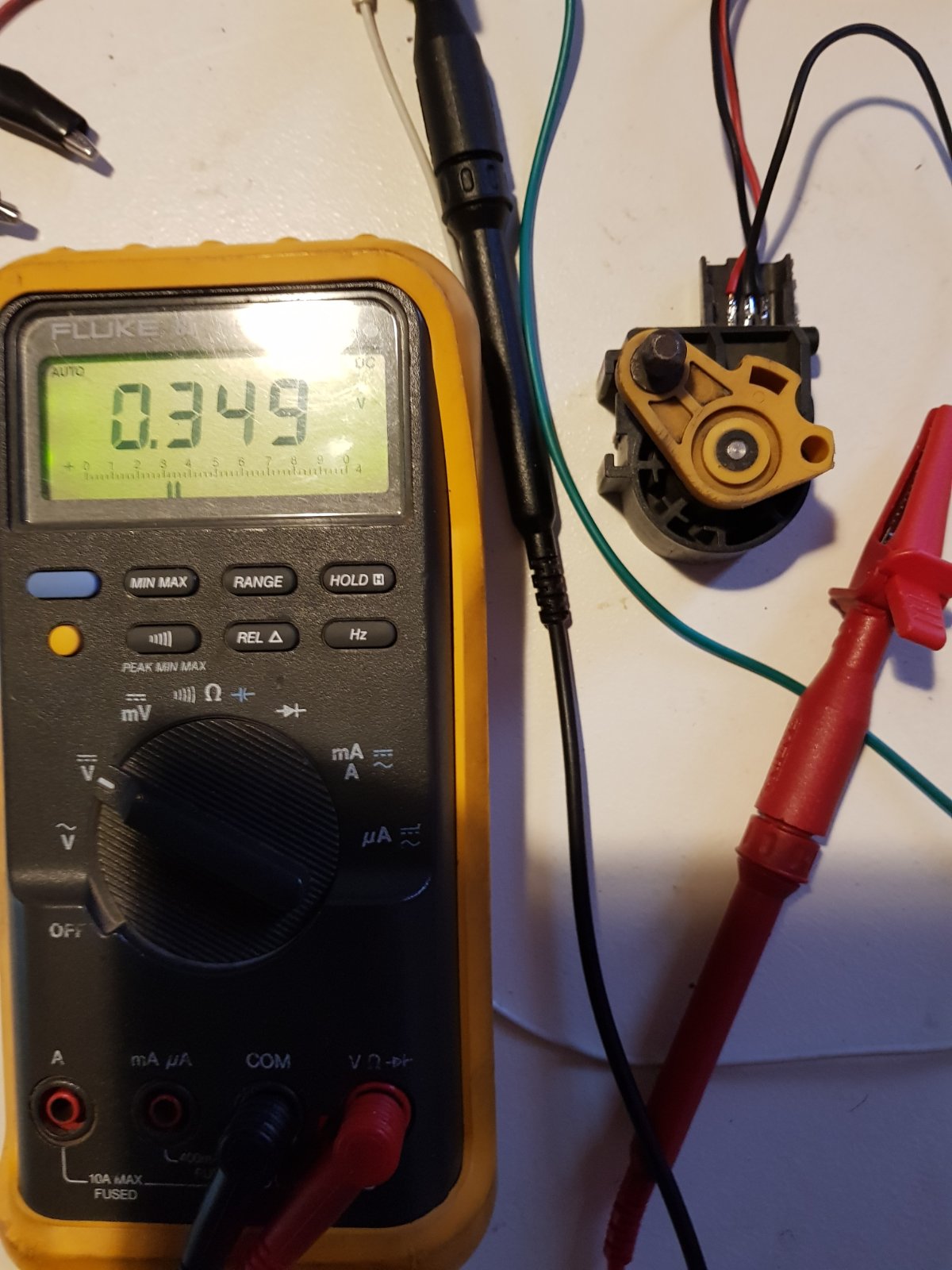

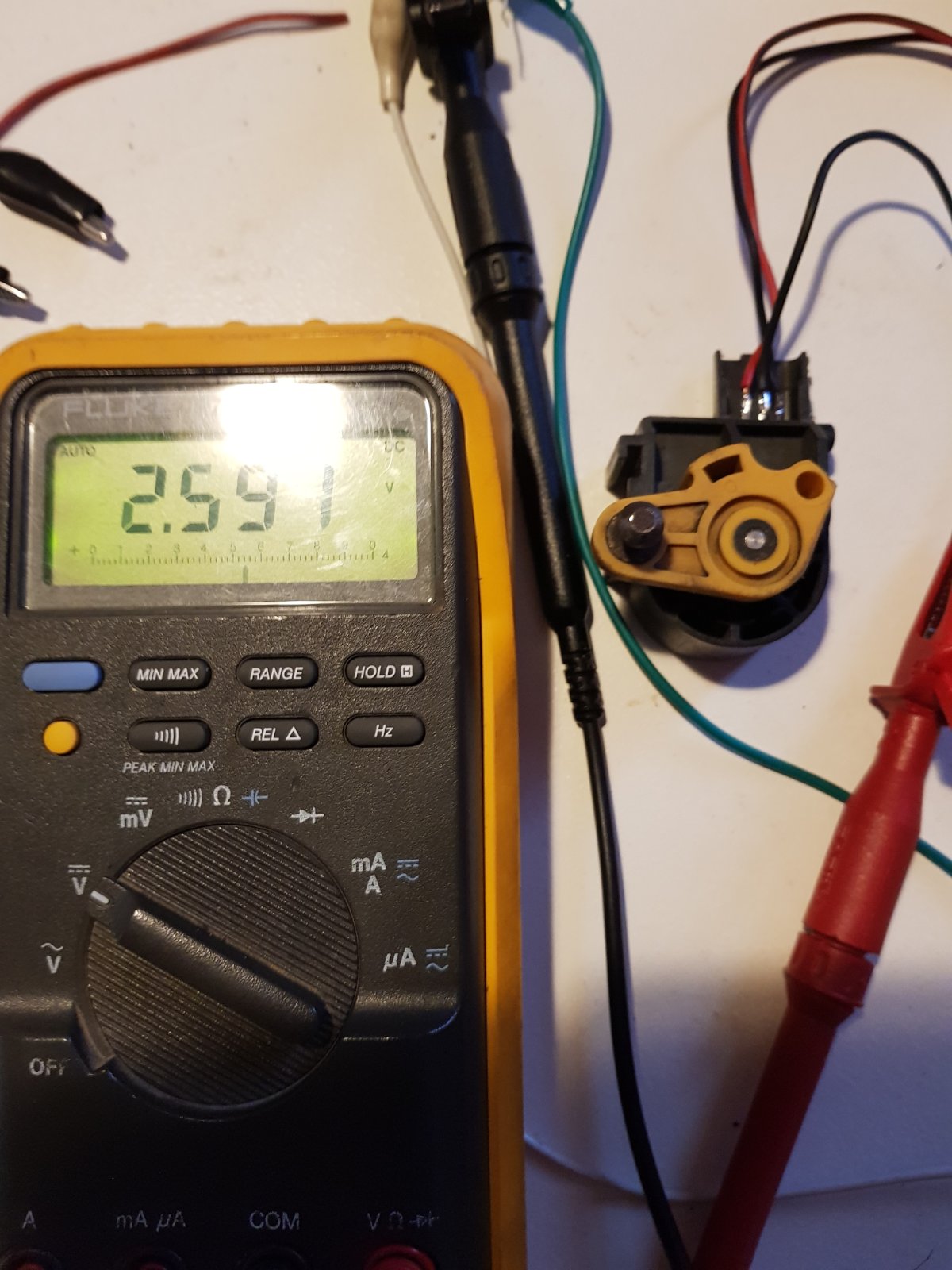

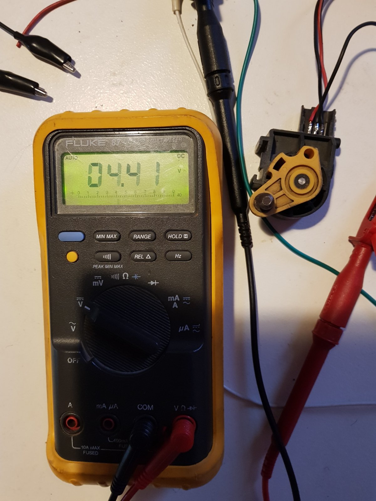

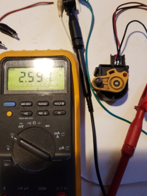

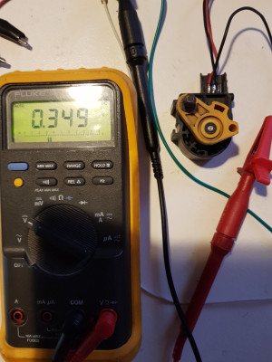

Here you can see the difference between the position and readout.
Because i used the yellow one it's possible that the blue one has opposite readout.
This is why you get the error message from the diagbox.
Because when the position is wrong, the value is out of range.
Greetings,
Kees.
Greetings,
Kees.
