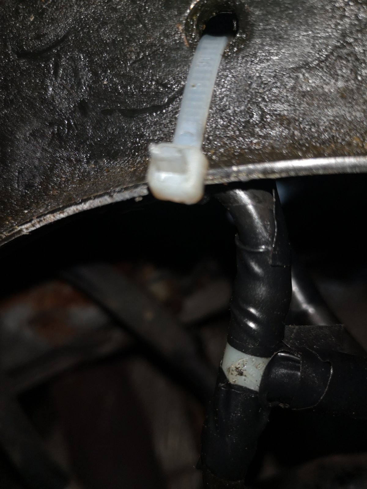

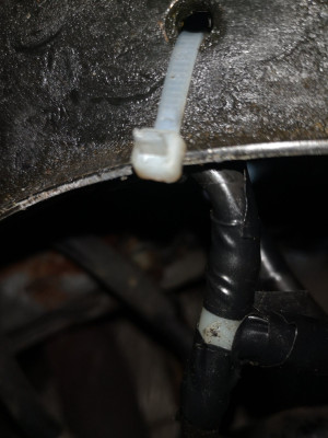

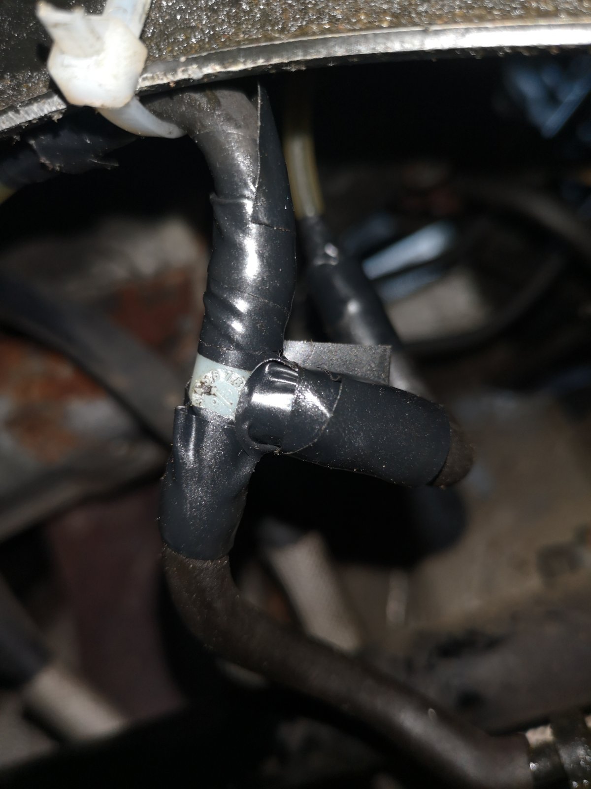

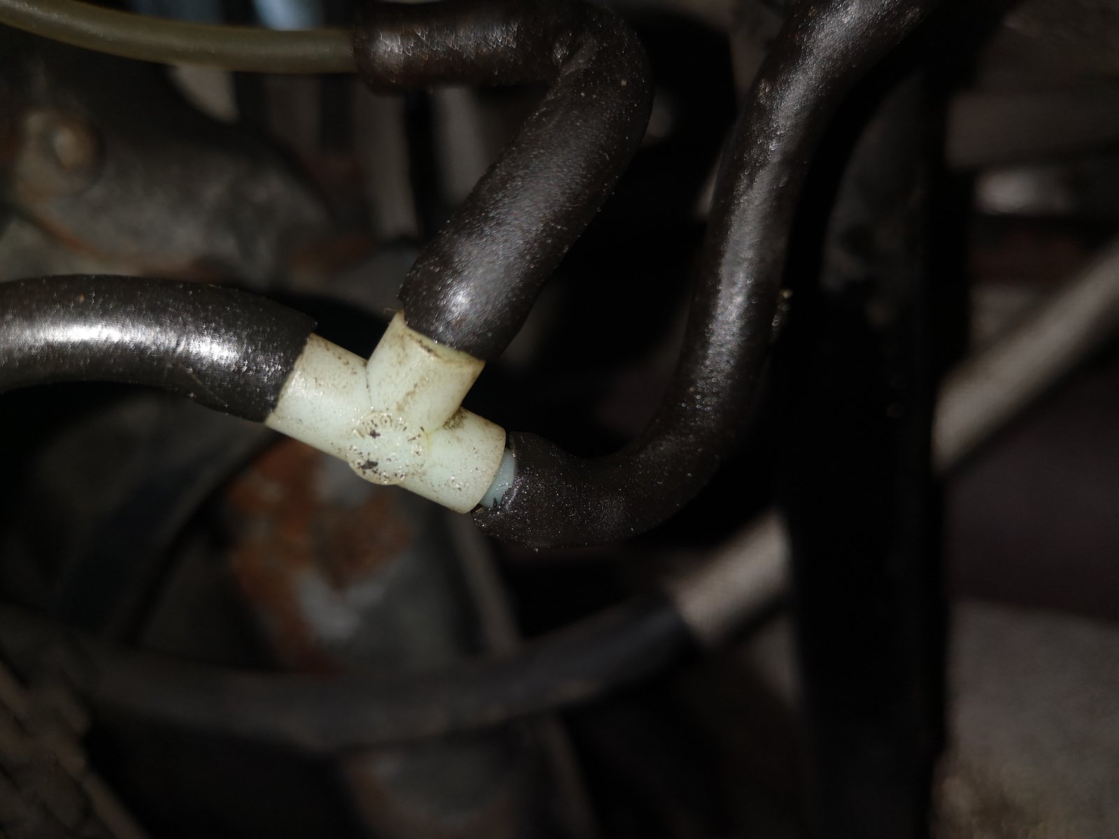

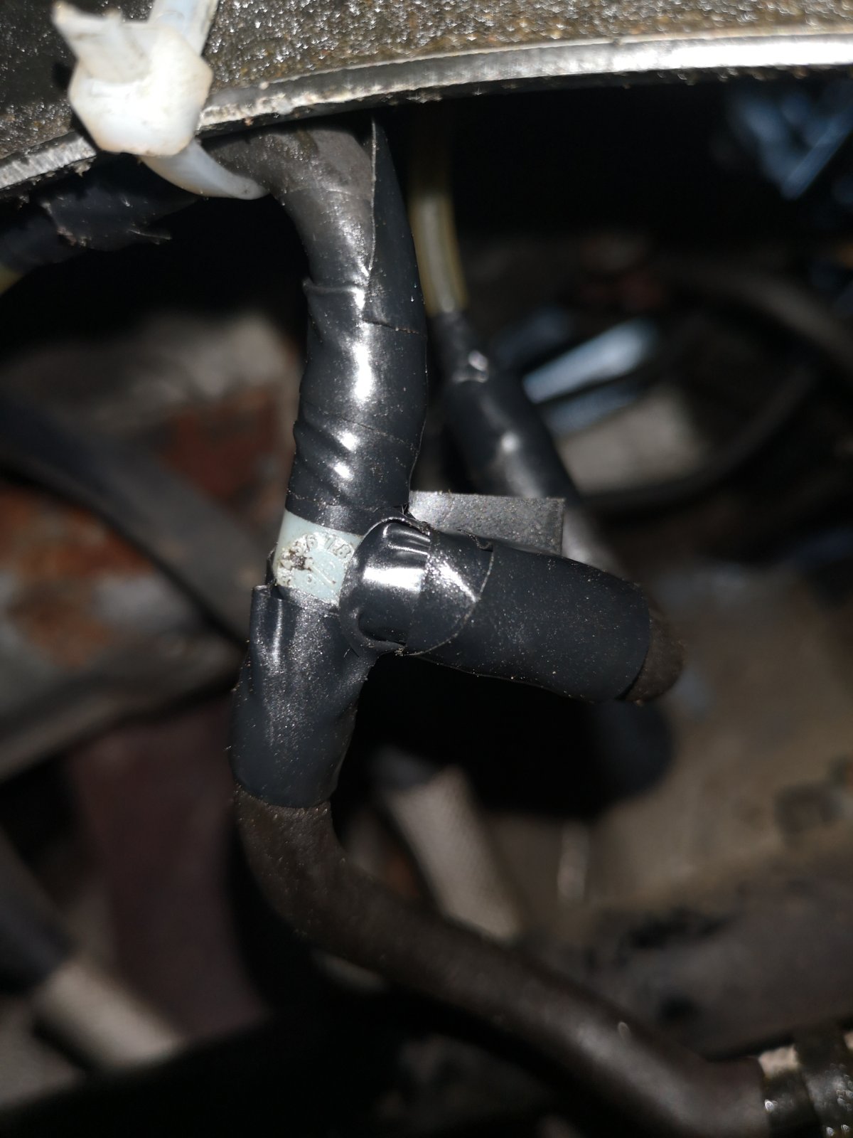

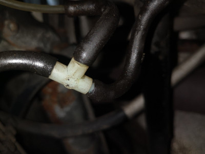

Ok...managed to get the car up on concrete blocks today (the neighbour has his car up on my axle stands for over a year...another story).
It was immediately evident where the disconnect pipe was from looking through the wheel arch with LH wheel removed.
It was exactly as Sticky finger and XantiaV6 suggested. Someone had 'bodged" the 3 way connector by putting nylon pipe over the existing pipes and used this plastic Tee....two of the pipes were clear plastic, small bore with a "blister" about 3cm in, and one was metal, connected to the subframe.
The ends of the nylon pipes, used for the repair had split, probably due to LHM contamination (and I see it has also ruined the gator on the steering rack). I removed the three joints and replaced all three with finer bore nylon pipe that I found lying around. I flared the ends in a saucepan of boiling water and inserted a pencil to widen the new joints. I just used the existing Tee and the car is no longer leaking and the car raised (after a top up of LHM) and the stop light went out. Took it for a test drive and brakes, steering and suspension all working and no leaks when I stop the car. (Left clean cardboard under it for an hour).
I have basically "rebodged" it, although my repair looks better than what the alleged mechanic had done. I've also secure the joint with cable ties, so it won't wobble around.
I've ve told my partner's daughter that she needs to take it to a garage and get a proper repair done. I might tackle it myself as I think the proper Citroen Tee (think it's green in colour) isn't too dear. She will need the gator fixed anyhows.
Thanks for all the advice I've received on here. Very Grateful. Here are some photos of my bodge. A liberal helping of black tape to help hold pipes in place. Joint cable tied to sub frame

The original T piece is no longer available from Citroen, but reproductions are available, of variable quality. There are several different versions with different combinations of hose diameter, but they are colour-coded. You would need the green one, part number 5270.14. if you do a web search for "citroen 527014" you should find what is available, beware that some are exorbitantly expensive. One UK supplier is: https://www.chevronics.co.uk/product/bx ... ts-xantia/

For the hydraulic connector (if they want it replaced), it would be best to buy one and take it to the mechanic, as they are not available through normal trade sources.
