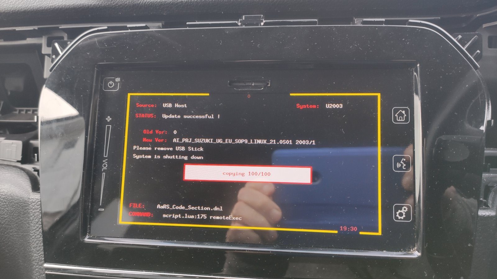

Firstly, I bought a new SD card.

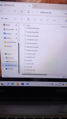

I then copied the 14 files from the unzipped SOP9 files.

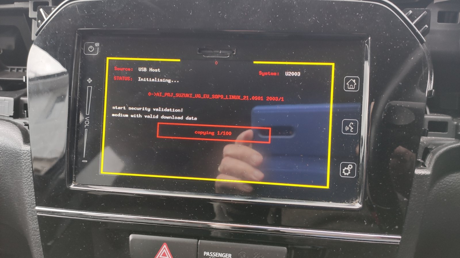

These were booted up in the head unit.

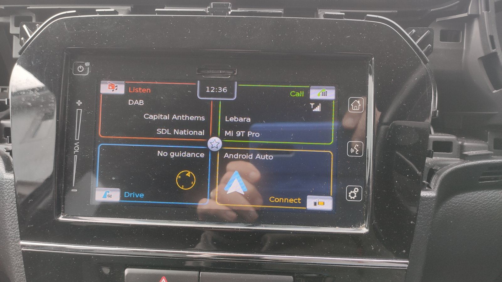

half an hour later I had this.
Which gave this.
Which also updated Android Auto as well as a functioning Sat Nav.
So, while this thread is about a Suzuki, reading SLDA forums suggests that similar units can be found in Renaults / Nissans and possibly more.
This short version proves my first question, in the very first part of this thread, about asking if a firmware upgrade could achieve anything, and it has. Just what this has to do with faulty aerials I have yet to establish but I have hundreds of posts to trawl through to see if I can find out why.

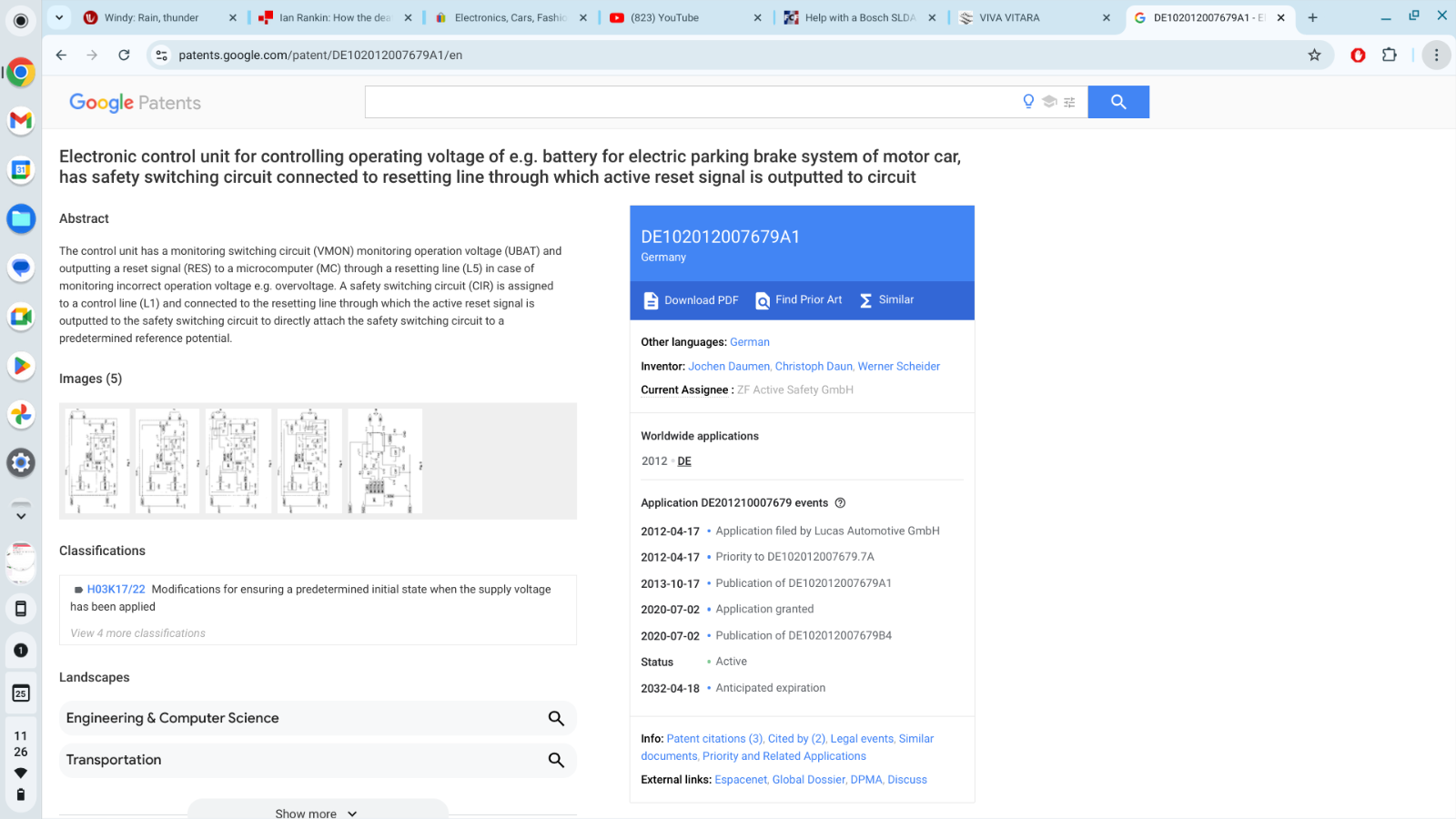

This is the type of article ( of the many, many ) I have trawled through to get ideas why the ubat ( operational supply ) voltage may be linked to GPS.
[/quote]
This article about a completely different electronic unit got me thinking that the SLDA unit had some sort of UBATT monitoring circuit
( even fuse ). If it was a fuse it would be inside the head unit. If it was micro processor controlled, then a reset might be possible. I tried all the on car resets so the firmware update was the step before removing and dismantling the head unit. I am still hunting for better wiring diagrams for this SLDA unit but I have hundreds of pages to look through so I may still be some time.
As it turns out, the firmware update has appeared to reset the UBATT / micro processor issue I think I had. Early days, but the unit seems to work properly now and I have by no means been through all the possible combinations this unit can do. For instance, the GPS acquired time signal now works, which it never did before. I knew my own GPS aerial worked so I started the reset process attached to the car's own GPS aerial and, as it turns out, it works.

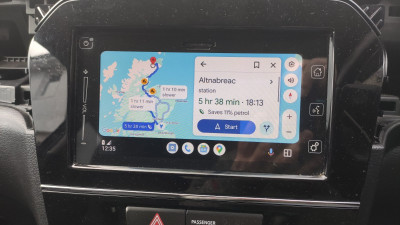

The Android Auto system is working spot on. It linked instantly to the phone and was able to get this right away.
My next step is to play with a multi hub into the single usb in the centre console. I have a usb hub/volts display in the 12v power socket. This will take power back to the cubby mounted multi hub in an aftermarket centre armrest we have fitted and a single usb cable will then connect the muli hub back to the SLDA head unit. The cubby has two layers, a big-ish cubby and slim top tray for a mobile phone to lie in.
This will go into a separate post shortly once I have assembled all the cables and adaptors.

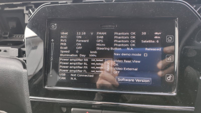

This unit is taxing my knowledge to it's limits just now. It defies the logic I think should control it, forcing me to think laterally - given how numerous these units are, there is precious little technical information coming to the surface yet.
I am pretty sure the UBATT issue was caused by the roof aerial wiring issues I found. Just why it locked up the Head Unit, I don't know yet. Yet!

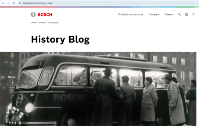

However, Bosch has its own pages of Historical Blogs on it's own website.
Don't get your water heated, it provides nothing to the SLDA thread, but it might interest some of you as it talks about the inventions they have introduced to our lives.

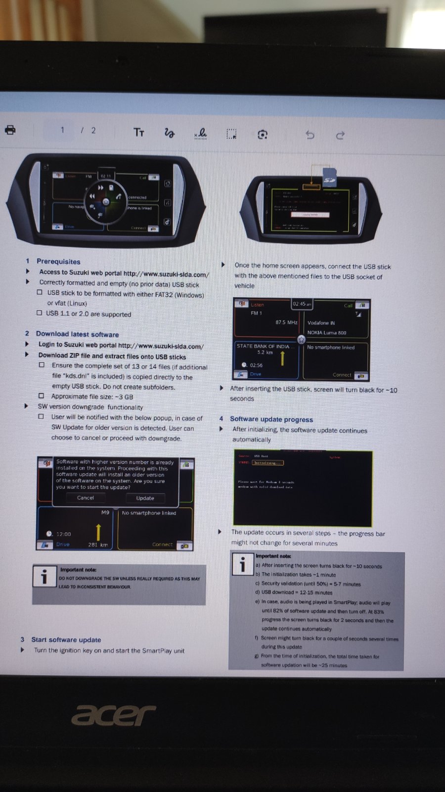

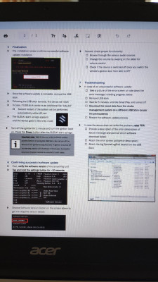

I did find this web portal pdf 2015 instruction set for upgrading the Suzuki SLDA head units Firmware. Unfortunately this site won't upload the original file so you are stuck with photos of the screen as my Chromebook won't take screenshots of web portals.
It is not totally 100% correct/ inclusive in what it says but it looks like it was a "translated into English" job done by Suzuki using an instruction set given to them by Bosch. I will expand on this further in my full report.
