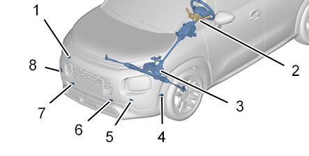

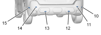

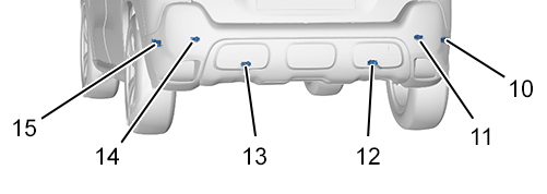

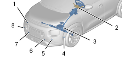

Ok so using my car as a template, this is how they are referred to. According to VIN you also have blind spot monitoring, so will have (10) & (15):
(10) Rear right lateral parking assistance sensor.
(11) Rear right outer parking assistance sensor.
(12) Rear right inner parking assistance sensor.
(13) Rear left inner parking assistance sensor.
(14) Rear left outer parking assistance sensor.
(15) Rear left lateral parking assistance sensor.
(1) Front right lateral parking assistance sensor.
(4) Front left lateral parking assistance sensor.
(5) Front left outer parking assistance sensor.
(6) Front left inner parking assistance sensor.
(7) Front right inner parking assistance sensor.
(8) Front right outer parking assistance sensor.
