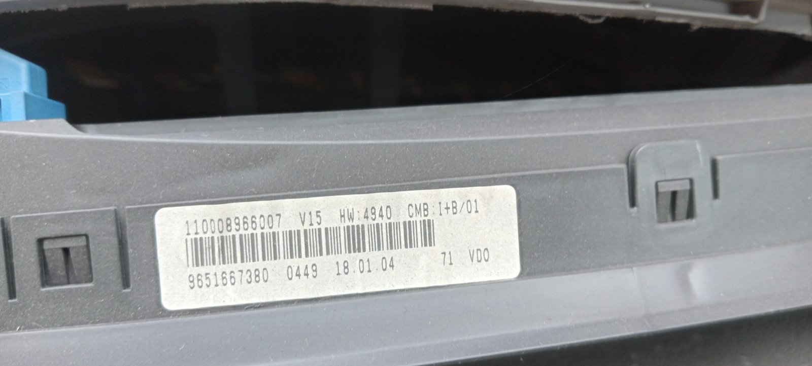

FurryCurrySauce
- Posts: 15
- Joined: 28 May 2024, 09:10
- x 2
Re: Problem with dashboard on a 2004 picasso
Hi, you need to take out your dashboard and have a look at the code you have on the back of it. There are a few different ones so you need to be really careful wish one you order, some have just 1 blue connectar and some other have 2 connectors, 1 black and the other blueMewk93 wrote: 18 Aug 2024, 19:00 Hi
Did you solve the problem with adjust the mileage? My car has the same problem 2004 and only have 16,000 km. Is there any diffrence which year the display/speedometer was made? Do i need a 2004 model, just like my car?
