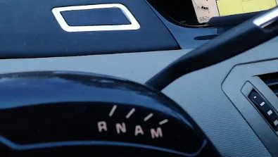

On the EGS front, never had one so have you just got two pedals Mick, brake and accelerator, and you shift gears manually with the stick and all the clutch-ey stuff is done "automatically". Is that just to preserve the experience of moving a stick about for customers or does it have any advantages over a fully automatic box.

@ Neil - No gear stick in EGS just the selector on the steering column (or elsewhere, depending on model), and no clutch pedal. You can tell EGS cars vs TC auto, as there is no P position on the selector. Clutch and gear change taken care of by the electronics and hydraulics. Only difference in manual mode is that it doesn't automatically shift up or down - although it will still select 1st if you come to stop. It's not the fastest change in the world, and a bit of anticipation is required when it changes gear to avoid it lurching. No creep at idle. Not really sure why PSA went down this route, maybe they couldn't get a decent deal on a full auto box. Discontinued about 2015/6 when they brought in the EAT 6 (and later 8) box which is a proper TC auto.

Unlike olden times, auto boxes are now the 'efficient' mode of transmission for ICE engines, mainly because they would normally change gear when they think it's a good - efficient - time, hence allegedly improving efficiency. EGS boxes probably helped at the time by not having a TC, but things have moved on now and we have proper full auto boxes with TCs !

As for the EGS gearbox I have found it better in some ways than a TC box as it has absolutely zero creep when the gear selector, floor mounted in my case, is in the auto position but the car is stopped with no throttle. There is an initially irritating delay in drive pickup when you press the throttle whether in auto or manual mode but I have now completed 400+ miles and got used to applying the throttle just a second or so before you would with a clutch and it is fine. By micro adjustments of throttle pressure you can achieve exceedingly smooth, virtually imperceptible gear changes so I am pretty happy with it. And of course I have bragging rights down the pub having a hyper car style set of flappy paddles

Thanks Richard et al for the extras on the EGS. I wonder if after the novelty wears off drivers tend to just stick it in Auto and drive it in automatic mode most of the time, or maybe the opposite and they become addicted to playing with the paddles.
