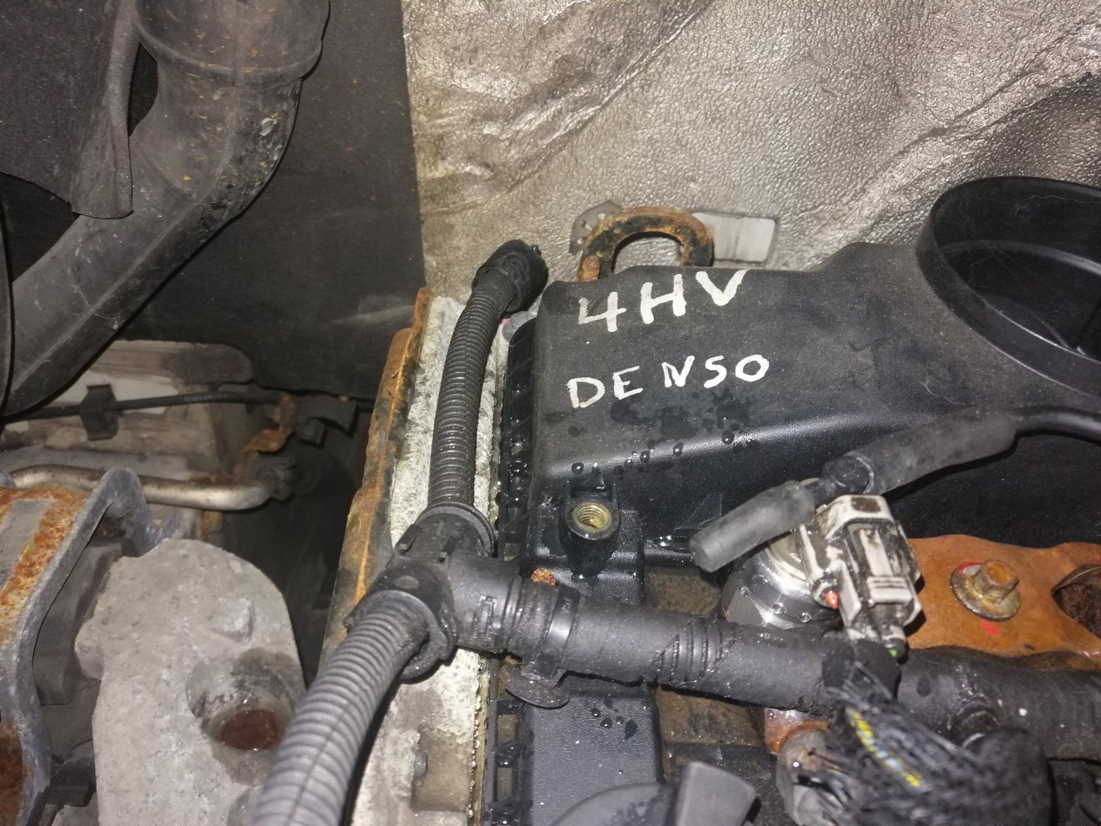

2 - I no longer have access to the original engine and original injectors. The actual/replacement engine is hand marked on top as "4HV denso" (picture attached).
