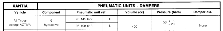

That's really comprehensive.
Thanks chap.
One point this all raises is that one would have to be VERY careful swapping out SC/MAC valves from other vehicles as it wouldn't be immediately obvious if you were fitting the same valve or not.
It is useful to see the part numbers on there also.
I only put 40 bar in the centre sphere but that is within specification still but I will increase that to 50 bar. Perhaps I was think of BX when I imagined that the pressure was only 28 bar in these centre spheres.
There's still an error in the handbook. It shows that part number for the non-hydractive sphere as hydractive. No wonder I was scratching my head.
