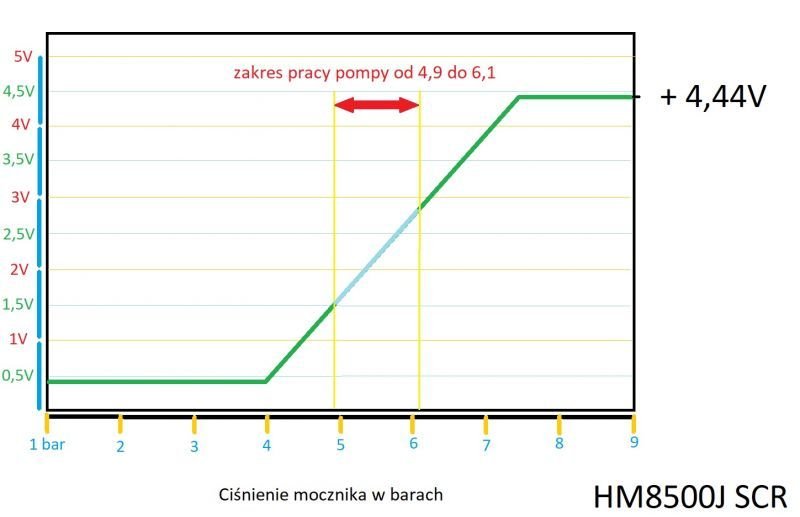

@Stuart W. Thank you for your explanation. I haven't yet tried any experimentation but I am in the process of collecting info for when that bad day arrives.
I have read through much of the marathon thread posted on the Elektroda forums and from the post by mako122 I borrowed this image detailing much of what you have deduced indicating 4.9 to 6.1 bar would have a voltage range 1.5v to 2.8v in which case your choice of a 10 bar sensor was likely to be very wise. Out of interest, what sensor voltage range did you find with your own modification?Source: Repair of the AdBlue tank PEUGEOT BOXER III, CITROEN JUMPER https://www.elektroda.com/rtvforum/topic3827598-60.html

I cannot recall from memory whatt the sensor output was at the turn off point but did read the output pressure at 6 bar, so I was very happy with that. Some where in my scribbled notes, will be the output voltage !The srndors generally give a linear output voltage from Zero at no pressure and increasing up to 5 volts at the sensors rated pressure.Hence with a 10 bar sensor,reaching the required 6 bar it should be 0.6 of 5volts, i.e. about 3 volts.

Just one more point.Do not rely on any diagnostic read out to read the adblue pressure, these only monitor the voltage output from the sensor and if you have fitted a 0- 6 bar sensor or a 0-10 bar sensor the actual pressure would be completly different. The read outs from the diagnostic may appear ok as it only interprets the sensor voltage and the controller cuts the pump off at about 60 percent of the maximum sensor output.
The only way to check what the sensor is regulating the pressure to is to fit a pressure gauge straight onto the output of the pump when the engine is up to temperature and the adblue controller is running the pump.
In my case the 10 bar sensor settles the system at about 6 bar adblue pressure.Also, standard 10 bar sensors seem to be readily available.With an 8.5 or 9 bar sensor it would probably give 5 to 5.5 bar adblue pressure which would give the pump a slightly easier life.

I think you are right. From what I understand the pump pressure starts to be registered by the control board/ecu at about 5 bar and reaches the optimum/maximum working pressure at about 6.1 bar.In my case the 10 bar sensor settles the system at about 6 bar adblue pressure.Also, standard 10 bar sensors seem to be readily available.With an 8.5 or 9 bar sensor it would probably give 5 to 5.5 bar adblue pressure which would give the pump a slightly easier life.

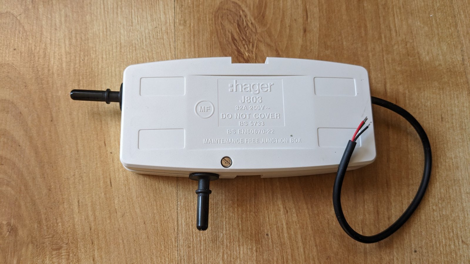

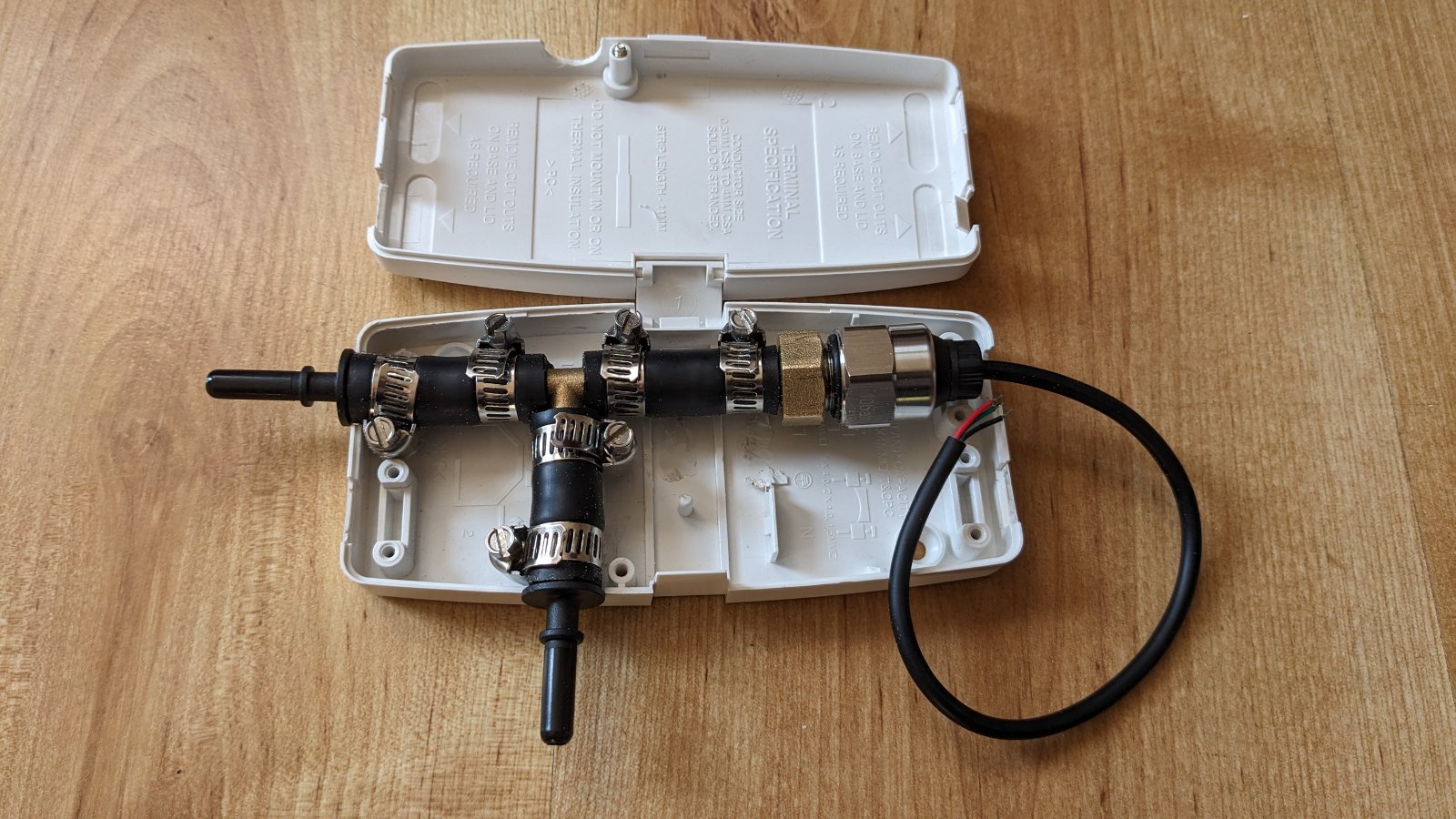

Just sharing my black box (or white box) solution in the future. Looking at attaching a 3pin connector at the end to allow flexible placement. Thanks, Stuart W. for sharing your initial solution. For now, I'll relax for a bit.
Stuart W
- Posts: 83
- Joined: 27 Jan 2022, 17:05
- x 45
Re: Adblue tank repair details
Good thinking c4.My initial fix was not quite as neat, especially not knowing if it would work! There is very little space around the adblue tank to fit the external sensor so extended pipes make good sense.My original repair still works fine though.
