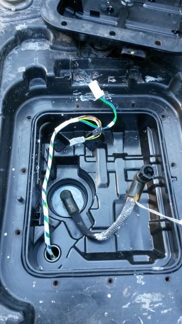

Summary: I have a favour to ask. You suggested in an earlier post that "I've taken the old tank back so I'm curious to see if there's anything obviously wrong with the pump and/or electronics". If you still have your old, 308 adblue tank please can you measure the resistance of heater element that is inside the tank. Reasons and details below:
I've also had the dreaded low pressure Urea, loss of communication to the Denox, "Starting prevented in 700 miles", ... on my 2015 308. Note 6yrs old + 126.5kmiles so don't believe that Peugeot will do anything on the extended warranty for this pump/tank which I have read is for up to 5yrs & 150km (93kmiles).
So stripped out the pumps and electronics and found that the pressure reservoir (part of the pump module) had leaked from the diaphragm and deposited adblue over the pcb. This then corroded a couple of tracks on the pcb (one track to the Canbus & another to the relay). I've repaired these but also need to replace a Mosfet that drives the adblue pump and then repair or find a replacement pressure reservoir.
Also some adblue may also have gone down the cable hole to the electronics inside the tank. So I wish to check that these are still working as if they aren't, then a new tank is required. I have checked the temperature and level sensors by plugging the partially repaired unit back into the car and they change with the temperature and removing or adding fluid. So ok. Running the heating element test through Diagbox - fails. I don't know if this is due to a partial short on the heater element inside the tank, or the dead Mosfet, or not driving Diabox correctly. I have measured the resistance on mine as approximately 1.2 ohms, which is maybe a little low. So if you can, would you please measure the resistance of the heater. It is connected between the blue and green wires on the white plug shown below.
Thanks in advance,
Tom

Sorry it's taken a week to get this done. I measured the resistance as 1.4?. The probes touching together measure 0.4? and so that gives 1.0?, which is close to your figure.
Assuming mine is not also wrong of course! This may be the problem on both.
It's a shame I didn't know to measure the resistance on the new tank before it was fitted.

Thank you, I now think that is the correct figure and I'm assuming that the heater is ok.
I put a patch up the expansion reservoir and tried running the denox system. The system would not allow this due to the denox pressure. Diagbox showed that the pressure was 7bar (should be between 4 & 6bar) even though the pump had not run! Using a dvm I found out that the pressure sensor is also faulty. Seems to give roughly the correct reading when cold, but goes to maximum when warmed. I should have suspected something when I saw some blackening on the connector to this sensor.
So I'm assuming that the parts in the tank are ok, and I need another pressure sensor. So I've ordered a second hand tank to use the pump/expansion vessel/pressure sensor. It's from a 2018 Vauxhall Crossland X! These have the same pump assembly as the 308 (looking at the pictures it is probably the same tank as a late 308), but at about a 1/3rd of the price. So hopefully will work. I will also (as a test only) try the tank pcb to see that is compatible or if it requires the engine management ecu coding. A job for tomorrow.

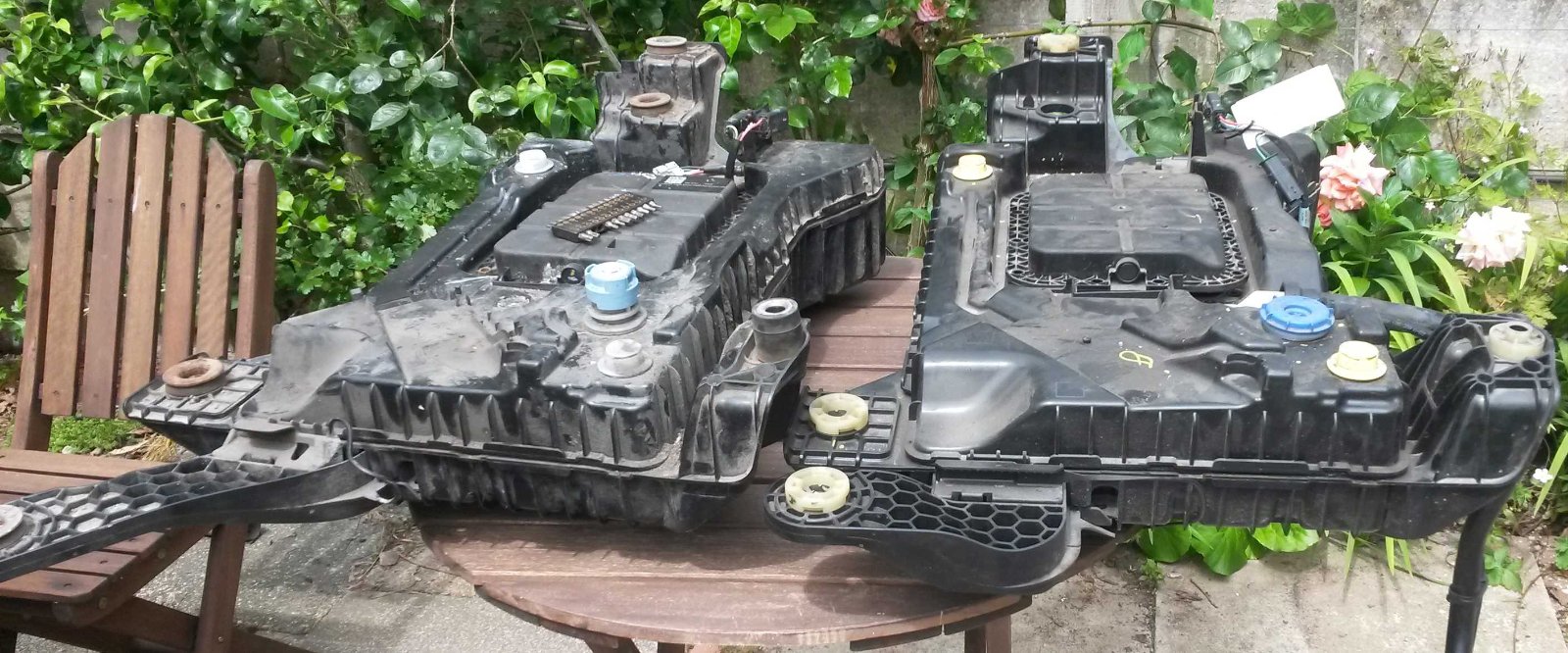

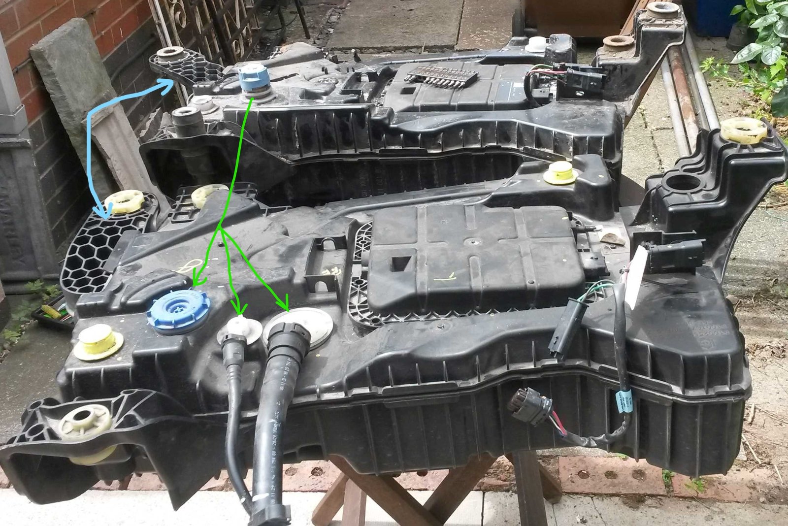

Update on the Crossland X adblue tank:
The Crossland X tank uses the same parts as the 308 except:
- the fill connections have been modified (to allow adblue filling by the diesel fuel flap - the same as latest 308), see green arrows in pictures
- the removable mounting leg, blue arrows.
- the pump control pcb

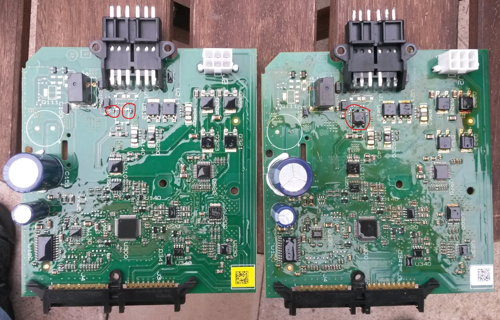

The pump control pcb:
- has a common mode choke fitted on the Canbus connections on the original 2015 pcb, but this has been removed and replaced by two zero ohm links on the 2018 version. In the picture below these are shown circled. The removal of this choke is probably PSA's attempt to make this connection more reliable as these usually help to suppress interference, but they can lead to other problems.
- I haven't found any other differences in the components or the tracking and have been reasonably thorough, even to checking the major components manufacturer's part numbers.
As the car's ecu# needs reprogramming when using the newer pcb, I think the pcb's processor must be reprogrammed as the removal of the common mode choke probably wouldn't need a reprogram. # Is this actually the Built-in System Interface (BSI)?

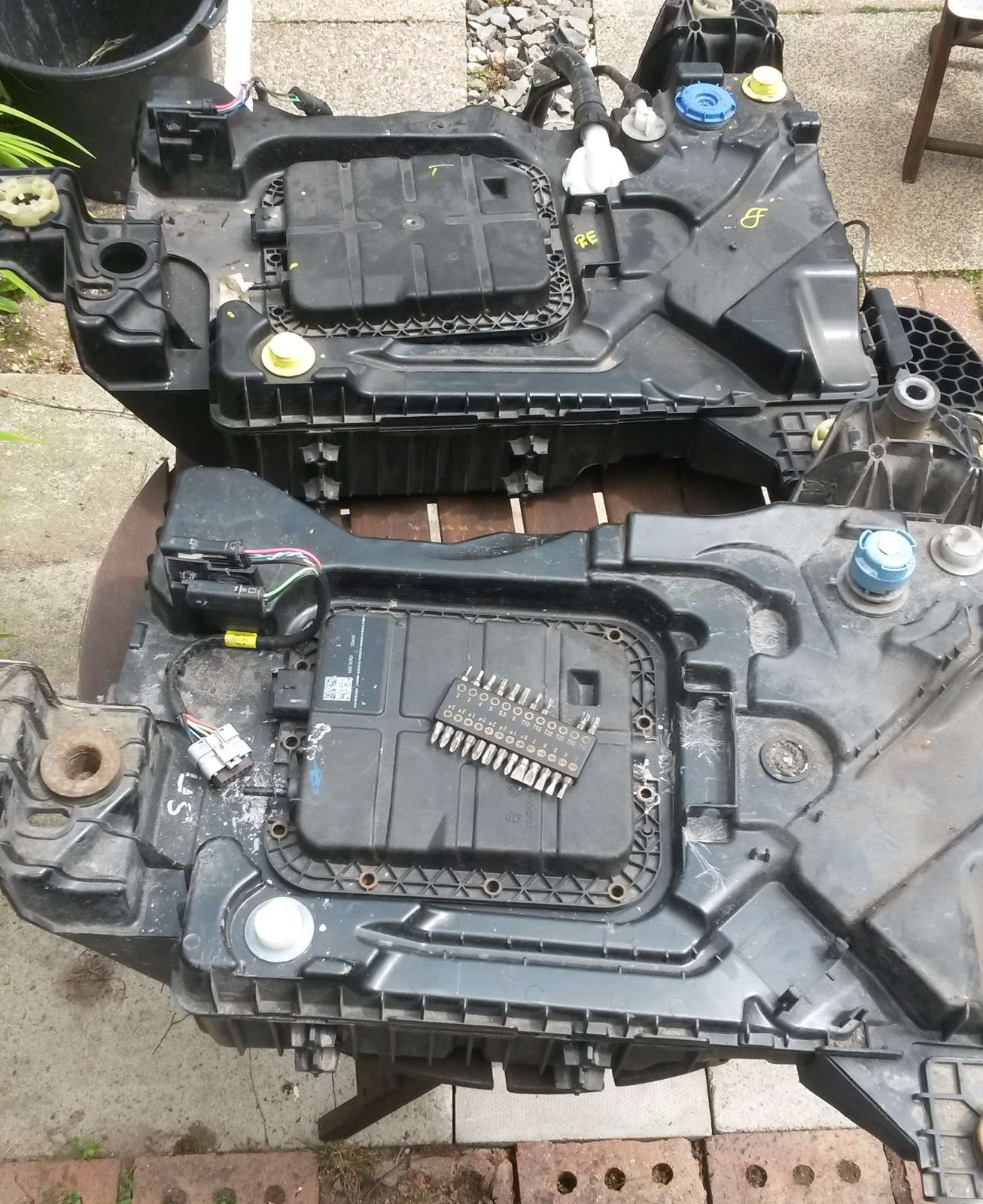

To continue with my testing:
I repaired the old pcb (replaced the Mosfet in the H-bridge that drives the pump motor and put wire links across the two corroded tracks) and also replaced the pressure sensor and the leaky expansion tank by using the complete pump assembly from the 2018 Crossland X tank except for the pcb.
Tried this in the car and it still didn't work even during an extended road test.
Also tried the 2018 pcb, but came back (as expected) with the "No communication to the Denox system" fault.
I was unsure if I still had faults on the pcb, if hadn't properly commissioned (refill, bleeding, resetting) the tank, or if I was not using Diagbox correctly, so as Paul-R was not too far away I asked if I could have the pcb from his old faulty tank. He very kindly let me have the complete tank :-D
Note at the start of the process, I was unsure how the tank could be tested. So I'm not sure exactly when it was working or not, but here is what I did:
1. My tank wouldn't run even when driving the car
2. Inspected Paul's tank's pcb & wiring. Couldn't see anything wrong.
3. Tried Paul's pump assembly (pump and pcb) on my tank, Using Diagbox showed -40C tank temp! I thought it was a bad connection or thermal sensor not connected. Pulled it apart again and found nothing wrong.
4. Tried swapping my tank for Paul's. Still -40C.
5. As my pcb had shown the correct temperature, I tried my pcb with Paul's pump and my tank. Showed +19C.
6. Swapped the two pcbs. Now Paul's showed +20C, but the parameters on Diagbox still showed tank heating, so the car wouldn't allow the pump to run. Note I don't believe that tank heating is required much above -11C (freezing point of adblue).
7. Disconnected and reconnected Paul's pcb. Diagbox box showed that it was no longer in heating mode.
Note I had tried resetting the urea tank faults on Diagbox on the above faults but it hadn't changed temperatures or the heating requirement.
8. Tried the actuator tests again and the "check of the Denox flow" and it started the pump!! Note that the outlet was just connected to a bottle, so would be unable to pressurise.
9. Tried my repaired pcb with the 2018 pump again, it also worked on the check of the flow!
I have found that this test is best for testing the system. I also tried the other actuator tests. The control relay test does nothing, but doesn't fail. The heating tests sometimes pass, sometimes fail, sometimes it doesn't start. I tried combinations of Paul's pcb, tank and wiring and mine all with inconsistent results. I'm totally confused by that as the resistances of my tank, Paul's and the Grandland x are all the same.
10. My last combination was basically Paul's tank & pcb, so I tried a test drive. It worked.
11. The next day it didn't work on a test drive or start the pump on the flow test.
12. The day after that, I pulled it apart, but couldn't find anything wrong or with the parameters on Diagbox and it wouldn't run the pump with the flow test. I was talking to my next door neighbour and was telling him about it, saying that it felt like the problem seems to be one or more poor connections. So I said if I just tapped the pump assembly it would work and guess what, with the screwdriver handle I gently tapped it and it worked!
I put it back together, gave it a test run which worked fine. I was going to do some more testing when it stopped again, but it has now been working for just over a fortnight and over 600 miles.
