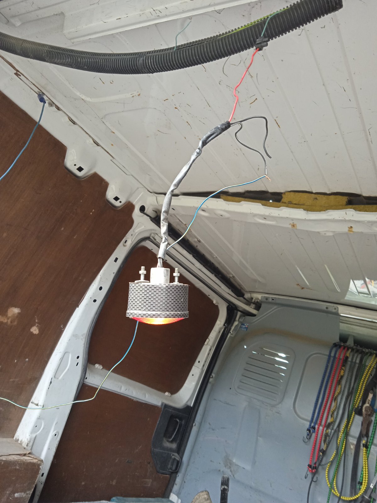

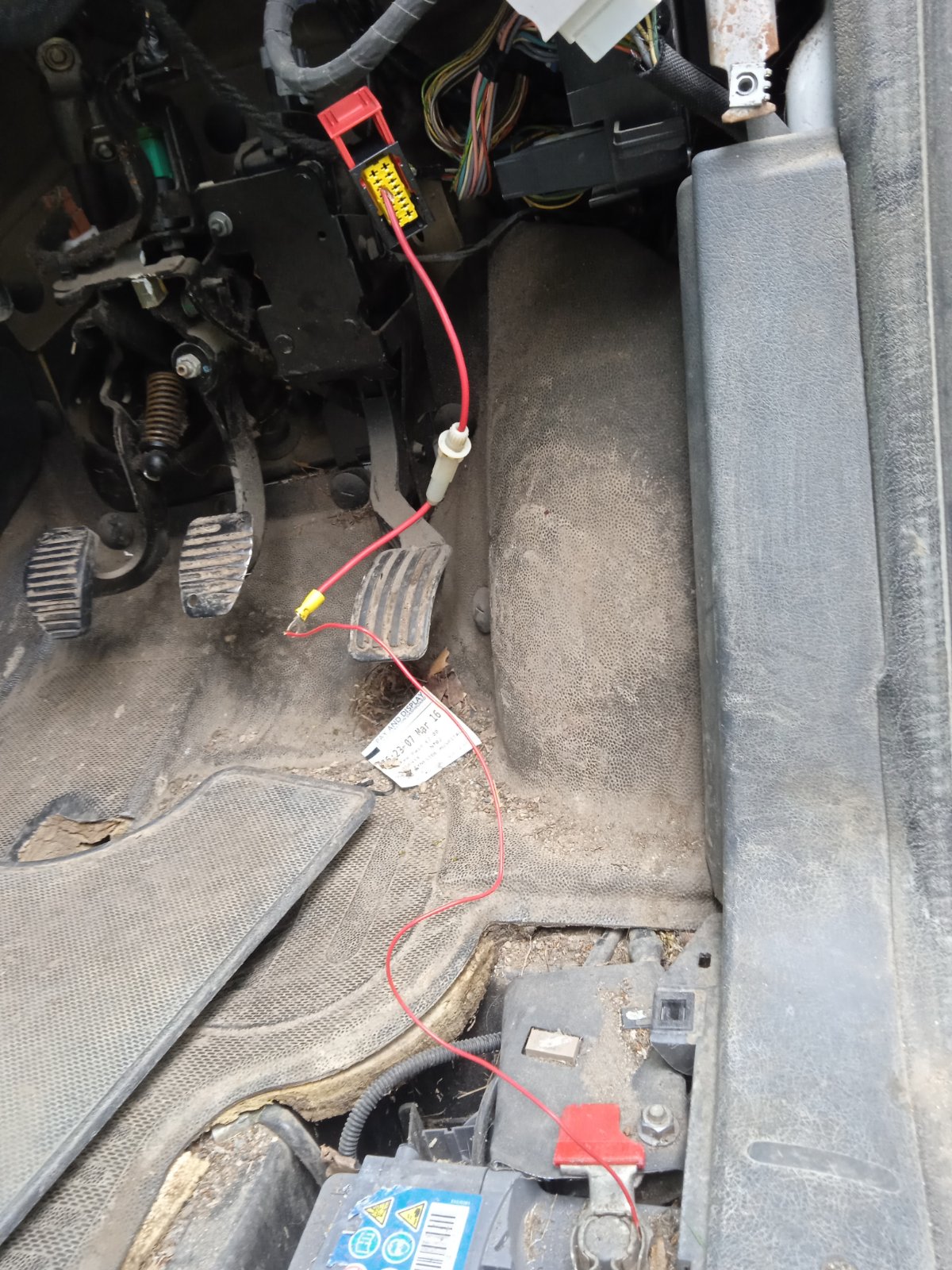

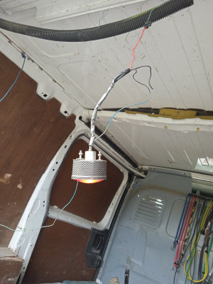

Thanks Wheeler, just spoke to a mate in the UK who does car electrics, just said the same thing, send 12v up the wire with a 10 amp inline fuse to see if the bulb lights. Can't trust continuity checks 100%.

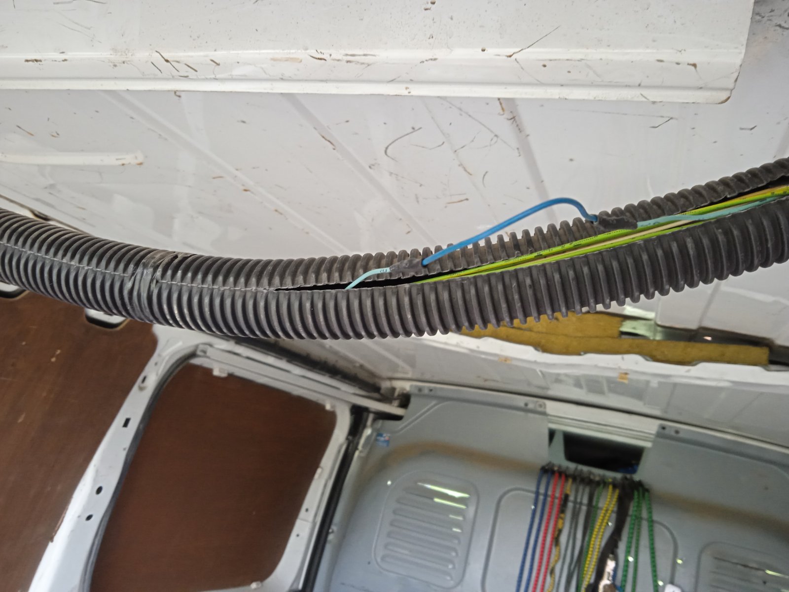

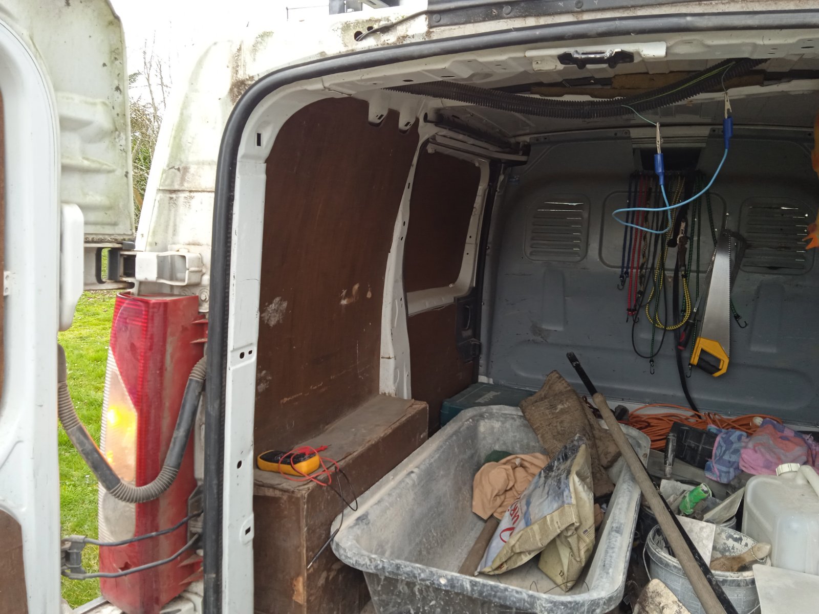

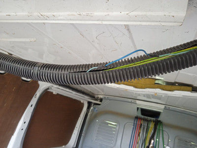

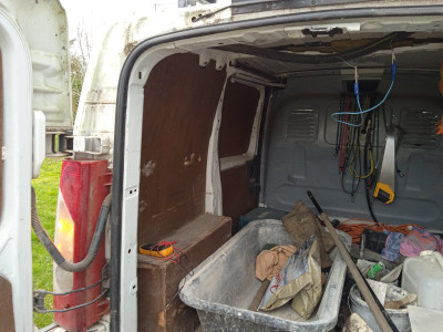

Fed the plug with 12v. as I'd already cut the loom above the rear doors I checked the wires in 2 hits.
