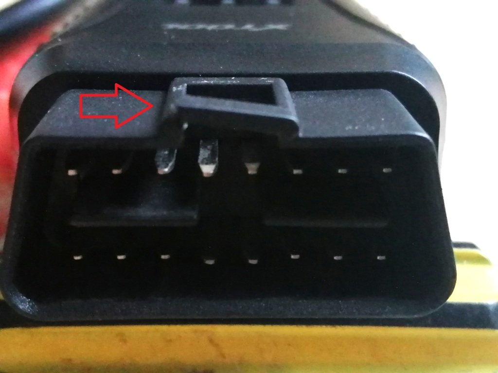

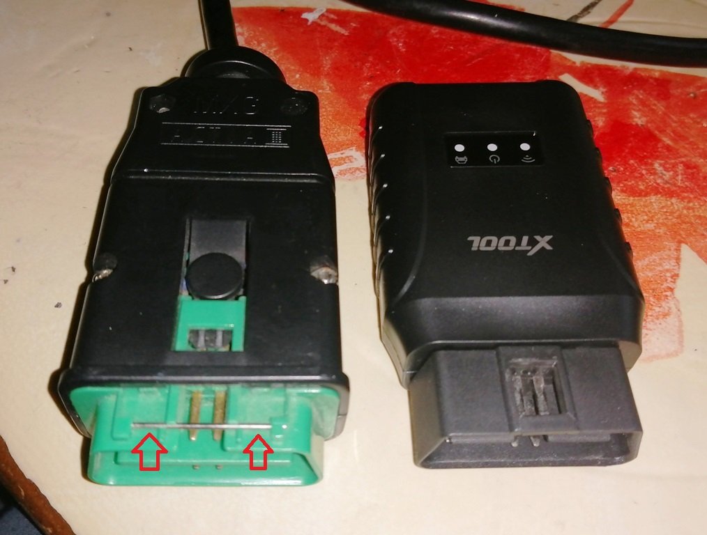

One thing I wasn't expecting was when I'd finished on the 308 I couldn't pull the VCI off the EOBD socket. It required a mighty wrench to get the VCI off and when I inspected the VCI I could see that part of the plastic surround had broken. I compared the D8W VCI with the VCI off the Diagbox and this is much better designed as there is a metal pin which obviously has more springy 'give' to allow removal whilst having enough grip to hold it in place.
I sent the two attached photos to the manufacturer and am waiting for a decent reply from them about this.
