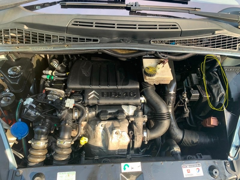

wheeler
- Posts: 7932
- Joined: 21 Sep 2002, 19:07
- x 1056
Re: Xsara Picasso won't start
This one is a diesel but the ECU is in the same place. Its should have a ‘shower cap’ over the 3 plugs to help prevent water ingress.
Vuk1987
- Posts: 53
- Joined: 27 Oct 2018, 14:32
- x 4
OK, I have the exact same "bag", I just taught it's a cable insulation.
