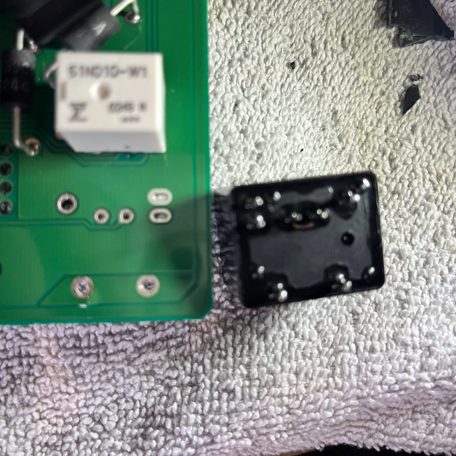

Okay, I got it out.
I will be replacing the relay in a few days.

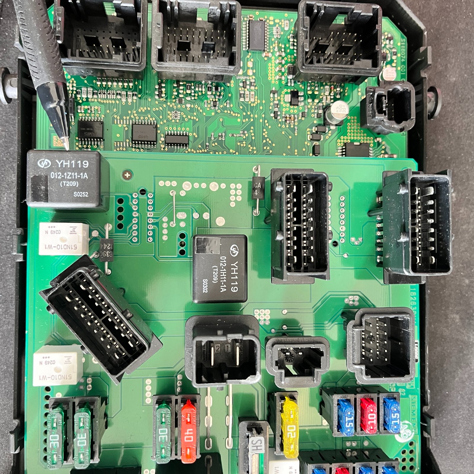

Just to confirm, that is the right relay???
Thank you
Thank you
ozvtr
- Posts: 900
- Joined: 13 Oct 2020, 01:11
- x 253
Re: Central Locking Problem [With VIDEO] - Could it be the relay?
I'm sorry but I can not find any details on the PCB's of the BSI. There are 2 relays involved. 1 relay is connected to pin13 of the 16pin grey connector and 1 relay connected to pin15. I cant tell you which is which. I.E. which is the "lock" and which is the "unlock" relay.
However, if the guy in the video says that's the relay...then I guess you have to trust him?
ozvtr
- Posts: 900
- x 253
I did a bit more research and that does appear to be the relay.
That relay should be connected to pin 15. Pin 15 appears to go to the unlock solenoid of the door locks.

FYI. Most "electric" door locks use a motor. A motor is complicated, has spinning parts, carbon brushes, gears and so on. BUT it draws small amounts of current and produces little "Back EMF (Electro Motive Force...VOLTAGE)" and it can be quite powerful.
However, Citroen/PSA tend to use solenoids. Basically, electromagnets, to move a "bolt" to lock or unlock the door. This is nice and simple...However...it produces a lot of back EMF across the open contacts of the relay when you switch the power to the solenoid off. This damages and burns out the the relay contacts. In fact, this process is somewhat similar to what is employed to produce a spark across the gap of the spark plug!!!
There are ways to mitigate the damage (hint: diode) but, I am not here to tell PSA how to engineer their electronics!
Why it only seems to be the unlock solenoid relay that fails, I have no idea.

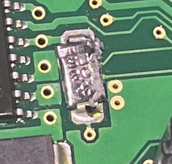

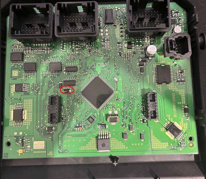

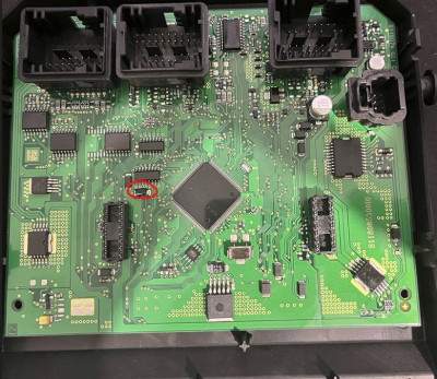

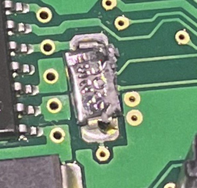

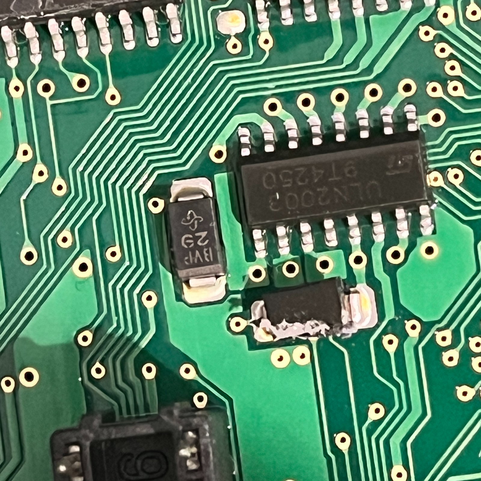

Hi, I need help identifying this damaged component.
ZOOMED IN AS MUCH AS I COULD
Please can someone help me with this, for sure needs to be changed

I think it is a SJ2C Diode.

If any one has an OLD BSI unit. More than happy to pay for this component.

Both surface mounted and leaded versions appear to be available in the UK. Could find any on Ebay but a quick search threw up the names Farnell, Mouser UK and Digikey. I didn't investigate further.

Hi,
FYI, it is a
Vishay S1J
https://www.vishay.com/docs/88711/s1.pdf
Old relay. It was a pain to get out. New one going in.
FYI, it is a
Vishay S1J

FYI, All working now.
I have a donner BSI unit. If anyone wants any parts, PM me please.
