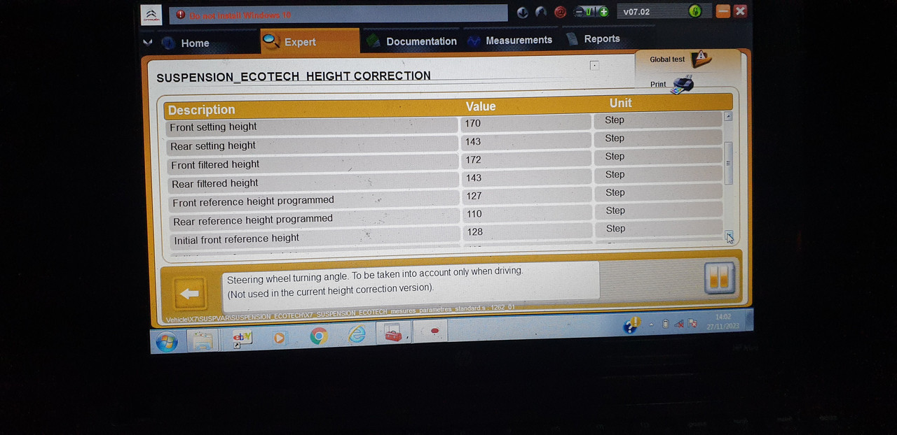

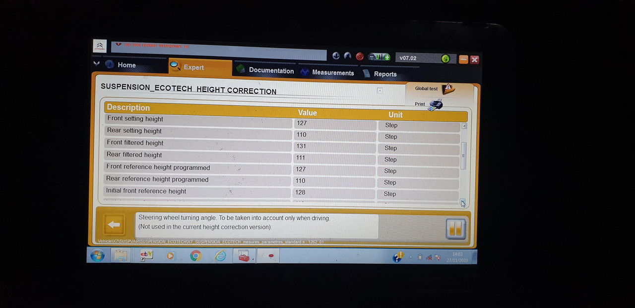

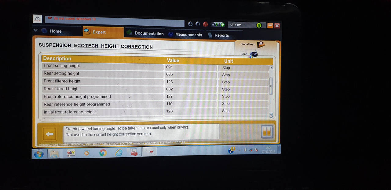

was just playing around in Diagbox with car running. Top, normal, and low shown. (I will almost definitely have moved the front roll bar yesterday, despite tipex, whilst making sure the HC wasn't seized, not to worried about that at this stage)
Any of that mean anything? ;) - i guess things are talking to each other at least..
the front filtered height on pic 3 looks odd.. that's all I can see
btw still taking many minutes to go from low to high, and more than one cycle of the Hyd pump

I went to the barn armed with ramps and trolley jack, and set about things... just before then I plugged diagbox back in, and whilst staring at the parameters, made the car rise and fall about 10 times! the journey from low to high has came down to 3 1/2 mins, the fluid looked less frothy, and despite checking the levels so much yesterday, more came out of the filler neck, not much though.. (air causing fluid rise as it escapes?)
I changed the front ride height, as now in drive mode there wasn't any front suspension (see yesterday ARB comment) - after all of that, the raise to max is now how it used to be, about 2 mins!
TLDR, the car is now like it always was! looks good front and back, softly sprung, I cleared some more lingering errors, left it on ramps for now, and shut the door..
