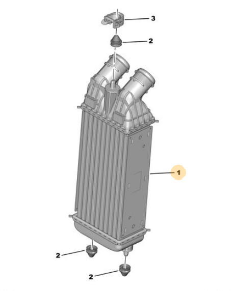

FOUND ISSUE!:
the post DPF pressure sensor hose/pipe had come dislodged from the block clamp and the clip on it has punctured the intercooler. Could i get a part number for the replacement intercooler please?

- x 6945
Re: DS3 1.6hdi Engine AIR codes
Ask for parts on the official thread in future, as I may not see it here
. I have your VIN but the above has 2 characters / digits too many.
(1) Intercooler, part: 9803900780, £401.28
