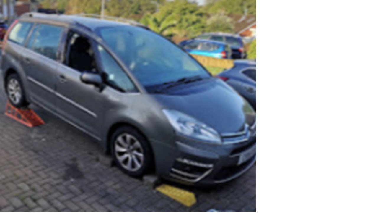

Hi All
Firstly many thanks for all the help here.
My VIN is VF7**************[VIN obfuscated, can be read by forum staff].
Variant on V5 document: UA9HR8
My car is a Citroen C4 Grand Picasso 1.6 HDI VTR+ 2011.
I attach a picture.
I attach a picture.
- x 6957
Re: Particle filter additive too low
Yes, you require Powerflex additive for this vehicle.

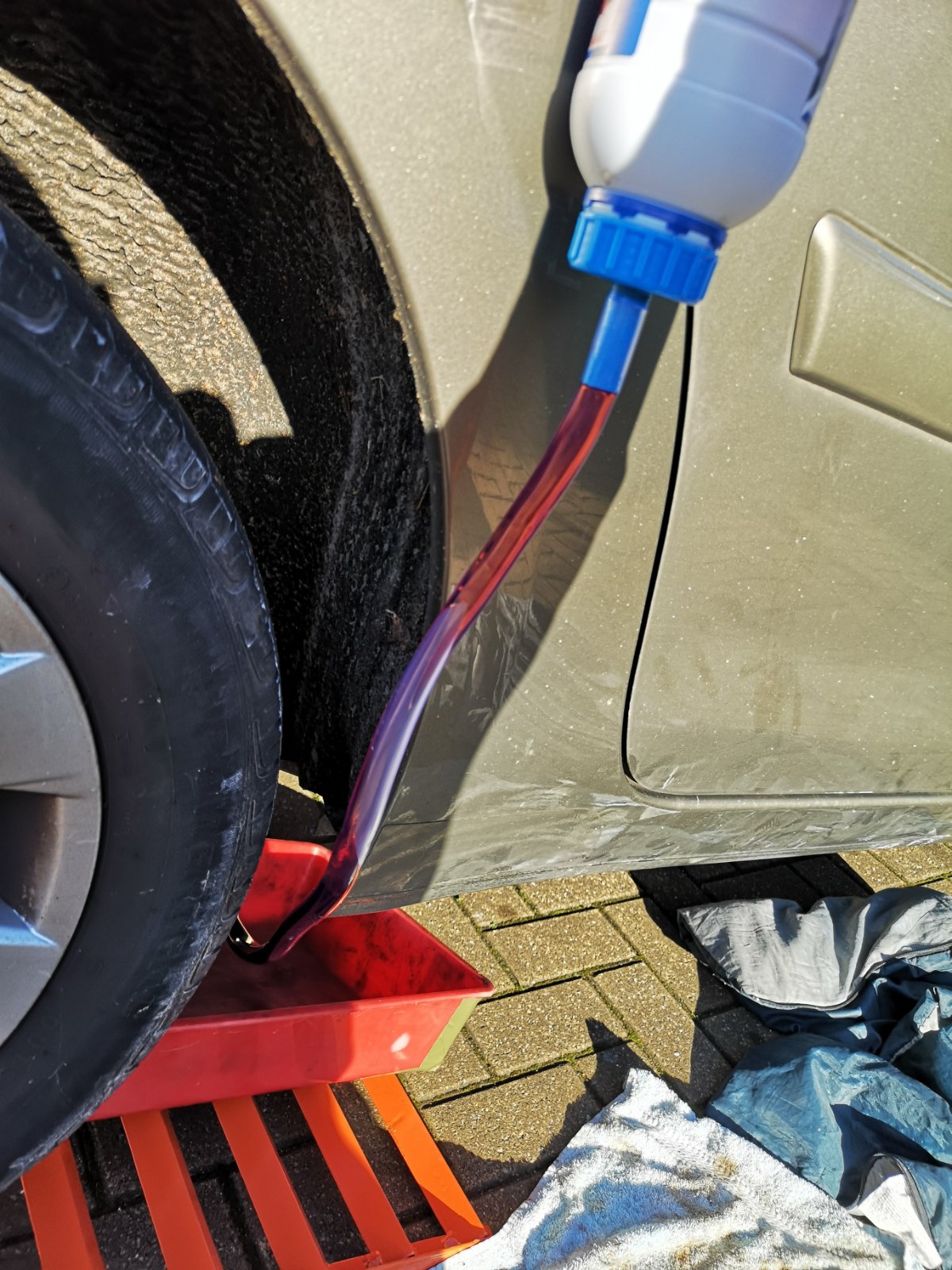

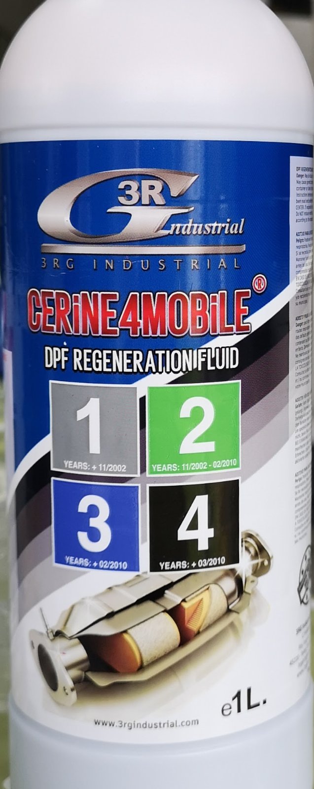

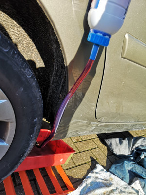

Final update on this.
The fluid arrived and I added it down the filler pipe that I had decoupled underneath as per the pictures in previous comment (The blue connecter end)
The fluid came with a convenient end piece that fits the filler pipe without leaking.
Was October 20th 2023 - no side effects so far. Unsure of mileage done but been to on a 200mile trip since then and several other 50, 100 miles trips + town driving.
Pictures attached.
Pictures attached.

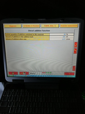

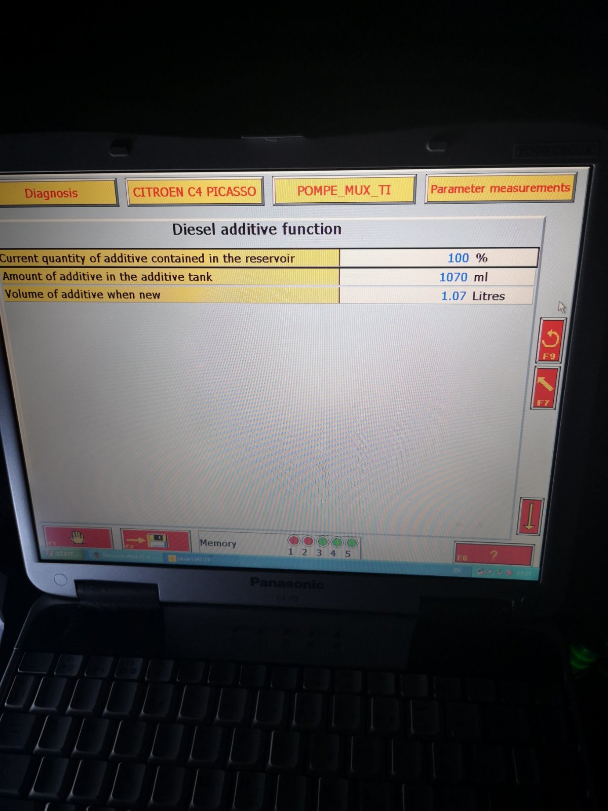

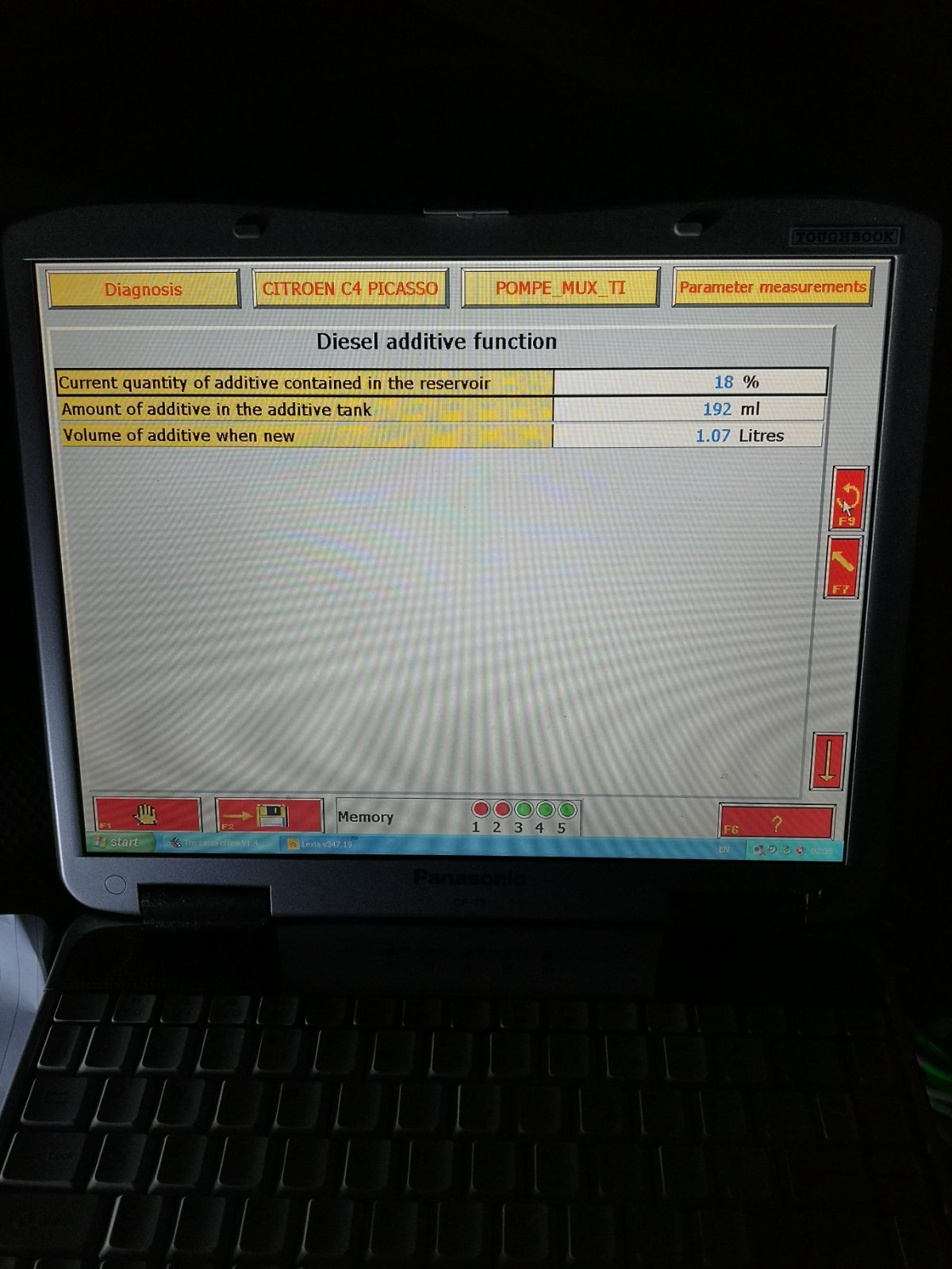

Yes - I reset the counter using the lexia diagnostic tool.
richarda
- Posts: 30
- Joined: 15 Oct 2019, 13:13
- x 9

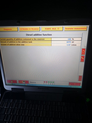

Before and after pics. (number of menu screens inbetween...)
and always grateful for the help I receive on here.
RichardA
RichardA
- x 6957
Looks good to me.

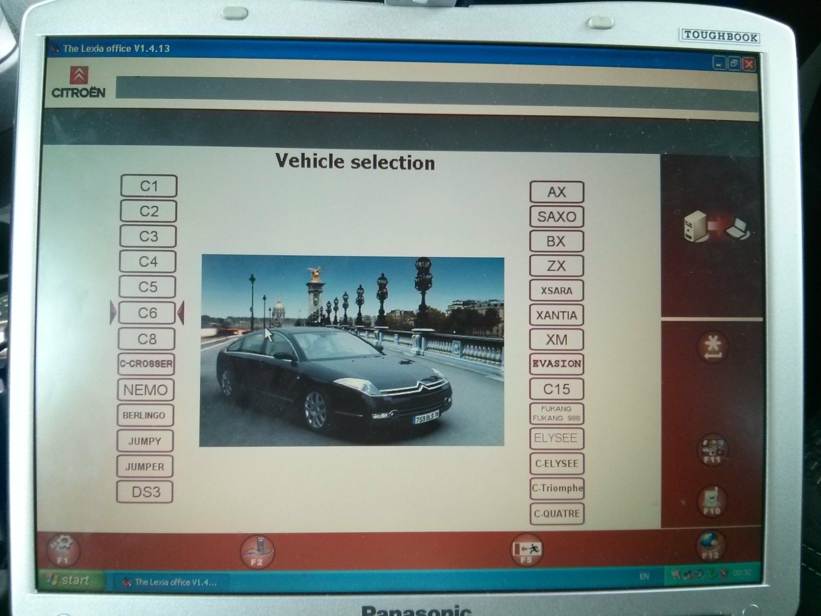

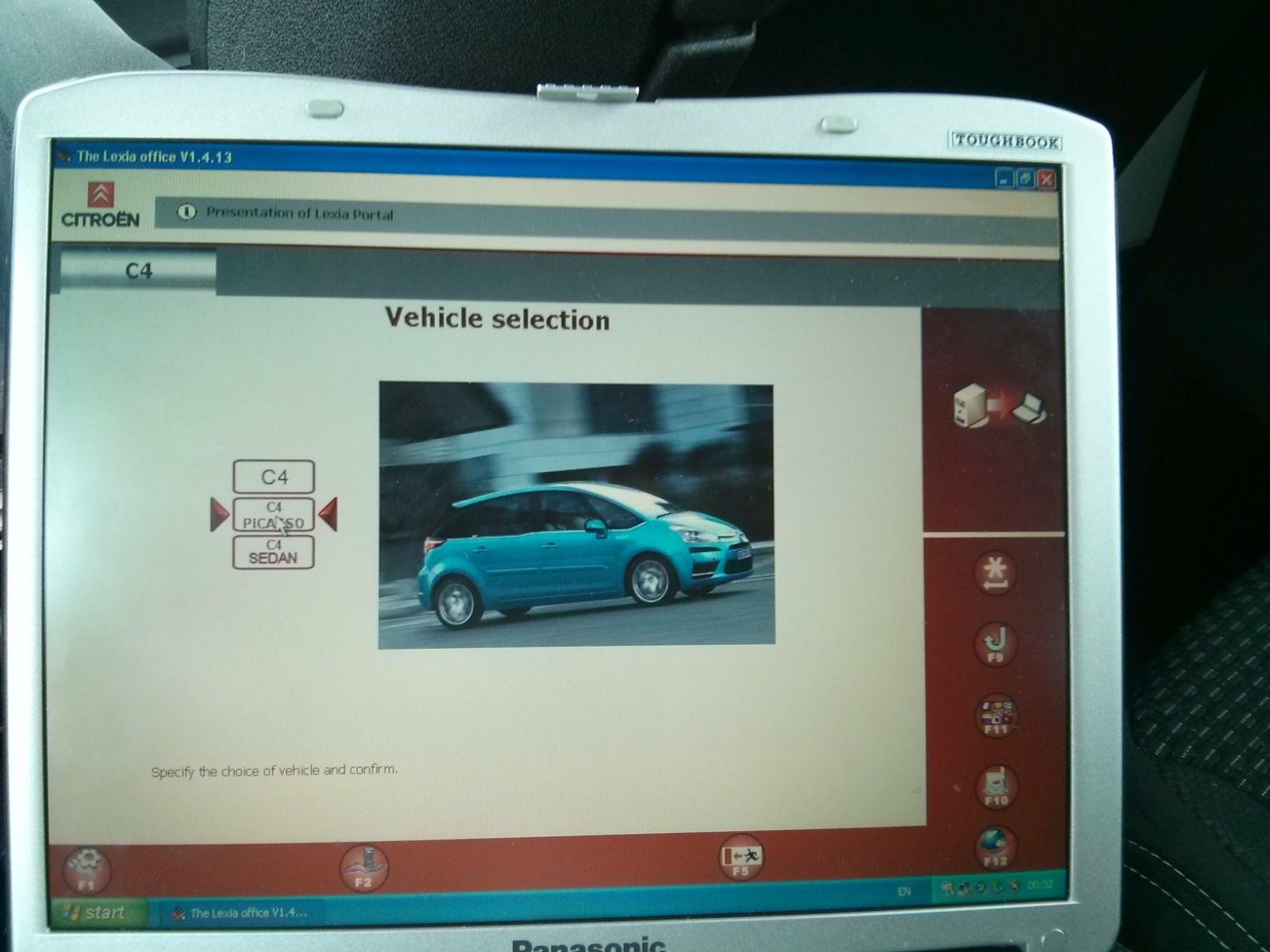

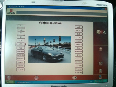

richarda
- Posts: 30
- x 9

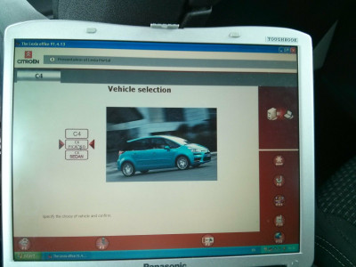

I bought the lexia from Ebay around 2017. Cost about £50 back then, came with a box full of connectors. I have it installed on a ancient windows xp laptop. Works OK, bit slow to get going and very old skool. Does the job though saved me a fortune.
Pics attached.

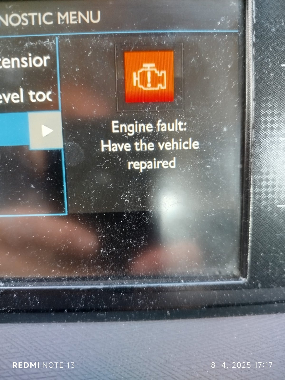

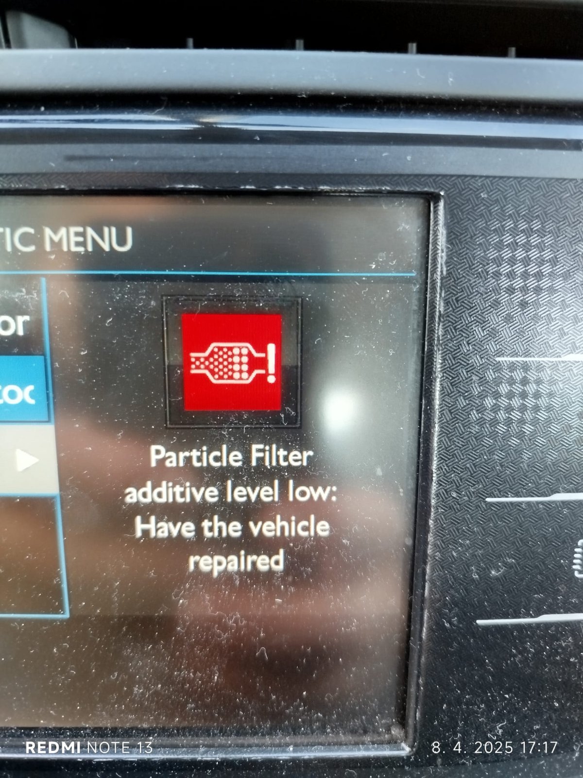

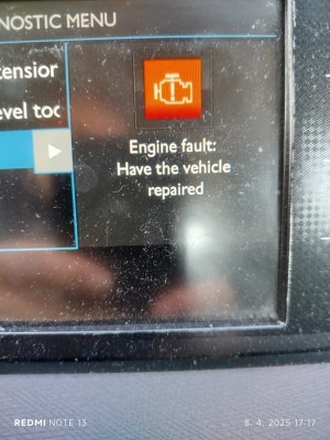

Hi! I am writing on behalf of my dad who drives Citroen C4 Picasso (2013 i believe) and he just got this error today. Could someone please suggest if he also has that refillable reservoir? Thank you! His vin is VF7**************[VIN obfuscated, can be read by forum staff]
Edit:
Should this be what he needs? eolys powerflex infineum f7995
Thanks in advance!
Edit:
Thanks in advance!

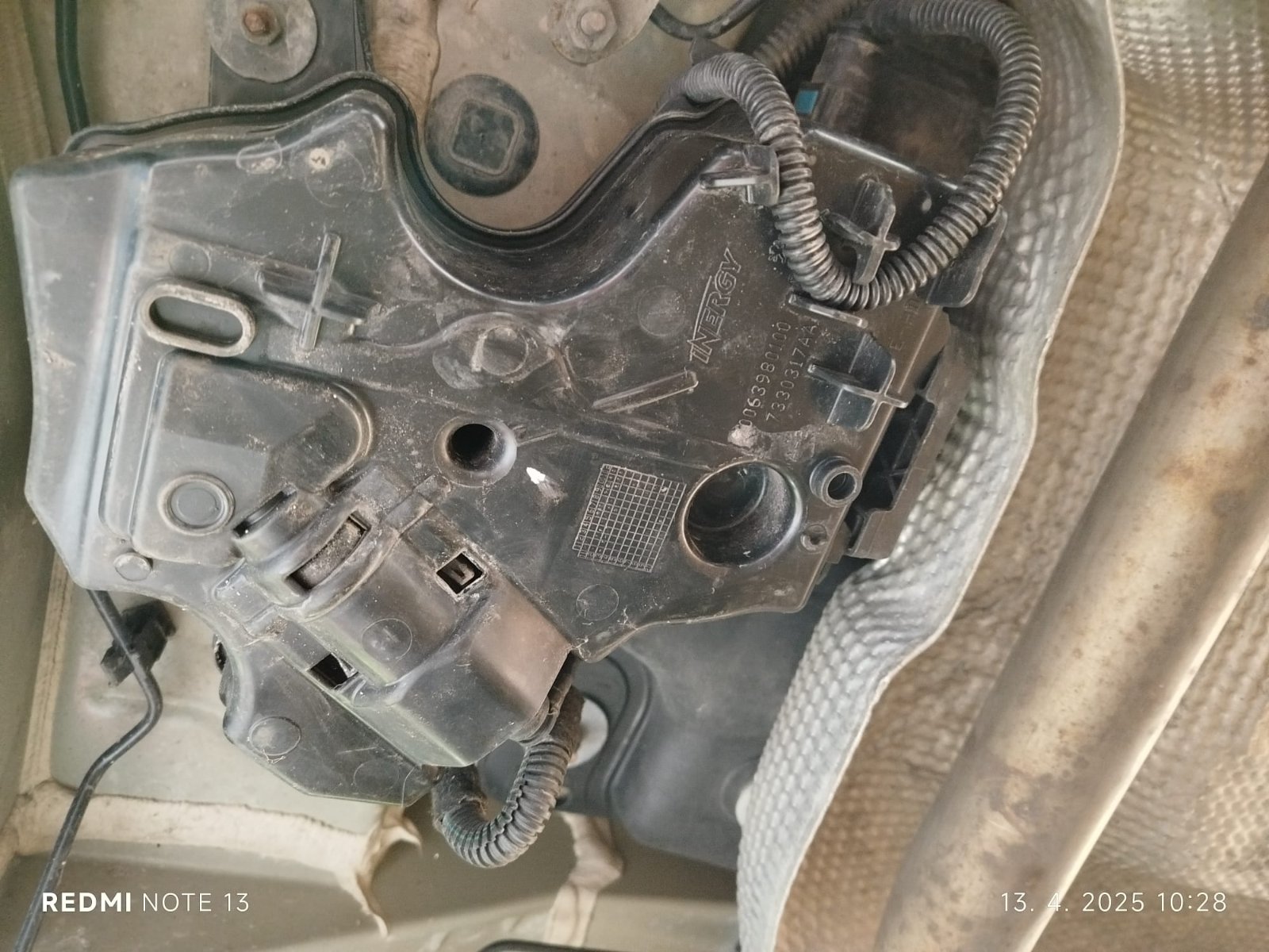

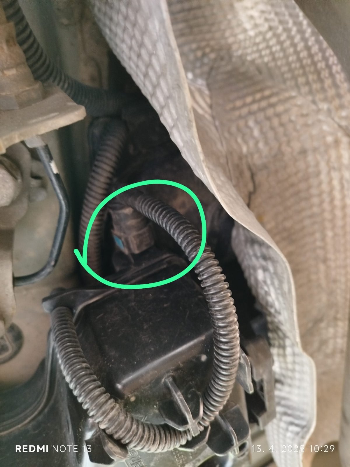

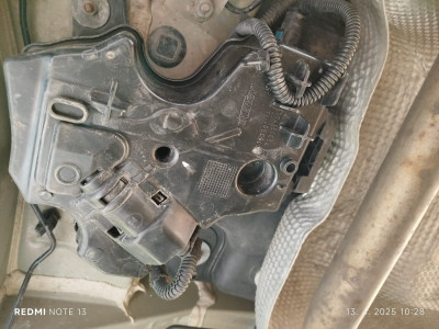

Hi again!
Still hoping someone might be able to confirm, just to be sure we’re going in the right direction
In the meantime, my dad was able to check a few things using his diagnostics tool. It looks like the additive tank has a 1L capacity, and the clip is blue (see attached photos), which from what I’ve read, would point to Eolys PowerFlex.
So just to double check: would BOSAL 258-977 be the right replacement fluid for this setup? (vin posted in my previous message in this thread)
Really appreciate any help, thank you so much in advance!
