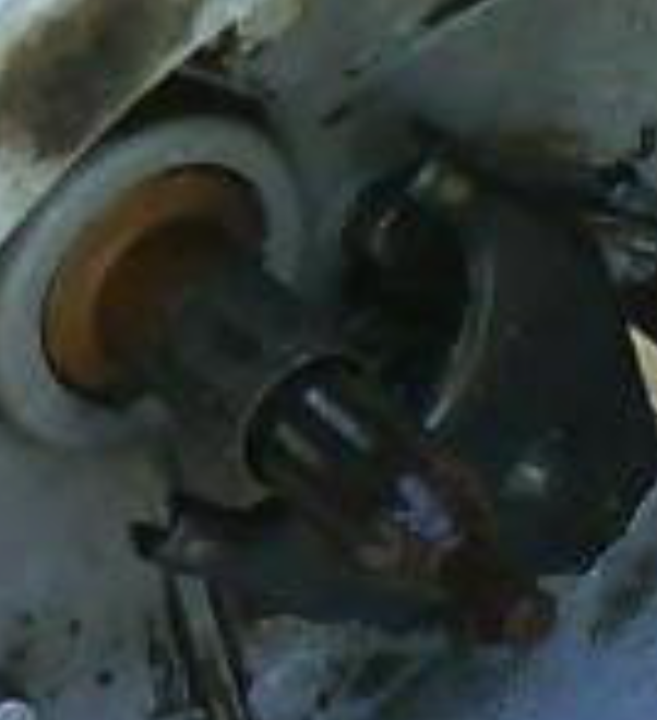

MattBLancs wrote: 09 Aug 2023, 18:24 To be honest, I think looking at the pictures is good but a bit risky!
Am sure I have read DW10 and DW12 are different sized bellhousings - pattern the same, but the overall spacing of the bolts was larger. (Will try and find the thread on it)
Am also worried quite how different the gearbox input shafts look, here's a zoomed in view from your image:
Splined area looks massive!
Agreed, it looks massive, but I was doing some investigation about it, took luk and sachs catalog and did a little cross reference
JPX/504 uses a Ø215mm disc, with 10 straight splines. Pressure plate uses 6 bolts
This was a very common spline for light trucks, my other jeep uses a clark 240V trans is similar, GM S10 to
EW10A/EW10J4/DW10TD/EW7J4/XU7JP4 uses the same Ø230mm disc 18 splines with the BE3R | BE4R | BE4/5 | BE3/5
Both XUD and EW10A used the same BE4R transmission, maybe with a different splined input shaft
