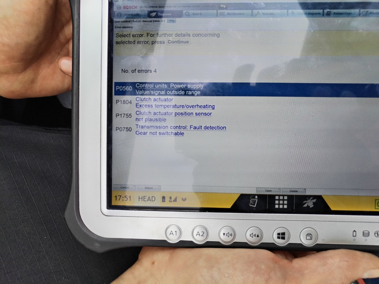

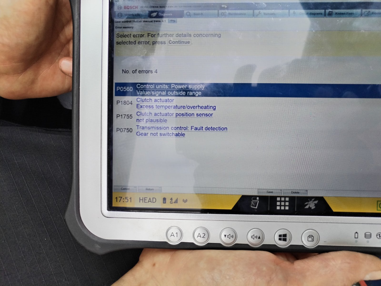

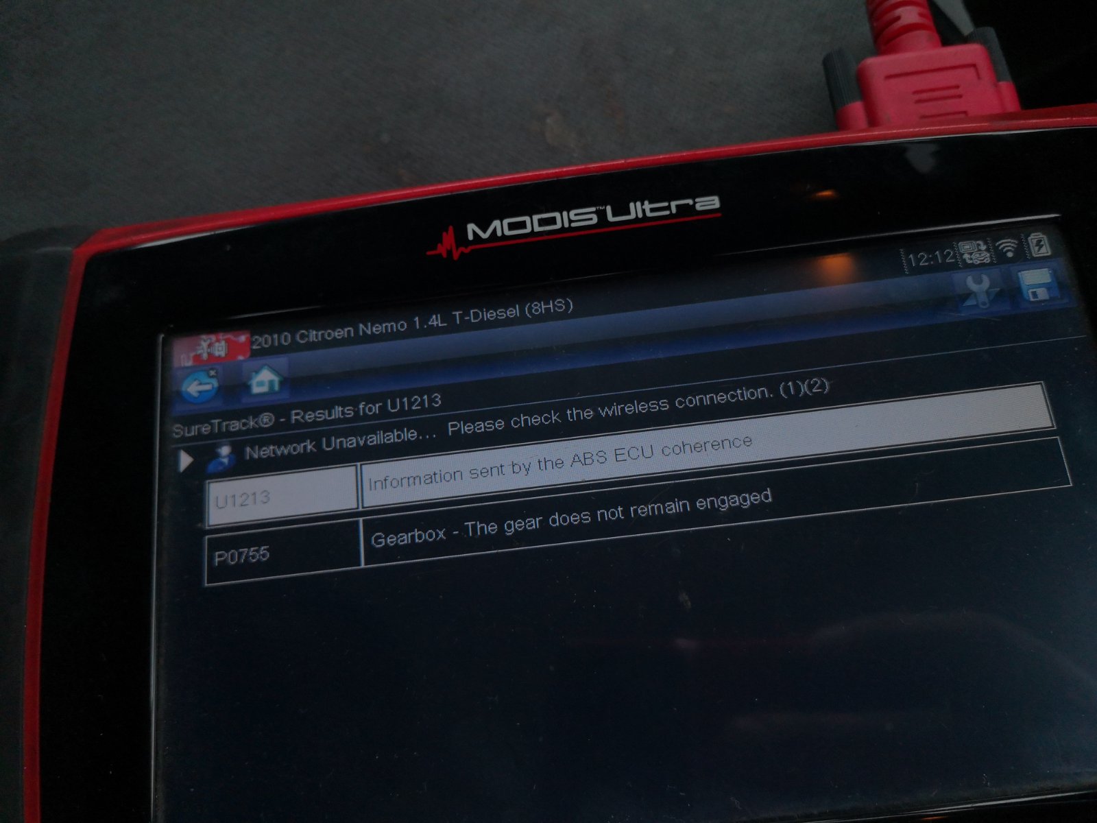

My car has the same problem, my gearbox was rebuilt, new clutch, flywheel skimmed. Mine plays up after about 40mins of driving, the actuator had already been reset and happened again. When it happens the electronic gearbox light comes up, it starts being jumpy, slipping out of gear, stalling, not been able to get in gear. Very stressful not being able to move stuck in random places on busy roads.
I have attached all my fault codes I have gotten over the past months. I am sure it needs a new gearbox actuator as it always seems to happen when warm.
- x 6956
Re: Nemo Broke down again auto gearbox issue
These can be complicated to deal with and need specialist attention or you will end up wasting money - I'd really suggest you bet it to a dealer to properly resolve or you could end up going in circles and wasting money.
If you want some help with the fault codes, pop your VIN up. Please post your VIN in full without spaces - it will be automatically masked from public view after submitting your post & will only be visible to staff.

I have found over the years, that if a vehicle is fine when cold, but messy when it gets hot, it's "usually" (not always) the crank sensor or a similar sensor that detects rotation. But in my experience, a crank sensor can cause all manner of maladies, but doesn't necessarily flag up a code. You need to get live data or even an oscilloscope to check the output.Johno4665 wrote: 17 Aug 2023, 14:50 My car has the same problem, my gearbox was rebuilt, new clutch, flywheel skimmed. Mine plays up after about 40mins of driving, the actuator had already been reset and happened again. When it happens the electronic gearbox light comes up, it starts being jumpy, slipping out of gear, stalling, not been able to get in gear. Very stressful not being able to move stuck in random places on busy roads.
Might be worth trying that first.
