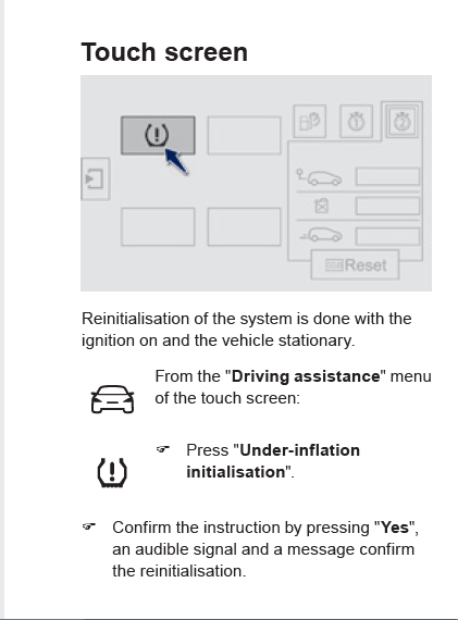

Does the screen have an option to reset the TPMS after inflating the tyres? If it does then it's the indirect type which compares speed information from the four wheels. This is the type we have on our 308.

Paul-R wrote: 19 Jun 2023, 12:08 Does the screen have an option to reset the TPMS after inflating the tyres? If it does then it's the indirect type which compares speed information from the four wheels. This is the type we have on our 308.
Can't find Anything to reset that system in any setting unfortunately

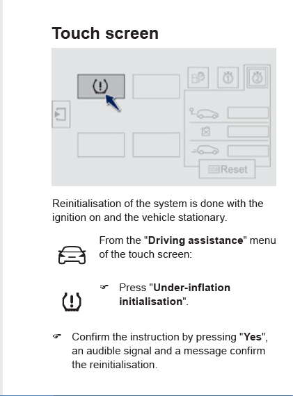

This is what is on our 308 with a touchscreen. You don't have anything similar?JamieLeeWV wrote: 19 Jun 2023, 20:21Can't find Anything to reset that system in any setting unfortunatelyPaul-R wrote: 19 Jun 2023, 12:08 Does the screen have an option to reset the TPMS after inflating the tyres? If it does then it's the indirect type which compares speed information from the four wheels. This is the type we have on our 308.

Re: Citroen app vin unknown?
Paul-R wrote: 19 Jun 2023, 21:06This is what is on our 308 with a touchscreen. You don't have anything similar?JamieLeeWV wrote: 19 Jun 2023, 20:21Can't find Anything to reset that system in any setting unfortunatelyPaul-R wrote: 19 Jun 2023, 12:08 Does the screen have an option to reset the TPMS after inflating the tyres? If it does then it's the indirect type which compares speed information from the four wheels. This is the type we have on our 308.
Nope. I do not have anything on my main screen with the nav on or my screen next to my speedometer about resetting anything to do with my tyres.
