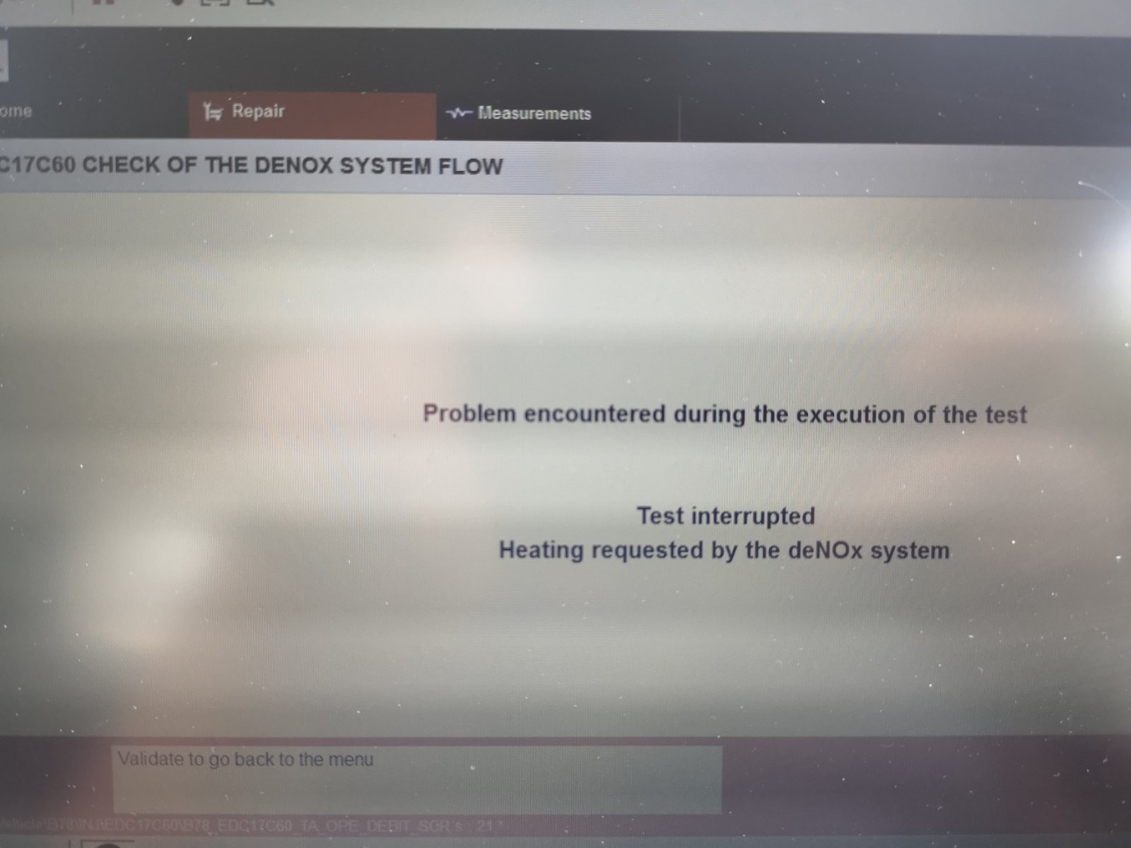

Did a flow test and the test was interrupted as heating requested by the denox system. Any ideas on why it would say that?

Re: C4 picasso bluehdi u029e 87 error code - has anyone had this? What was the solution please?
If the denox system heating is not working then it won't be able to complete the test or is refusing to do the test - as running the fluid through unheated supply pipes may cause it to crystallise in the supply and if that happens it will get blocked up rapidly.
